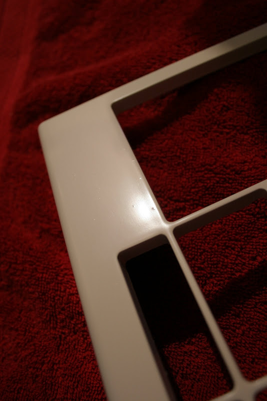

First Coat with problems in the finish
I used the Rustoleum Auto Gloss Paint from Lowes Hardware store. This finish is NOT hard enough of a finish to last on your keyboard, mine is currently in the auto body shop down the street getting a shot of clear on it. On this first coat you can see some trash in the paint. I started off with two thin coats and then i wet sanded the whole thing down for the 3rd and 4th coats. The first three coats where done in the first hour of the project but the final coat i waited for 3 days to fully cure and then wet sanded it with 600grit.
