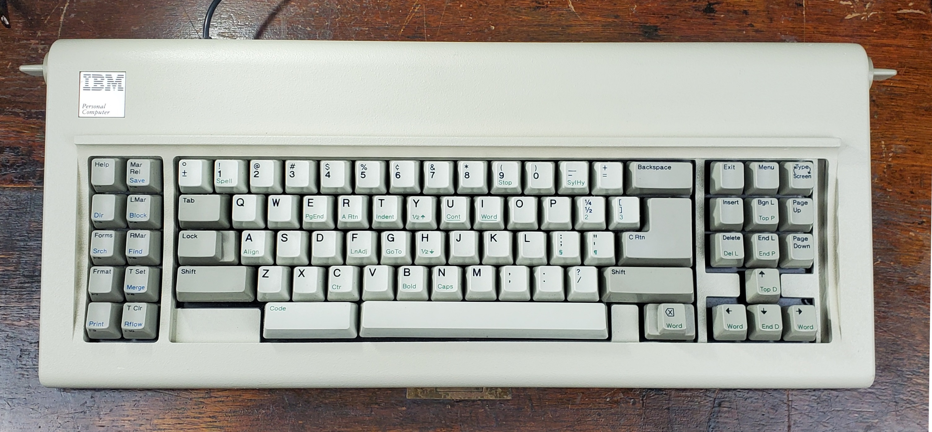

UPDATE 1-29-23: Finally able to modify the Wheelwriter cover and overlayed on the barrel plate to get color matched blockers. Made the entire build look much better almost like it was supposed to be this way. Now completely working with QMK.

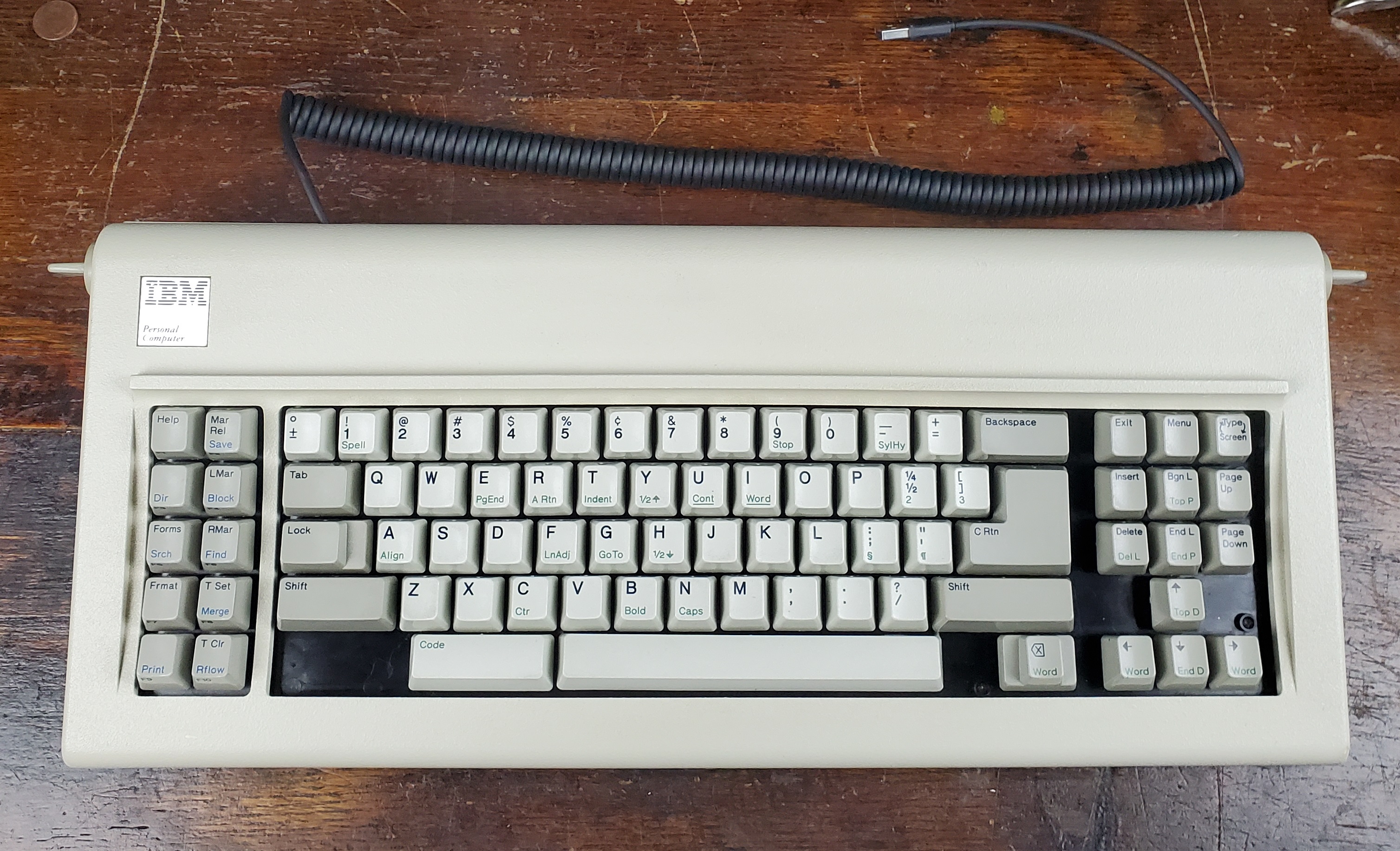

Coming back to what this is. I saw a post a while back about that a Wheelwriter assembly might fit into a Bigfoot. I didn't have a Bigfoot case but I did have this. Since I have a spare XT case I am not using, I wanted to see if the Wheelwriter assembly fits. Of course the Wheelwriter is using Model M flippers, but it does allow an interesting layout with that funky Code key.
The short answer is the Wheelwriter assembly does not fit out of the box (it is 1/4in too wide and too tall), so it needed some plate modification. But the layout certainly does fit and after simple modification of the Wheelwriter backplate you can get it into the case, as seen above. There is still more to do, tweaking the keyboard assembly placement, and I am going to try the new MStar controller with it after mapping out the matrix. But it all fits and looks doable.
Is this a good idea, probably not, but I do like to try odd things and will post again to the Workshop if I get it all together. Also as there are traces for the German layout under the LShift, it might be possible to membrane hack and mod the plate to get an LAlt, and maybe an ANSI Slash if I get around to bolt modding and looking at the membrane layout. But that would be a bit down the road.

For this thing if I can hack an extra left modifier, and get tap mods working, it probably would be just fine for me. The Wheelwriter keys feel pleasantly different than my Mini M and Model Ms I have, not quite sure I can describe it. Maybe a little crisper and a touch firmer. The keycaps also seem a little different slightly more textured in a nice way. The spacebar is a clacky mess though, but I have not relubed the stabilizers yet.

I was able to map the matrix, typing on it now! Used Level1Techs MStar controller, Mini M version since it has the dual 16 pin triomates, as Wheelwriter's actually have 2x15 trace connectors although it only uses half (8 traces) of the row connector of course and only 14 if the columns as column 0 has no trace. I have a QMK configuration and will see if I can post it to Workshop in the next few days. You could use one of the Model M versions with the 8 or 12 pin connectors but you would have to cut the membrane on the row connector.
All in all pretty painless with a little futzing with QMK to add the configuration.

Updated the pic for the final look and fully working now using QMK.
