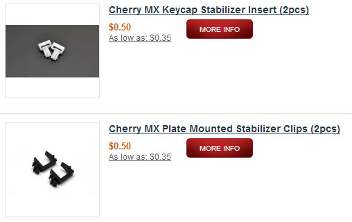

29 Sep 2012, 19:24
gimpster
29 Sep 2012, 19:41
Yup, those are Costar stabilizers. The plate was made to be compatible with those as well as plate-mount Cherry stabilizers. It's just the PCB that can't support PCB-mount Cherry stabilizers.
EDIT: if you want Cherry stabilizers, you can get the 2x stabilizers and wires from Mouser here:
Mounts: http://www.mouser.com/Search/ProductDet ... 0-G99-0224
Wires: https://www.mouser.com/Search/ProductDe ... -0014-0645
But the MOQ on their spacebar stabilizers are far too high, so you'd need to source that wire from another keyboard or just use a Costar stabilizer for that.

Half-Saint
08 Oct 2012, 12:31
What I mean is that the hole for the switch is much bigger (wider) than the switch itself.
I'm asking about the costar stabilizers because I don't have them here yet and just by looking at the image, it's not at all logical how those two parts fit together.
The white 'things' look like normal Cherry G81-3000 stabilizers which you can pull out of the keys...
HzFaq
08 Oct 2012, 12:39
The black bits clip into the plate and are connected by a bent bit of wire. The white inserts go into the cap and are hooked on to the bent bit of wire. It will all make sense when you have them in hand.
Like this?
I guess it's to allow for different spacebar's to be used (some have odd stem spacings).
Half-Saint
08 Oct 2012, 12:47
OK but am I right about the white inserts being the same as in G81-3xxx boards? :-)
HzFaq
08 Oct 2012, 12:48
No idea, I don't own any G81's, sorry.
The_Ed
Asperger's... SQUIRREL!
08 Oct 2012, 12:59
No.
Half-Saint
08 Oct 2012, 13:03
The_Ed wrote:No.
The ones that I have look the same as above except they're symmetrical while the insert above (upper right) is not.. I'm talking about the part where the wire goes.
