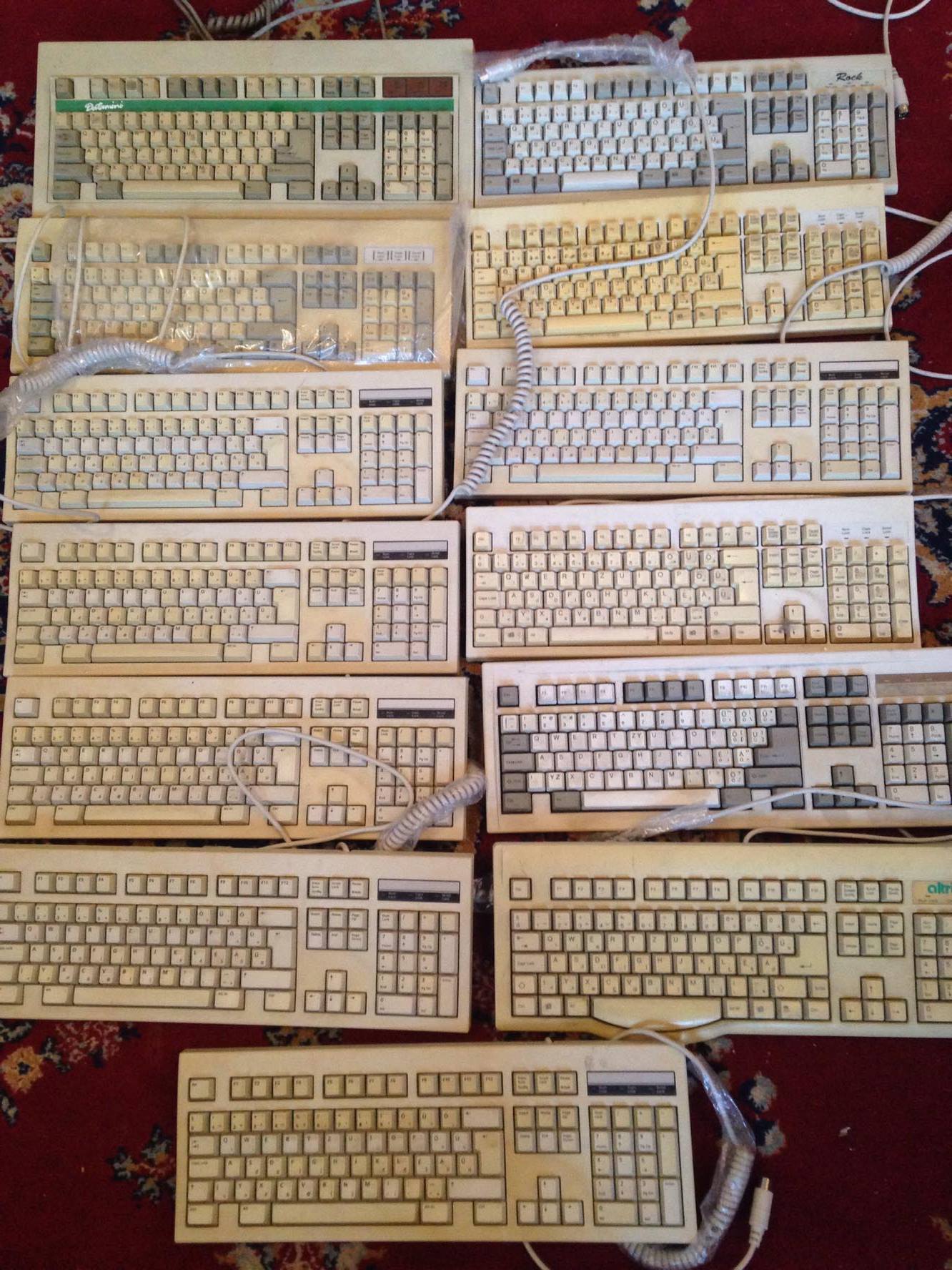

Hi guys. I've just sent the money for theese keyboards. WUTARDOOZ???
I've successfully identified the 6 FREAKING Poor men's topre (BTC D W/ S, big Échap key, with the brown-black very distinct num-scroll-caps badge thingy) (temll me if you want one
), and the Altrix (which is ofc a cheap rbr dome, I have one already. But the others... Can't seem to be able to identify them. But the most interesting one being the top left Model M lookalike.
Thanks, Lynx!
EDIT: If I'm not mistaking, there is a Mitsumi dome over membrane also, that one which is badly yellowed.
PS: https://www.youtube.com/watch?v=IK0t38Al4_E if you don't get it
Thanks, Lynx!
- Things.jpg (340.43 KiB) Viewed 6093 times

- Daniel Beardsmore
- Main mouse: MS IMO 1.1
Second from the top on the left is a Chicony, something like a KB-5916 (the [ ] bracket-style LED labels are a give-away, although it took a while for me to remember where I'd seen them).
Top left is not a Mitsumi, but it's very close to a Chicony KB-5181. It's not quite that, nor a 1KB101ATUS, nor a Monterey K101 — it's a common design, and there's a reasonable chance of it being mechanical. Hopefully it's interesting enough to justify whatever you paid for way too many BTCs :P

10$+shipDaniel Beardsmore wrote: Second from the top on the left is a Chicony, something like a KB-5916 (the [ ] bracket-style LED labels are a give-away, although it took a while for me to remember where I'd seen them).

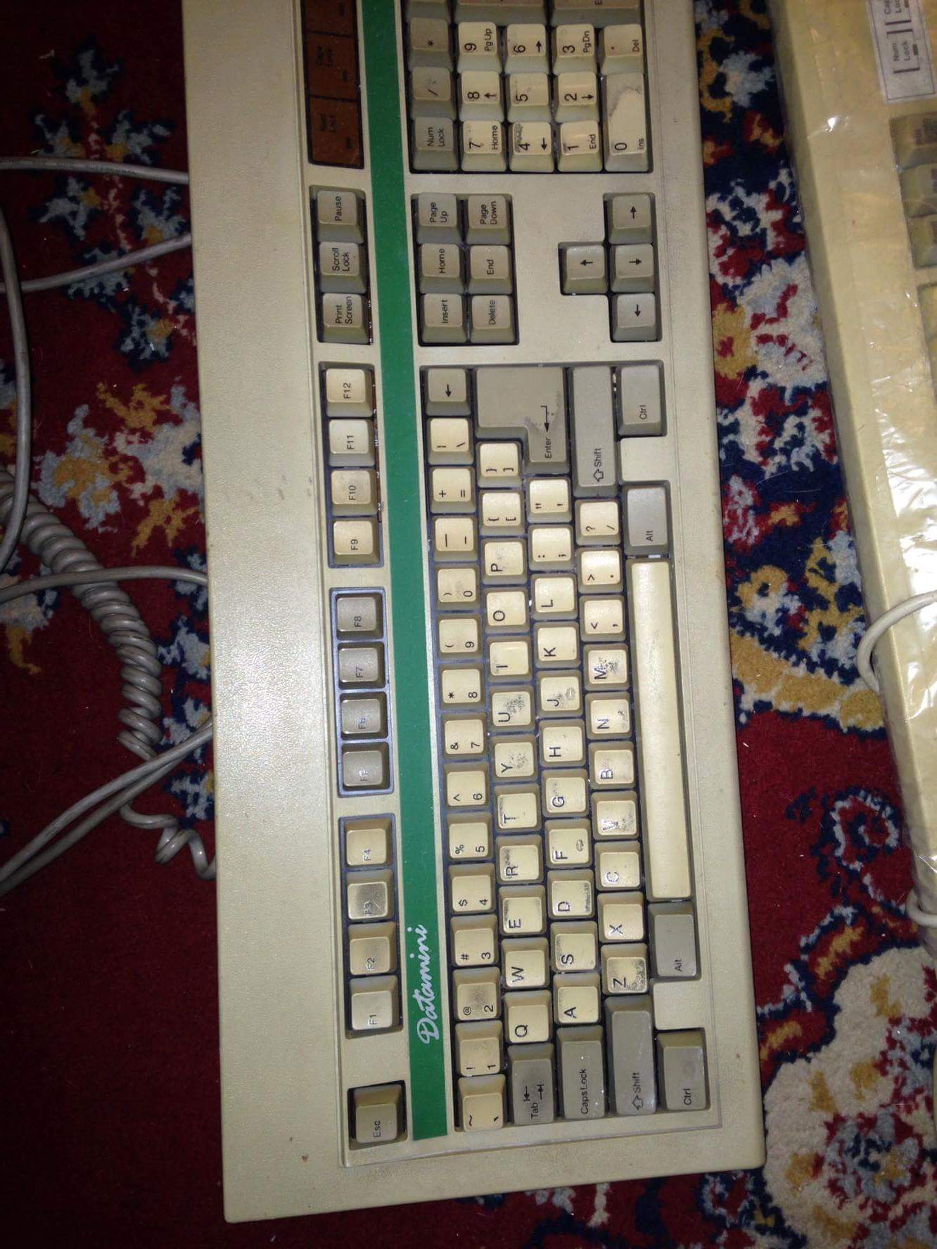

The guy sent me some more pictures. I've searched for the magic keywords and found this: http://img3.picload.org/image/lopagri/w1ssv1j.jpg
Seems like MX Blues, and guess what, mine also looks like PCB mount, confirming futaba Clicly or mx something.

Doh, pad printing with selective image coating.
Seeing it more closely, I'm now pretty certain actually it is a Chicony KB-5181.

- Daniel Beardsmore
Not sure. The 5191 was often PCB mounted, but that to me looks like a black painted plate, and 5181 with MX Blue is confirmed to exist in plate mount. It's the case that gets a bad rap, though.
