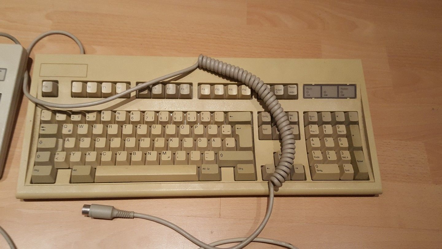

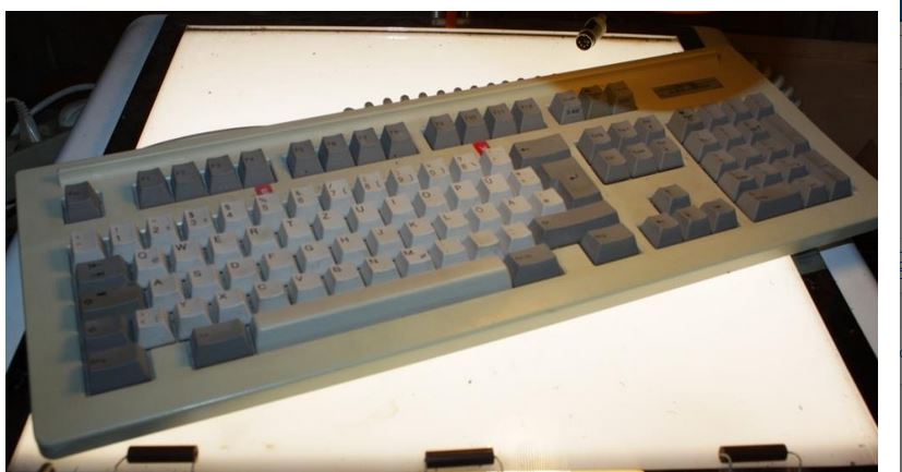

I've looked at the photos, and you've not shown the switch or the model number.Byarlant wrote: Found this at a recycling center a few days ago cleaned it up it works great seems to be some sort of membrane kb with cherry stems which is very odd it also seems to use a weird type of membrane that has something else in it for the actuation it also has really nice DST keys with Cyrillic characters on it its pretty neat. tried searching the model numbers google gave me nothing :/
IDENTIFY THE KEYBOARD thread

Thanks! That was a quick IDDaniel Beardsmore wrote: That keyboard is almost the same as that of the [wiki]Sager NP-925[/wiki] — including the style of PCB, albeit Fontex instead of Parex. The switches appear to be [wiki]Alps SKFR/SKFS series[/wiki], finally indicating why the yellow ones exist (for function keys).
I don't have any keycaps to go with these switches so I can't say how hard they are to remove — someone with an Apple Adjustable Keyboard will know the answer to that.
I don't know of any series now with switches that are short front-to-back — that was an Alps peculiarity and all those series are gone. However, NOS SKFR and SKFS switches are still available, but I don't know off-hand if the yellow ones are still sold, as the chap I bought them from no longer sells parts. The problem with those is that you'd never get new keycaps for them.
It looks very similar to the Sager, only mine has just the 10-pin cable, not the ps/2 connector on the side
The switches are very nice, much nicer than anything on a modern laptop and if there are no other keycaps for them there is also less need to remove the current caps, except for cleaning.
The similarity and the fact that the motherboard does have a ps/2 connector on the back (labeled 'ext. keyboard') are pretty solid indicators this is a ps/2 keyboard.
Is there a way to figure out the mapping between the flatcable and the pins on a ps/2 connector? Or would I need a scope or something to analyze the signals?

The function row (SKFRAD) will be linear. I'm guessing that the remaining switches are all SKFRAC, also linear?
I can see what appears to be at least eight connected pins on that cable, so PS/2 or AT seems unlikely.
Curiously, the big 40–48-pin IC is at the bottom of the keyboard on the far side away from the cable. Of all the connections coming in from the cable, just one goes into a switch. The rest seem to go disappear into huge blobs of solder. The switches seem to be connected to each other but not the far side of the PCB, based on the one photo showing part of the PCB close enough to trace.
I would have thought that the cable would go directly to the chip.
Electronics isn't my thing, and besides, I can't see how the chip is connected up.

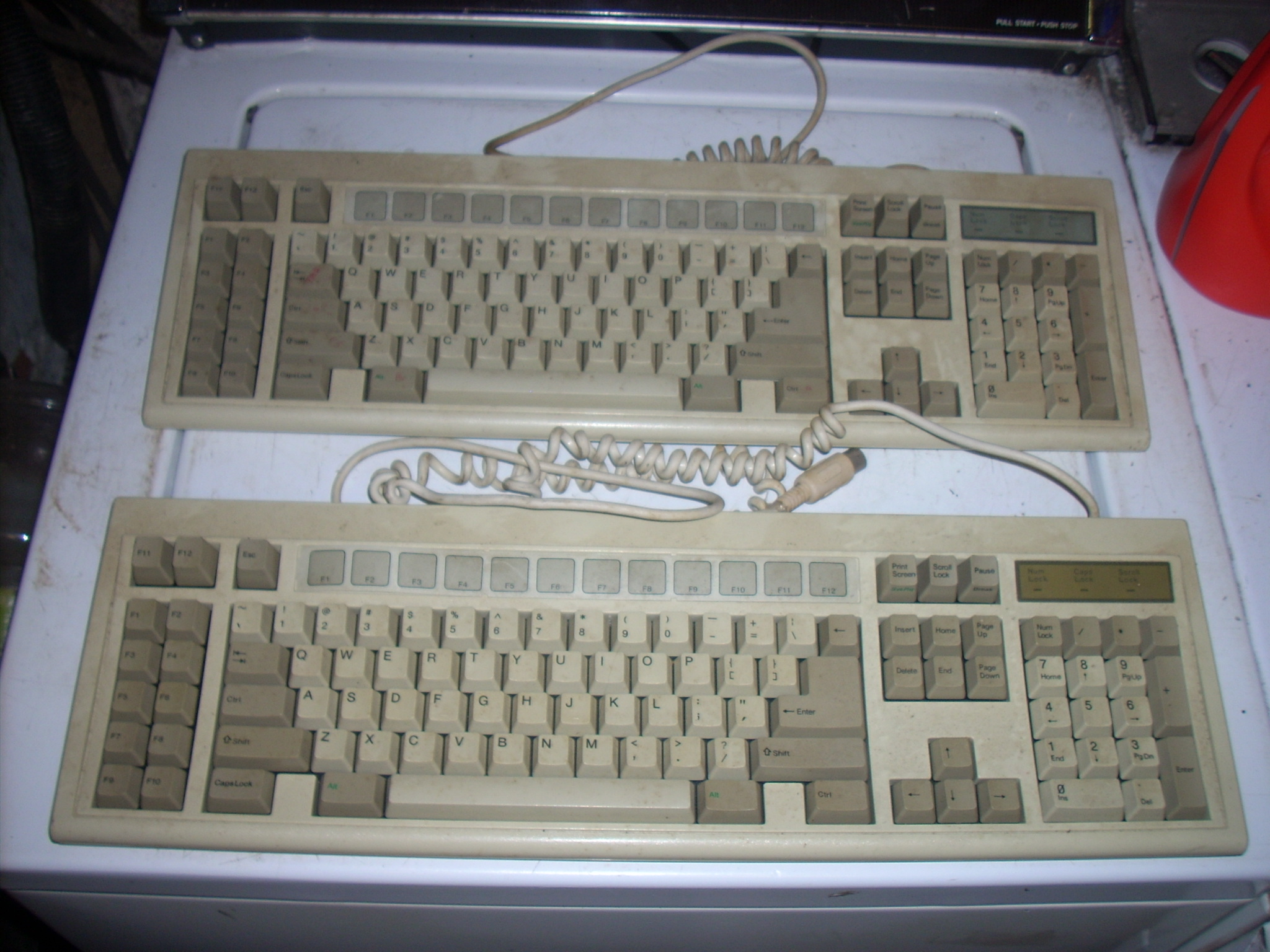

ok finally fixed it properly here it is not sure why I had so many problems.Daniel Beardsmore wrote:I've looked at the photos, and you've not shown the switch or the model number.Byarlant wrote: Found this at a recycling center a few days ago cleaned it up it works great seems to be some sort of membrane kb with cherry stems which is very odd it also seems to use a weird type of membrane that has something else in it for the actuation it also has really nice DST keys with Cyrillic characters on it its pretty neat. tried searching the model numbers google gave me nothing :/
- 1503186079606276860648.jpg (213.32 KiB) Viewed 6865 times
- Daniel Beardsmore
- Main mouse: MS IMO 1.1
Please put an actual image or link!

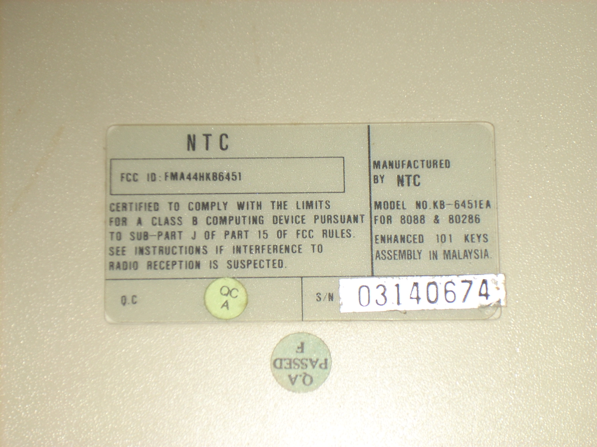

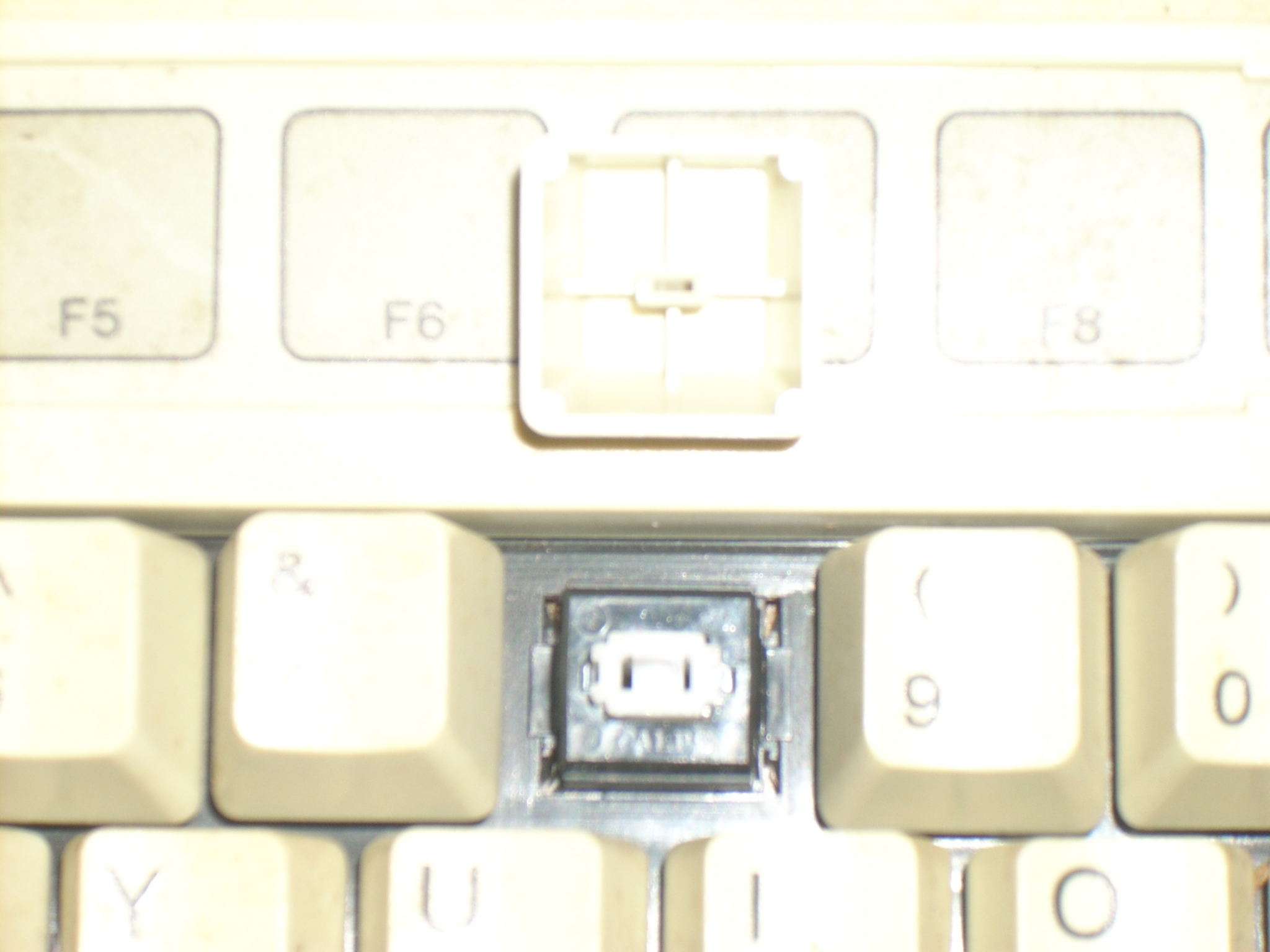

New here, trying to catch up. Late reply to a question a few pages back. I have two of those here. Mine are NTC model KB-6451EA, white Alps SKCM (marked ALPS on top), printed caps, XT/AT switch on the back, 5 pin DIN, plastic plate, very light weight. Nice feel (to me...), interesting layout. CTRL key next to A (Wordstar-friendly). Keys at the top corners very deep; those were usually broken off.

- Saved two good ones out of dozens that were broken, usually the top row keys, which were very deep.

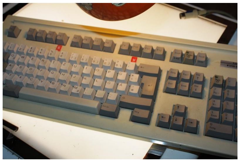

Nixdorf luggable - anyone know or care to guess what type of switches this uses and whether it has a regular DIN connector?

I once came across a similar machine once with nice tactile switches, but it was Siemens instead of Nixdorf. The switches were white in some way, so I figure they were Siemens STB 21 (I couldn't seem much of them). Sadly I never wrote down the model number of it.

Right, I have a feeling it's a rubberdome.
- Daniel Beardsmore
The insides are a light colour, which could be a single plastic upper case, but it could also be a bare metal or white-painted mounting plate. Hard to say, but it's not particularly promising.

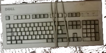

Looks like Dell AT102W. The image was a little edited by me...

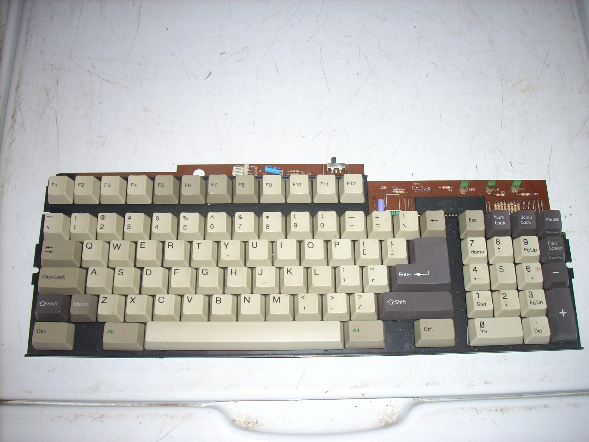

Still digging through Mr. Whoopee's Closet, down to the 386 vintage stuff now, found this one. No case, no ID other than "KB-089" on the back of the board. White Alps clones. About half have lost their click. 4 pin connector. Two position slide switch, unlabeled, presumably AT/XT? Brown Enter key, etc., Macro key next to left Shift. Stamped caps. Some sort of luggable?
- DSCN9722.JPG (804.75 KiB) Viewed 6523 times
