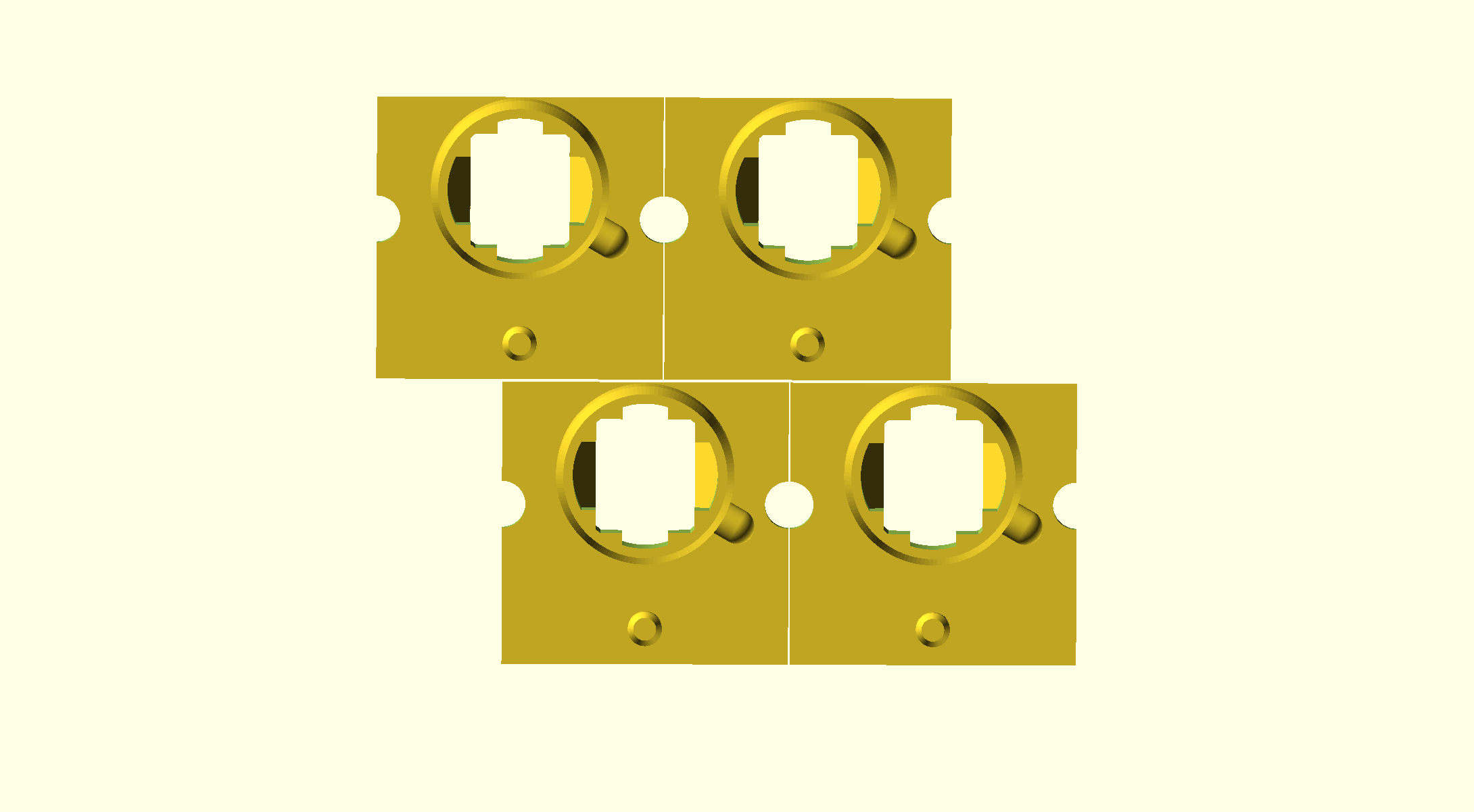

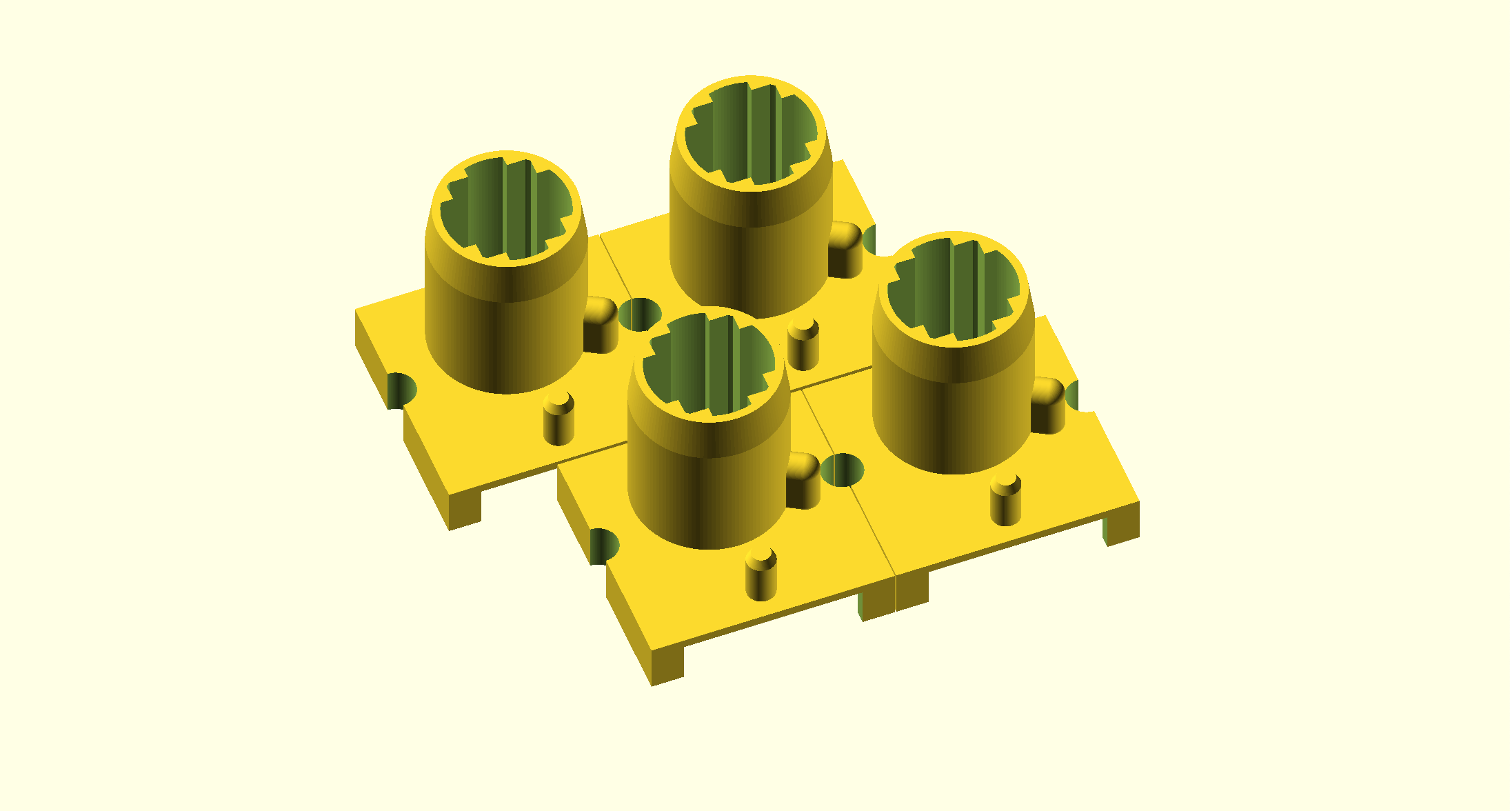

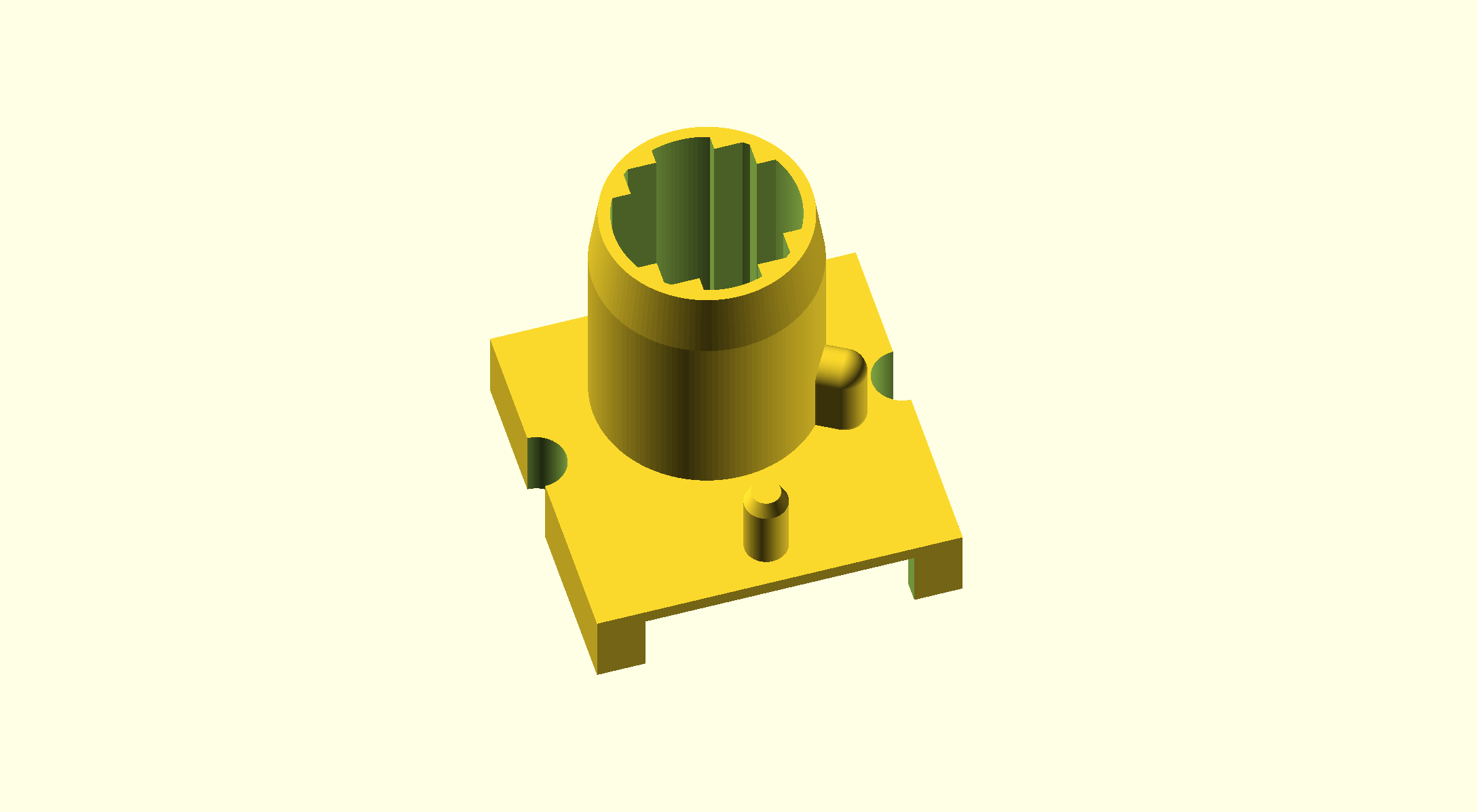

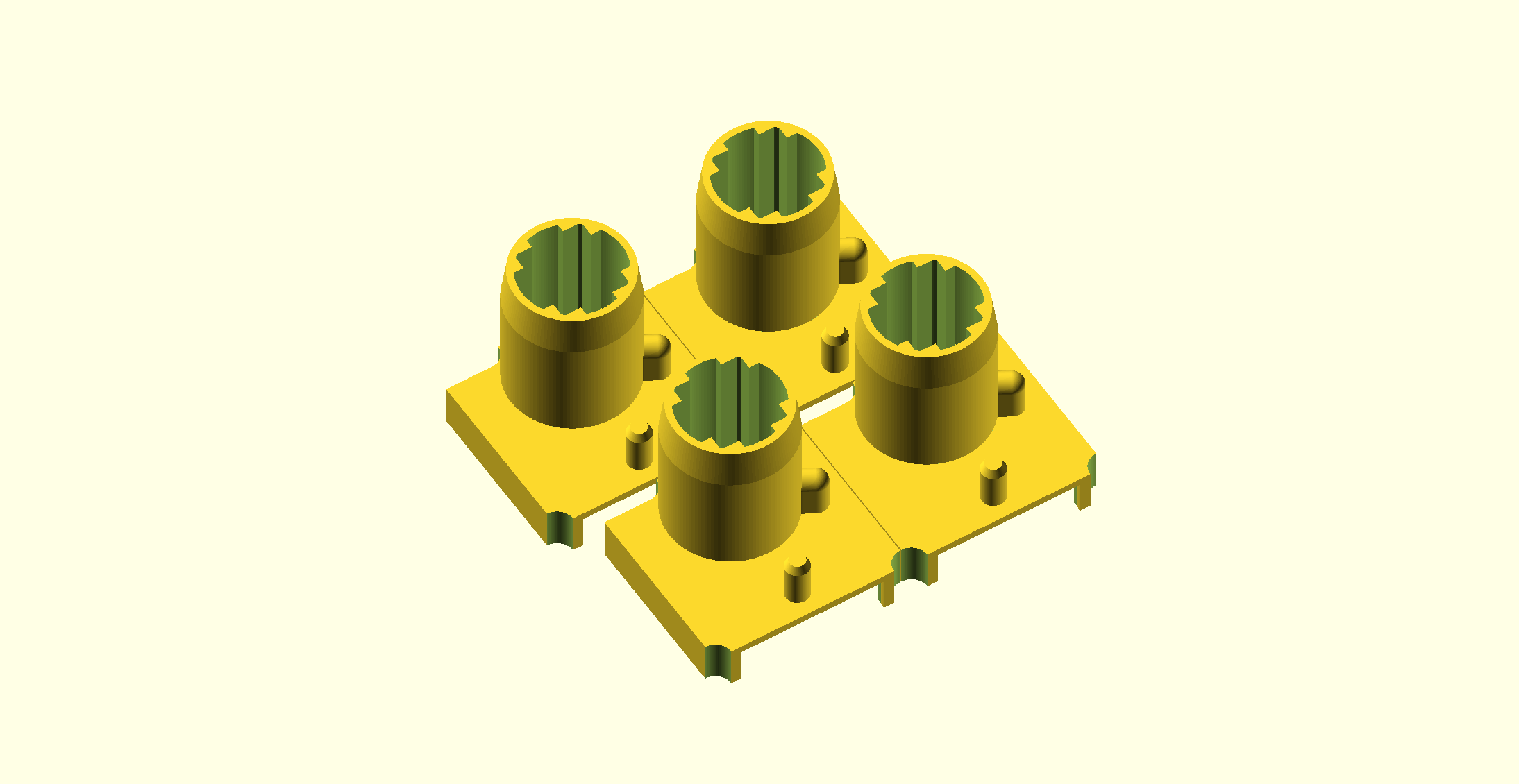

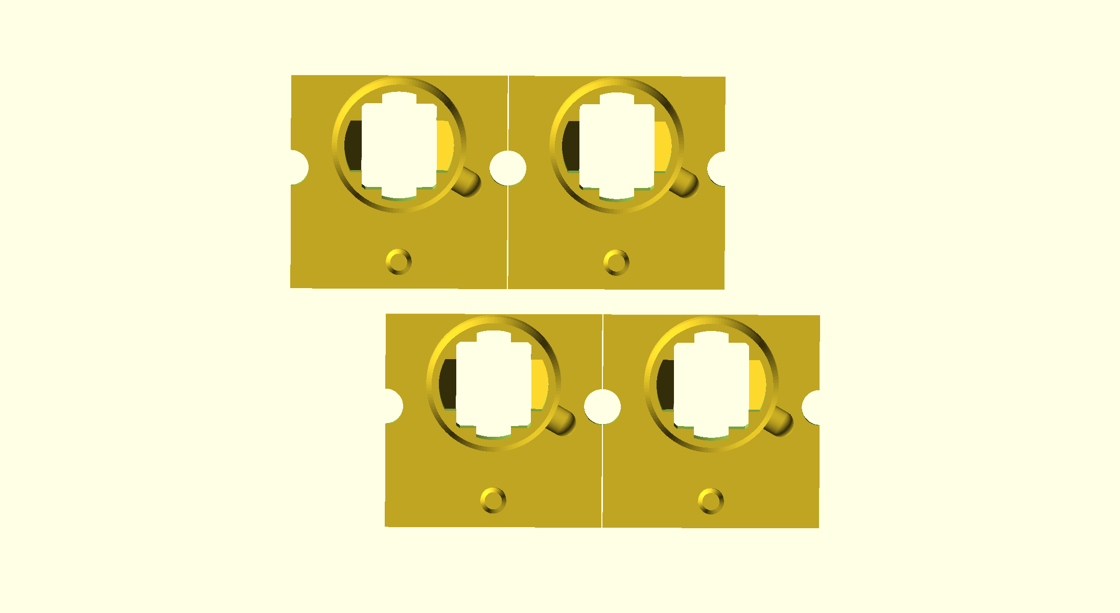

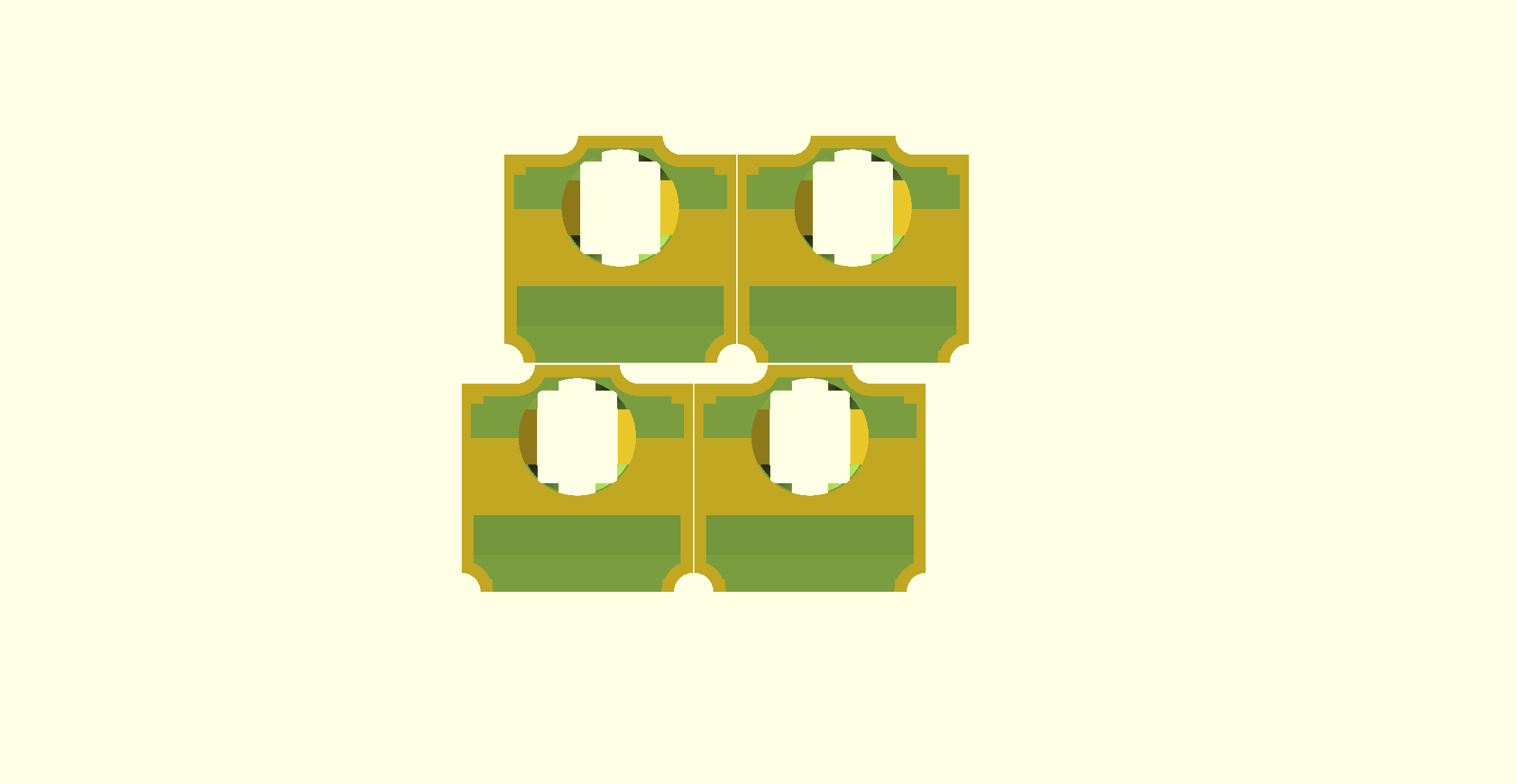

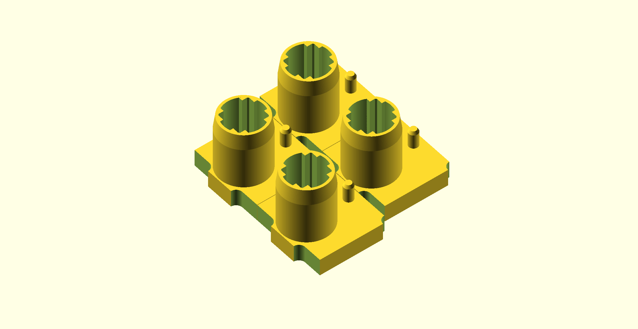

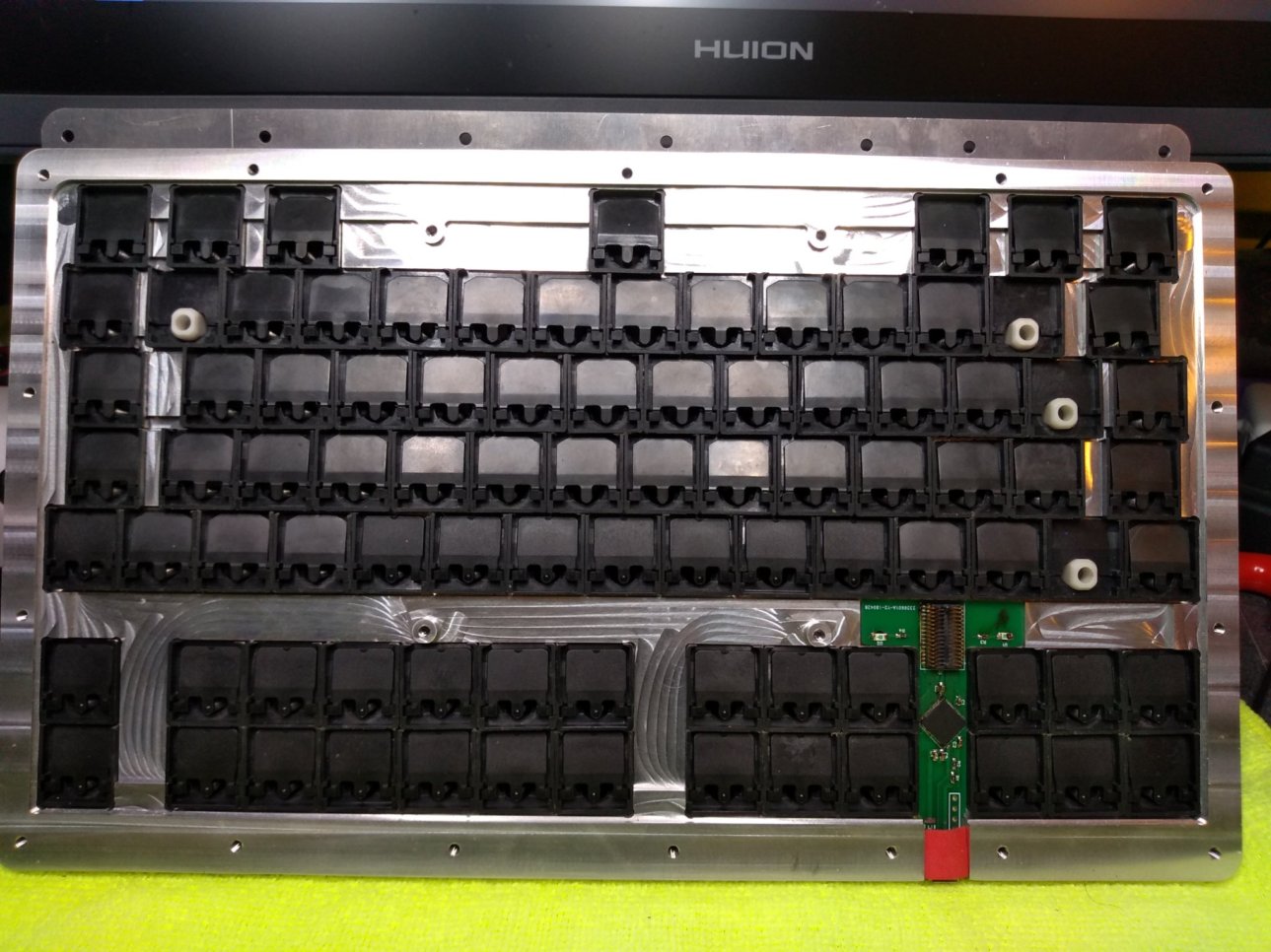

Here are some renderings of the modified barrel as previously discussed... assuming we ever make our own. The goal of this design would be to create a barrel that works with a larger number of plate form factors. Remember the original plate design really only did so because the curved plane allowed key caps to be moved to alternate rows without affecting the form factor (also made cap production cheap for IBM). While we would still work perfectly well as originally intended, we could now have a buckling spring on a flat plate plane as well. The "quarter circles" have been added to the corners to allow for 3mm pass-through bolts to help tune the board. We all know that buckling spring boards have dead spots. Even my VERY best buckling spring boards have at least some inconsistency (tuned Ms from Phosphorglow included). The properly tuned Ms are by far more consistent than the best Fs, but the M is obviously just "dead" feeling on its best day by comparison. Really only even bringing up the M because this concept is in direct alignment with bolt-modding an M... but with an F.
The bottom quarter circles can be in a consistent location for two reasons. One, it had to either be on the top or bottom :), and two... it enables the flipper contact area to remain as large as possible. Because the bottom quarter-circles are in a consistent location, the top has to be variable because the align of rows vertically is offset (meaning, we aren't stacked in a perfect 2x2).
Welcome the thoughts. Again, this is ONLY if we decided to actually take the leap and create our own barrels and flippers. I left one render with an original flipper so you can see how we need to reduce the contact area of the flipper by ~10% if we wanted to make this work (I have it completed, but wanted to introduce this concept in stages). @DMA... this is the bit where I am not sure if everything falls flat on its face. It means the sensitivity of the controller needs to account for that potential ~10% reduction of circuit (assuming surfaces are clean, etc). Also note, these renders are on a flat plane. For the curved plane (stock), there would be a ~2mm gap between barrel rows
2x2 barrel stack
2x2 barrel stack
Screen Shot 2019-03-20 at 5.21.06 PM.png (132.95 KiB) Viewed 20554 times
2x2 barrel stack from above
Screen Shot 2019-03-20 at 6.12.55 PM.png (85.45 KiB) Viewed 20554 times
2x2 barrel stack from rear
Screen Shot 2019-03-20 at 6.05.14 PM.png (126.66 KiB) Viewed 20554 times
Bottom of a 2x2 barrel stack
Screen Shot 2019-03-20 at 5.19.08 PM.png (71.99 KiB) Viewed 20554 times

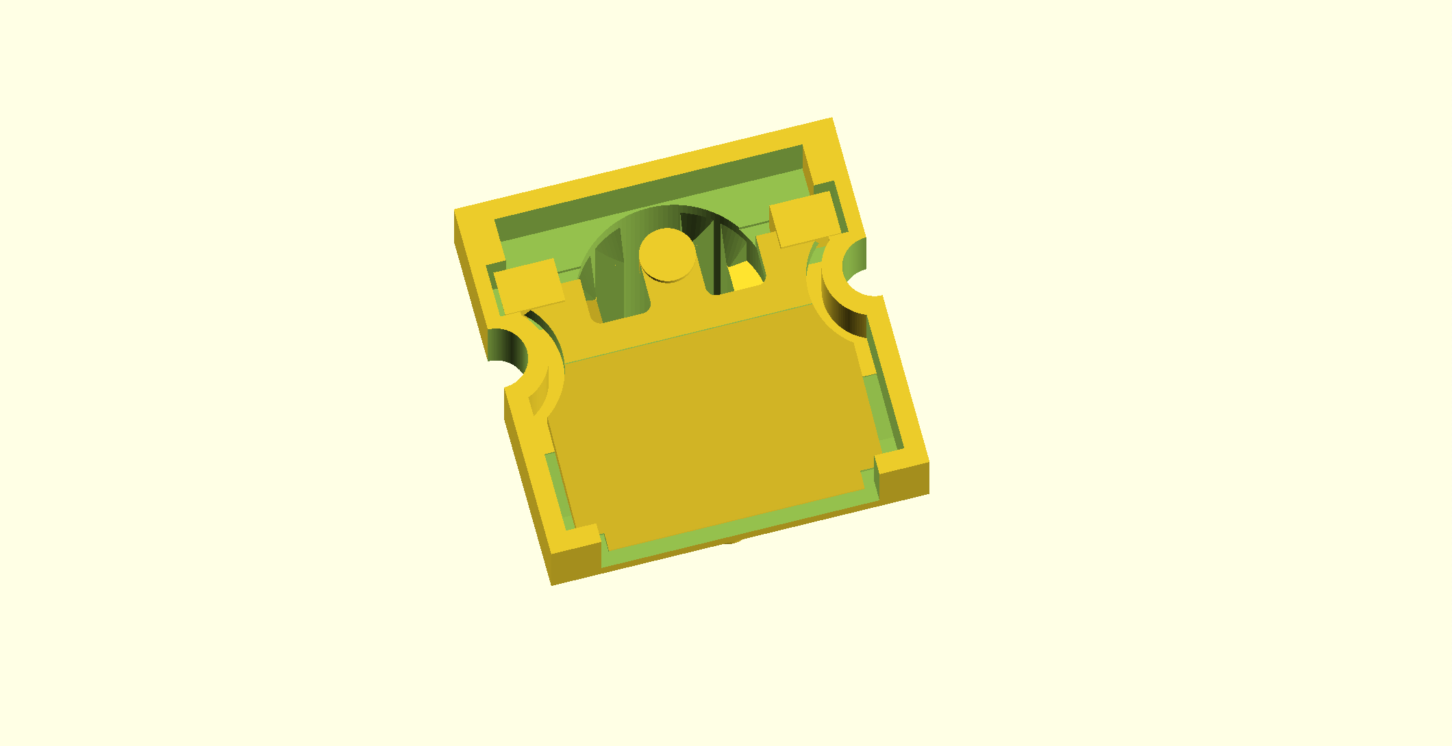

NOTE...  the new flipper design requires reduction of ~10% of contact area
Screen Shot 2019-03-20 at 5.38.13 PM.png (58.01 KiB) Viewed 20554 times
wcass
21 Mar 2019, 02:54
if the rows are offset by a half unit (as they are for most of of a "standard" 60%) do the quarter-rounds form round holes? It kinda looks like this would work for non-stagger and quarter-stagger but half-stagger maybe not.
lot_lizard
21 Mar 2019, 08:31
wcass wrote: 21 Mar 2019, 02:54 It kinda looks like this would work for non-stagger and quarter-stagger but half-stagger maybe not.
Exactly as you say. The other option is having two full half circles on the sides, but that is either impacting the flipper contact area a bit more (maybe up to 20% counting the ~2mm reduction for the row tightening) or potentially tightening the distance between the flipper pivots towards the top (probably more ideal). Let me throw that together (semi-circles towards the top) and see what we have. It’s certainly more ideal for tuning long-term if it can be every row as you say (given various form factors of today and future unknowns). I was attempting to avoid altering the flipper itself as much as possible, but if we are going to be shorter on the “lever” by a tad, then a tighter distance of the “fulcrum” legs in a similar ratio is probably ideal. Only testing will tell.
EDIT: I should also mention. If we were actually going to do this “in all corners” design (the ones posted), then we would likely get rid of the side wall around the bottom quarter circles. Then it has then upside of working with legacy flippers if the switches remain on a legacy curved plane. So these barrel housings could be intermixed with legacy housings and legacy/modified flippers could be intermixed as well with minimal perceivable difference. With the semi-circle approach, the flipper potentially gets enough of a tweak where it would no longer work with legacy boards 😔. Long-term... no big deal, but short term it would be ideal to support intermixing (repairs to old boards, etc). Eventually the line needs to be drawn though that we should stop being a “Swiss Army knife” when making something new. The new switch, however we do it, would work with legacy boards. The debate point becomes whether the flipper and barrel be interchangeable with legacy barrels and flippers.
adamcobabe
21 Mar 2019, 11:37
Nice.
It is a goal to have these compatible with old boards as well? Won't having both the XT and AT style "alignment notches" mean the barrels can't be used without modification? Lots more XT boards out there, but AT style seems cleaner. More importantly, AT would reduce the number of holes and the amount of cutting needed on potential plates.
EDITED
Maybe if the AT style notch was just a cylinder like the XT one, i.e. not attached to the barrel on the side, then the nub could be cut off more easily to adapt to old XT boards. Would reduce it's strength a bit, but makes it more universal.
lot_lizard
21 Mar 2019, 13:18
adamcobabe wrote: 21 Mar 2019, 11:37Maybe if the AT style notch was just a cylinder like the XT one, i.e. not attached to the barrel on the side, then the nub could be cut off more easily to adapt to old XT boards. Would reduce it's strength a bit, but makes it more universal.
Bravo... I at least like the concept. Someone might have actually mentioned this in the past, but I completely forgot if they did. The original plan was just to have us vote XT or AT, but this is an easy tweak (strength would be plenty in “AT mode”). Long run if we are creating new novel boards, it’s a bit of an eye sore to have both... but those are first world problems. Ultimately we vote if this comes to light anyway, but this is a nice third option to pick from. Well done

lot_lizard
26 Mar 2019, 03:33

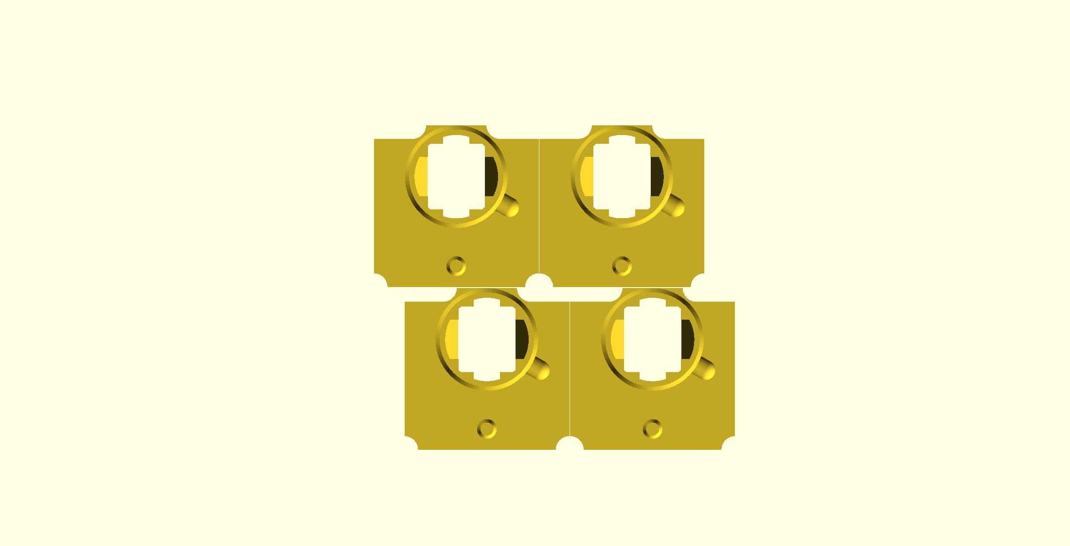

Busy couple of days... but I think I have a start at what @wcass mentioned previously. This is the modified barrel and flipper. Personally, this is an ideal state for legacy and future designs. It works with curved (legacy XT/AT plates) and would allow flat plate designs.
I just want to reiterate though that if we went down this path, our switch (barrel/flipper combination) WOULD work on any existing F. I would need to alter the "buttress" lock (name per @fohat) to be easily removable to work with both XT and AT legacy boards per @adamcobabe's suggestion... but that is one last easy fix. What the new barrel WON'T do is work with a legacy flipper because of the tension screw tolerance, but the new flipper would work with a legacy barrel. I am extremely content with this sacrifice, but it needs to be very clear to everyone. Reread the above if it didn't make sense (feels like a double negative, though it isn't :) )
Barrels overhead on a CURVED plane (ie...  our MF, and other F boards)
Screen Shot 2019-03-25 at 9.05.04 PM.png (131.81 KiB) Viewed 20232 times
Barrels overhead on a FLAT plane where the rows have to be tightened by ~2mm
Screen Shot 2019-03-25 at 9.06.17 PM.png (130.97 KiB) Viewed 20232 times
Barrels on a FLAT plane (~2mm row reduction)
Screen Shot 2019-03-25 at 9.06.32 PM.png (158.12 KiB) Viewed 20232 times
Barrel by itself with pride :)
Screen Shot 2019-03-25 at 9.07.39 PM.png (98.11 KiB) Viewed 20232 times

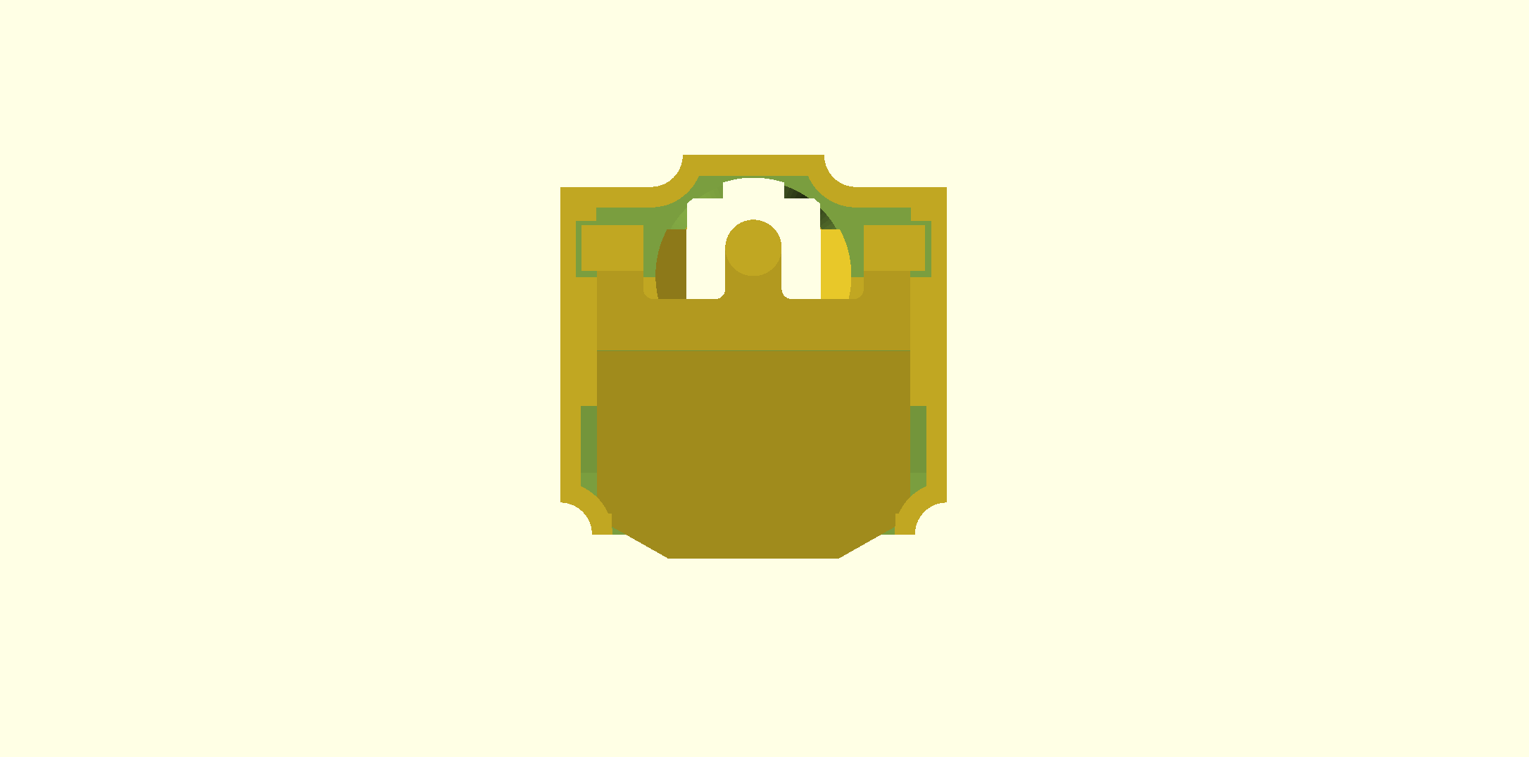

Switch from the bottom with new flipper
Screen Shot 2019-03-25 at 9.08.27 PM.png (77.61 KiB) Viewed 20232 times

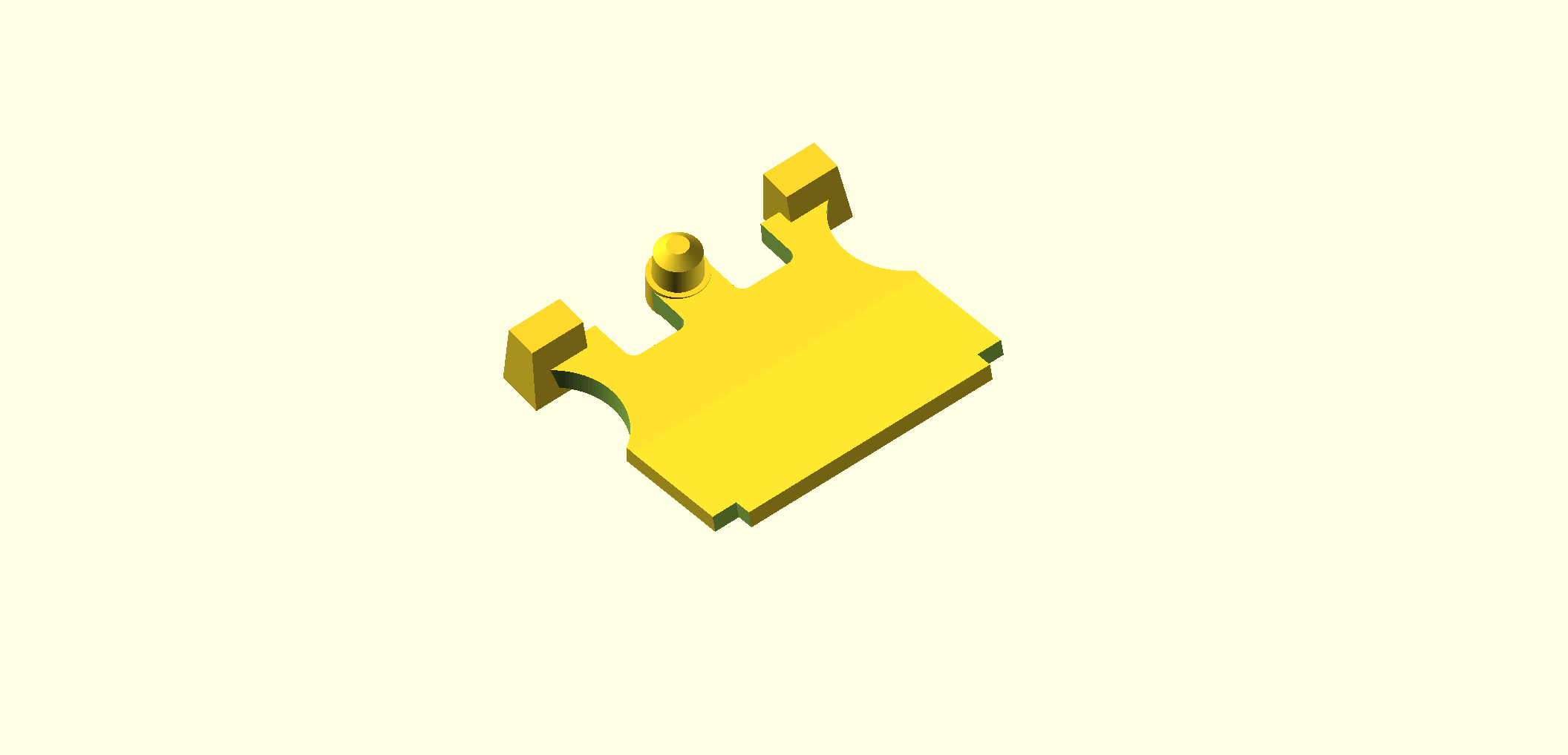

New "hourglass flipper" to allow for tension screws
Screen Shot 2019-03-25 at 9.09.57 PM.png (62.17 KiB) Viewed 20232 times

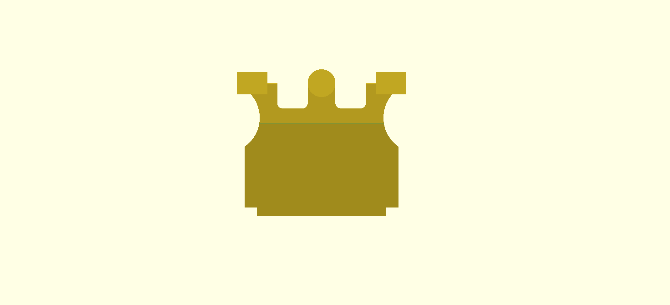

New flipper profile as seen directly from beneath
Screen Shot 2019-03-25 at 9.10.28 PM.png (50.4 KiB) Viewed 20232 times
Techno Trousers
100,000,000 actuations
26 Mar 2019, 04:26
To recap:
1. The new barrel and flipper combo will work together in any F, new or original.
2. The new flipper will work in a new or original barrel.
3. An original flipper will NOT work in a new barrel.
Moral of the story: to repair or replace the switch parts in an original F, you MUST buy at least a new flipper, with a new barrel being optional if you already have a legacy barrel for the location being repaired.
I think that this is a really clever design, and the single compatibility restriction of original flippers is quite reasonable. Having both the forward (flat) and backward (curved) compatibility with the new barrels is a huge bonus. I would actually like to stock up on some of these just in case of future repairs.
E TwentyNine
26 Mar 2019, 14:04
Why the notched corners at the bottom instead of the original diagonal cut? Minus the cutout, is the dimension the same, looks a little shorter.
I think with a little dremelling of the barrel an original flipper would fit, so long as you don't need the side screws (e.g. in an original board).
lot_lizard
26 Mar 2019, 16:03
@Techno... well worded. Much better than my drunken typing last evening 😂. Exactly as you say.
E TwentyNine wrote: 26 Mar 2019, 14:04 Why the notched corners at the bottom instead of the original diagonal cut? Minus the cutout, is the dimension the same, looks a little shorter.
It is ~1.5mm shorter. The notched corners are just to increase the contact surface area as much as possible. There are actually a small percentage of legacy F flippers that leveraged a notched corner design as well (seems like more of them came out of “blue switch” boards iirc). We could get rid of the notch altogether, but would need to remove the walls at the bottom of the barrel as well. They do a nice job of shoring up the “aircraft hanger door” at the front of the flipper (helping to keep it plumb under pressure). You can definitely take an existing legacy flipper and bring it down to this footprint. It just requires some effort as you mentioned.
The one bit I’m unsure of is it’s ability to reliably complete the circuit. Testing will tell, but we do have less contact area now on the PCB. This was the question for @DMA, @__red__, @wcass, and company earlier about if this even works. I am quite confident in it mechanically

On Cooler Master keyboards, both of these variations use Fn+F9 as the (left) Windows key lockout function. That's for gaming, so I'd just as soon not map it by default to prevent accidental activation, again unless someone else feels it's really important.
DMA
06 Apr 2019, 05:15
Techno Trousers wrote: 06 Apr 2019, 02:22 Since no one has weighed in on the "stock" CommonSense default bonus function layer configuration...
I would personally like to have the right side extra "Windows" key location between Alt and Ctrl mapped to a Fn type key, and the default layer for that could have media keys in the following locations. This would work for people used to some of the "standard" spots for these keys, and I don't see any reason why having both of these variations mapped by default would be an issue, unless someone else objects.
You no longer have to reflash to change layout. And for things you do - FC does that, no other tools required.
Windows key lockout.. I have some spare keycodes which can be taught to do that. But currently not supported.
