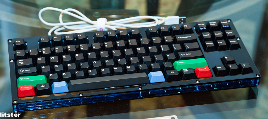

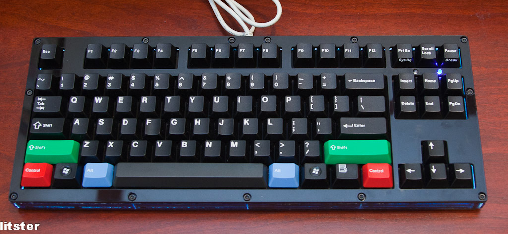

Phantom Acrylic Case V2-1.jpg (186.77 KiB) Viewed 6523 times
Phantom Acrylic Case V2-3.jpg (187.41 KiB) Viewed 6523 times
Sunken screws and nuts. But screws are too long. Where can I get custom length screws?
Any the case is not easy to put together. Very time consuming.

Nice!
trax
11 Dec 2011, 10:50
That looks epic !

Gilgam
11 Dec 2011, 11:39
Nice, i love the opaque top.
But aren't the borders to sharp?
Like some metallic cases i fear cutting my wrists on the borders.
I do so on some macbooks.
litster
11 Dec 2011, 18:23
No, not sharp at all. In fact, some parts are rather rough. I think that is because of the laser cutter I use. Professional ones should cut better with more powerful and straighter laser. I have some blacks screws coming in on Monday from mcmaster.com.
As nice as this one looks, I think I will need to go back to non-sunken screws and may be use acron nuts, unless you guys don't mind gluing a layers together yourselves and cutting your own screws. Actually you might need to cut your own screws either way. Or, I will have to design the case based on popular screw lengths (3/4 inch, 1 inch, 1 1/4inch).
The case looks better in picture then in person though. May be because I made it, I see flaws everywhere... :(

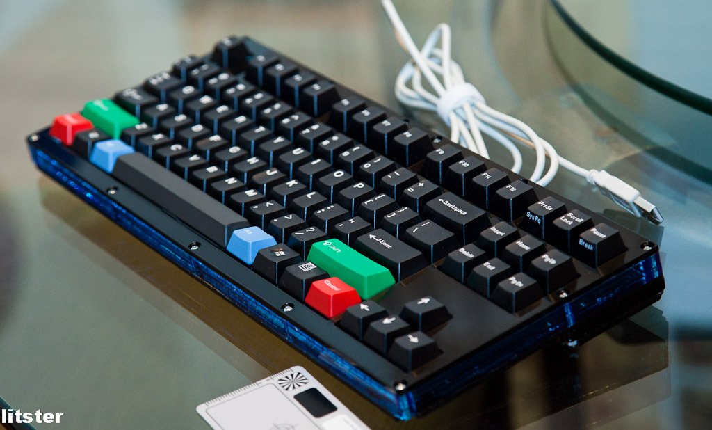

With sunken, black-oxide hex cap screws:
Acrylic Case Blue-2.jpg (169.28 KiB) Viewed 6372 times
The piano black finish does attract finger prints though.

15 Dec 2011, 01:46
Do want do want do want!
Finally, a fantastic use for a set of shiny doubleshots! (not that yours are, I can't really tell, I just mean that I think that shiny ones would look even better than new ones on that board.)
