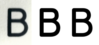

This latest round of revisions to the Beam Spring font came out of some template techniques I worked up while doing the F XT Quality repro legends for the Ellipse project. I now had a pretty accurate setup for getting all the stroke widths the same so I went about fixing things. I had just assumed that whatever kind of engraving machine IBM used to make the molds would result in consistent stroke widths but I started noticing stuff like this after fixing up the characters.
Beam Spring B comparison.PNG (50.29 KiB) Viewed 10991 times
The left B is from the original scan from lot_lizard. The middle B is what things look like when you make all the strokes equal. Looks pretty good but the openings seem a bit small and the horizontal strokes now look too heavy when you compare it to the scan. When the horizontals are made a bit thinner, things start to look better as shown in the B on the right. Looking at the other characters with horizontal elements, I became convinced that I wasn't just seeing some distortion in the scan. This was how they were designed... like a real font.

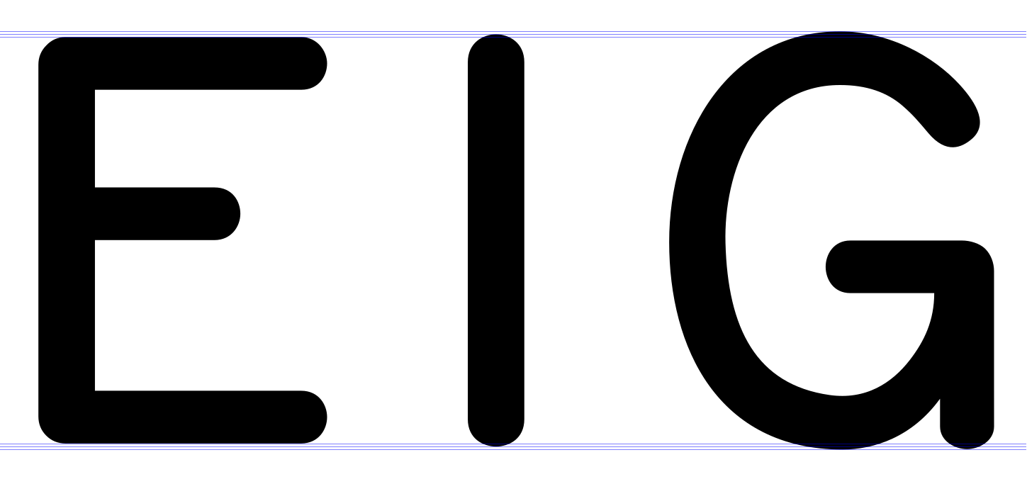

The overshoot is something I am not as sure about since it is very difficult to get exact height measurements given the resolution of the scan I have to work with. The fuzziness around the edges of the letters is pretty much the same thickness as the amount the overshoot would be so it becomes a judgment call. Given the confirmation of the horizontal strokes being thinner, I decided to go with it. If they went to the trouble to use the horizontal stroke trick, there is no reason why they would not also incorporate overshoot. If I am wrong, it is pretty harmless and at least it makes the letters look like they are equal in height.
Beam Spring overshoot 2.PNG (2.4 KiB) Viewed 10991 times
When we zoom in a bit, it looks like this.
Beam Spring overshoot 1.PNG (32.88 KiB) Viewed 10991 times
There are three different heights and three baselines to account for the flat stuff, the rounded ends and the big curves. Will any of this make a difference with letters that are less than 10mm high? I don't know, but I look forward to finding out.

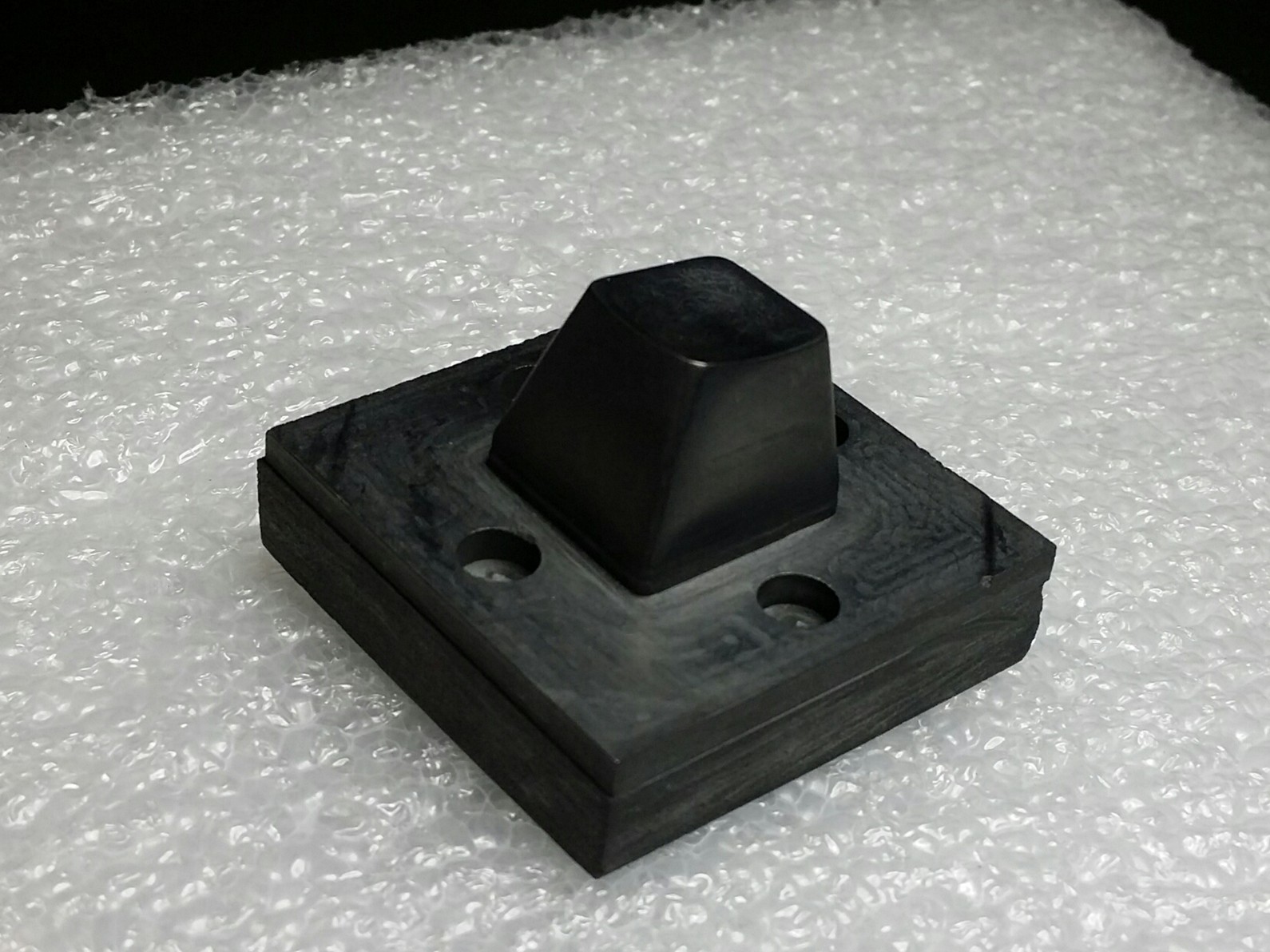

Sorry for not updating, I haven't had much to update on. Real life has demanded a lot from me over the last few weeks as it has for my son. Now for some good news, We have started the millwork on the die sinks for production tooling, this is actually a very big deal. Attached is a picture of one of the dies for the single unit keys. We plan on setting time aside to get some traction this week so hopefully there will be something more substantial to report soon.

If you're working on production tooling, does that mean the prototypes all went well, or is this work that's not specifically related to the shapes of the molds?

Techno Trousers wrote: If you're working on production tooling, does that mean the prototypes all went well, or is this work that's not specifically related to the shapes of the molds?
There is more to the production tooling than just the mold cavity itself. All the caps excepting the space bars use the same mold base. The die you see above is for a 1u cap and will be used to produce a cavity insert for the caps in the evaluation sets (prototypes). Because this project is intended to be a direct replacement for an existing profile I'm not expecting there to be any serious issues and the initial tooling will likely rollover into use for the production sets. To be safe we are focusing on just the 1u cap right now, but all the tooling engineering will carry over to the rest of the keycaps. The mold cavities will be replaceable and if we need to make any changes we won't be starting over from the beginning. This approach is going to help keep costs down as we tool up.

So cool! Thanks for the detailed explanation.
