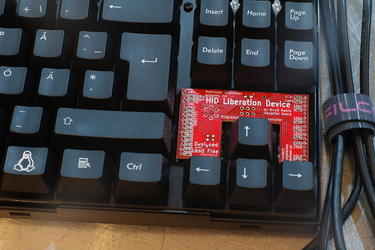

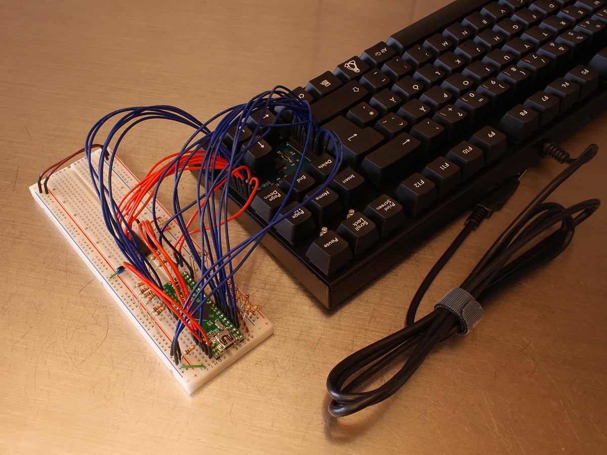

I'm pretty sure all the different tenkeyless models use the same main PCB. There are switch locations for the Japanese layout as well.
The picture I haven't posted here on DT yet.. My brand new test board is an ISO one =)

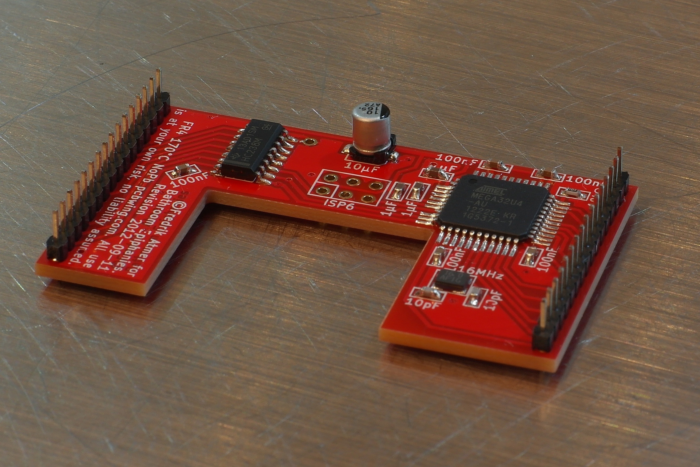

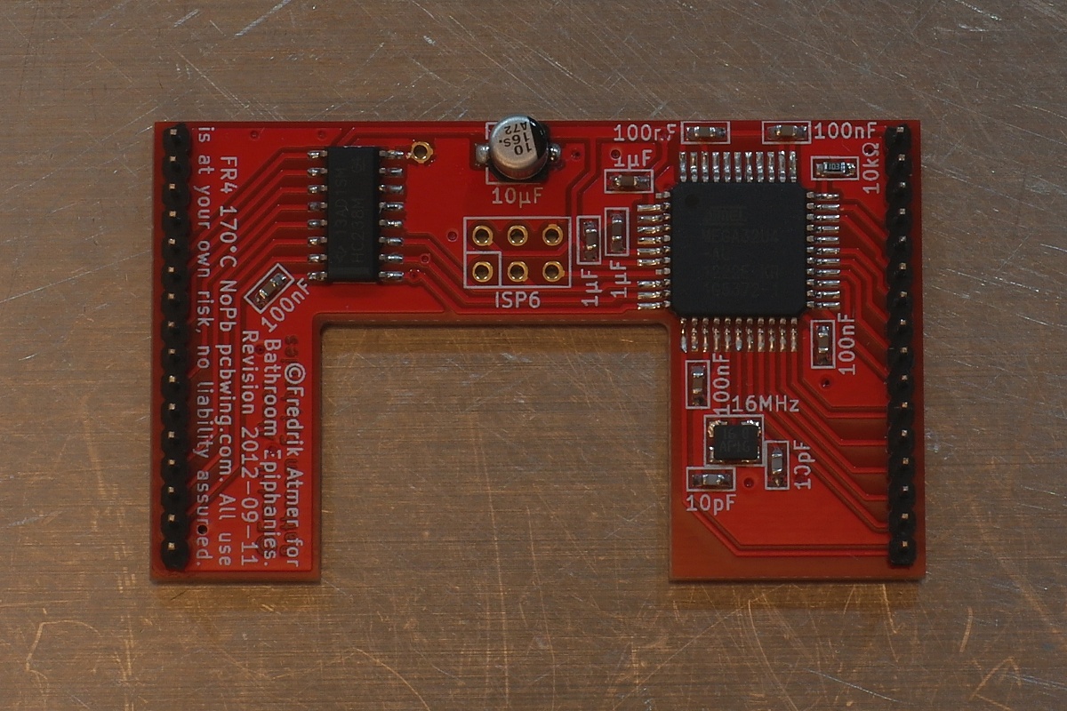

Boards came in today =D I put one together, discovered I had botched up the firmware I had up and running on the prototype, spent all afternoon re-writing the firmware... But now at last it's all in working condition. I'm typing this post at the first finished controller!

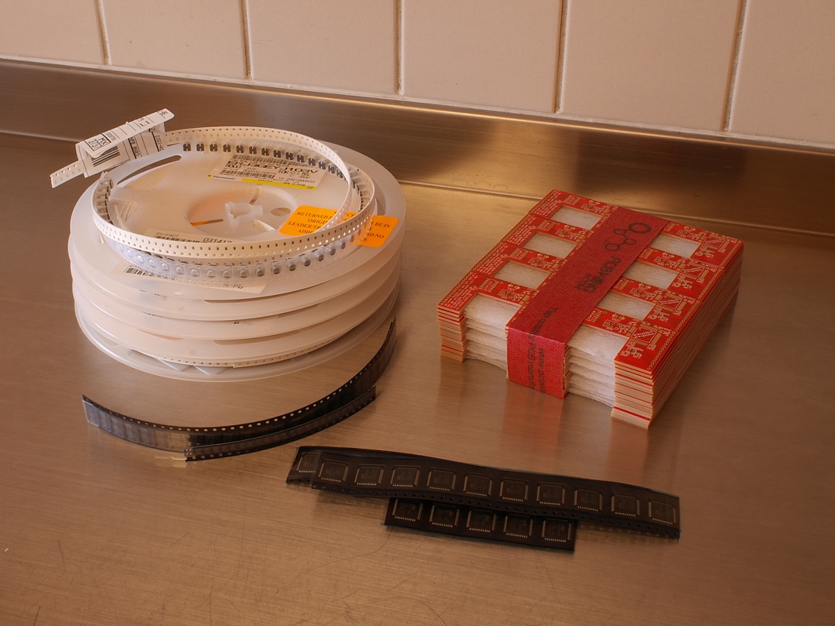

Controller porn There will be enough for everyone, more than 100 PCBs, and those are 15000 resistors, 4000 capacitors, and some other goodies. There seem to be a bit of a drought on ATmega32u4s at the moment though. But they should be coming back in stock in a month or so. I've got 50 to work with for now. Some of them I will need to re-program to run at 16 MHz instead of the 8 MHz they are pre-programmed to run.

For me ;)litster wrote:Awesome! What is the ISP6 for?
Nah, you never know when it's going to come in handy... I will use it to change the fuses on the second batch of controllers I got. They are pre-programmed to run on the internal 8 MHz clock source. But it is simple enough to change that via ISP.
Changing the bootloader requires an external programmer as well. I will need to change it on the ones I change clock source on. It will not run at the changed speed. So they will have to do with the LUFA bootloader. I think I will leave the Atmel one on the other ones though.
Edit: Also the reset pad is one of the ISP pads. I didn't add any other. The pad next to it is GND so it is easy enough to just short them out. I probably should have added instructions on the silkscreen =P I managed to do the silkscreen in reverse on the only electrolyte capacitor as well... They blow up if mounted the wrong way. Other than that it's only the larger chips that need to be mounted in a correct orientation.
