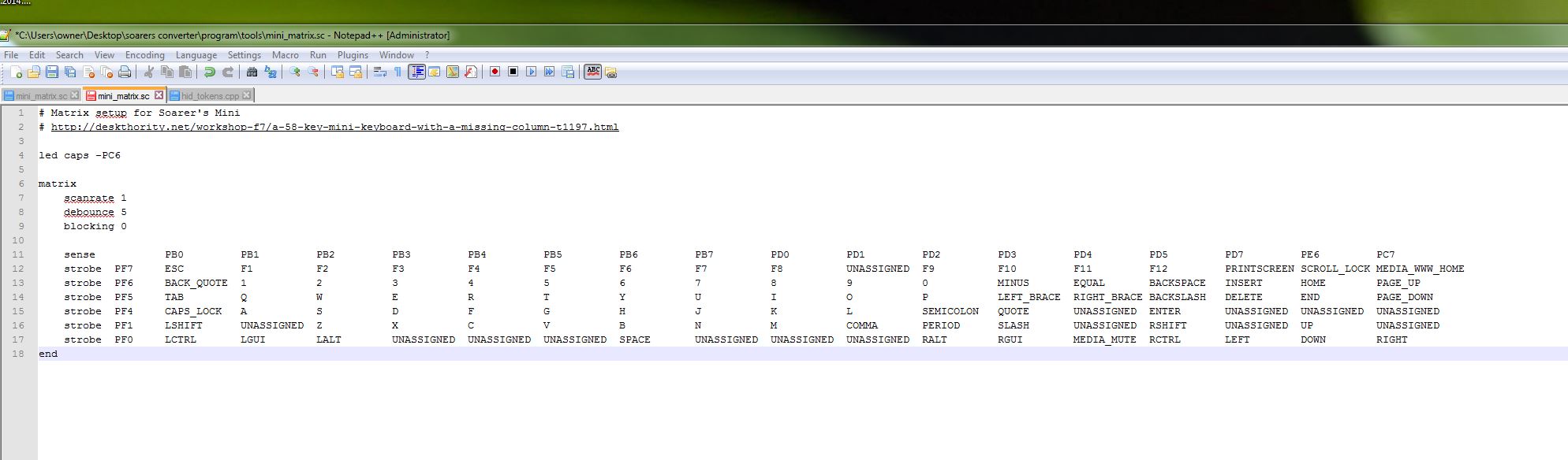

Hi guys, i have a probably idiot question for you.
I am trying to make a teensy firmware to control my dell at101w.I hand wired it, removed pcb etc so its not a dell anymore
I want to try the soarer's fw but i dont understand how to write the hex file?
I can find the beta 4 firmware but dont i need to make changed to it? How do i do that?

Edit: I did the trick and flash the teensy but only the first line of f1,1,q,a,z,windows key (matteo wiring) works.
Maybe sense is not columns but rows?
This is what my matrix looks like
