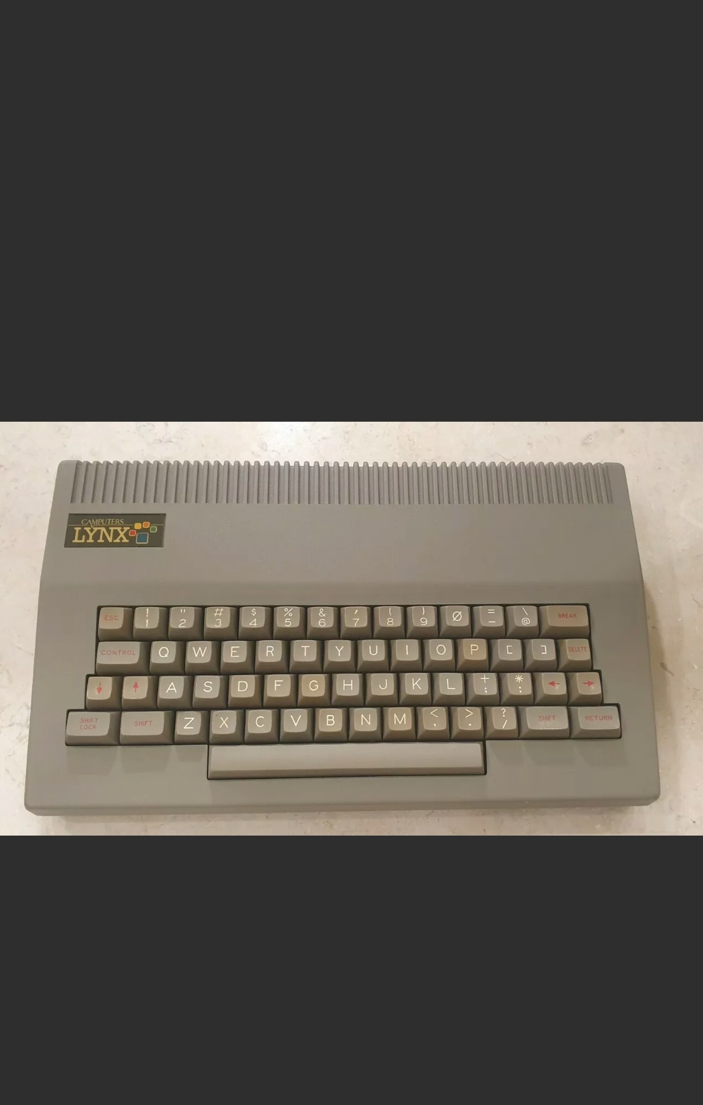

They look like Mitsumi Miniatures.skorpionrazor wrote: 17 Jan 2021, 03:31 Hi. I've seen this on sale and looks like a keyboard that I had when I was a kid. Do you know what kind of switches are these? Looks like Cherry Mx but I'm not sure. Keyboard company is Sunshine.

Makes sense, model says "Made in singapure". Thank you

Looks a lot like a Fujitsu Peerless, but it's not. Kinda cool looking. I don't think that "Menus" key is original.

Now that you mention it, the "Menus" and blue keys all look different from the rest. They're all cylindrical while the rest are spherical. It's just a weird oddity of a keyboard, but also more than I'm willing to pay without knowing the switches.

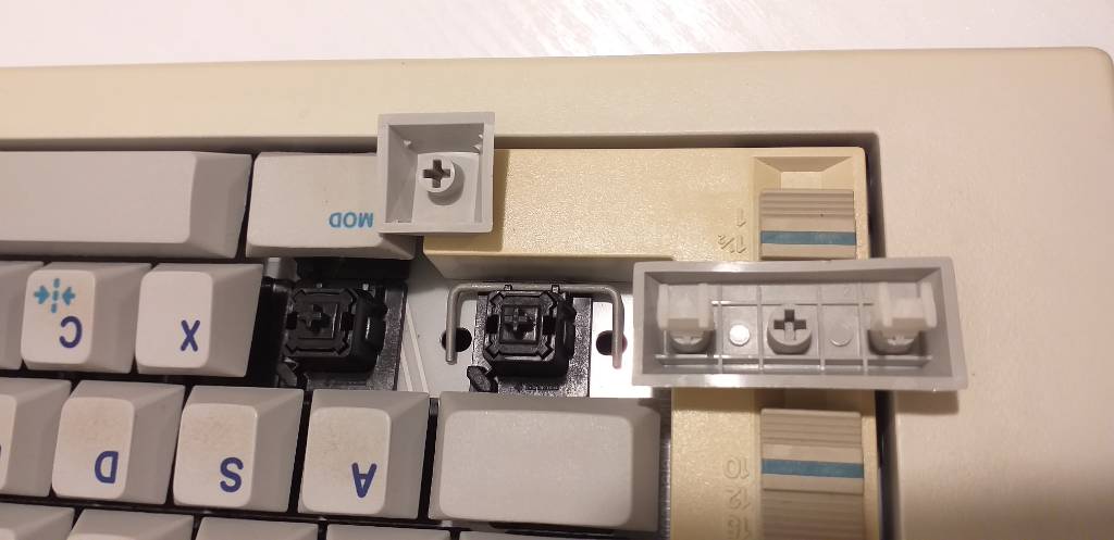

Hey guys,
are these MX linear (Olympia) clears or maybe MX linear (Olympia) white Switches compatible with standard plate mount Keyboards. Same question for the keycaps. I´m not sure because when I look to the deskthority-wiki it seems, that these Switches have minimal different dimensions. Is this problematic or will they fit into regular plate mount keyboards?
wiki/Cherry_MX_Olympia_Linear_Clear
- Olympia.jpg (695.21 KiB) Viewed 8958 times
- zrrion
- Main keyboard: F122
they fit into the plate just fine, but caps will have clearance issues. If you really want you can just swap the sliders into some vint black housings and this will fix the cap clearance issue without effecting the keyfeel
Thanks zrrion, but what do u mean exactly with clearance issue? Do u mean, that the keycap could hit the top part of the housing when it´s pressed 100% down? If this is the case, could O-rings may counter this a bit because with O-rings cap won´t travel full distance down?

Yes, the housing would hit the underside of the switch. O rings probably would help but I don't think anyone has tried before so I can't say for sure.
Thanks for your help, so I think I will try
I have possibility to get 3 old typewriters with linear MX Clear.
Your idea that I could put just the slider into a vintage black housing sounds also nice. Must it be a Vintage black or does normal mx blacks also work for this?
And last question: Is there a interest in linear MX Clears here? I asked bcause I think about to sell 1 or 2 sets here.
As far as I know, they are really rare and can be found only in 2 AEG typewriter models, isn´t it?

any MX housing should work. vintage cherry housings would be the closest to the housings they normally have
Thanks dude, so I think I will give it a try and play a bit with the parts to see, what will work and what will not.
I´m also excited about the keycaps from the typewriters. It´s a bit tricky, because some modells from AEG have this uncommon "rounded" Caps, but there are also models, which seem to have some caps which look at least similar to the OG PBT dyesubs from old Cherry boards.
Maybe it´s similar stuff like the caps from some old Triumph Adler typewriters, which are also Cherry PBT dyesubs. One set I have already put on my Filco Minila Air for the alphanumeric keys. Really nice and thick caps, I hope the caps from the AEG typewriters are also like this. For the moment I know they are thick PBT, but I don´t know, if they are dye sublimated or "just" pad printed or laser engraved. We will see

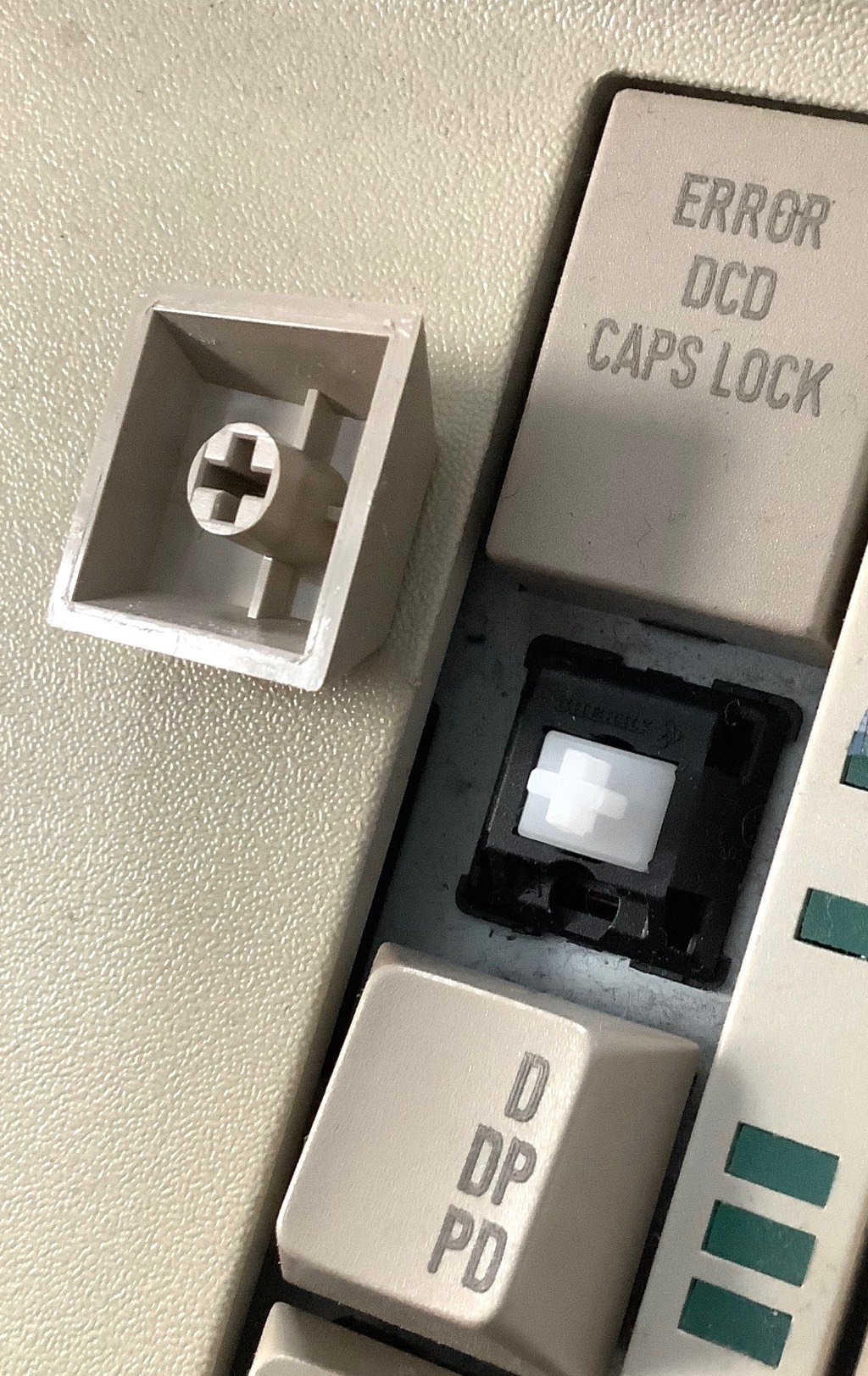

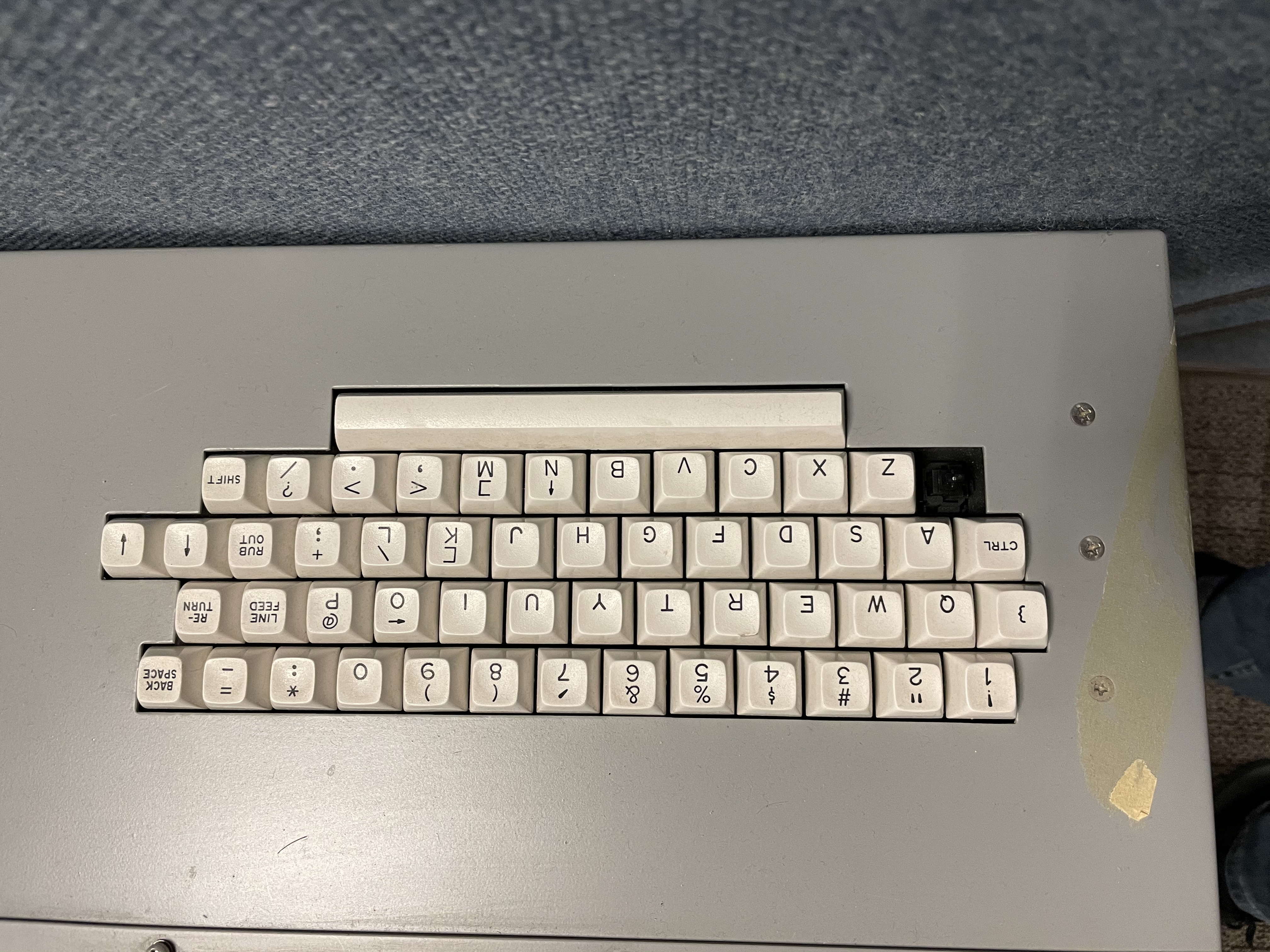

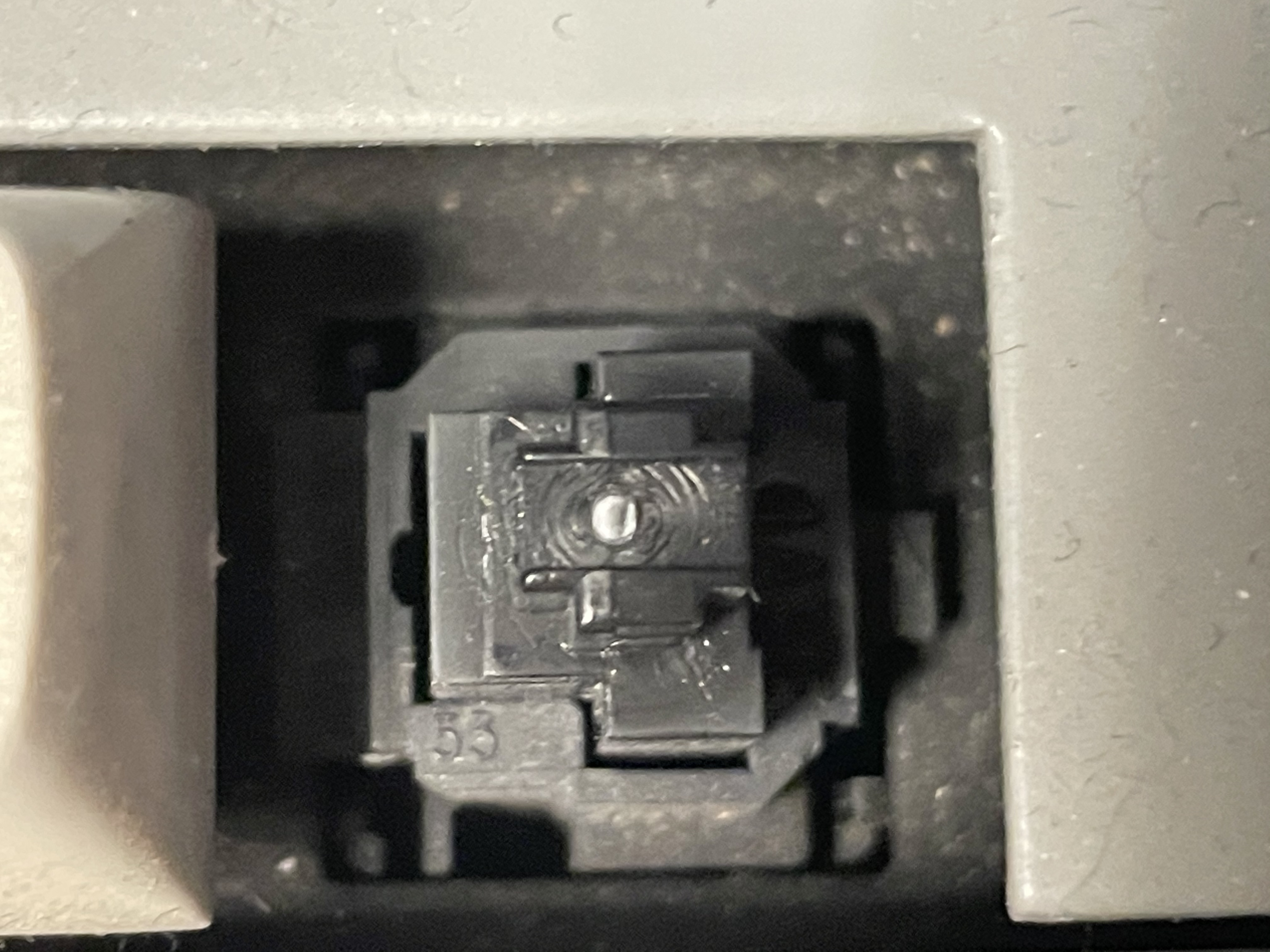

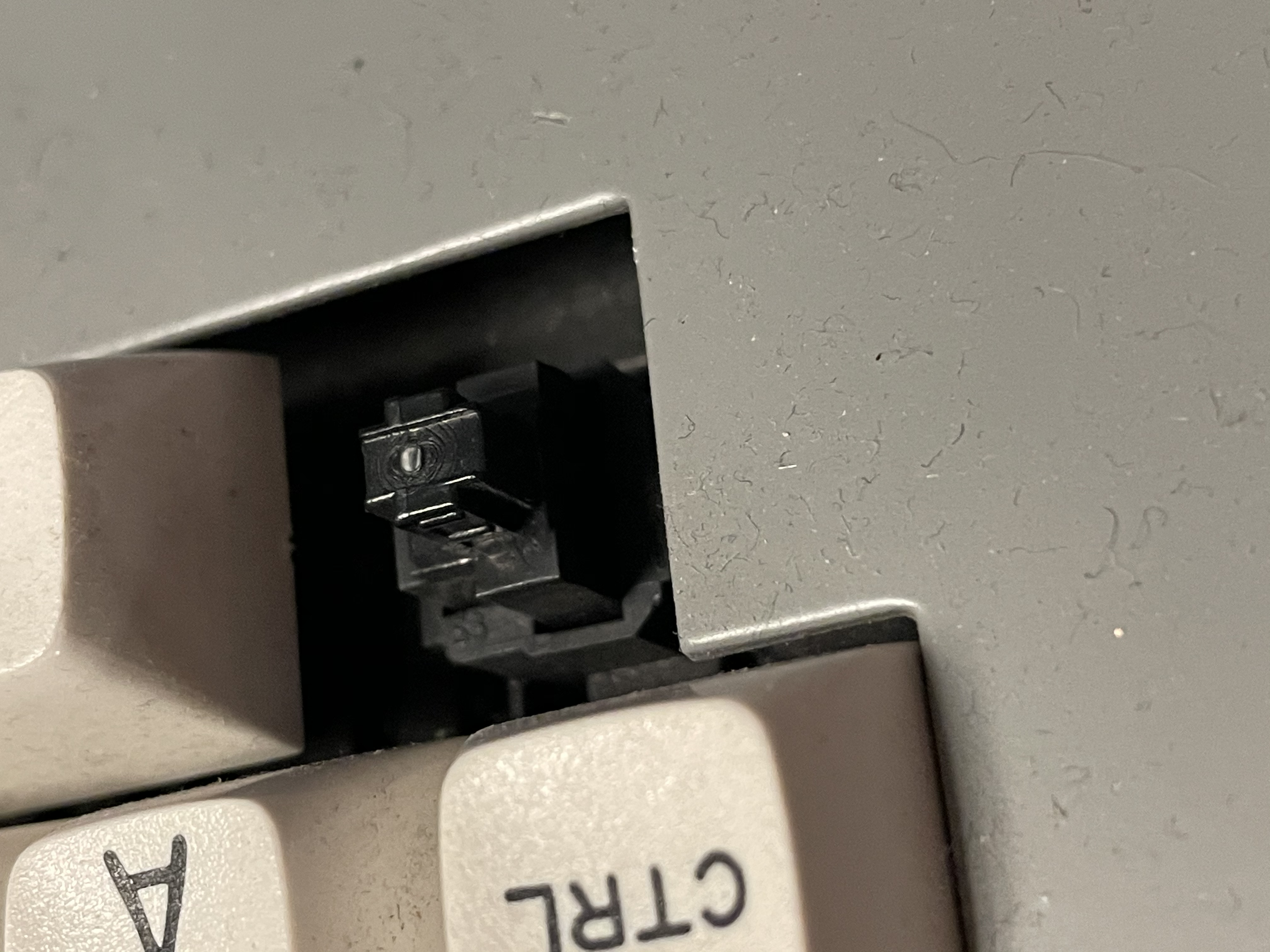

Wondering what kind of switch this is...
This is a Toshiba Satellite T series laptop. Externally in poor shape.
(Apologies if any of my formatting / approach is poor- haven’t posted much on here!)
- 4911ACF2-70FF-4530-808C-AB985A83C1CC.jpeg (3.01 MiB) Viewed 8645 times
- F51F18EF-389F-4E70-92B2-770441F2728D.jpeg (2.94 MiB) Viewed 8645 times
- zrrion
ALPS KFNR: https://telcontar.net/KBK/Alps/KFNR

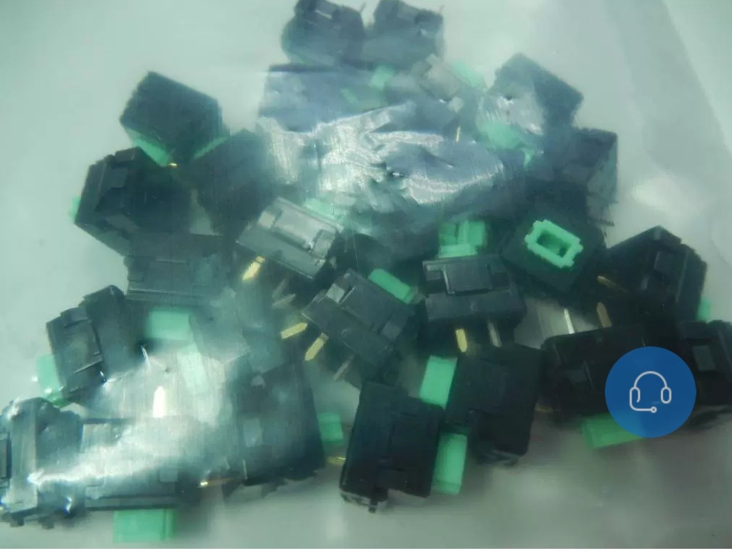

Those are clones of some sortLazerCat wrote: 07 Feb 2021, 01:48 Found these on TaoBao. The listing says they are original alps switches but I can't tell from the picture. Need help confirming![]()

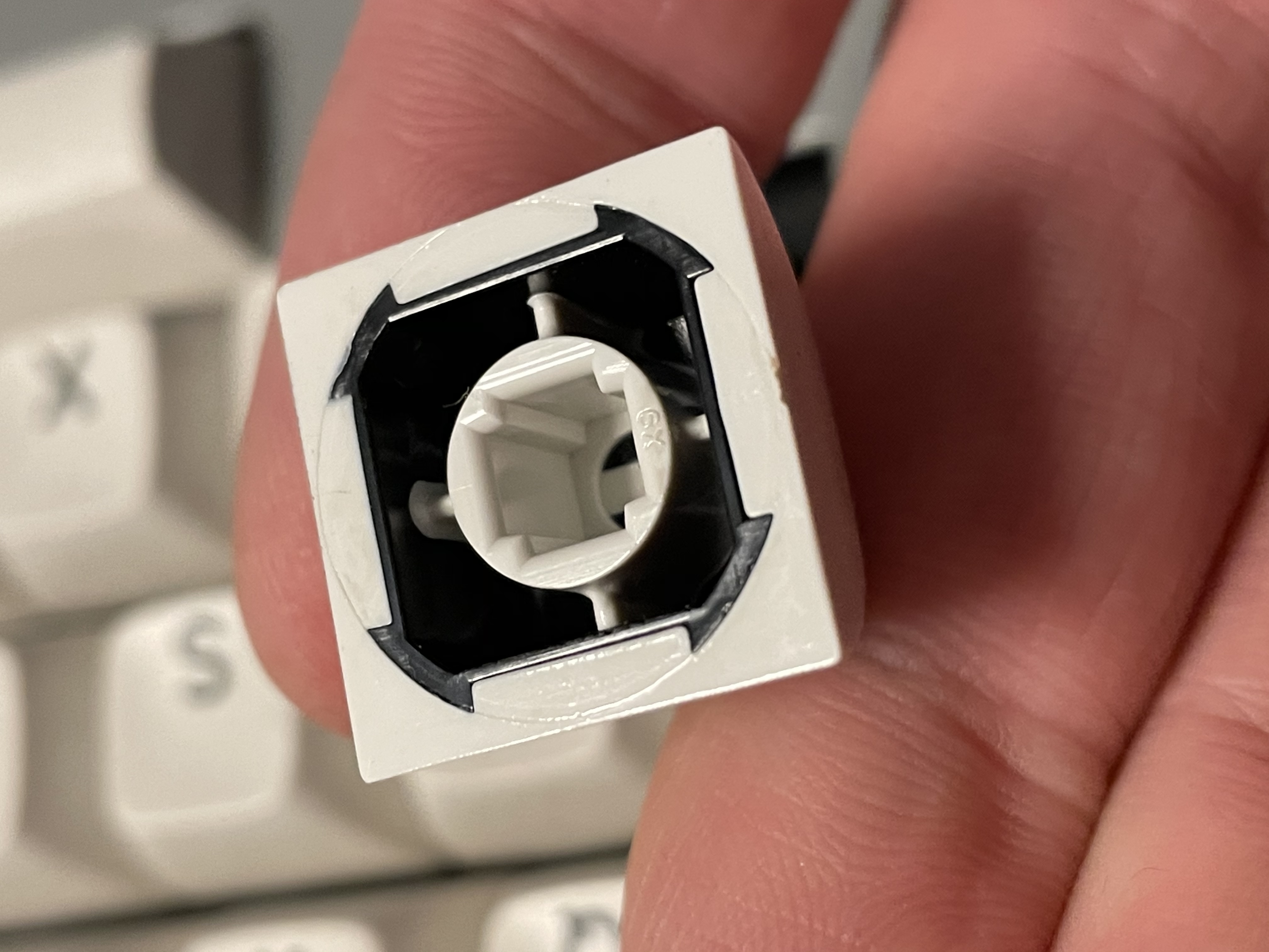

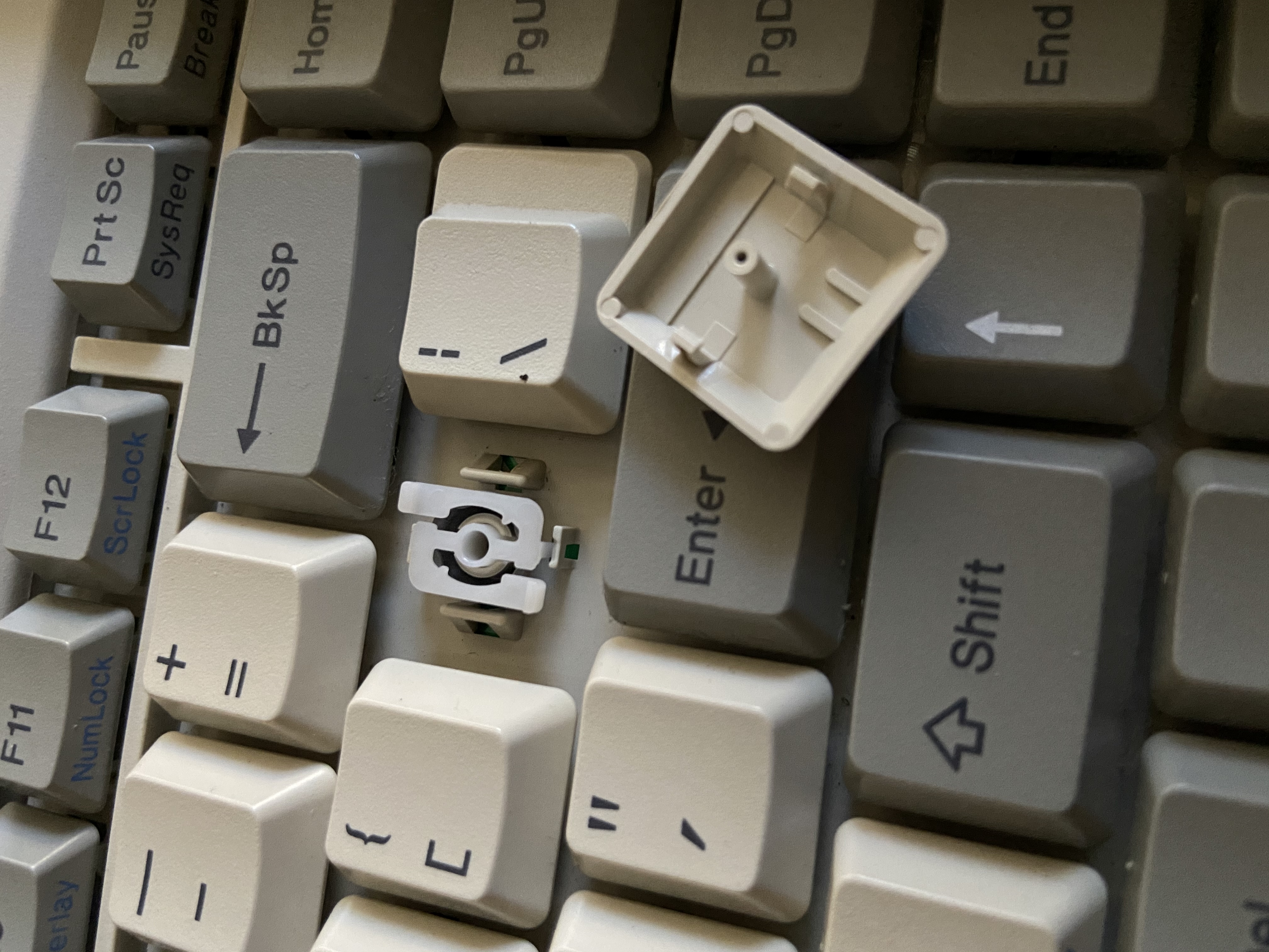

I’m curious of anyone can identify this switch. The attached pictures are from keyboard installed in an old military simulator that’s been gutted. The switches are linear and a little heavy. I’m trying to see if I can take the keyboard before it’s trashed.
- 9BF5F22A-FB57-4652-88FF-908B71F840AF.jpeg (1.64 MiB) Viewed 8222 times
- 6C348263-236A-4B80-AD17-40DF5FE99AFC.jpeg (1.59 MiB) Viewed 8222 times
- 1ADACF1B-C162-4310-AE96-3265AA4FC28F.jpeg (2.03 MiB) Viewed 8222 times
- 020CEA42-5744-4DFE-9AF8-6C8FA0004661.jpeg (4.65 MiB) Viewed 8222 times
Common microswitch SD variants.
thefarside wrote: 08 Feb 2021, 03:23 I’m curious of anyone can identify this switch. The attached pictures are from keyboard installed in an old military simulator that’s been gutted. The switches are linear and a little heavy. I’m trying to see if I can take the keyboard before it’s trashed.
- thefarside
Thanks!Amontillado777 wrote: 08 Feb 2021, 03:30 Common microswitch SD variants.thefarside wrote: 08 Feb 2021, 03:23 I’m curious of anyone can identify this switch. The attached pictures are from keyboard installed in an old military simulator that’s been gutted. The switches are linear and a little heavy. I’m trying to see if I can take the keyboard before it’s trashed.

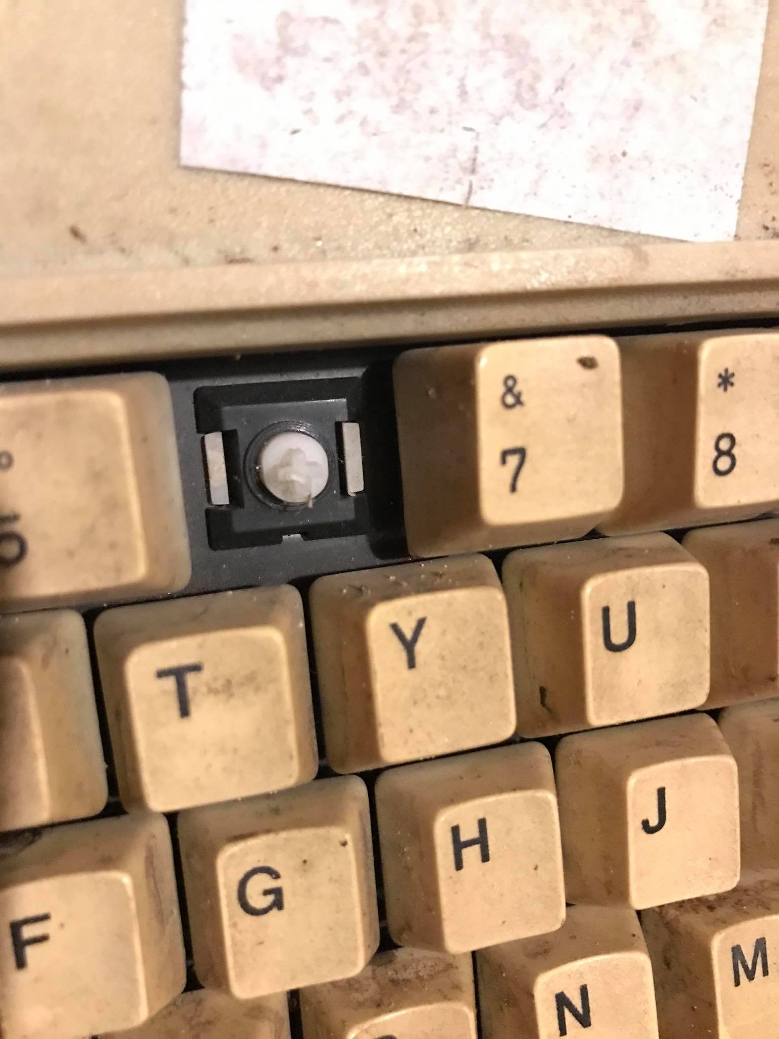

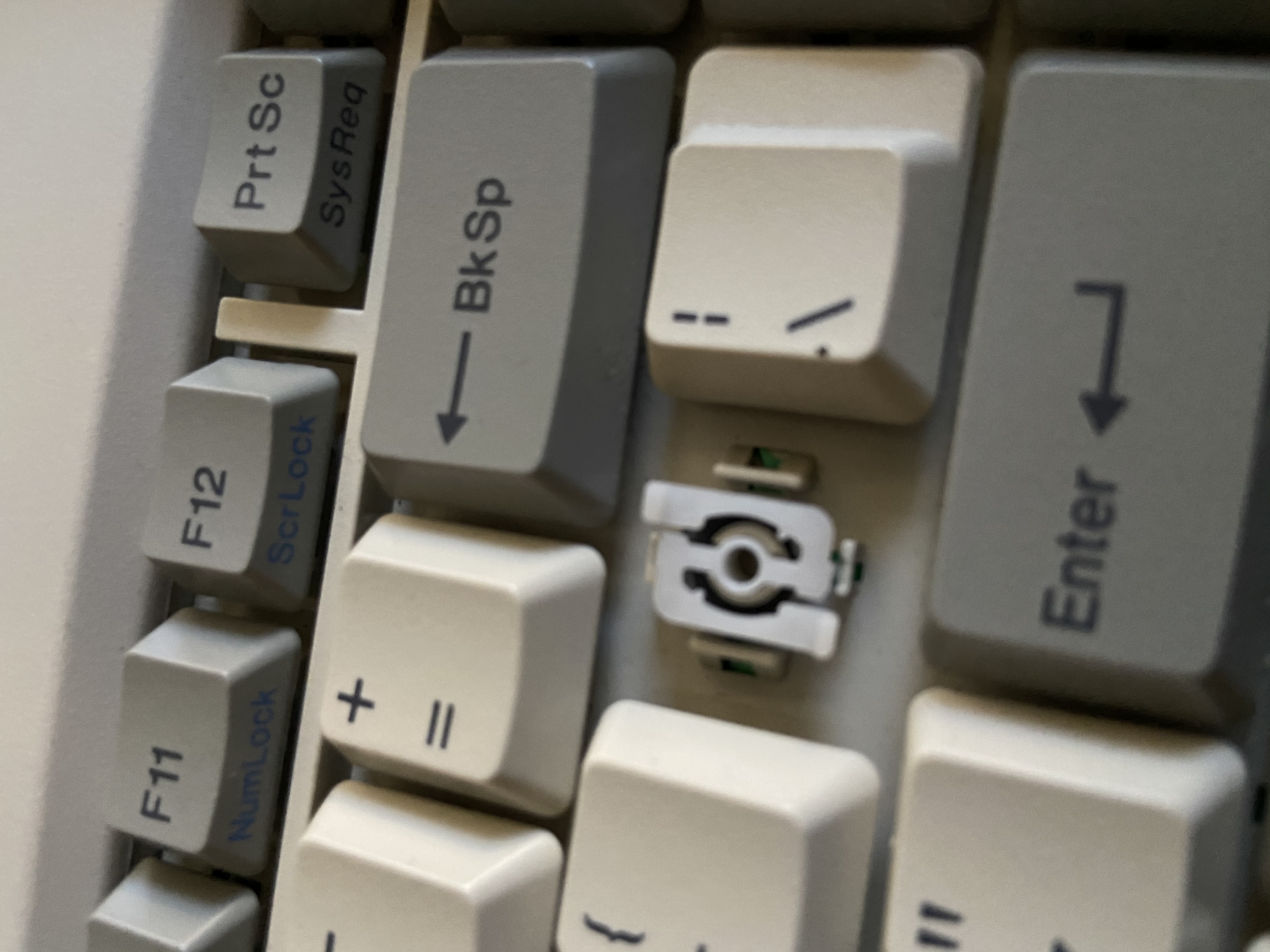

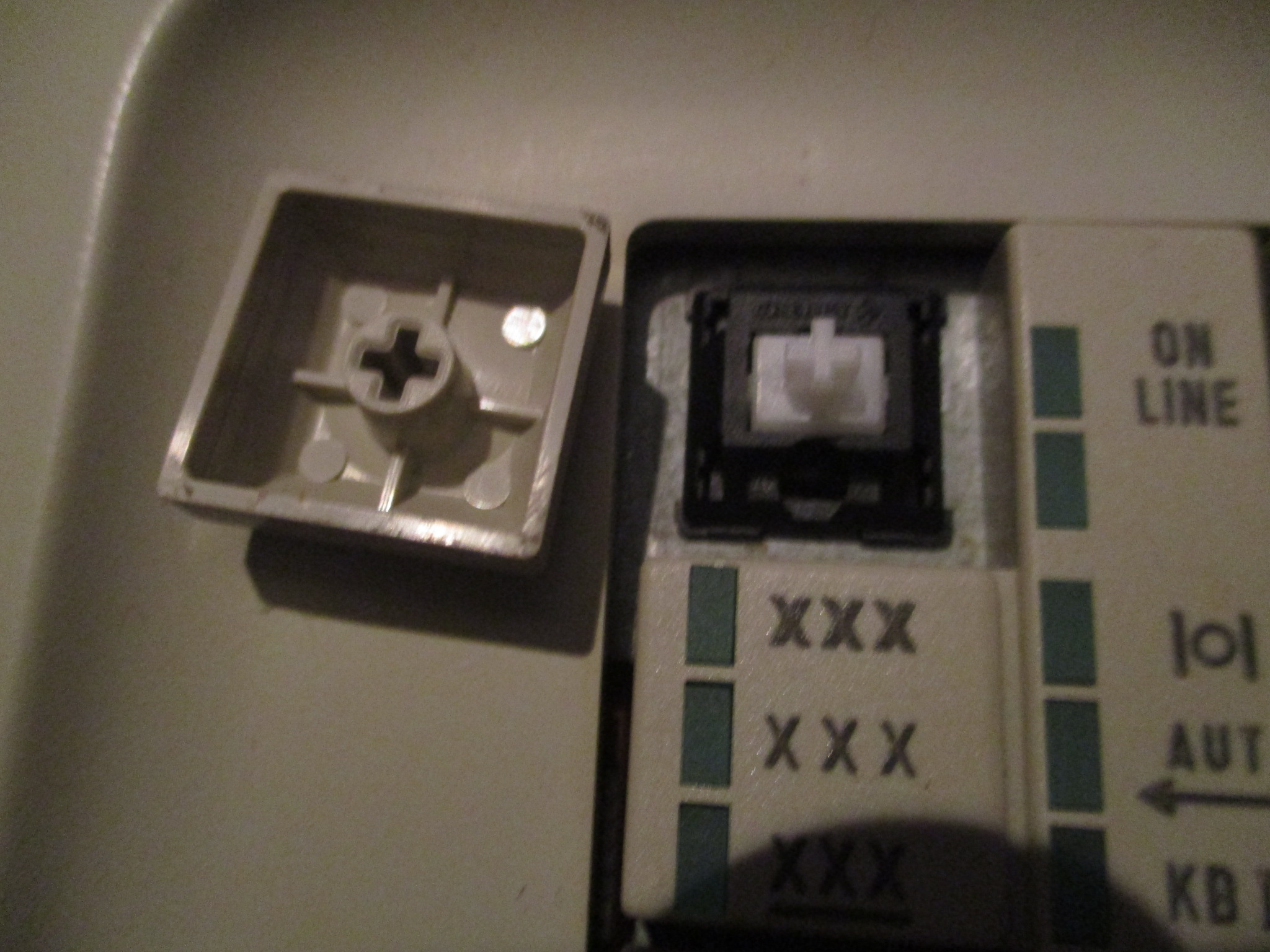

Hi there.
What is this? I can seem to be able to identify it here: wiki/Switch_recognition
The dude says it's linear.
- TNT
- DT Pro Member: 0250
I'm not an expert, but it kinda looks like SMK- or NEC vintage linear with a different slider colour ...
Sry, I misread can for can'tLynx_Carpathica wrote: 10 Feb 2021, 20:17 Hi there.
- Location: Stockholm, Sweden
- DT Pro Member: 0011
A variation of the Ericsson switch. Look here: viewtopic.php?f=62&t=9821&start=30#p208611

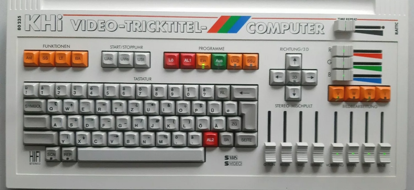

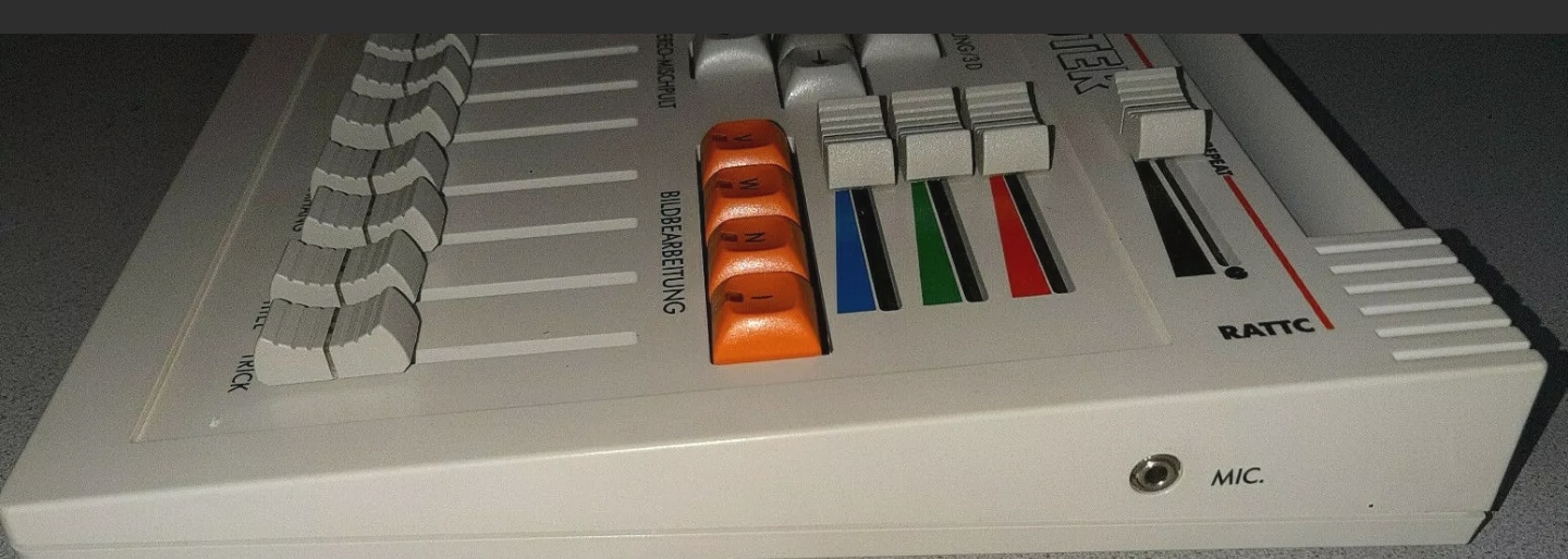

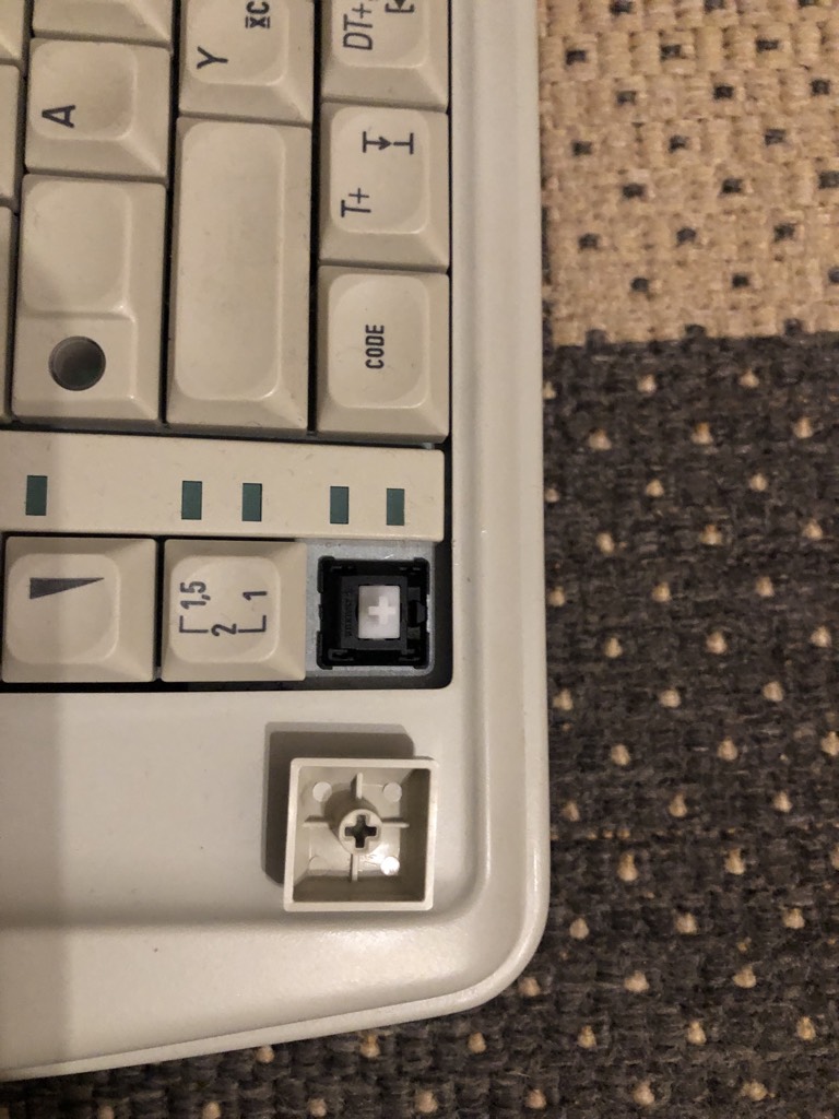

Hey found this two online and wanted to ask if anybody knows what switches they use
Thx!!
Thx!!
- Screenshot_20210221-201738__01.jpg (191.95 KiB) Viewed 7853 times
- Screenshot_20210221-201735__01.jpg (255.16 KiB) Viewed 7853 times
- Screenshot_20210221-201730__01.jpg (242.44 KiB) Viewed 7853 times
- Screenshot_20210221-201452__01.jpg (256.56 KiB) Viewed 7853 times
- Screenshot_20210221-201450__01.jpg (234.36 KiB) Viewed 7853 times
- PlacaFromHell
- Location: Argentina
- Main keyboard: IBM 3101
- Favorite switch: Beamspring
Considering the first one is german and also has spherical keycaps, I would say RAFI hall effect.Lalaland124 wrote: 21 Feb 2021, 20:18 Hey found this two online and wanted to ask if anybody knows what switches they use?
Thx!!
- kbdfr
- The Tiproman
- Location: Berlin, Germany
- DT Pro Member: 0010
Considering the position of the LED window, I would rather think it has Cherry M8 or M9 switches. I once had a video editing board with quite similar keycaps (except they were black on white).PlacaFromHell wrote: 22 Feb 2021, 00:23Considering the first one is german and also has spherical keycaps, I would say RAFI hall effect.Lalaland124 wrote: 21 Feb 2021, 20:18 Hey found this two online and wanted to ask if anybody knows what switches they use?
