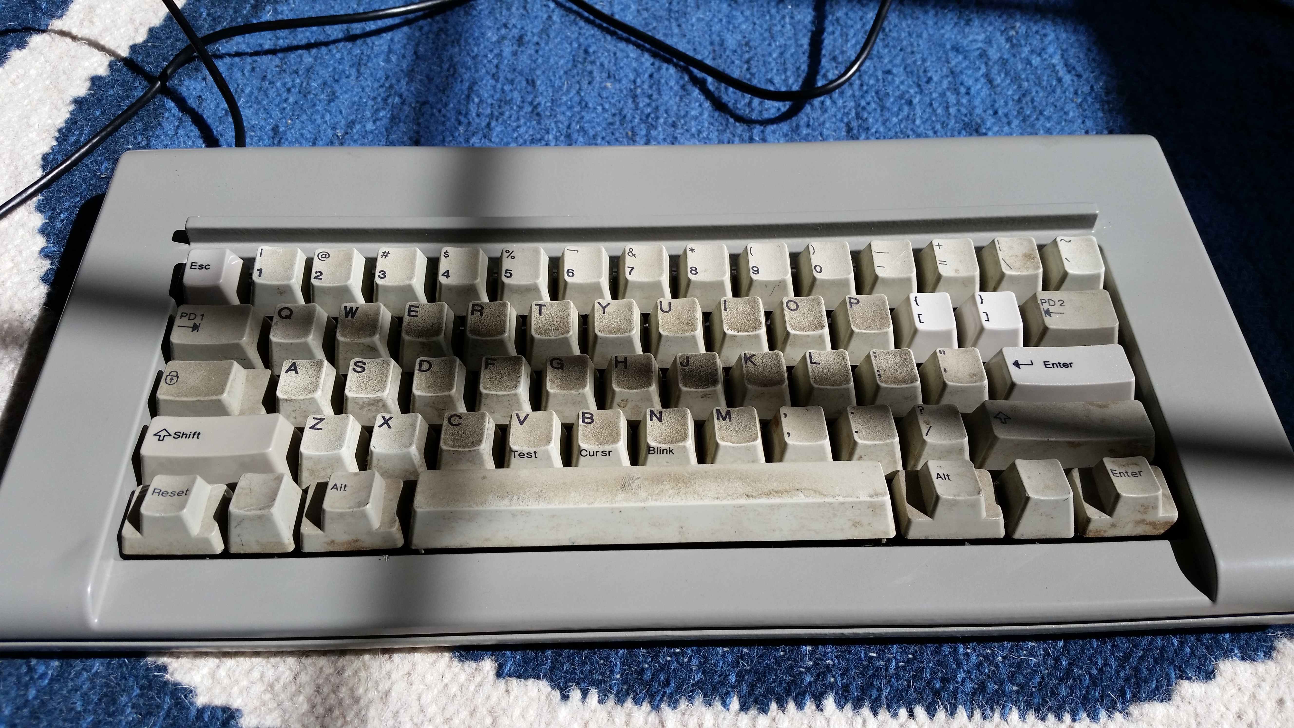

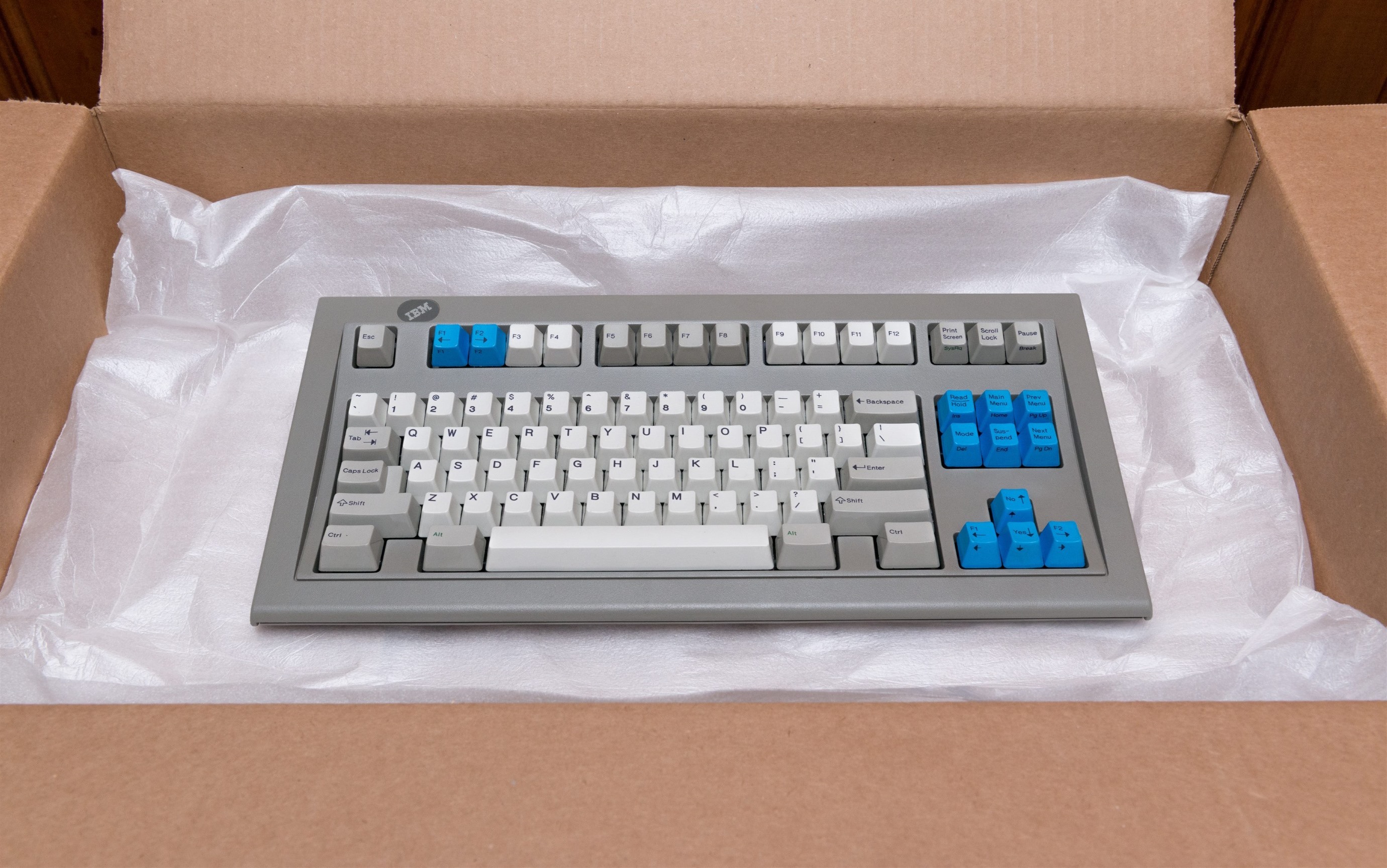

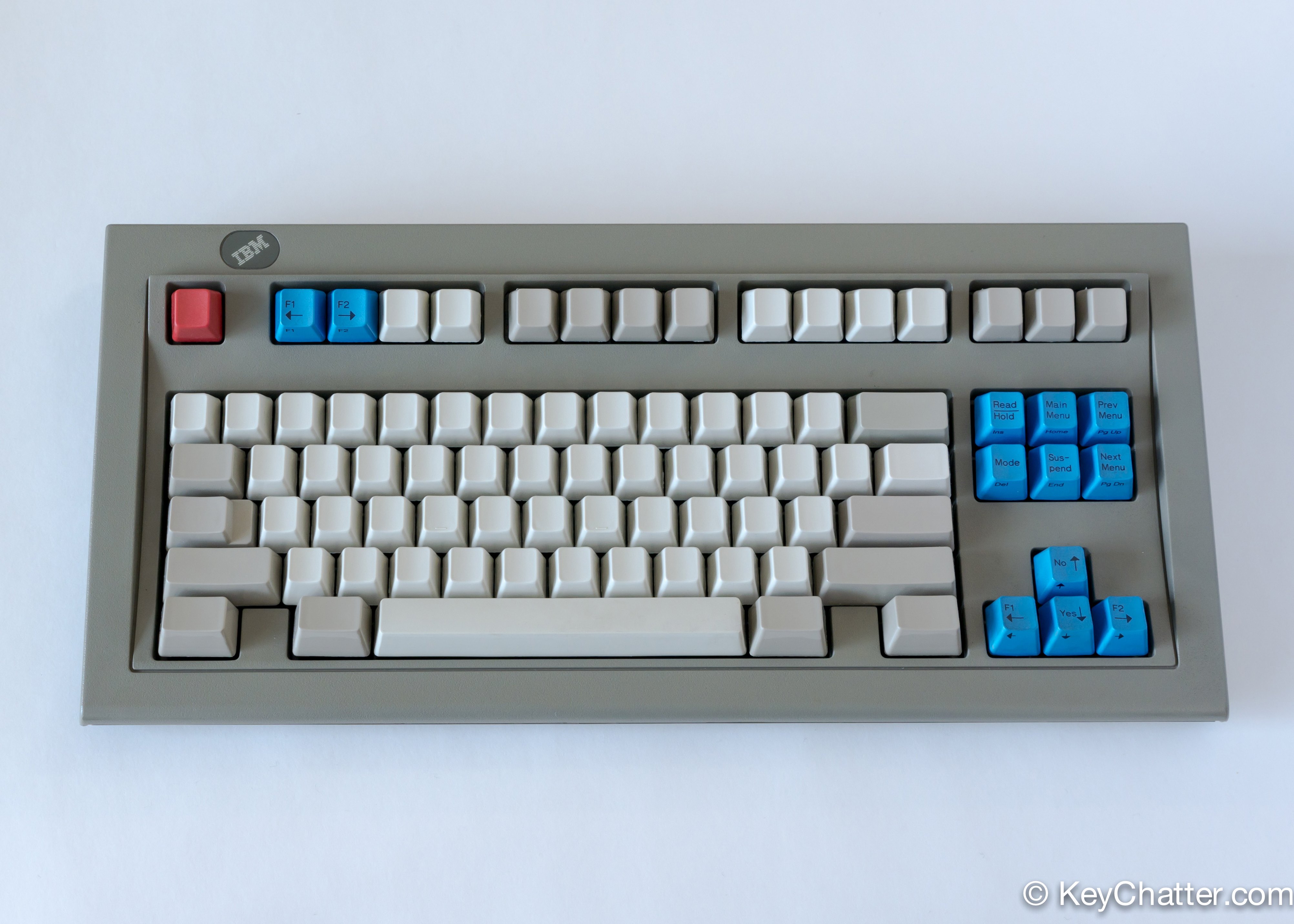

Hey Ellipse,
you said the Industrial color will be something like RAL 7030, and you said it will look approximately like you Industrial SSK.
Industrial SSK:
Industrial SSK for sale.jpg (982.34 KiB) Viewed 6705 times
Industrial SSK (keychatter.com):
RAL 7030 (dorkdaver's photo):
Industrial grey.jpg (991.37 KiB) Viewed 6705 times
You grey looks much darker then his though, or is it just the photo or my eyes?

They've really got to be in the same photo to compare.

Can it make such a "huge" difference if there are not in the same photo?
23 Aug 2015, 15:37
Yes. A camera will even gladly make bright white look like custard yellow in different light. You can't tell anything without controlled conditions.
Ellipse will have some good pictures I suspect.

Yeap.
For one, the last pic is under direct natural light, and the others either artificial or diffused natural.
Diffused light picks up any color cast the surrounding environment provides.

The industrial color is very hard to catch on photos. It always looks different than in real.

Confirmed - RAL 7030 will be one of the powdercoated color options for the F77 and F62, along with beige (something close to the painted Model F color) and black.
Exposure and lighting definitely play a factor in perceived color, so all three of these photos could be how you perceive the color. The color may look different if you are in an office vs. in a room with only sunlight vs. being outdoors.

A photo of a RAL 7030 board next to a beige board would also be helpful. For instance, the RAL 7030 in this photo is a more biegy grey than those in hammelgammler's post.

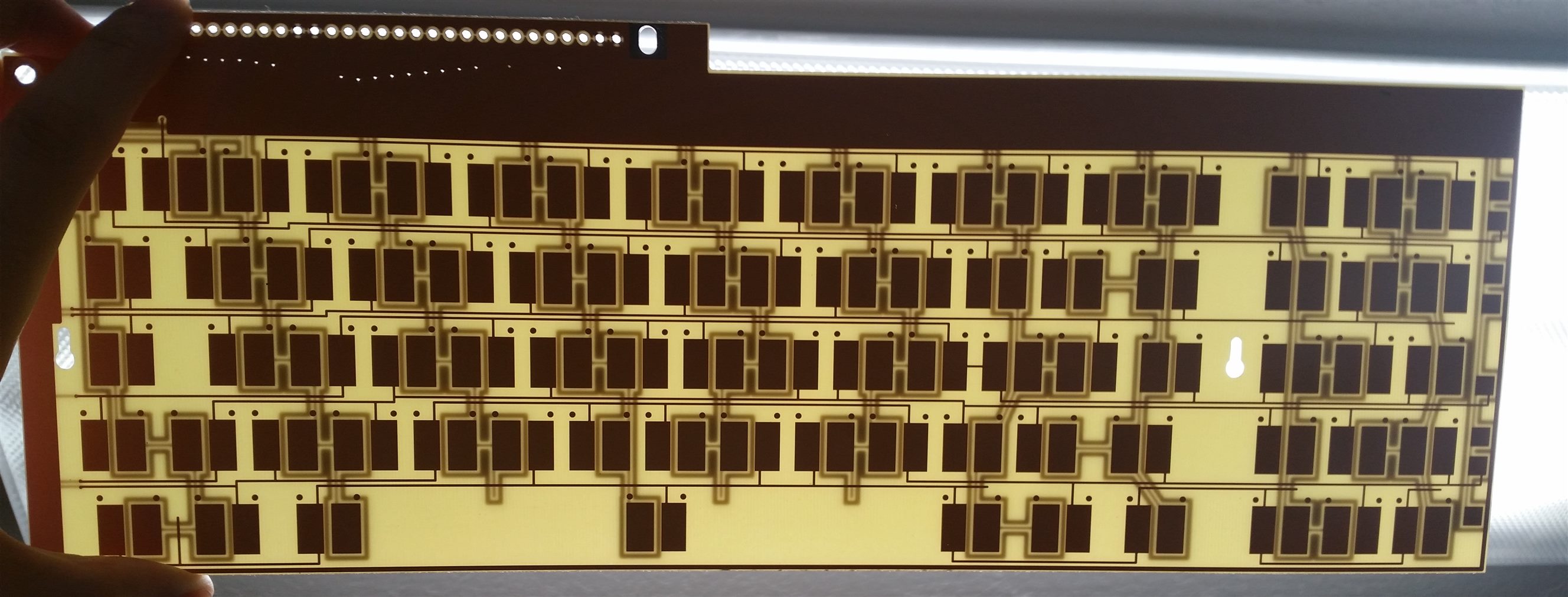

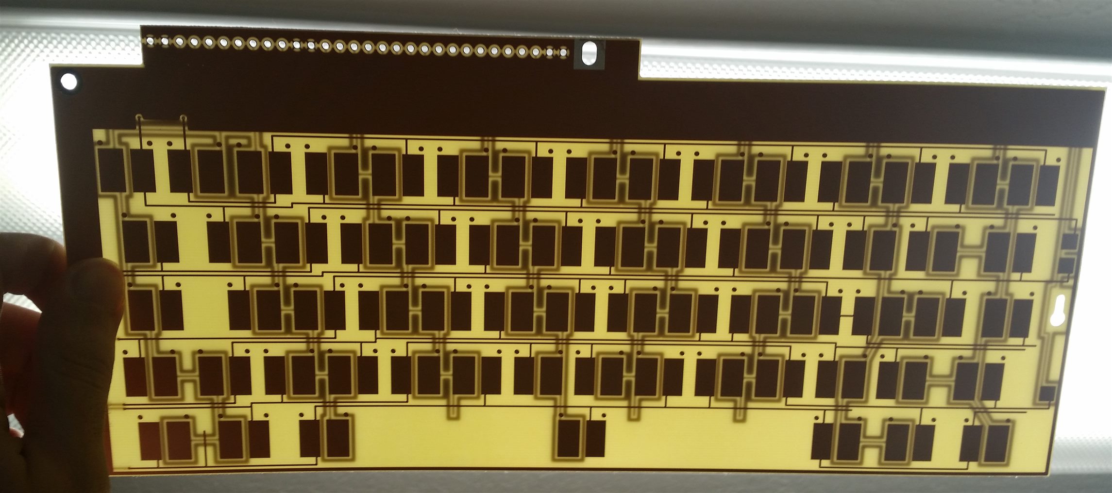

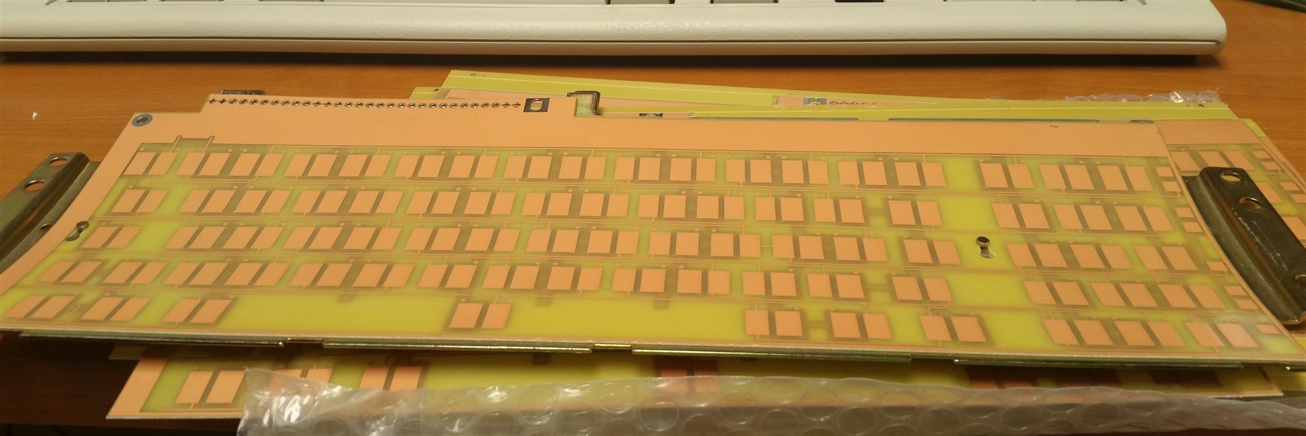

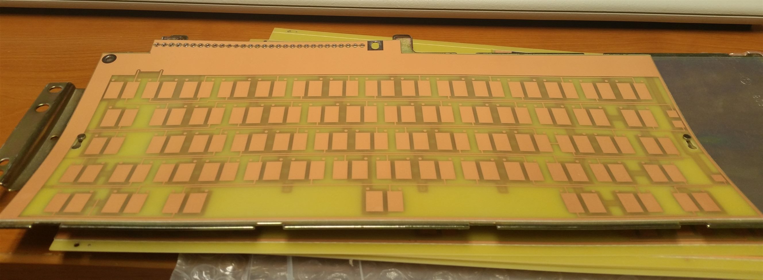

Here's an update modology - Look what arrived in the mail today from China :)
Some truly nice PCB design work by one of the senior DT contributors who has been very helpful throughout the PCB design process! I could not have done this nearly as well as he did!
Interestingly the standard unaltered copper color used today for the traces (as well as the PCB material) is a lot less dark than what was used in the mid to late 80s but reminds me of some of the very early beamspring PCBs, at least when back illuminated.
It is my understanding that the tradeoff to getting a darker copper color is you would need to change the solder mask from the current clear solder mask to dark brown, but then you would lose the nice transparent effect where you can see the back side column traces through the PCB (another more expensive PCB shop may be able to do custom copper and PCB colors but that is out of budget).
A note - the bottom inner assembly pictured with the new PCBs is from an original F77 - the prototypes have not yet gone into production.

PCBs looking good, I think the real test will be the quality of the flippers, springs, and barrels.

That gorgeous, brown, PCB!

I like it a lot! No need to go for absolute authenticity in my book (I'm in for the non-authentic HHKB-layout anyway ;)). Is the tray they're mounted on from the prototype, or is it the one from your F77?

Stupid question I'm sure - but why is there a grounding mask over the row traces (or at least looks like there is in the pics)?

Great success! I soldered the controllers tonight and both the F77 and F62 PCBs are working so far. I made some extra prototype PCBs in case anyone wanted to use one of their own xwhatsit controllers.

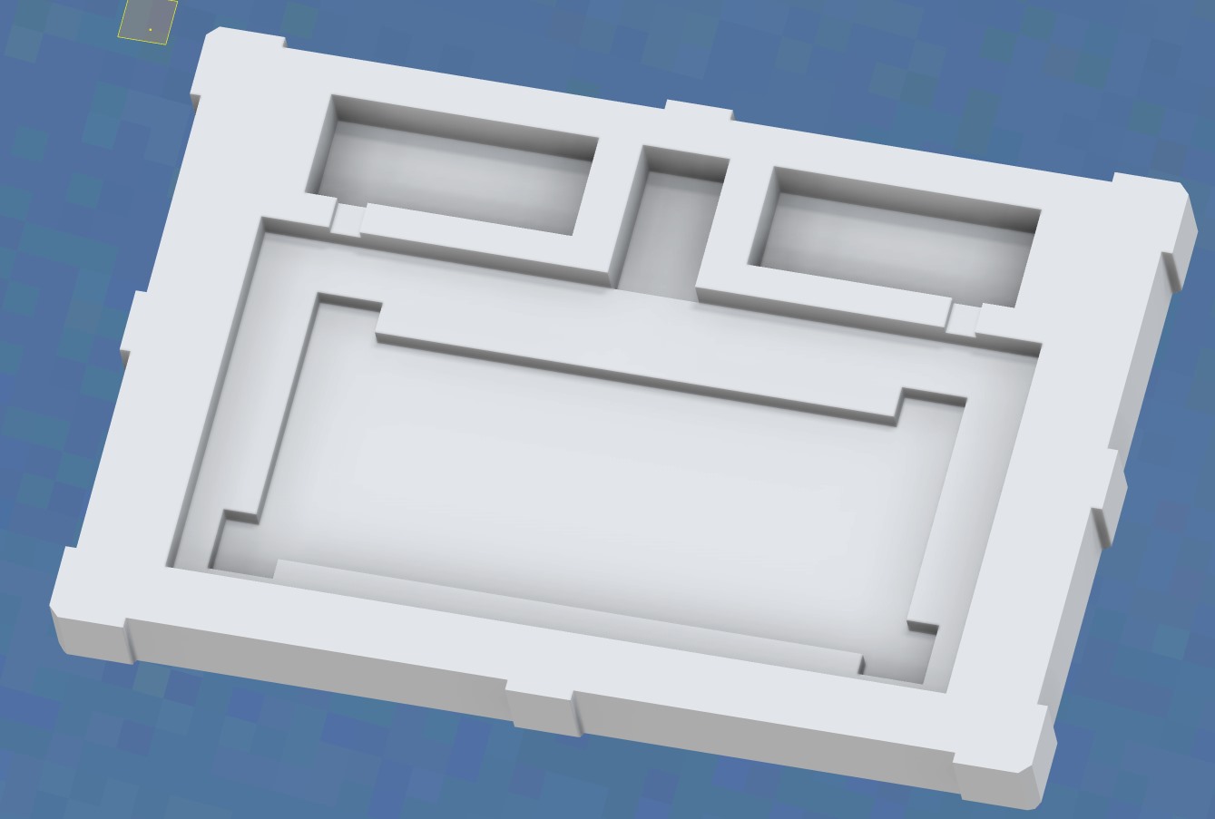

Below is the EPS foam (Styrofoam) design for packing each keyboard, similar to the design of the original foam from my NIB F77 and made of the same material. The design is the same for the top and bottom piece to save on tooling costs. Extra foam and double walled custom fit boxes will be available for order if you wanted one for your original F62 Kishsaver.

The PCB is that good at first i assumed it was an IBM original.
Is there solder mask on it at all over the copper ? would not want it to tarnish

Yes clear soldermask everywhere so it is protected and you can see through the PCB and see the copper traces on both sides. The ground pads and controller holes do not have soldermask.
010-allow me to quote the PCB designer to answer your question:
Xwhatsit's controller has a trace (and two resistor arrays) on the top of the board that go under the matrix "rows". Because of this, the rows have to come to the controller from the bottom of the board (where there is no obstruction).
