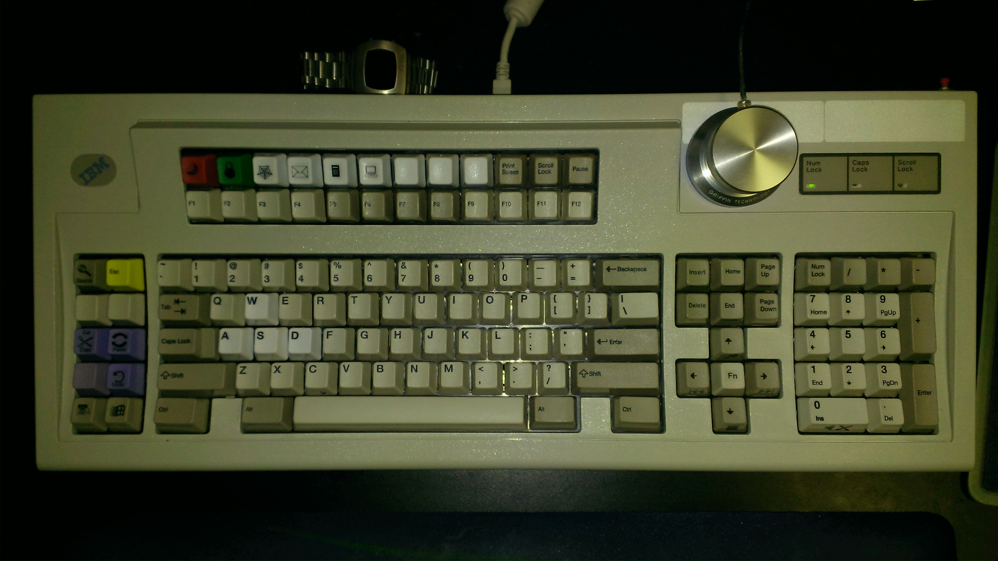

122 key M with a 101 key layout
30 Aug 2013, 14:00
Your photo gives me an idea, Lamune. Experiment time:
Got my 122 y hoo up rght now by RJ45 an th sam wr bhavour whr th convrtr sns "a" s prsnt for f21 an f22 (whch arn't alray rmapp), spt thr cos +70 an +71. Curous!
Back to the 103 key now. Can you tell my 122 needs some repairs? Translation:
Got my 122 key hooked up right now by RJ45 and the same weird behaviour where the converter sends "a" is present for f21 and f22 (which aren't already remapped), despite their codes +70 and +71. Curious!
Fortunately it's no practical concern. The keyboards report different IDs to the converter (103 key = BFBF and 122 key = BFAC) so I can give them different maps.

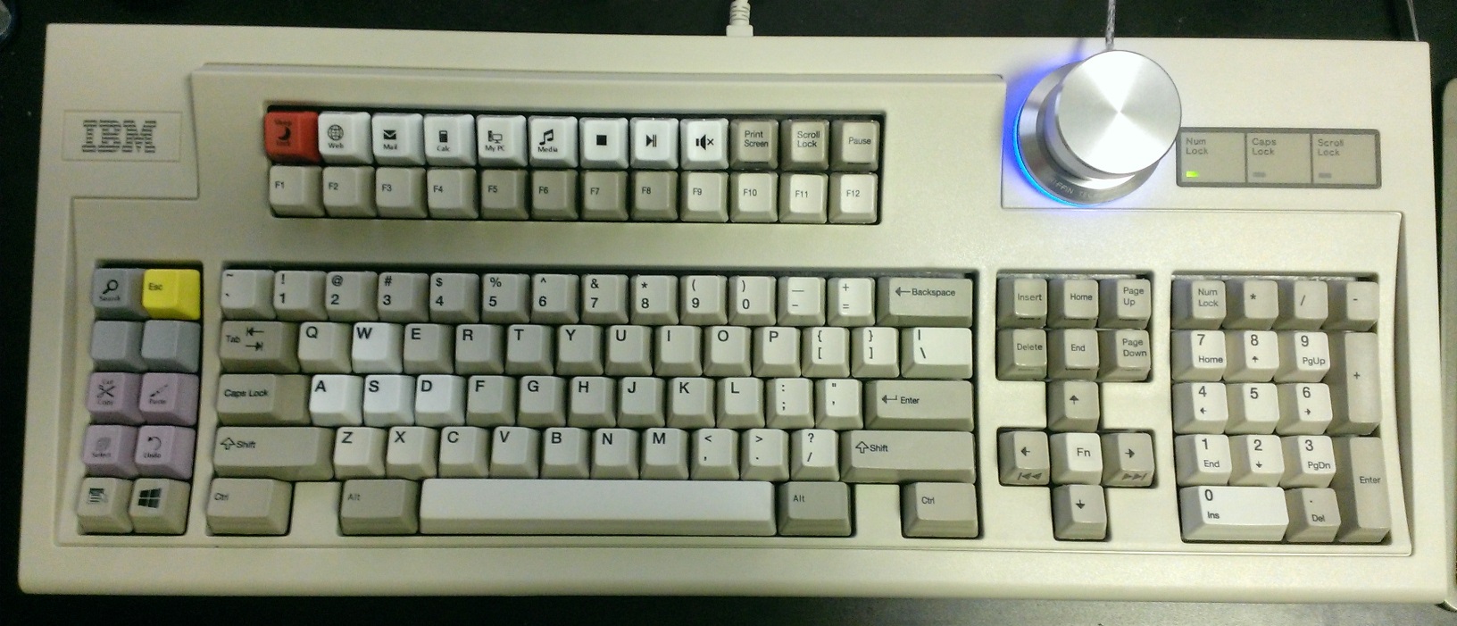

I wanted to add this to the Soarer list as well- version 2 of my conversion.
The guts are IBM, but the case is Unicomp- it had the LED holes and the sticker already. I reused the controller board inside solely for the LED mounting points. The rest inside was dome-switch junk.
I redid all the P-touch labels, this time designing them in Visio and using the new Windows 8-style icons and such. I'm using it now :)
IBM 122 term keyboard conversion #2
