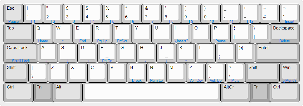

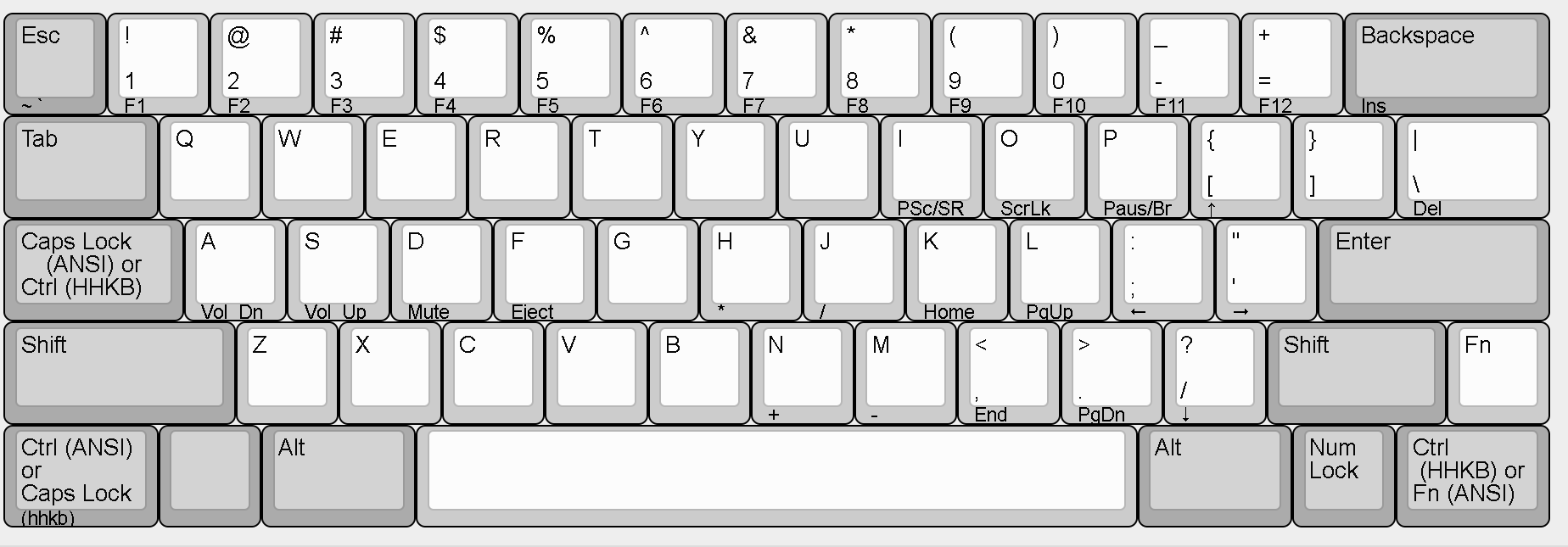

Below is the proposed factory default function layer for all keyboard variants. Please let me know your feedback:
Now's the time to recommend default function layers and other xwhatsit configurations! I will be loading the firmware and default configuration file to each keyboard during the QC process.
proposed function layer.png (32.79 KiB) Viewed 10913 times

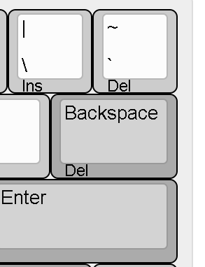

Differences for Split backspace layouts - note the Delete function suggested for two of the three keys
proposed function layer - split backspace.png (3.94 KiB) Viewed 10901 times

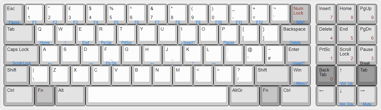

20 Nov 2019, 12:01
Ellipse wrote: 20 Nov 2019, 04:31 Below is the proposed factory default function layer for all keyboard variants. Please let me know your feedback:
Ok, so this what I intend to do on the F77:
F77 possible layout.
- Yes, I'm going with a TIE Enter. Makes sense for a compact keyboard.
- Note the presence of Fn on both sides, so either hand can press it while the other one presses the relevant key.
- Note there's just one Win key, and whisked off to the side, where Fn typically goes. Fn will get much more usage, so...
- The Back Tab and Tab keys are in a darker gray to signify that I intend them to actuate only if pressed in combination with Ctrl and Alt.
- Most of the secondary block's commands are duplicated in the main block's Fn layer so I can still activate them while in "num mode". Num Lock would alternate between it and "nav mode", while Fn+Num Lock would force the selection of the latter.
- Fn+WASD and HJKL for arrows, because Unix does as Unix is.
