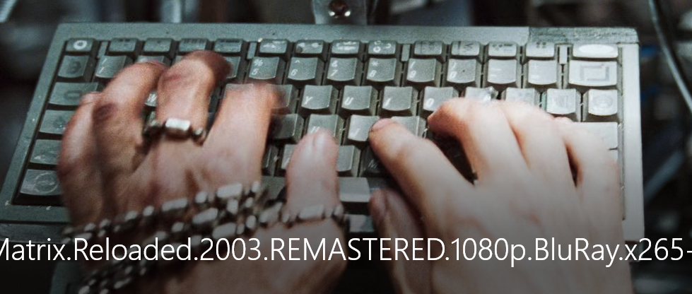

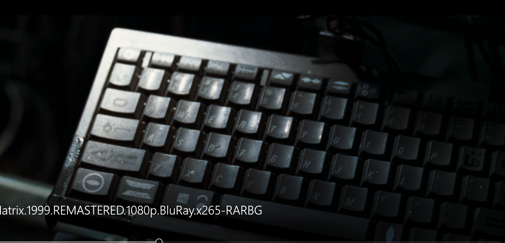

I have made two posts here and each time the bright minds in this sub have been able to find the answer to the questions I have. I wonder If you guys can get this one. This is a keyboard that I found from the movie the Matrix 1999. Do you guys know what it is?'
I really want to remake this keyboard and make this keycap set!
- Capture (1).PNG (2.08 MiB) Viewed 10476 times
- Capture.PNG (933.68 KiB) Viewed 10476 times
- Location: Stockholm, Sweden
- DT Pro Member: 0011
Tank's keyboard in the Matrix has been ripped from (or is a replacement part for) a Macintosh PowerBook. I first read that info over on The Replica Prop Forum many years ago, but I can't find the old thread now.
(You're not the first person who have asked here)

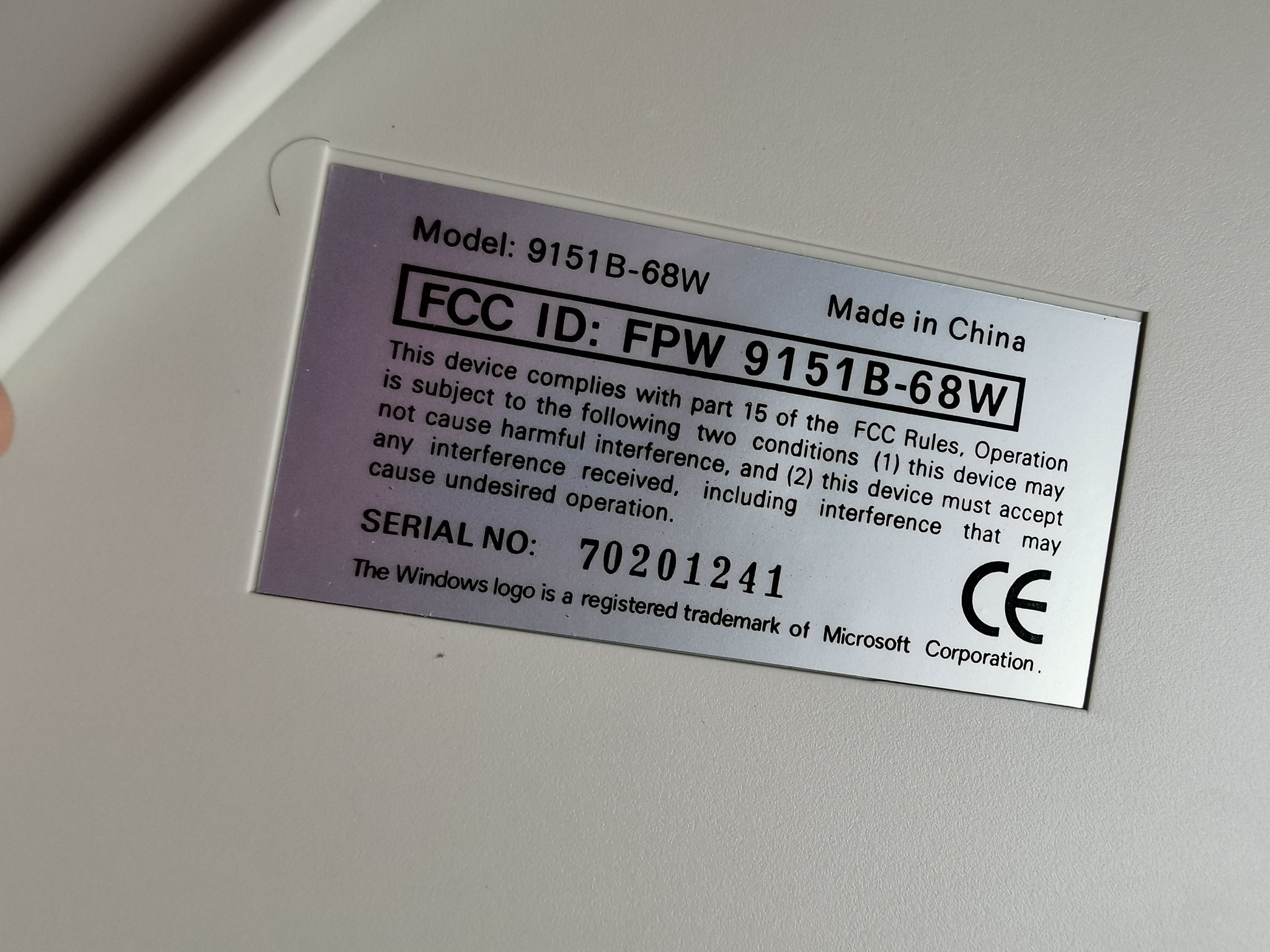

wiki/Tulip_9151BJimi14 wrote: 20 Jul 2020, 19:19 Can anyone identify what switch this thing uses? It's from 1996 from what i can find and OEM is Jing Mold Electronic Technology.
Spoiler:Spoiler:

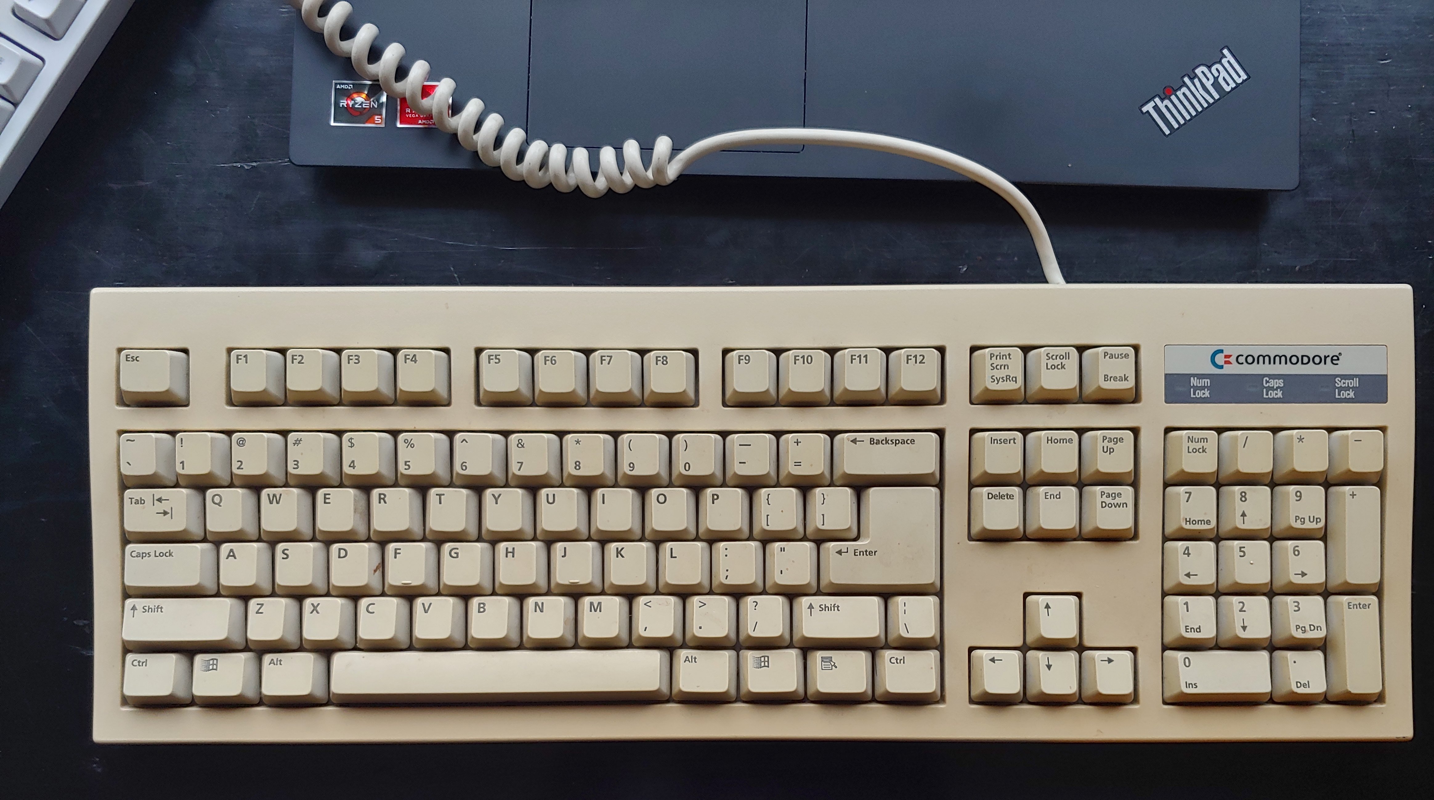

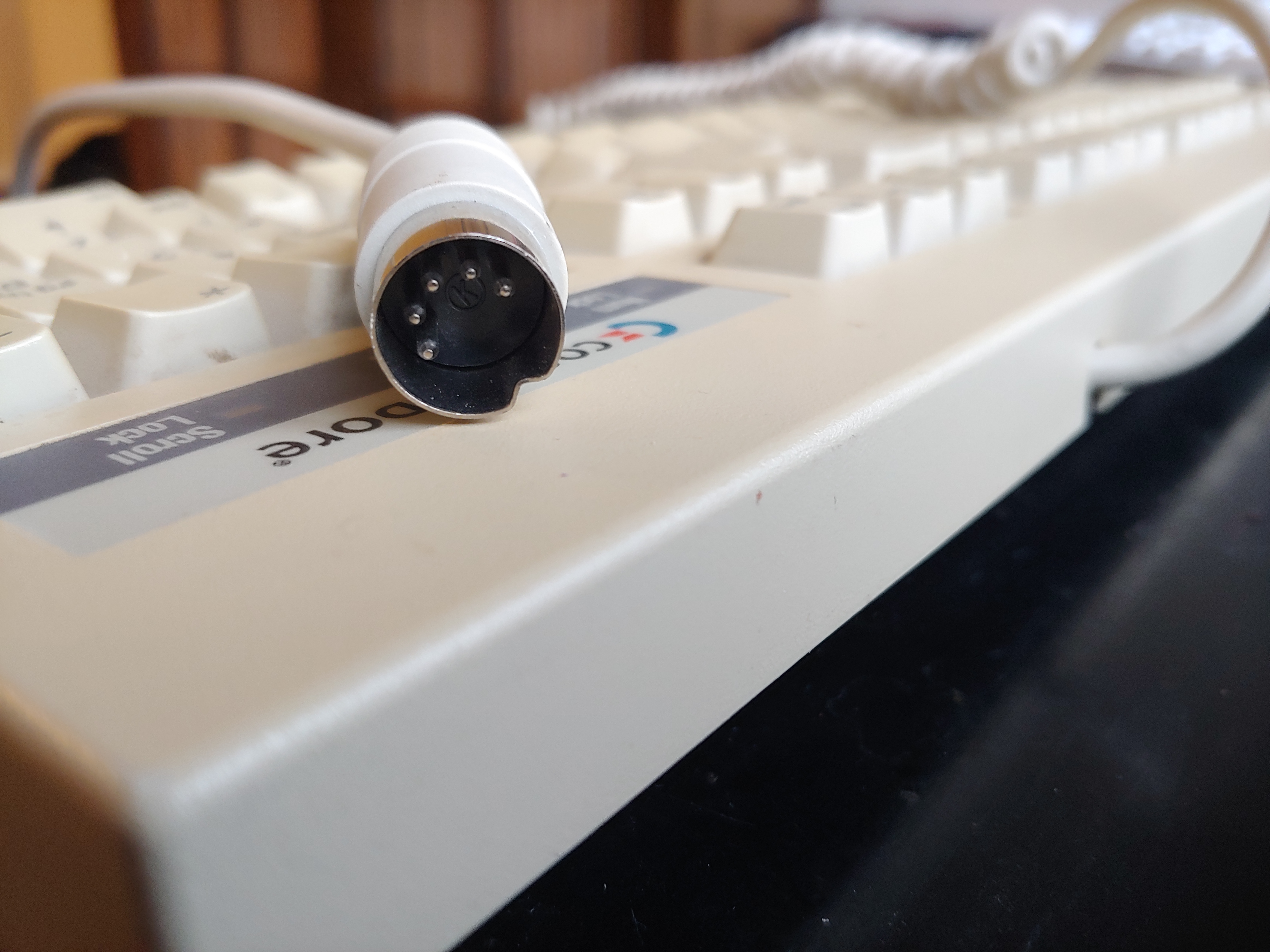

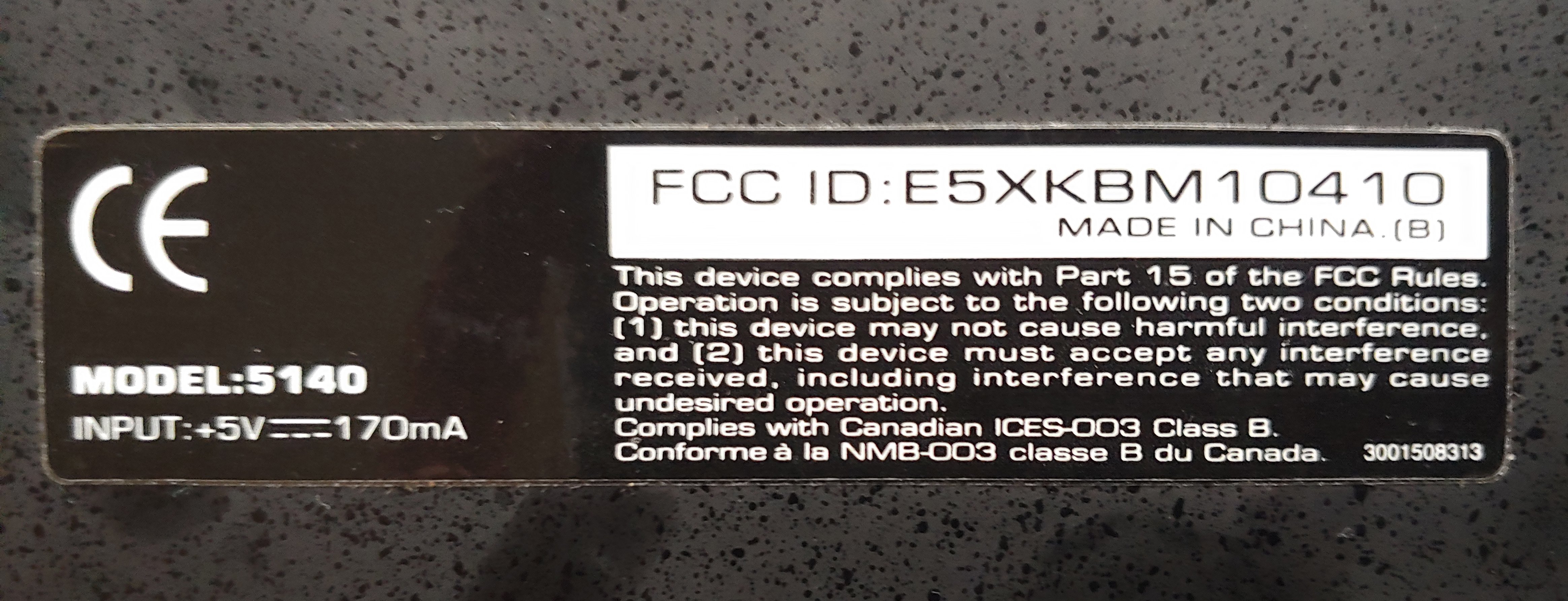

Anyone knows this keyboard? It's a 'Commodore 5140', but I can't find any additional information online.
Edit: And what is the plug called?

Welcome keyboardn00b! That's a BTC 5140, only with Commodore's branding. It has a 5-pin DIN plug for the PC/AT protocol. The signals are the same as PS/2, just with a bigger connector. The big plug was still quite common in the late '90s at least.
The BTC rubber domes are pretty good as rubber dome keyboards go. The smaller keycaps (those not needing stabilisers are compatible with Cherry MX-switches. I have a couple in the same series myself (not Commodore-branded)
Edit: BTW, The old Commodore company went bankrupt in 1994, and Windows keys were introduced first with Windows 95. German PC manufacturer Escom owned the Commodore brand from 1995 until 1997 when the brand was acquired by Tulip Computers. There are also Escom-branded 5140's so I would speculate that this Commodore-branded keyboard had been sold by them.

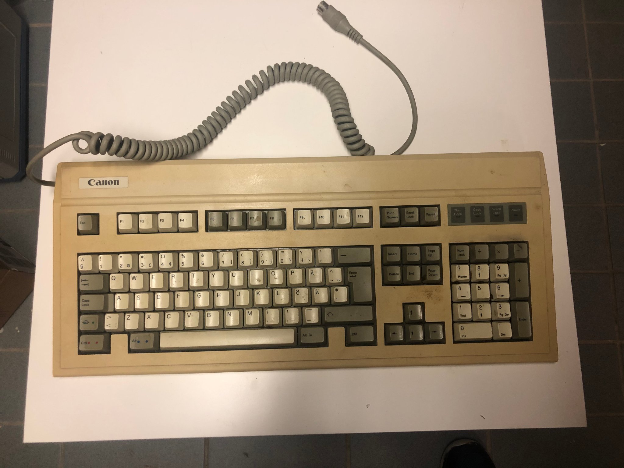

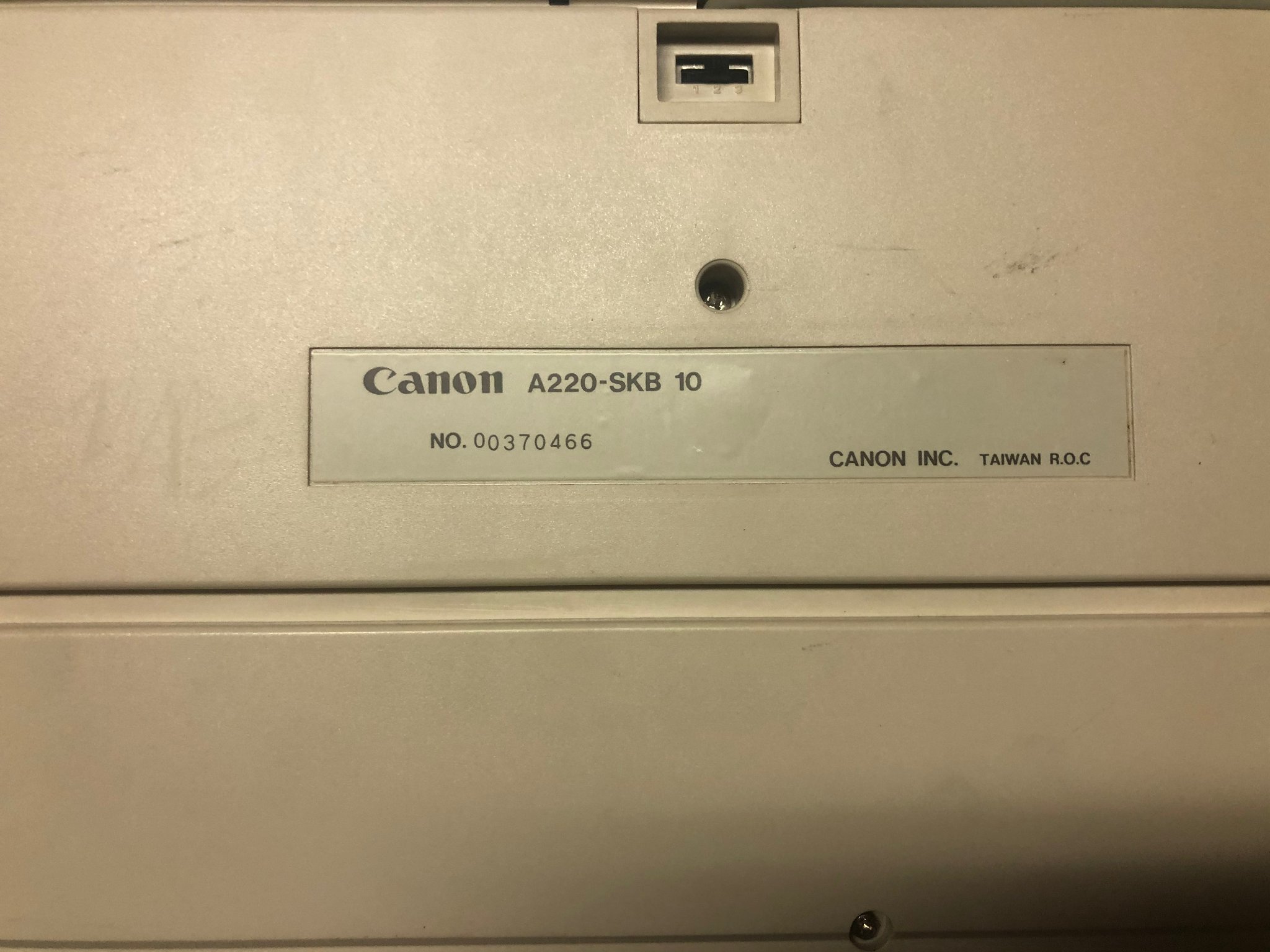

Any idea what switches this canon board uses? Looks possible like alps,but far from an expert.
Seller is also selling these brown alps boards, but claim they aren't working. Is it because they aren't speaking AT?
- Location: Canada
- Main mouse: MX Master 3
The wiki shows a very similar Canon board as having white Alps, so I think it's safe to say it's probably white Alps.
I'd get the brown Alps boards regardless. Hell, if they're cheap and you're not too interested in it, I may consider buying one from you.
- Polecat
The Canon is a rebranded Acer. That case style was used on several ISO and ANSI models. ISO versions were KB-102A, KB-102AS, 6012, and 6312. The position of the XT/AT switch suggests it's a KB-102A or AS, which likely has blue or white Alps switches.Jimi14 wrote: 02 Aug 2020, 10:40 Any idea what switches this canon board uses? Looks possible like alps,but far from an expert.
