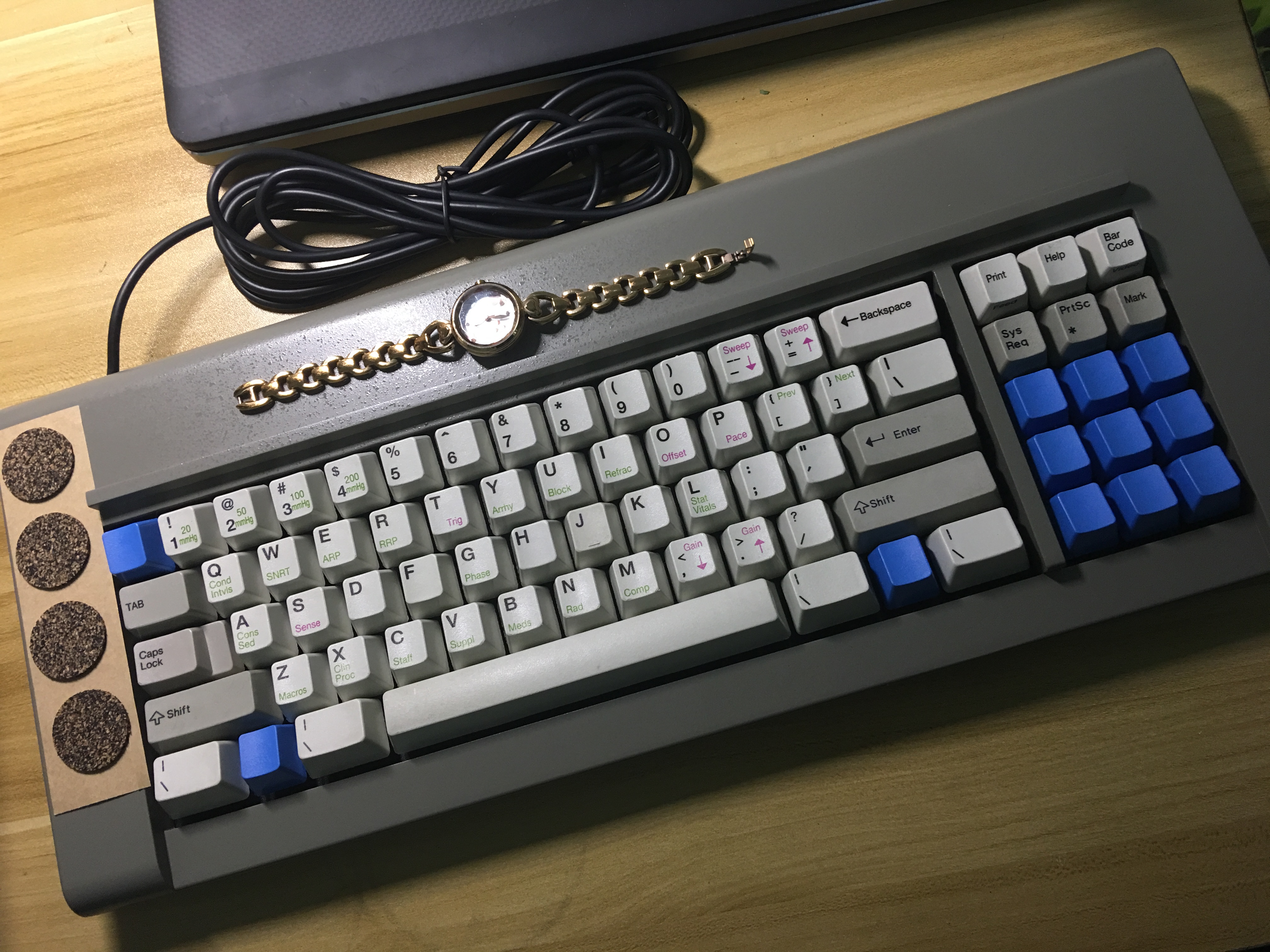

John Doe
14 May 2020, 17:40
I start regretting for not ordering a set of ellipse caps, have to slaughter some from a GE model M, but not that good as the new blue. Maybe I should place another order for caps lonely? Any advice, guys?
