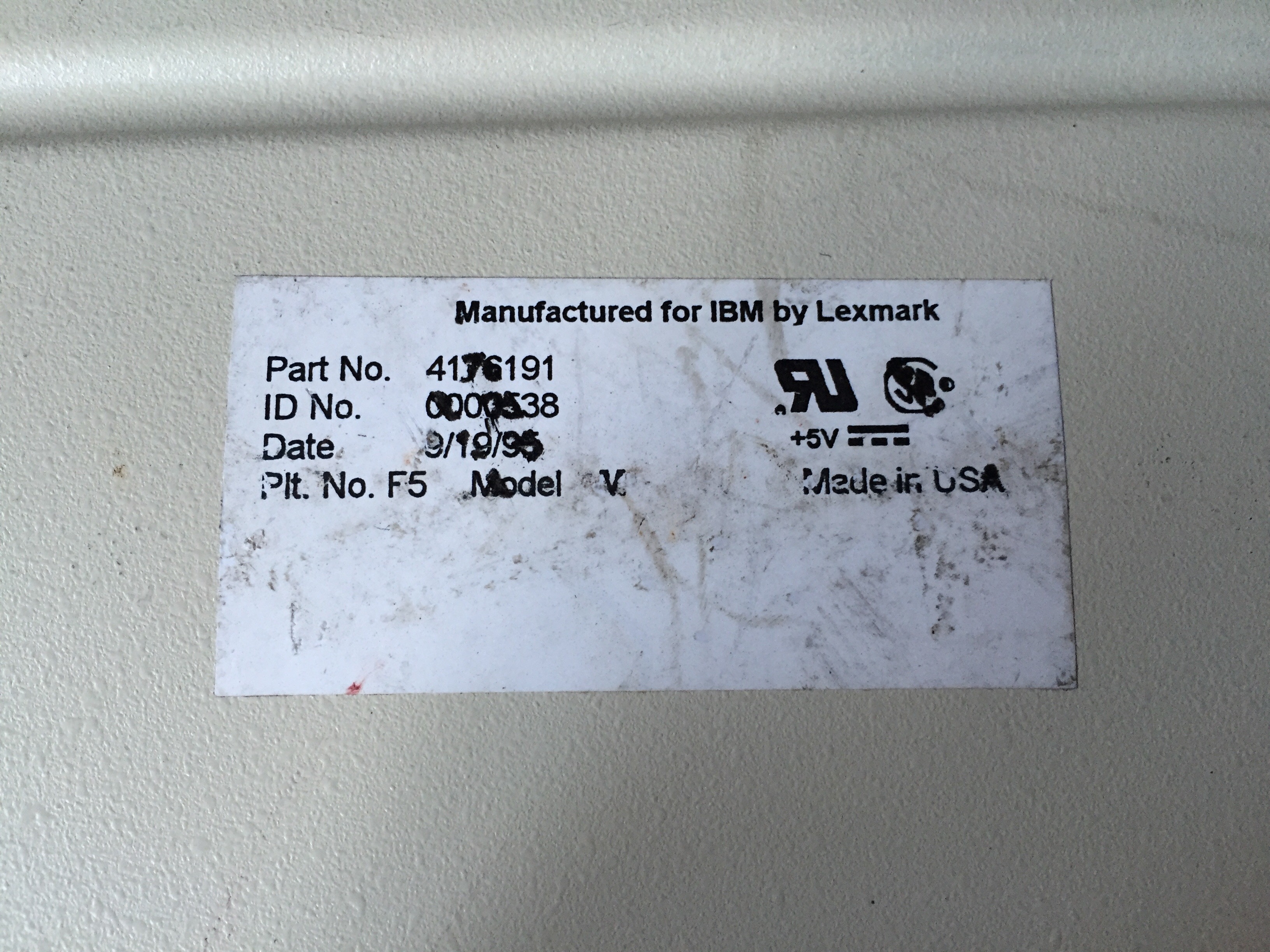

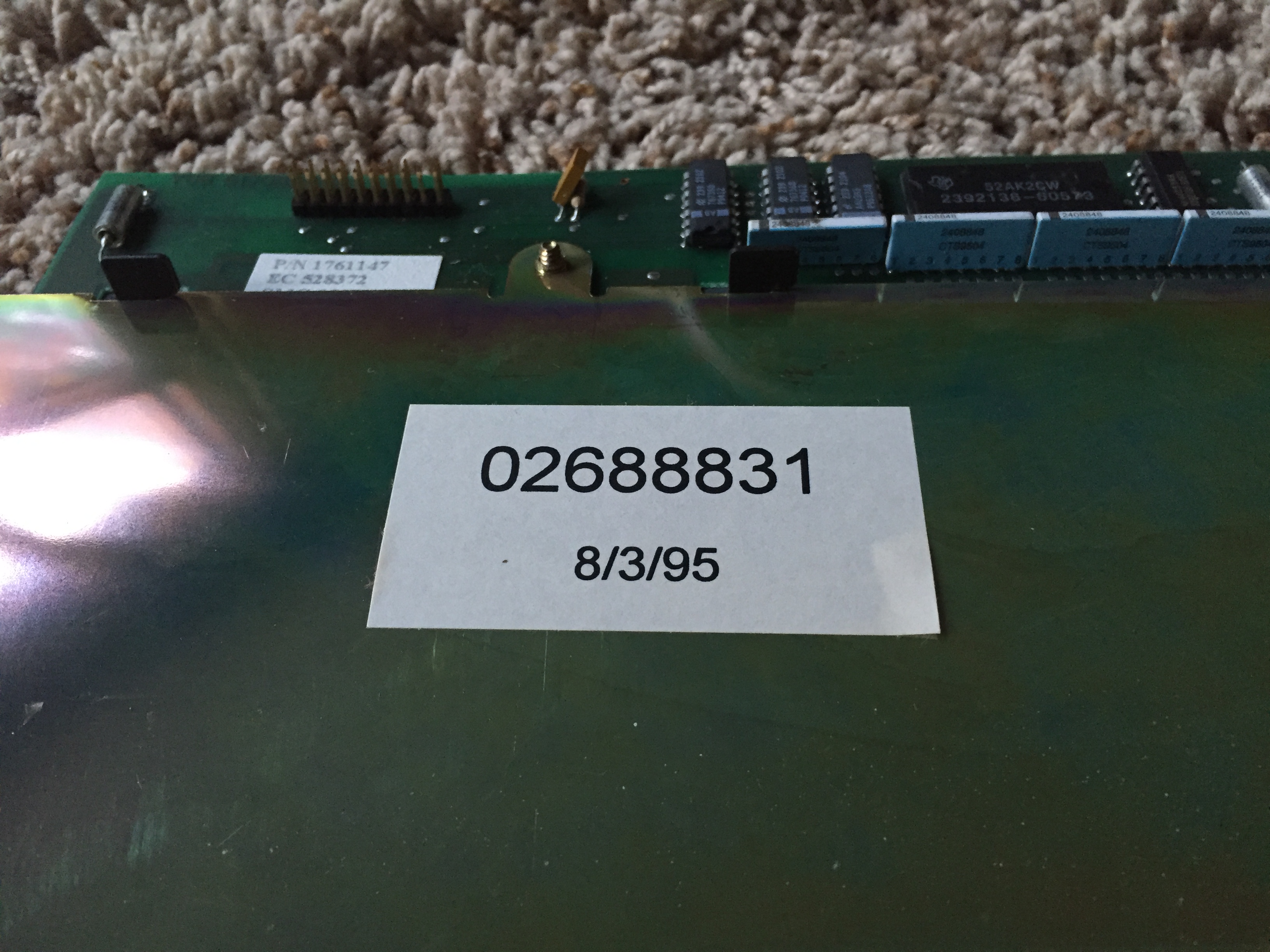

Before I head out for the evening for cocktails, I wanted to ask if anyone had ever seen this... I haven't. In the Cindy haul, there is a Lexmark labeled Bigfoot from the mid-90s. I am sure it is a refurb, but these boards would have been 10+ years old. Just surprised me
- The case label
- image.jpeg (1.75 MiB) Viewed 6383 times
- Assembly backplate label
- image.jpeg (1.82 MiB) Viewed 6383 times

Interesting! I guess Lexmark must have kept a cache of old Model F parts in stock for refurbs. Kind of like how Unicomp has their own refurbishing service for Model Ms.

My Model F Unsaver has a similar label from about that era that says "Model M" even though it isn't.

If it is anything like this Bigfoot, it must be one of the nicest Unsavers on the inside imaginable. The foam, plates, and lack of debris was incredible. Jealous if that was the case. My Unsaver needed some love.

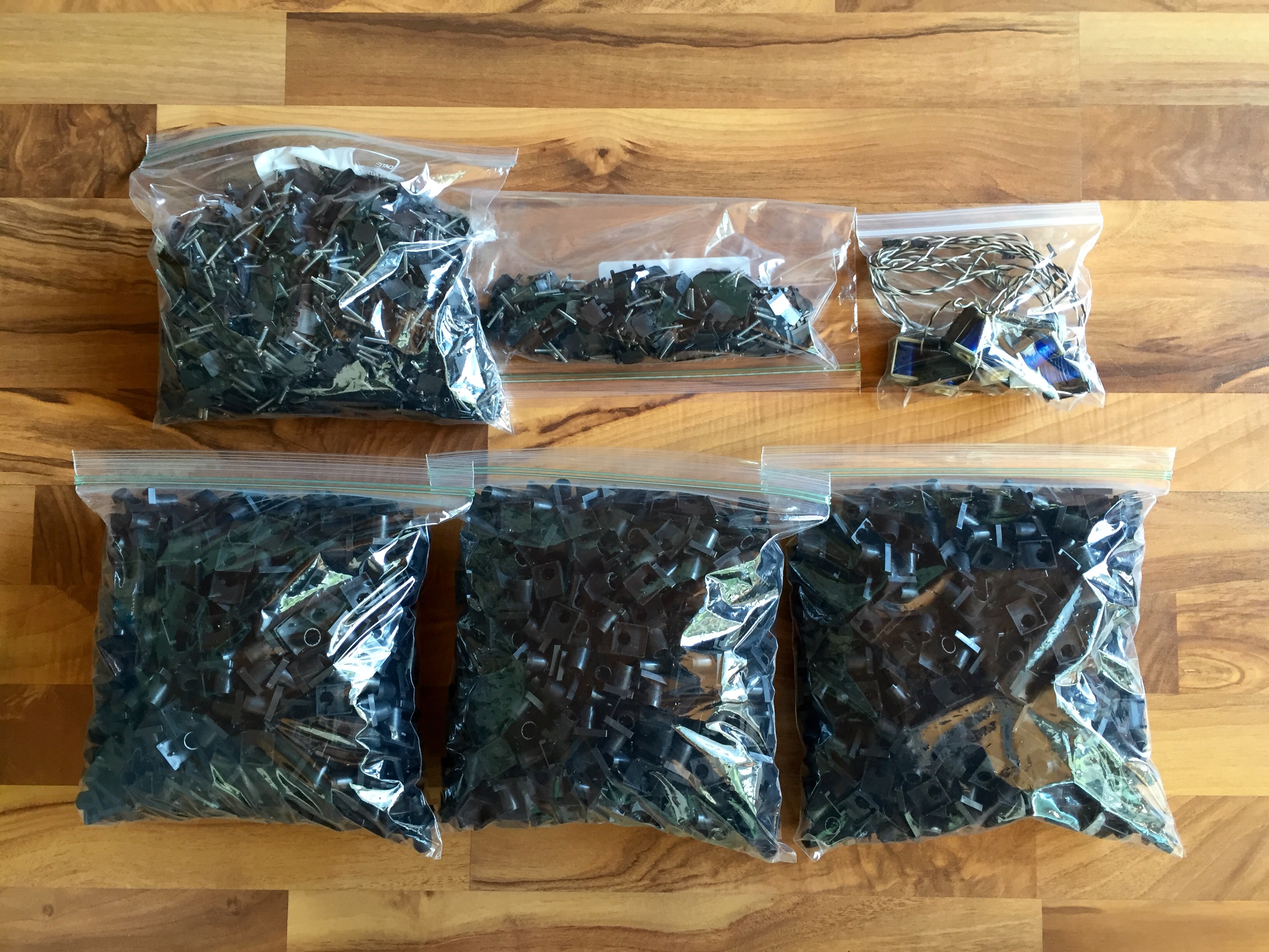

Spoils of war... Finished harvesting barrels from the first part of the Cindy haul. I didn't count, but based on the boards they came out of, and a quick weight test, we are at ~1800 so far. For sure we will be at least 250% of that in the end, but potentially more. So at minimum 4500 (enough for ~50 Model MFs). Given the polling, we would have at least 100 total boards produced so far. Again, that number goes up if Cindy's contact finds more when they inventory another palette they have yet to go through.
Also, go back and review the picture of the boards a few posts back and let me know if parts are interesting. I am already salvaging the solenoids from the 3178 (blue switch) console boards. Actually going to experiment getting them inside our boards, so stay tuned there. I originally intended on sending these out to keep them from the shredder, but most are not in the best shape (switches were great though). The more parts we sell out of them (cheap btw), the cheaper the switches. Right now we are at ~50-55 cents each based on complete guesses as to what the next batch holds. F122's are our best bang for the buck, so hopefully they are the remaining lion's share. Thanks again Cindy

That's a great haul! I can't wait to see the complete collection when you're all through with this time consuming process. Thanks again for all the hard work you are putting into this project, lizard!
Sorry if this is a dumb question, since I'm not a metalworker, but would it make sense to save all of the metal cases you're collecting, and melt them down to be cast into new compact metal cases for phase 2? That would seem to have some poetic value by giving phase 2 keyboards a direct connection to the past. But I wouldn't be surprised if that's impractical or way too expensive.

It would be fun, but we would never have the quantities of steel to have even a tiny portion of the steel mixture be our actual salvaged boards. Scrap metal is smelted down in huge bulk to produce large runs of steel bars and billet, and even then is mixed with "new" alloy to keep the ratios right. If no one wants the metal parts by the time we commence, I will scrap them, but metal prices are very low currently, so it wouldn't help our bottom line much.Techno Trousers wrote: Sorry if this is a dumb question, since I'm not a metalworker, but would it make sense to save all of the metal cases you're collecting, and melt them down to be cast into new compact metal cases for phase 2? That would seem to have some poetic value by giving phase 2 keyboards a direct connection to the past. But I wouldn't be surprised if that's impractical or way too expensive.
Several of the boards are in very good shape, and someone should take them (at least parts of them). If someone would like better pics, PM me. 3 or so were refurbished in the mid 90's, and are in exceptional shape (albeit dirty).
I am keeping the 3178 with the door on top for switch access btw. We should nickname the 3178 board "the platypus". It is definitely a unique/odd little animal. Great badges though.
