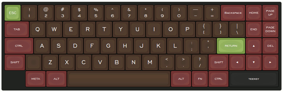

- 70%.JPG (122.33 KiB) Viewed 5147 times

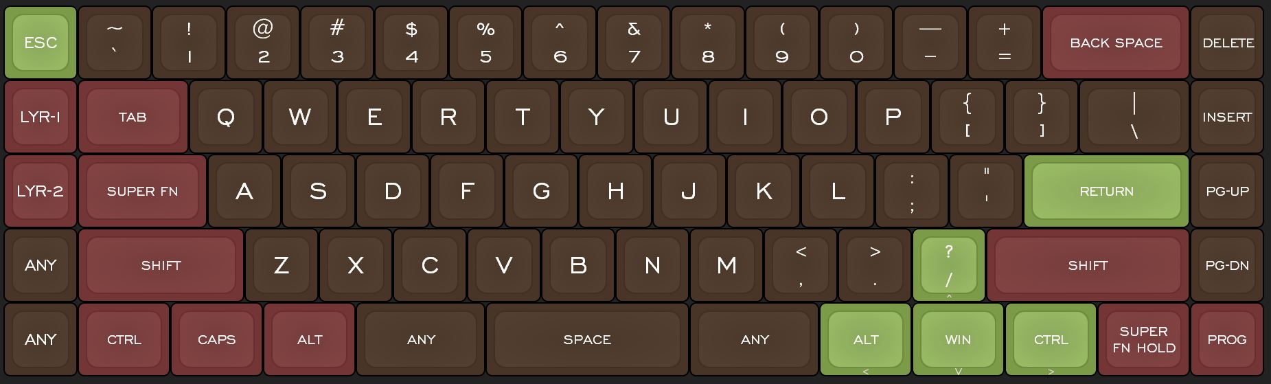

I come to the conclusion that finding an agreement on 3 layouts is impossible. I believe we will end up with one design per user like the first time

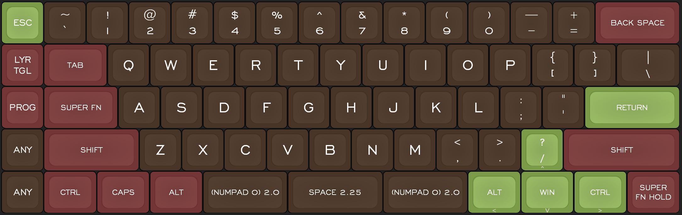

2.75 unit space bar!? That'll be an interesting requisition, Req… I like where you're going with the extra mods either side of it. Japanese style!

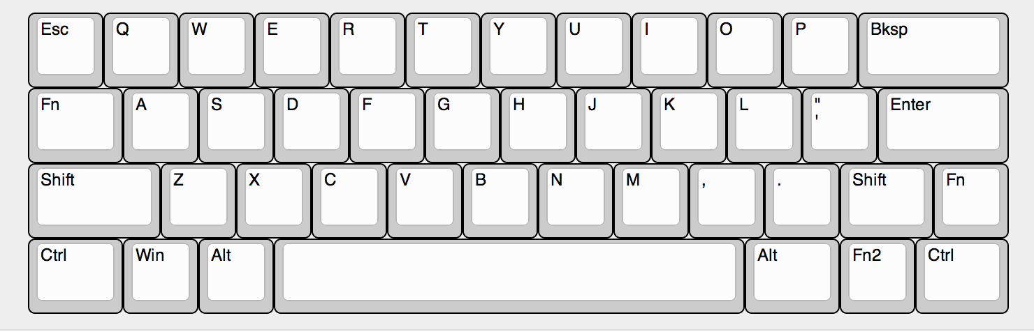

The best consensus we could probably reach is maybe 3 sizes of layout, like say 16x5 units etc.
A few people want my HHKB meets Poker hybrid 60% from last year, right? (The board with blue caps in the OP.) I'm likely to make another one, maybe in Matias or M84s. Not that this exactly helps!

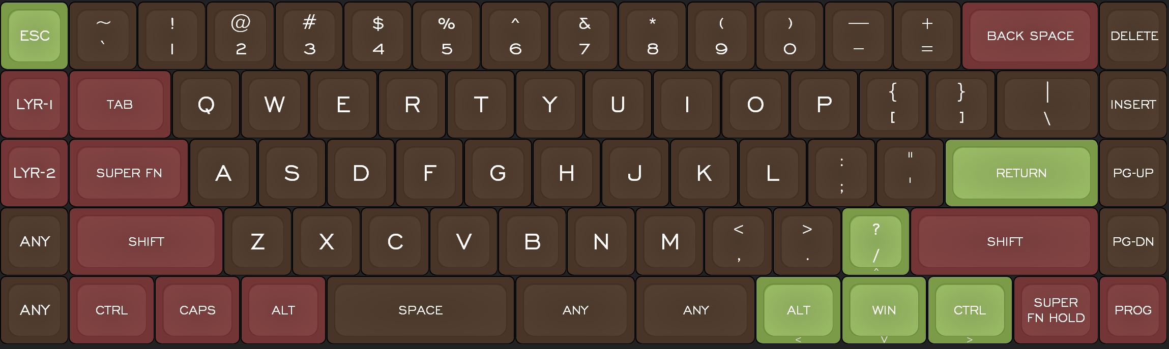

I was doing some mockup and that made the most sense in my mind from a FPS perspective. While your hand is in the WASD position ones thumb generally rests in the V area of the spacebar. With this configuration one can comfortably hit Space/Jump while having a large alternate key within easy reach. Additionally both of the assignable keys on the left (ANY) are amazingly easy to reach with your pinky (next to where sprint and crouch normally are).
My plan was to use DSA caps so I don't think using those keys would be an issue.
Matt3o: How will that work with one layout per user? Would something like what I posted above be possible then? What is the price of entry if you don't mind me asking?

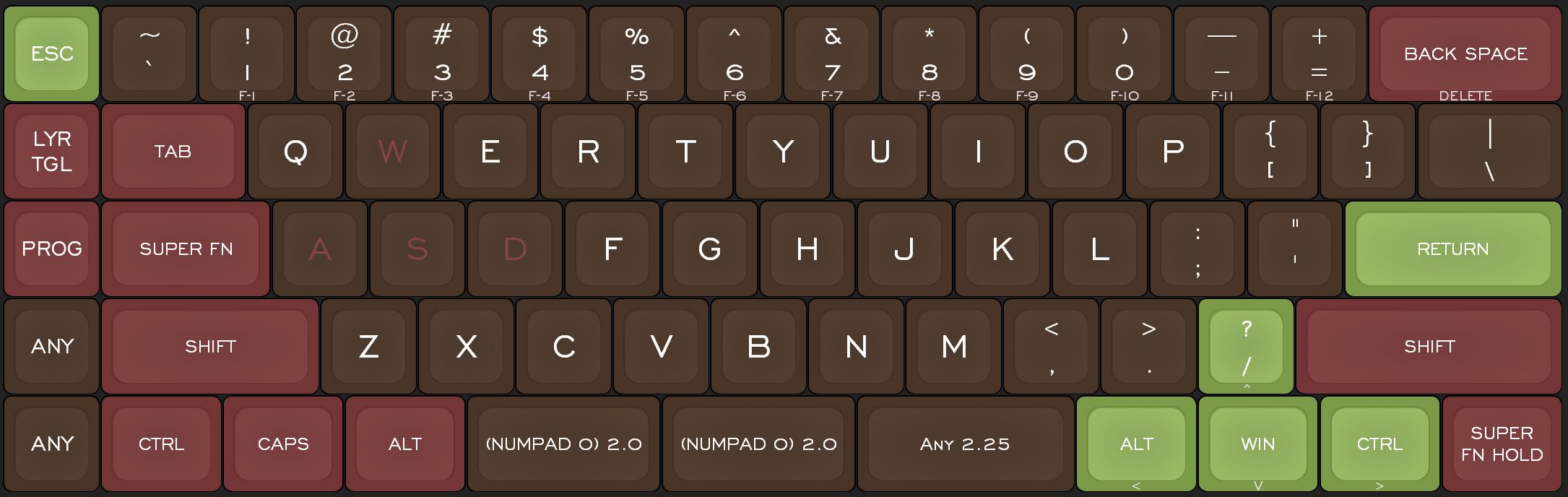

Sound thinking. No need to consider rows with DSA. But you'll still need a cap of that size. As far as I know, there's nothing available in the range between 3 and 6 units. Your best bet would be 2.75u. Because that's right Shift! Ah, my bad, you had this figured out already! Must be too late in the day for me…Req wrote:My plan was to use DSA caps so I don't think using those keys would be an issue.

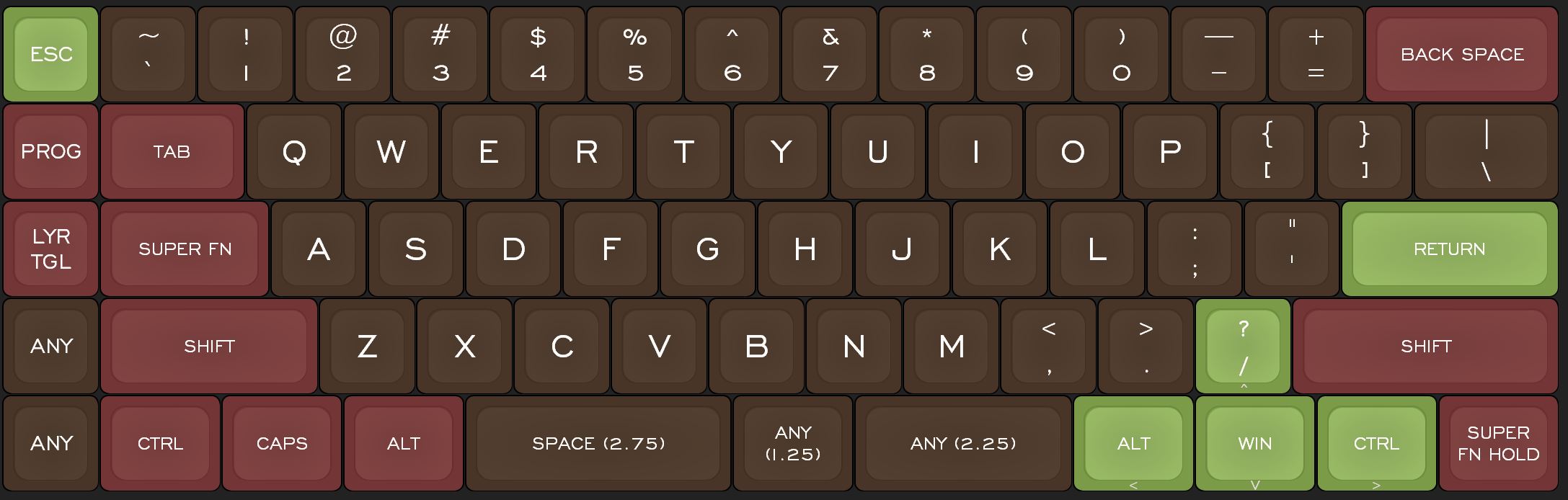

Here are alternate designs that are more 65%ish
- 65%2.JPG (167.2 KiB) Viewed 5116 times
- 65%.JPG (154.67 KiB) Viewed 5121 times

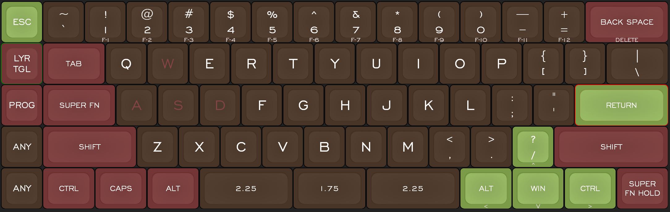

The "any" keys will probably be re-legibles/legendables * from the Ruby super system http://www.keycapsdirect.com/ruby.php . Or I may turn some of my WASD keys upside down or sideways. The spacebar area Ill just grab some blanks from SP.

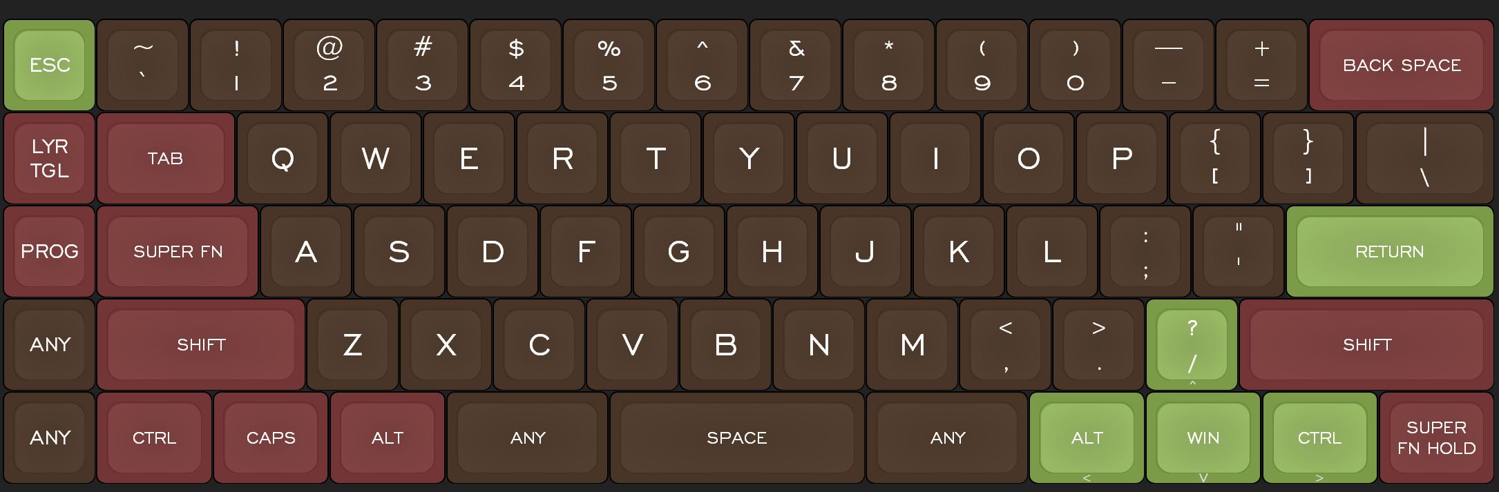

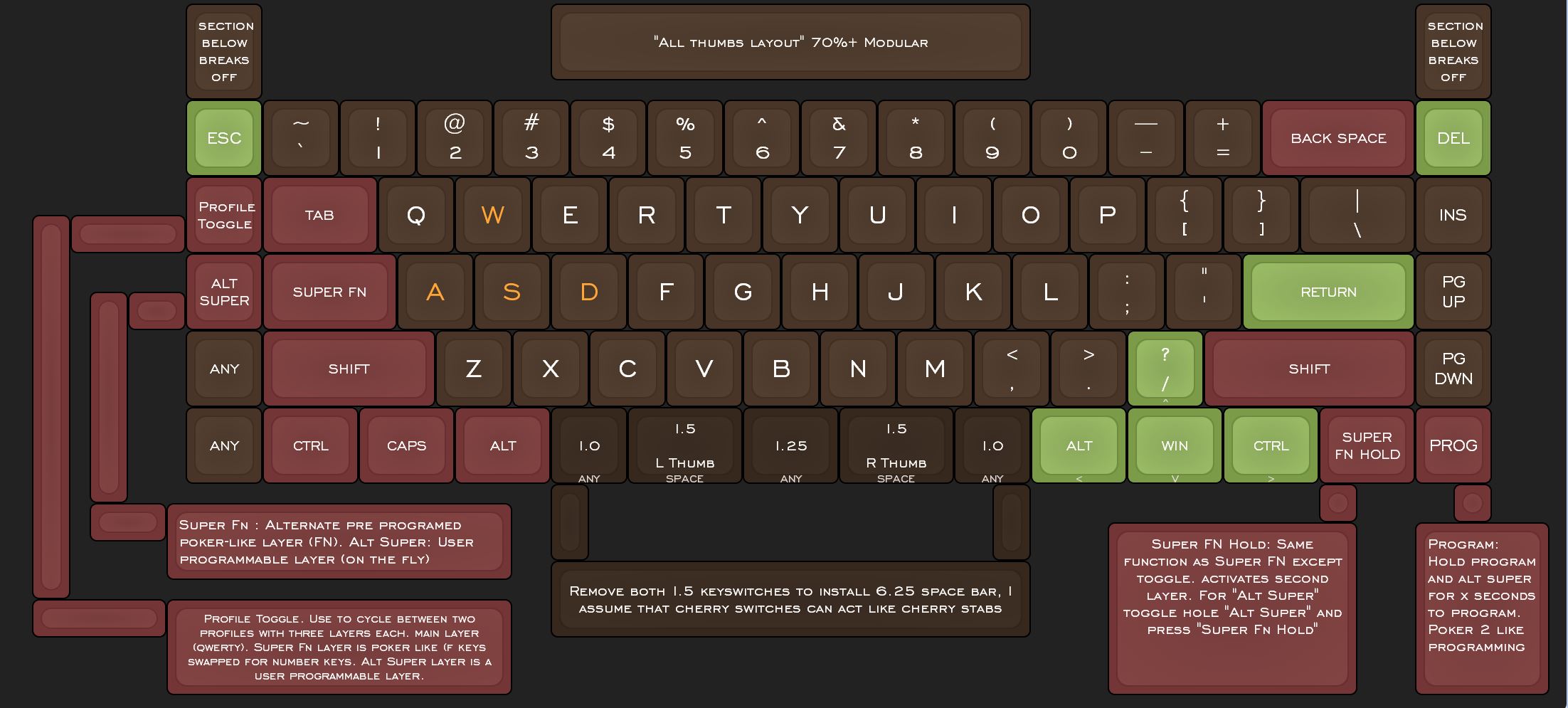

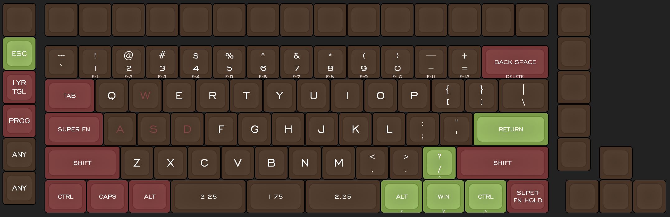

Here are more row friendly designs that I may like better than any of my others. The first one is quite symmetrical.
- Sym65%.JPG (150.13 KiB) Viewed 5104 times
- FPS_dream65%.JPG (150.78 KiB) Viewed 5111 times

Req, I really like the ones that have the extra colomn on both sides. What size are the "D-Pad” green keys? Would there be any way to get the "? / UP” key the same as the ones below it.
- Req
- Main keyboard: Das Keyboard
- Main mouse: Mionix Avior 7000
- Favorite switch: Clear
I like the first one as well for a lot of extra keys for little cost of space. Keeping to a standard US layout (for the most part) I used 3 1.25 keys for left, right and down and a normal 1.0 key for up. The alignment is at the mercy of the standard layout to be honest.SL89 wrote:Req, I really like the ones that have the extra colomn on both sides. What size are the "D-Pad” green keys? Would there be any way to get the "? / UP” key the same as the ones below it.
- Location: Stockholm, Sweden
- DT Pro Member: 0011
I don't know about yours, but my space bars have a shiny spot right under N and M, where Req's designs have a split between two keys.
BTW, I think my ideal keyboard would be close to this (and I have posted similar layouts before): Because I'd like a nav cluster. Arrow keys one step up for better ergonomics and it frees up space in the lower right corner for placing a Teensy µC on top of the PCB which allows the keyboard to be flat. Not entirely sure about the DEL key though. No Ctrl keys in corners is more retro and less confusing when you have Ctrl instead of Caps Lock.
1.5u wider than 60%. 0.5u wider than matt3o's 16u, 2u narrower than TKL.
I wouldn't mind a split space bar... if only there were small keys in space bar profile widely available.
- Req
The design below fixes your gripe however it de-centers the middle key making it so you could not have it dual purpose (holes for stabilizers for spacebar).Findecanor wrote:I don't know about yours, but my space bars have a shiny spot right under N and M, where Req's designs have a split between two keys.
Here is an attempt at maintaining the centered switch while fixing your gripe.
About the spacebar profile: I think that DSA blanks will serve as a more than adequate split space bar and thankfully can be had in many colors.
Another idea I had was maybe it is possible to make the PCB and plate modular. Could break serrations be made in the PCB and plate so sections of the pcb and plate could be removed to accommodate whatever design the user wanted? Below is an image with the areas I was thinking about the serration (all the pulled out keys). Stripped down its a Poker2, with the top row and right section its a 660, and there is a Keycool 84 in there as well plus more.
And here is an attempt at calling out how I would see the keyboard functioning. Im calling it all thumbs as it gives you much more to do with those underused digits. I don't see a reason that DSA PBT caps could not be used for the space bar region even with other profile caps, especially considering they are first row. I believe I solved the thumb location as well as the cherry stem locations allowing for a standard 6.25 spacebar to fit on it if I were to ever change my mind.
