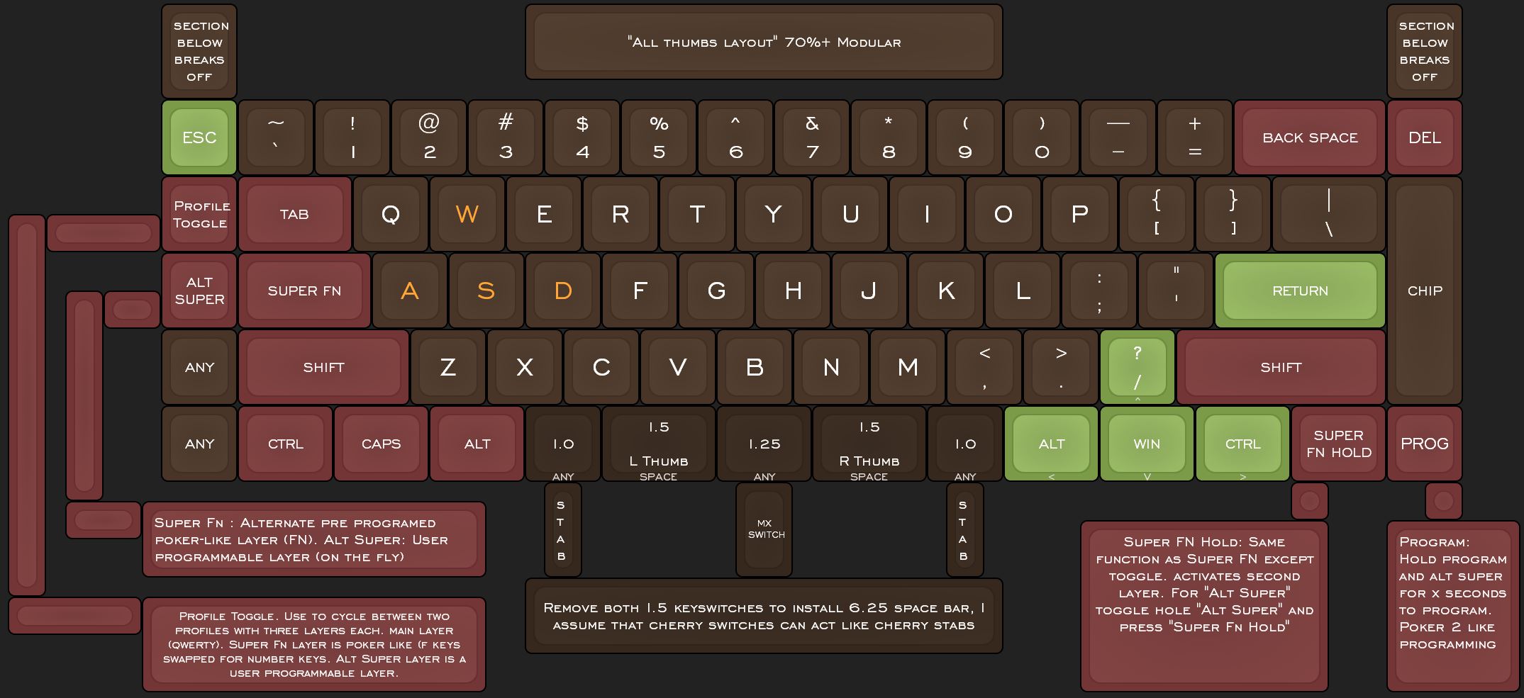

Req
01 May 2014, 15:16
Could we use the right column (remove the three keys between delete and program?
Like this.
TEENSY SPACE.JPG (236.39 KiB) Viewed 4980 times
01 May 2014, 15:18
The Teensy can squeeze into a 2x1 unit rectangle, in fact:
http://deskthority.net/post160861.html#p160861
Req
01 May 2014, 15:22
Muirium wrote:The Teensy can squeeze into a 2x1 unit rectangle, in fact:
Less space we need to give up then. So something like I just uploaded could be possible it seems with even less real estate taken up.
SL89
01 May 2014, 15:24
Would 2x1 for the Teensy be able to fit somewhere under a standard 6.25 space?
I'd be really keen on keeping the extra mods on both sizes like your original.
-[°_°]-
01 May 2014, 15:27
6u spacebar is enough to fit the teensy.
01 May 2014, 15:30
Req wrote:Could we use the right column (remove the three keys between delete and program?
The standard mounts for 6.25 space bars are "One center mount and 2 extra mounts 50mm left and right of the center." Is that compatible with your switches for stabs system?
I have thought of using MX reds as stabs, too. You definitely want something light and linear. But even so, two reds just by themselves would make a fairly heavy space bar, without the active central switch!
Also, stabs work a little differently to switches. Those connecting wires they have right from one end to the other exist for stability reasons. Switches won't stabilise quite as well. You might want to try the feel of POS caps on a Tipro to verify this yourself.
-[°_°]-
01 May 2014, 15:44
the stems position of a 6.25 spacebar don't fit Req's design I'm afraid (I'll double check). Apart from that a key with 3 switches becomes pretty hard to press. I tried 1 MX blue + 1MX red and it was already hard as hell (but admittedly not on the spacebar, the thumbs are probably stronger so a little more force can be used)

Req
01 May 2014, 15:52
Muirium wrote: Also, stabs work a little differently to switches. Those connecting wires they have right from one end to the other exist for stability reasons. Switches won't stabilise quite as well. You might want to try the feel of POS caps on a Tipro to verify this yourself.
The measurements are correct, I mocked up a K60 I have with cherry stabs and surprisingly it seemed like actually switches would be more stable as there is no stab bar on the cherry flavor of stabs. Im sure one could get a 20g or 30g spring to make reds even lighter.
I may be missing something here but I think that 3 switches (two gutted two resprung and one center of your favorite flavor) could work. What stabilizes the cherry stab if it does not have a torsion bar? (Edit:I just noticed its under the plate :/)
I have never used that keyboard you refer to however I am sure it is junk as you said. Obviously I would like to avoid that.
matt3o wrote:the stems position of a 6.25 spacebar don't fit Req's design I'm afraid (I'll double check). Apart from that a key with 3 switches becomes pretty hard to press. I tried 1 MX blue + 1MX red and it was already hard as hell (but admittedly not on the spacebar, the thumbs are probably stronger so a little more force can be used)
About the spacing. From what I gather the outside stem holes are .5 out from the outermost edges of the spacebare thus a 1.0 key there would put the stem in the correct location. The center stem is centered so as long as a 1.0,1.5,1.25,1.5,1.0 in that configuration the 1.0s will act as stabilizers after they are lightened and the 1.25 key in the middle is the center post for the space bar.
Maybe im off on this but this is the way the math works in my head.

SL89
01 May 2014, 16:19
I made this based on Req's design.
Same sort of idea, but keep the 6.25 space, put the teensy under it and use 2 Cherry MX Switches instead of 1 in the middle with 2 stabilizers. Idk if this is even possible, but its a thought.
01 May 2014, 16:21
Unfortunately, that would wobble really badly when pressed anywhere but exactly in the middle. I have experimented!
Try pressing a normal space bar down at the left edge, and you'll see how it tries to go down evenly at the right. That's stabs in action. Without them, there is no balance, and you have a lever instead!

Req
01 May 2014, 16:44
I wonder if the board could be made to accommodate both stabs and switches in my location. The center switch would remain the same regardless but the plate could have something that accommodates both. Im sorry to be pushing the multi spacebar but I think its something that the market needs.
-[°_°]-
01 May 2014, 16:46
Req wrote:I wonder if the board could be made to accommodate both stabs and switches in my location. The center switch would remain the same regardless but the plate could have something that accommodates both. Im sorry to be pushing the multi spacebar but I think its something that the market needs.
maybe with PCB mounted cherry stabs, I don't know, I'd have to make some sketches.
