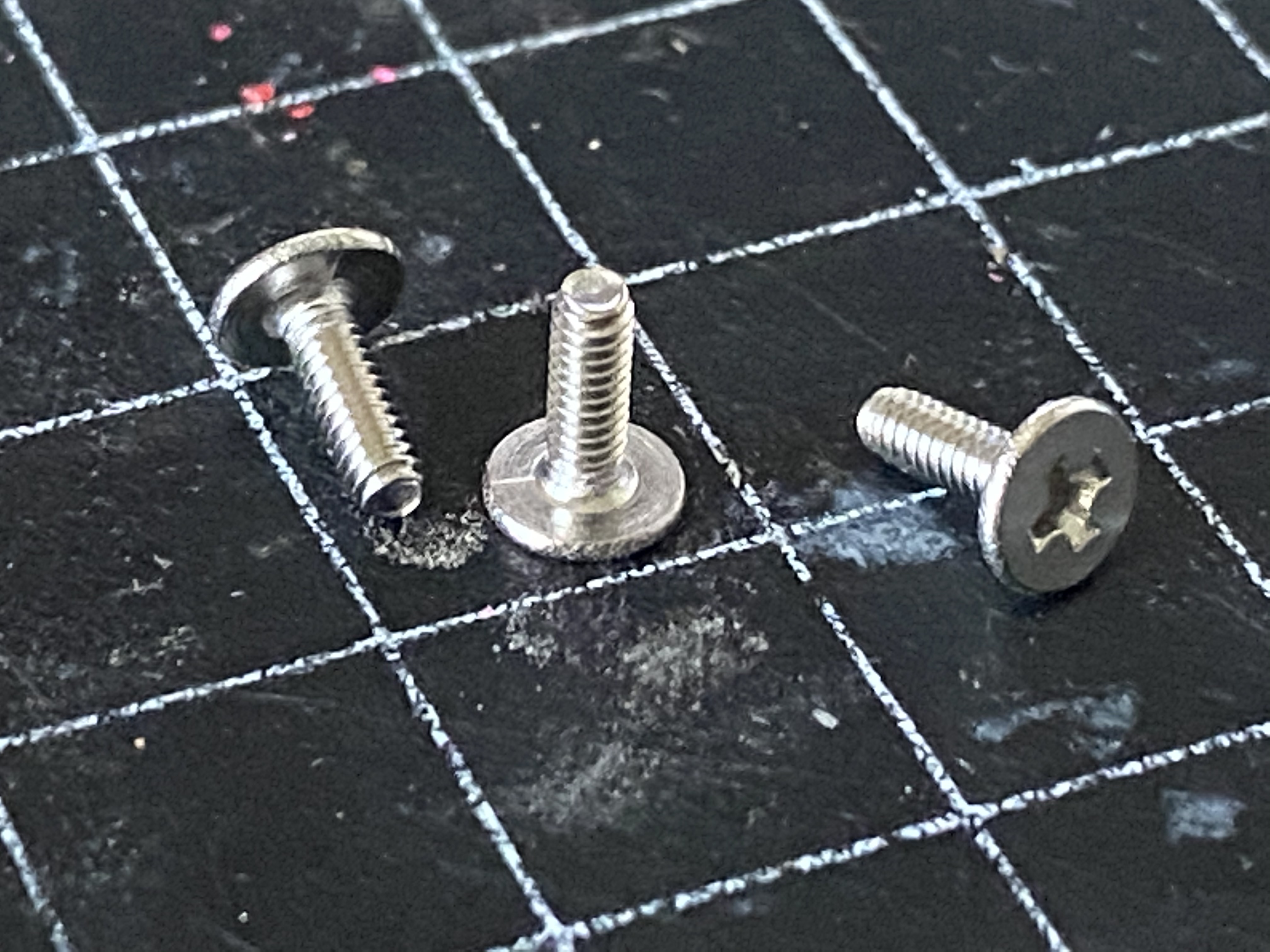

I just got two clean Model M boards for 100 euro, one is already taken apart but the previous owner was out of brave pills to perform the bolt mod. I'm reading up on how best to do it and thanks to forums like these, I think I have a chance of doing it successfully.
Thing 1
There seems to be very little space for bolt heads or nuts at the bottom, especially on the first row or two. I can imagine this can give some issues trying to force the modded assembly in the outer casing. I've seen the limited space thing mentioned a few times but not as often. What's peoples take on this?
Thing 2
Another thing I wonder. After scraping off the rivets, you're left with slightly protruding round bits. In most guides you see people cutting these off with side cutters or a knife. Wouldn't it make more sense to keep them? Seems to me they act a bit like a spacer for the mat and flexPCBs. Wouldn't this prevent some of the issues people have of over tightening the bolt/screws?
I can see an issue if you would use a countersunk screw in your screw mod, as only a flat head screw would work properly in this case, and that might protrude too much and hit the keyboard casing once you slide in the assembly. Still perhaps it would make sense to not fully trim those protruding bits straight away..
Thing 1
Thing 2

Without washers the there is just enough room for the M2s to fit. If yours are interfering, you can use a Dremel to make shallow depressions. After the first or 2nd row, start using washers.Niels007 wrote: 31 Oct 2020, 14:20
I use a chisel tip Xacto knife and shave the tops of the "mesas" flat, then drill through them creating a cylindrical hole.
- anthonymak
- Location: Hong Kong
- Main keyboard: IBM Model F101
- Main mouse: Microsoft arc
use this.
- CF1668C2-0C49-4B35-84BE-ECF49420E169.jpeg (1.64 MiB) Viewed 25368 times

I managed to find some nylon locknuts in M2 size, which I think will be more long term than regular nuts, but they're a bit taller. I ended up buying a whole bunch of screws (2.2 and 2.5mm diameter, 6mm and 8mm length, countersunk and normal heads) as well as m2 bolts and the mentioned M2 nylock nuts.
Do you have part numbers / link to those super flat head screws in the picture Anthony?
I'm probably also taking the second one apart to see what its like inside. The cables are a bit tired so when I'm going to have to pay international shipping from Unicomp for a few cables, might as well add some other parts if mine seem suspicious. Two traces on the ribbon cable seem repaired with some solder or conductive silver paint, so I feel I better play it safe and order that as well..
Up until about a month ago I spent $50 on keyboards in my life, now I'm a few hundred in...
- anthonymak
here are some variety of super flat head m2 screws from aliexpress
https://www.aliexpress.com/wholesale?ca ... d+m2+screw
Niels007 wrote: 01 Nov 2020, 15:40 I managed to find some nylon locknuts in M2 size, which I think will be more long term than regular nuts, but they're a bit taller. I ended up buying a whole bunch of screws (2.2 and 2.5mm diameter, 6mm and 8mm length, countersunk and normal heads) as well as m2 bolts and the mentioned M2 nylock nuts.
