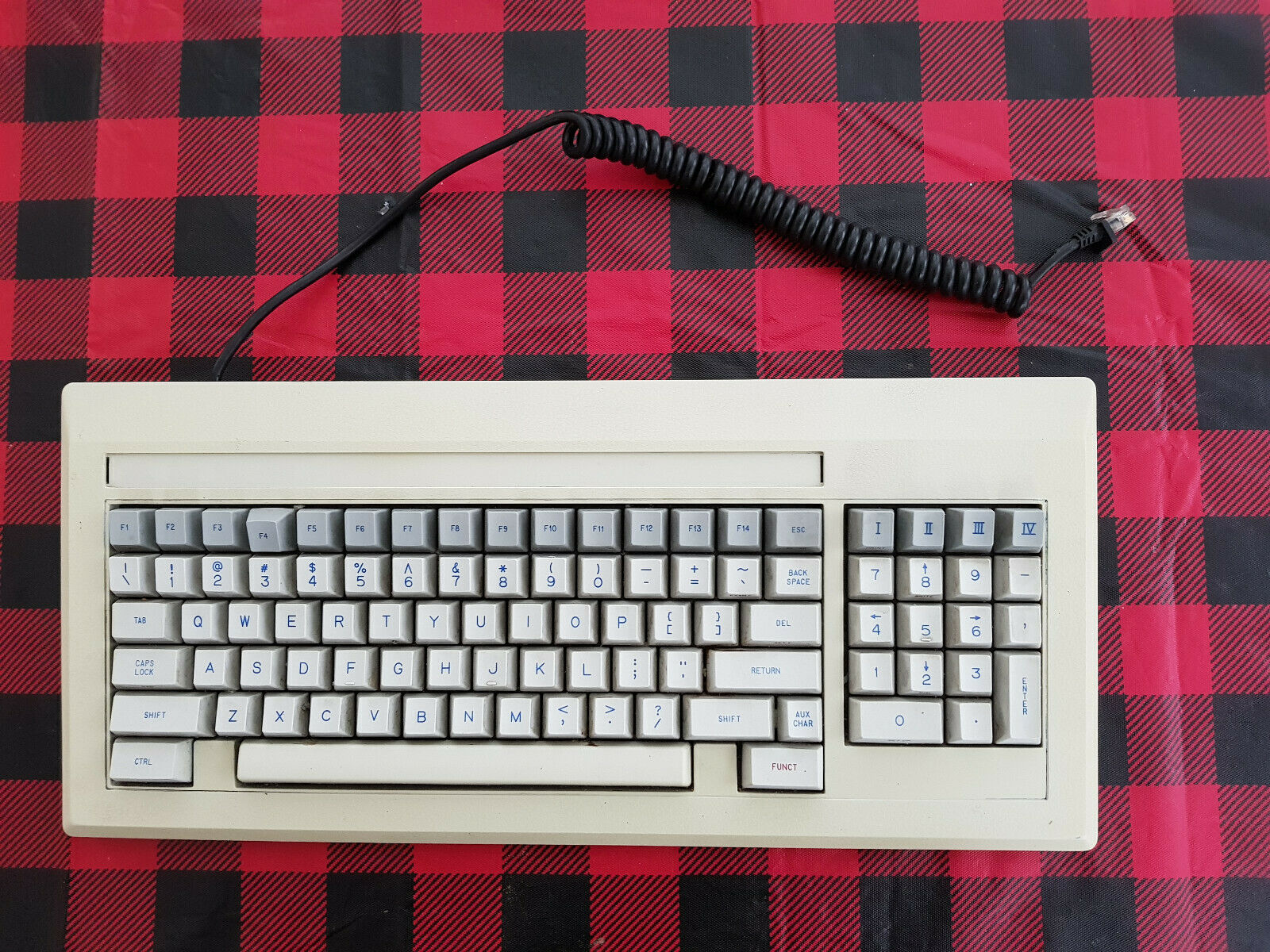

Any idea if I can use an RJ45 Soarer's to convert this bad boy?
Apparently it's a "Basic 4 Terminal Keyboard" or a "KKB25506". No idea what protocol it speaks (hopefully at or xt).- fohat
- Elder Messenger
- DT Pro Member: 0158
Orihalcon is a member here, you might contact him directly.kelvinhall05 wrote: 27 Mar 2020, 03:02
Soarer wrote a specific "WYSE" converter that might work, but it will be trial and error.
If you are incredibly lucky, where the wires hit the board they might actually be labeled as "data" "clock" VCC" "ground" or some variant.

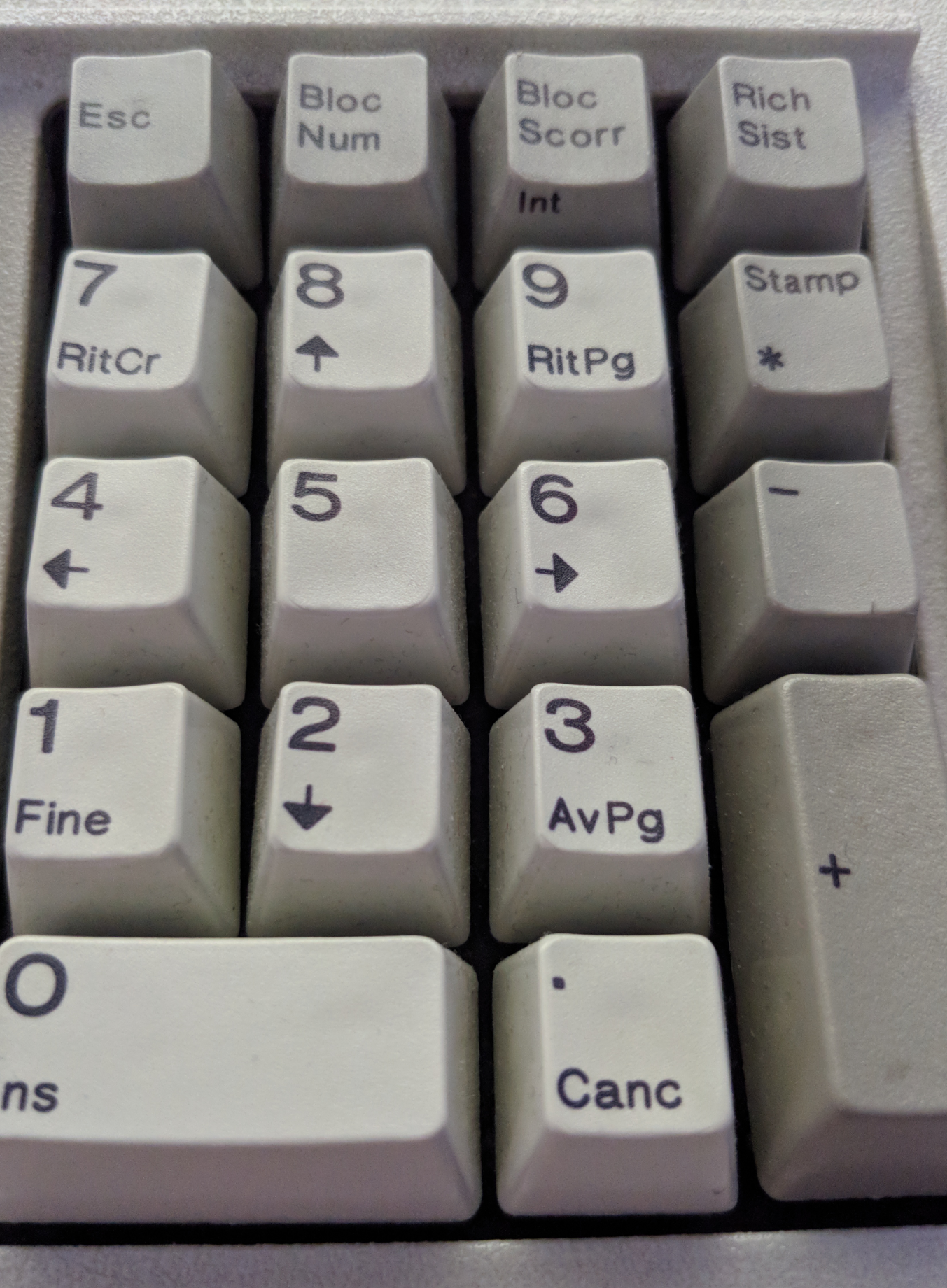

I flashed the latest version on a Teensy 2.0 and built a converter for my AT Model F keyboard (IT layout). I'm on W10.
It works, except for one thing: the "SysRq" key, which used to work as Print, now no longer sends ANY scancode at all (according to KeyboardStateView), and it no longer seems to work in any application in practice. It's dead.
There is a key on the numpad which is labeled "Print" and ' * ', it always only worked
as a * key, never as "Print", and it's still the same, whether numlock is on or off, so it didn't replace the print key. Nothing changed here.
I am confused as to what happened to my SysRq/Print key, the way it worked by default with my PS2 to USB adapter was fine.
How do I fix this?
I have another question: WinHIDListen doesn't seem to work, it runs but doesn't detect anything. Is there a problem with W10 perhaps?
Edit: I found that while WinHIDListen doesn't work, there's a cmd version that does.
With that I was able to find the scancode for SysRq and reassign it.
How do I fix this?

Does this support Wyse boards? Wired it up according to some diagrams and flashed V12. Doesn't work.
- Location: Stockholm, Sweden
- DT Pro Member: 0011
No, this one does not, but Soarer did release another converter firmware that does support most Wyse models. For the WY-50, you should be able to connect his controller firmwarekelvinhall05 wrote: 12 May 2020, 01:03 Does this support Wyse boards? Wired it up according to some diagrams and flashed V12. Doesn't work.
- Location: Canada
- Main mouse: MX Master 3
I tried using that one and it worked but the keyboard was outputting the wrong scancodes for the keys that were pressedFindecanor wrote: 12 May 2020, 01:35No, this one does not, but Soarer did release another converter firmware that does support most Wyse models. For the WY-50, you should be able to connect his controller firmwarekelvinhall05 wrote: 12 May 2020, 01:03 Does this support Wyse boards? Wired it up according to some diagrams and flashed V12. Doesn't work.

Aaand nevermind.
I literally just went outside for a short little bike ride, come back, and it works perfectly. Nothing changed with the converter, just...started working. Hey, I won't complain
