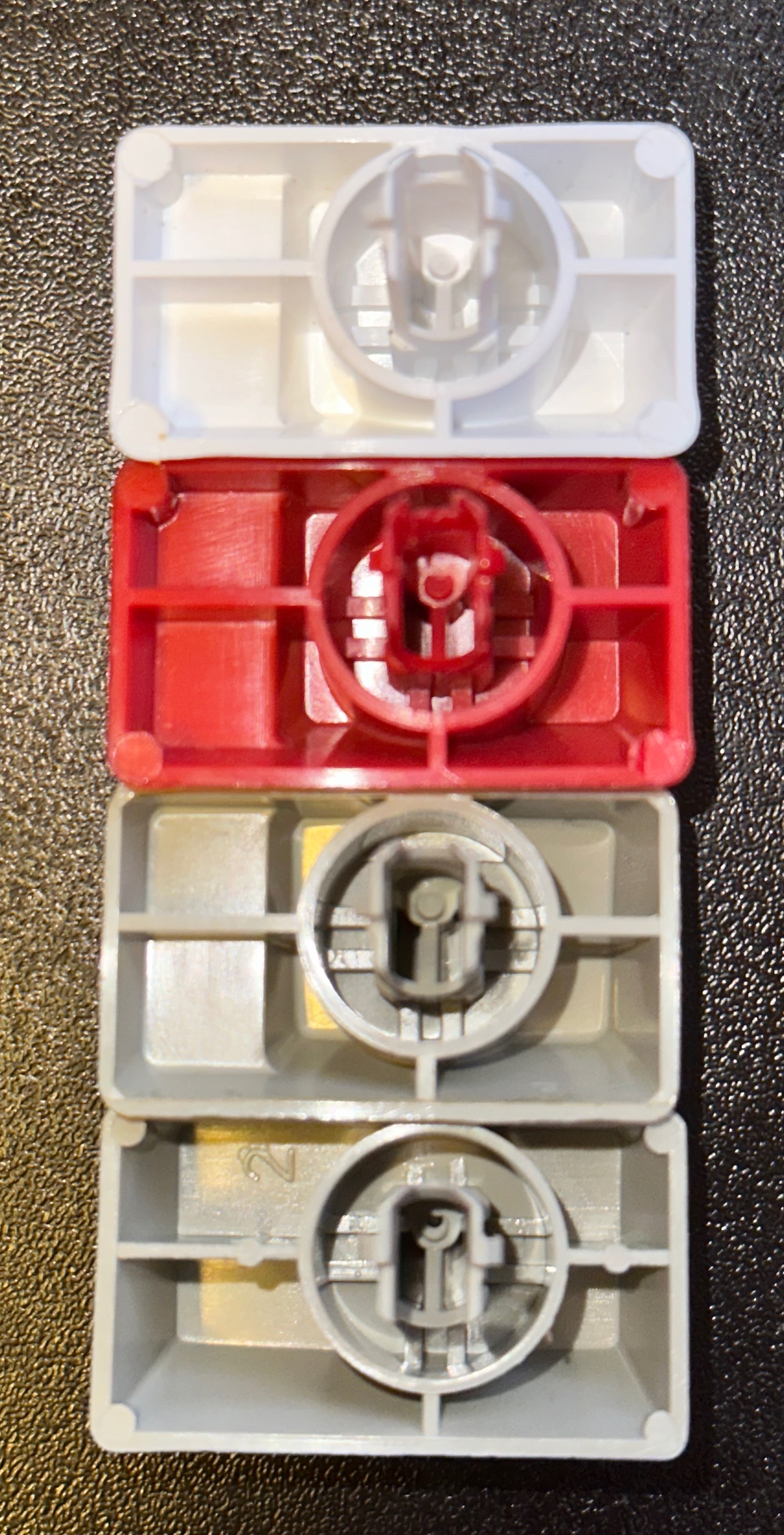

I did a search of the topic and didn't see anyone else ask about this, so here goes. Is anyone else experiencing an issue with Unicomp stepped caps lock keys binding in the F104, and does anyone know how to resolve it? I had Unicomp print red accent keys to match my board and unfortunately the Caps Lock binds when depressed (it does not return up without manual intervention). Right now I am using a gray stepped caps lock from a Lexmark M terminal board which does not bind, but obviously it looks weird. I tried the usual steps for the newly manufactured keys, but that did not resolve the issue.
I attached a photo of the keys for comparison, top to bottom: Unicomp brilliant white, Unicomp red, Lexmark pebble, New Model F pebble. Both Unicomp keys bind, it looks like the red one is older stock because it has some plastic burrs which I have tried to clean up, but even the brilliant white key which is clearly from a newer mold still binds.
This is driving me nuts, so any input would be appreciated.
Edit: Also, Ellipse, since you are monitoring the thread, is there a shipping timeframe estimate for the blank black keyset I ordered about a week ago? I paid for the separate shipping because I didn't want it to sit for however long until my other keyboard ships.

Please check out the video in the manual on the project web site which provides advice for binding keys, including the wiggle method and burnishing the back of the stem.

acfrazier wrote: 09 Jun 2023, 15:23This is driving me nuts, so any input would be appreciated.
So, this might be completely stupid reply. But have you tried removing the keyboard assembly from the case, to better be able to see where the key gets stuck? Since it's a key on the very edge of the keyboard I would imagine that without the case you might be able to look from below in case you can see where it binds more obviously than with the keyboard assembled.
