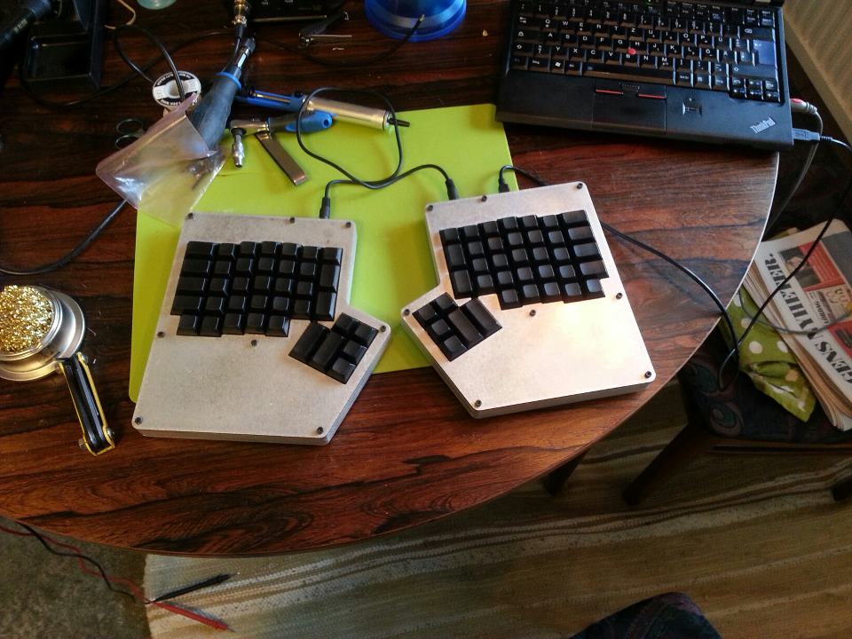

I got mine two days ago, I did most of the soldering yesterday but there's plenty left to do... I've go the aluminum case and it's far from a perfect fit, in the end I'll probably end up spending more time shaping the case then soldering. Happy to do it though, the end result looks promising!

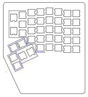

Is there a CAD file of the layer in the case that has the switch-holes?
Check out the "Acrylic Case Designed by Litster" http://www.ergodox.org/Downloads.aspx

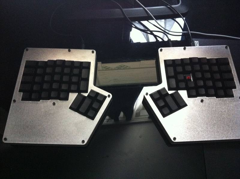

I finished mine today.
Not that many problems during the assembly, but i got a bit scared when i plugged it in the first time... The right hand worked without the left but with both plugged in it would not be recognized as a keyboard at all. It turned out the capacitor in the left bord touched the aluminum case. And they warned about that in the instructions so it was a dumb mistake... Anyway, works like a charm now!
I put on kinesis keycaps instead, i prefer to have them in different profiles instead of all the same.
Do I have to push the button on the teensy to remap the keybord?

Nice! Yes, you need to push the button on the teensy the first time, so make sure the layout you load has a key (preferably in some layer) that programs the teensy, so you can do it without the actual teensy button going forward. I drilled some holes in my top cover, just in case I need to push that button without opening the case. It came handy when I programmed the teensy blinky program by accident
