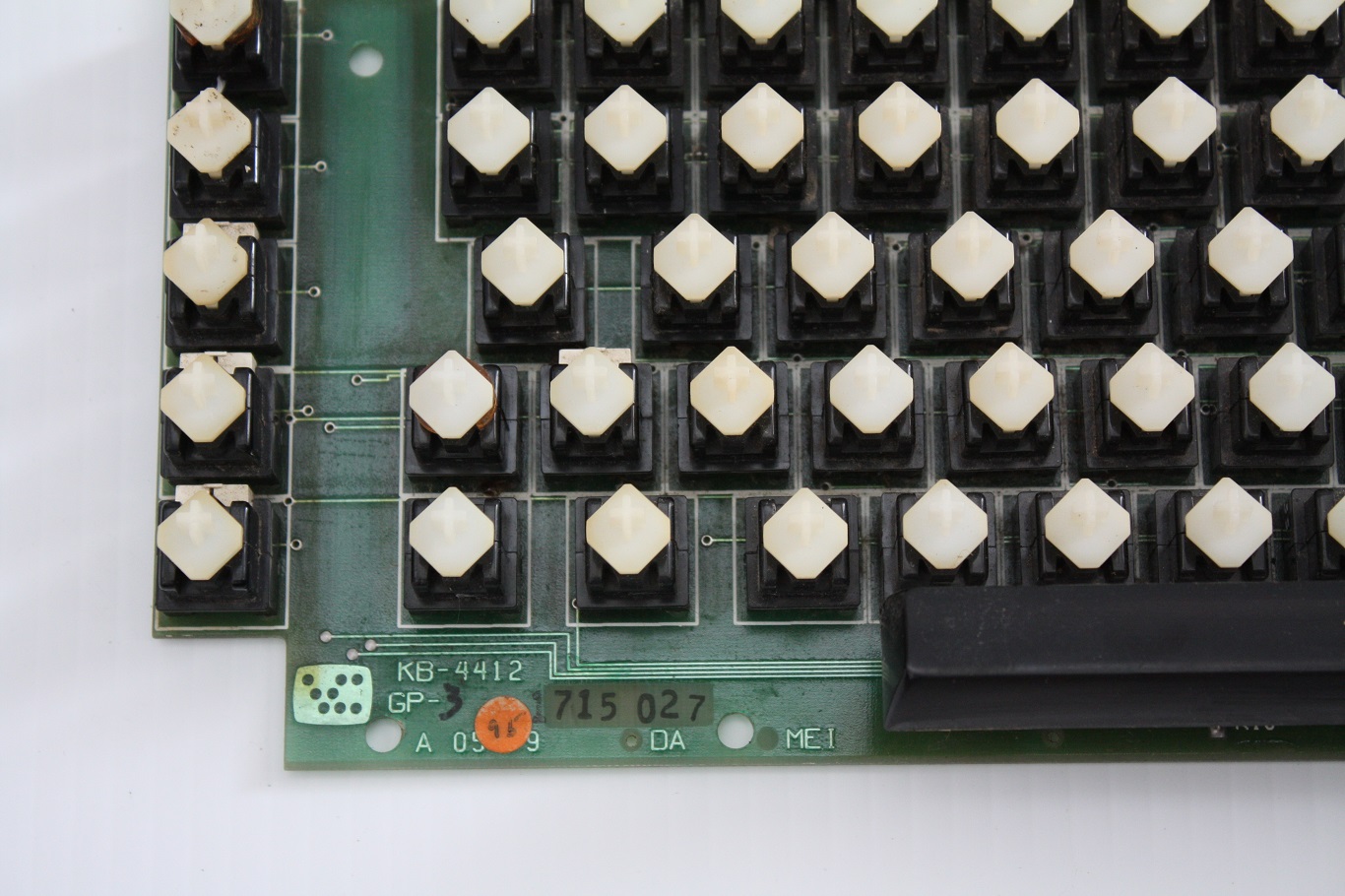

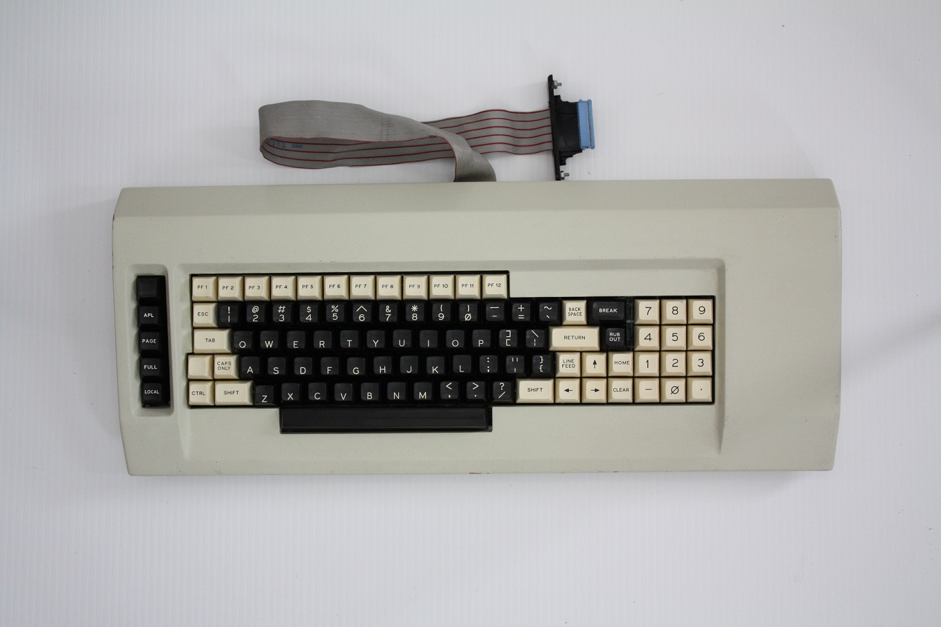

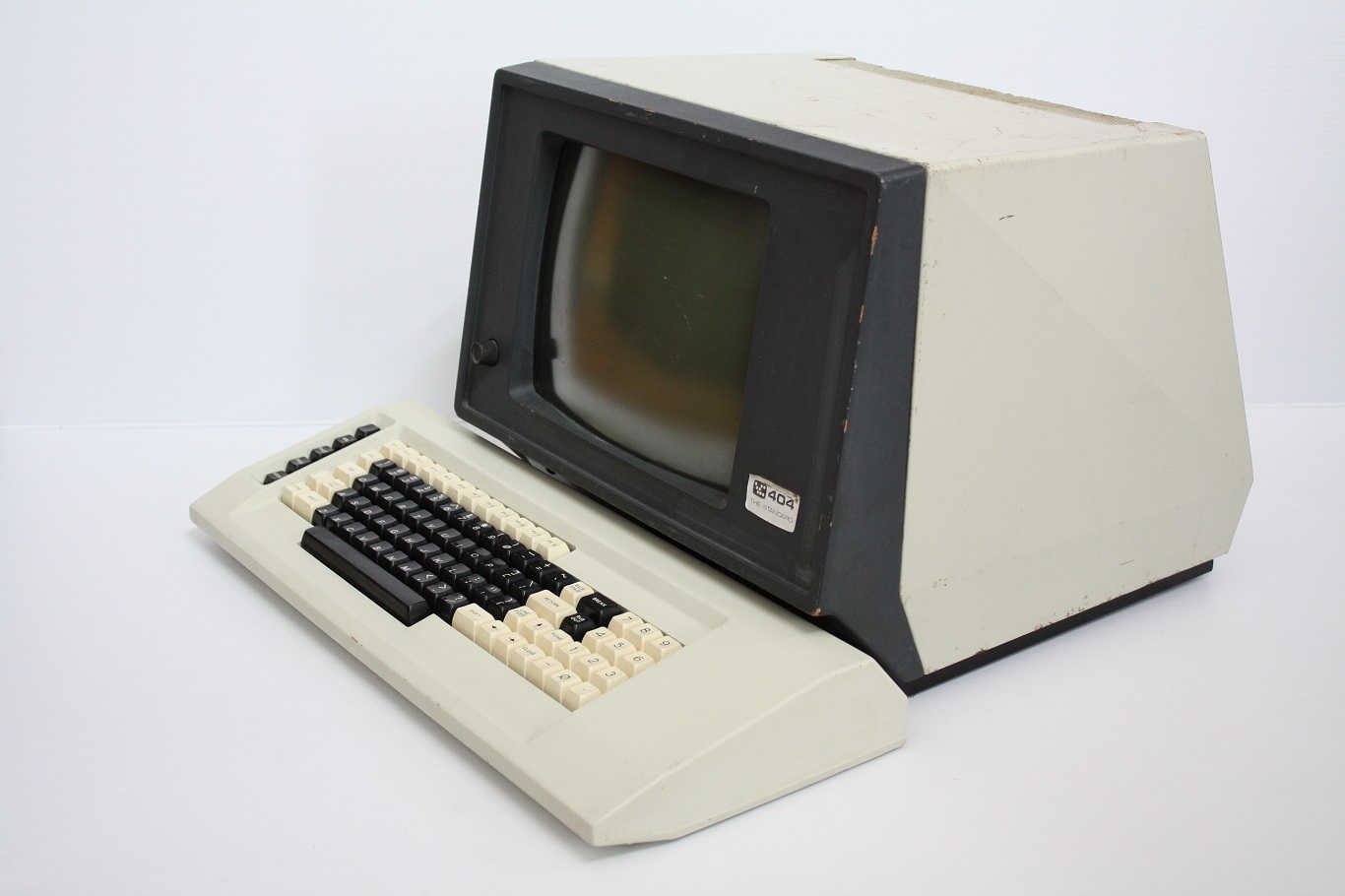

Pictured here is a Volker Craig VC404 terminal keyboard model number KB-4412. Some time ago Haata posted a similar keyboard with MEI switches here. The interesting part of this keyboard is that it has Datanetics key switches. These are the same key switches as on the early Apple II computers and Datanetics was later purchased by Apple. That must have happened after these keyboards were made? There doesn't appear to be a date anywhere that is legible (the case has a date with the year smudged) but the components indicate a late 1979 or early 1980 manufacturing timeframe so that date of the case may be May 8, 1980.
I actually couldn't place these key switches even after searching the Wiki but I remember I saw them somewhere (in my Apple II while I took pics for the post above) but after studying Haata's post above and seeing that "DA MEI" was written on the PCB and Haata's having the MEI switches on his, I looked up key switches starting with "DA" and found the Datanetics; completely realizing at that point where I saw them.

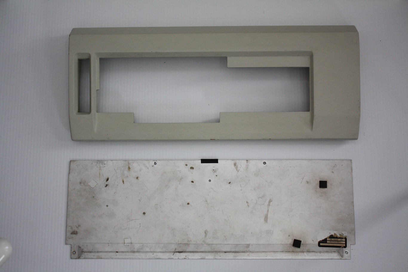

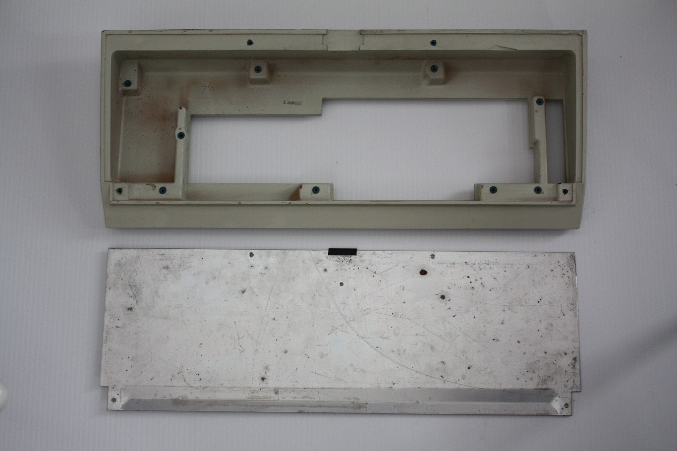

Anyway, one other notable item. The outer case of the Volker Craig keyboard is made from the same material as the Apple II case. It's a structured rigid foam based material that is molded into shape. You can see the screw anchors in the case that help secure the case screws (the Apple II has metal anchors molded into the case).
Anyway, here are some pictures.

Some questions were asked about this keyboard that I need to answer with pictures.

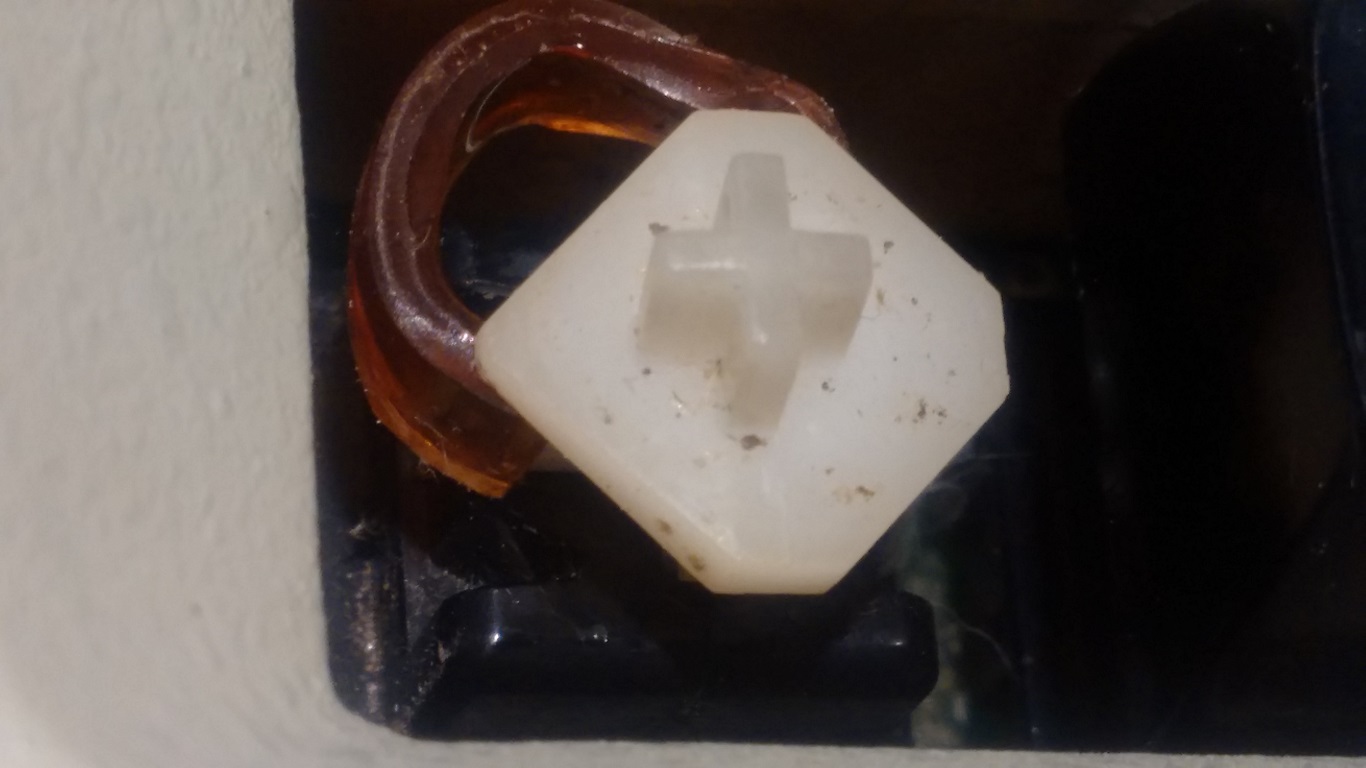

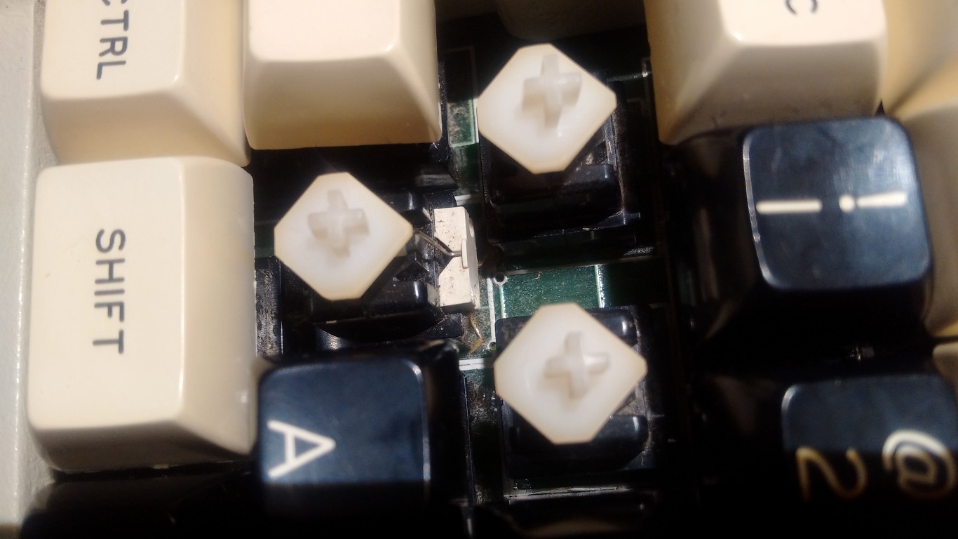

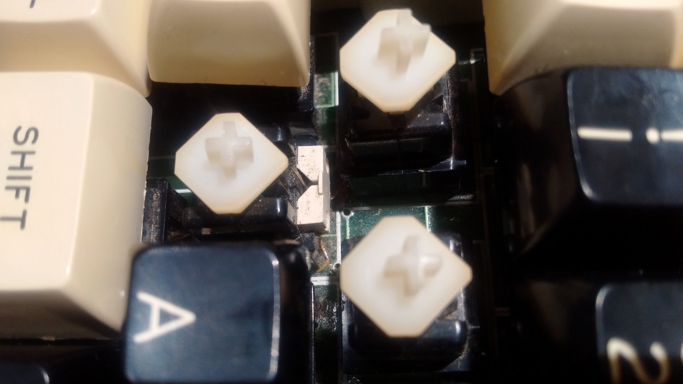

One of the keys was fixed in place. The picture showed an orange collar. This is actually an old clear rubber surgical tube that has been cut to size a split on one side so it can act as a collar for the key switch. the key switch is perfectly functional and is on the keyboard matrix. In fact, this key switch is like brand new and is not dirty at all. From this, I have discovered that these key switches actually do have a very distinct "bump" in the key stem travel and provide tactile feedback. All of the other key switches are fairly dirty so this is not easy to distinguish.

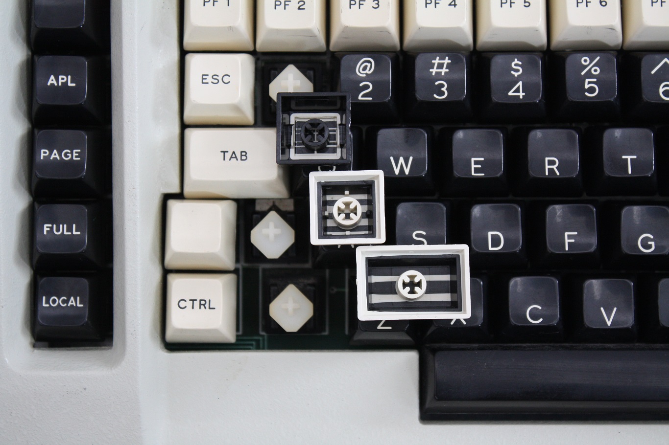

The other observation was the locking key caps. There is a white box on the side of these key switches that position a wire that extends from the top of the key switch stem. Left unlatched, the end of the wire is visible through a slit in the top of that white box. When pressed, the wire end latches midway into that box, holding down the key stem a couple of millimeters and is held in place until the key is pressed again. This, in turn, releases the wire and the key cap becomes fully erect.

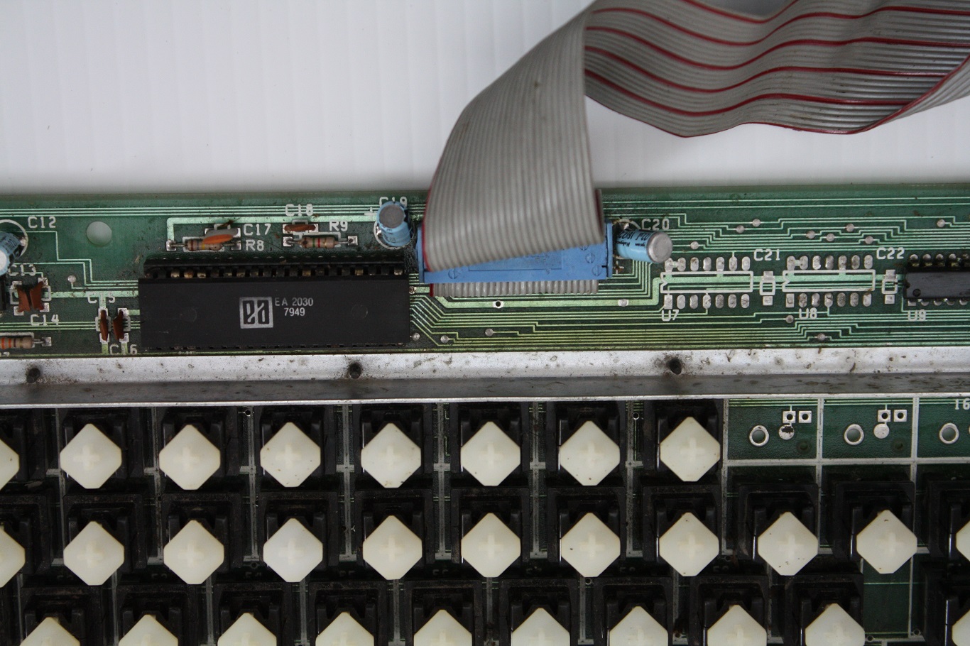

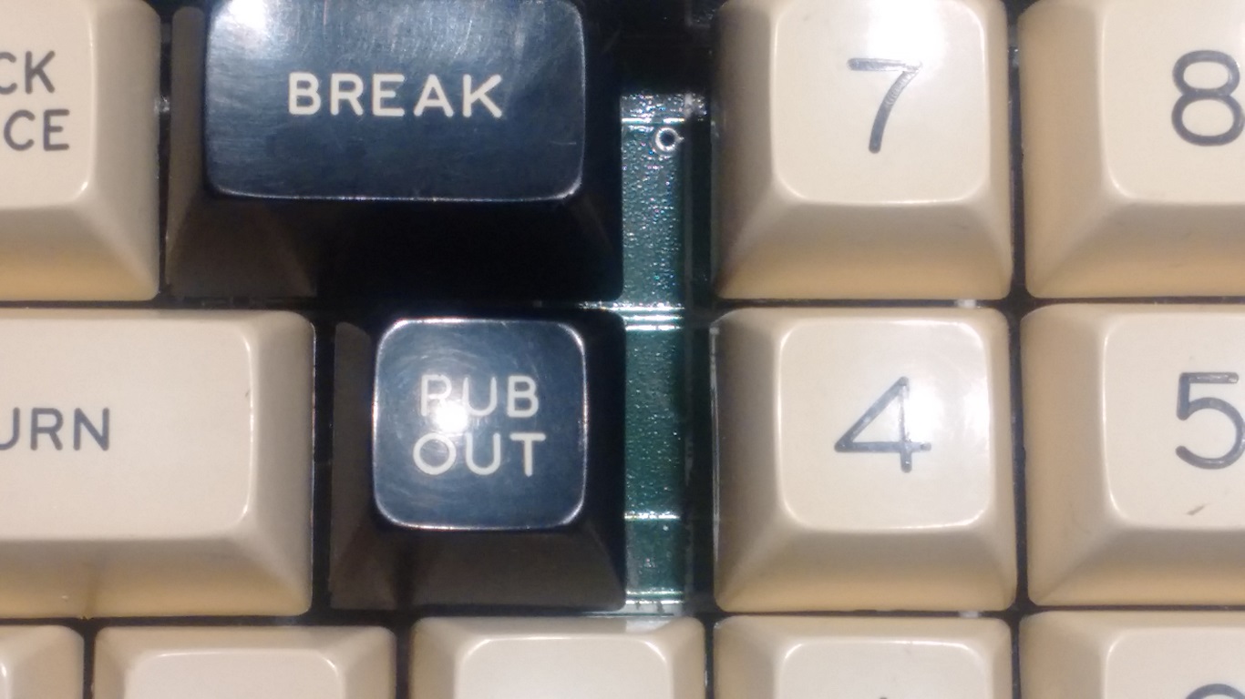

One thing I neglected to mention that appeared on the other KB-4412 keyboard. There is a slight gap at the top of the keyboard between the normal keys and the keypad. The are is highlighted below. I believe the other keyboard has foam in this area and around the perimeter of the key switches. This keyboard had electrical tape to blacken the area so the PCB board was not visible from above! I had to scrape off the dried electrical tape.
Lastly, this matters because these may be the only Datanetics locking key switches as the Apple II didn't have a caps lock key (no lower case back then) and this keyboard has several "toggle" key caps along the left side as well as the locking Caps lock.

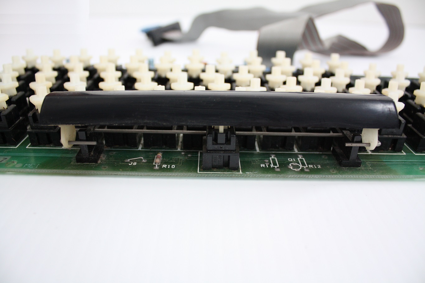

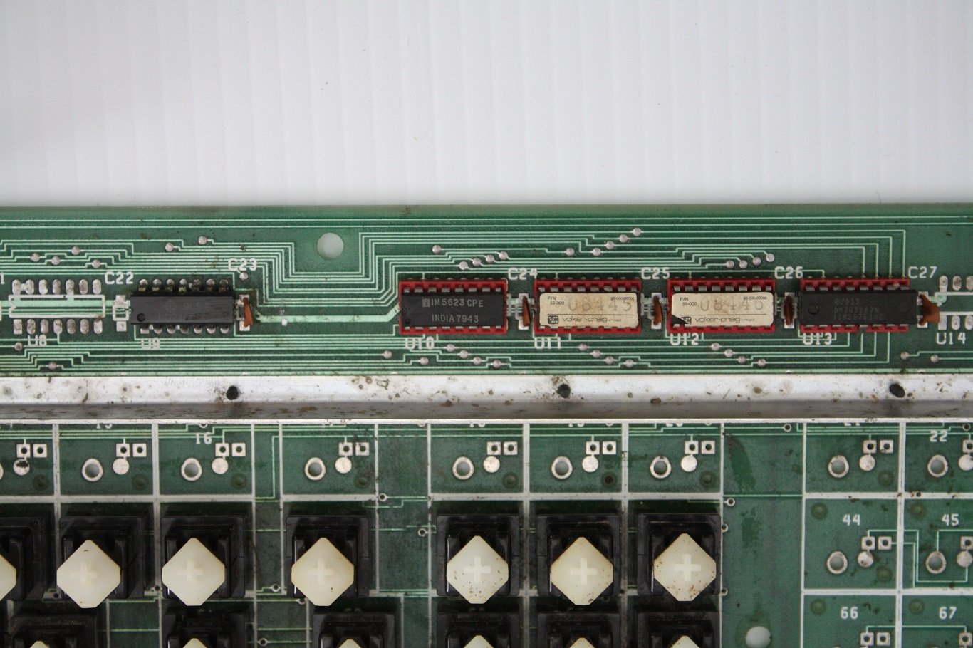

Okay, one more thing that was asked. I forgot to take a picture of the entire PCB board but the large area to the right that is not populated actually contains more keyboard matrix below for additional keys that are obviously not populated. I don't have the proper lighting to take a picture of that at this time but I believe Haata's pictures illustrate this.
Hope this helps.
