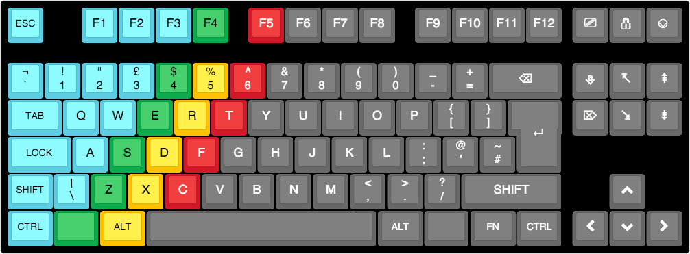

DISCLAIMER: This is my first post. I've never been involved in a GB before, let alone organised one. I just came up with a keyboard design and I thought it would be cool to spread the idea to see if we can make it a real thing.
So, nice and simple. Here it is:
Based on the 1982 Sinclair ZX Spectrum (colours changed to closest SP PBT colours).

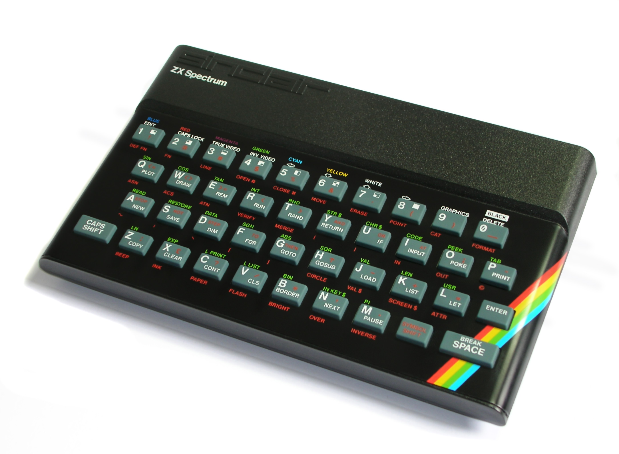

Here's the 80's beauty that inspired it:

I like it. It has some similarity to 1976, but is not too similar. What profile are you planning to do?
Have you considdered reverting the order of the colours to make them identical to the sinclair? What about just one stripe of each (i.e. no big blue area in the top left corner)? I'm just throwing in a few random ideas, not trying to nag abut your design.

Hi! Thanks for the input. It is still a work in progress so your ideas are very welcome!
It is indeed inspired by the 1976
Profile-wise, I'm thinking SA to keep the retro vibe strong. The editor I'm using makes it difficult to change fonts but I'd like to get that closer to the Spectrum too.

AFAIK SP currently has only one font for ABS doubleshots and a second one is currently-ish being funded. They don't do PBT doubleshots, because they don't have the tooling. PBT dye-sub would be an option, but the legends have to be darker than the rest of the key for dye-sub. Your last option would be pad printing, but I don't think you can raise any interest for an aftermarket set with pad printed primary legends.

PBT is my preference, purely for quality of the actual physical key but if there's an issue with the ability to print white on red the ABS would have to do.

it was impossible to get a nice straight looking line across the bottom left corner of the key layout. Just looks way better this way.
Edit: realised you may have meant just swapping the colours in place. Right now, it's as if the board had been physically flipped but I will look at the other colour way that would be created by placing red in the right corner
