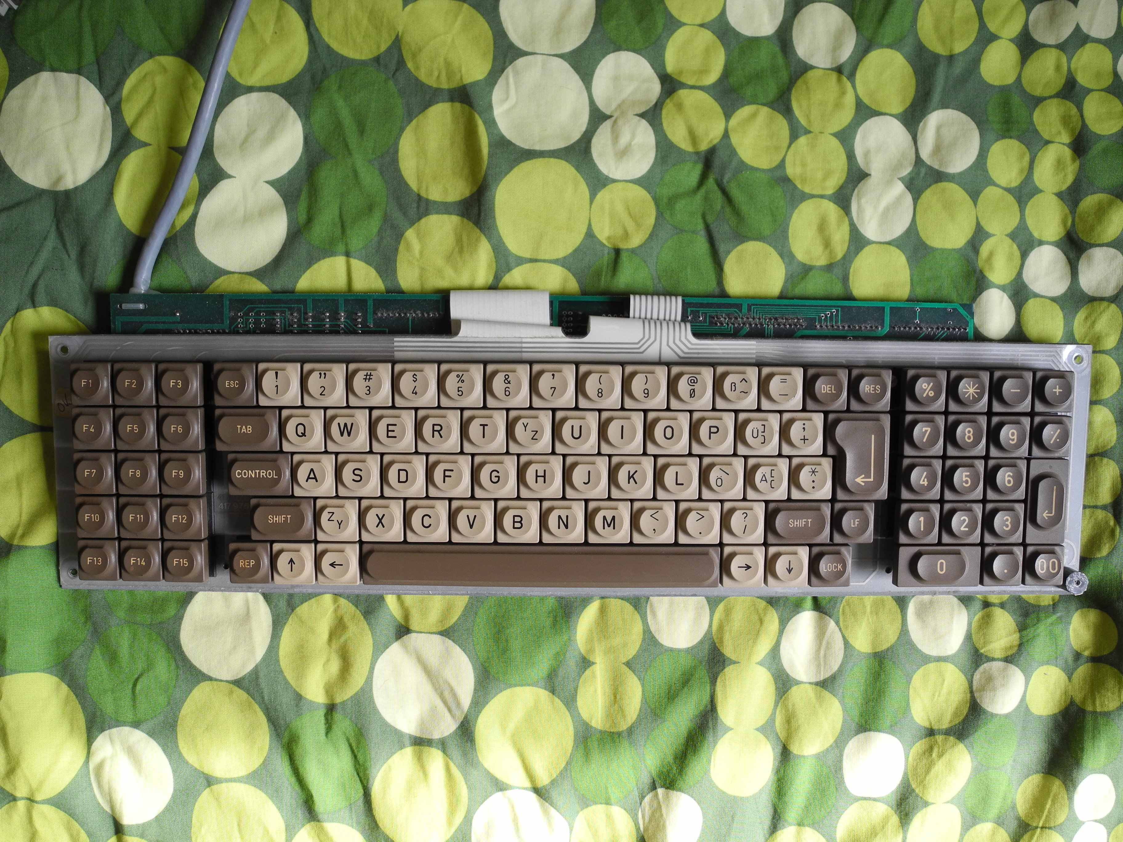

I just picked up an Apple II+ clone with a defective PSU, a very nice amber monitor and two keyboards.

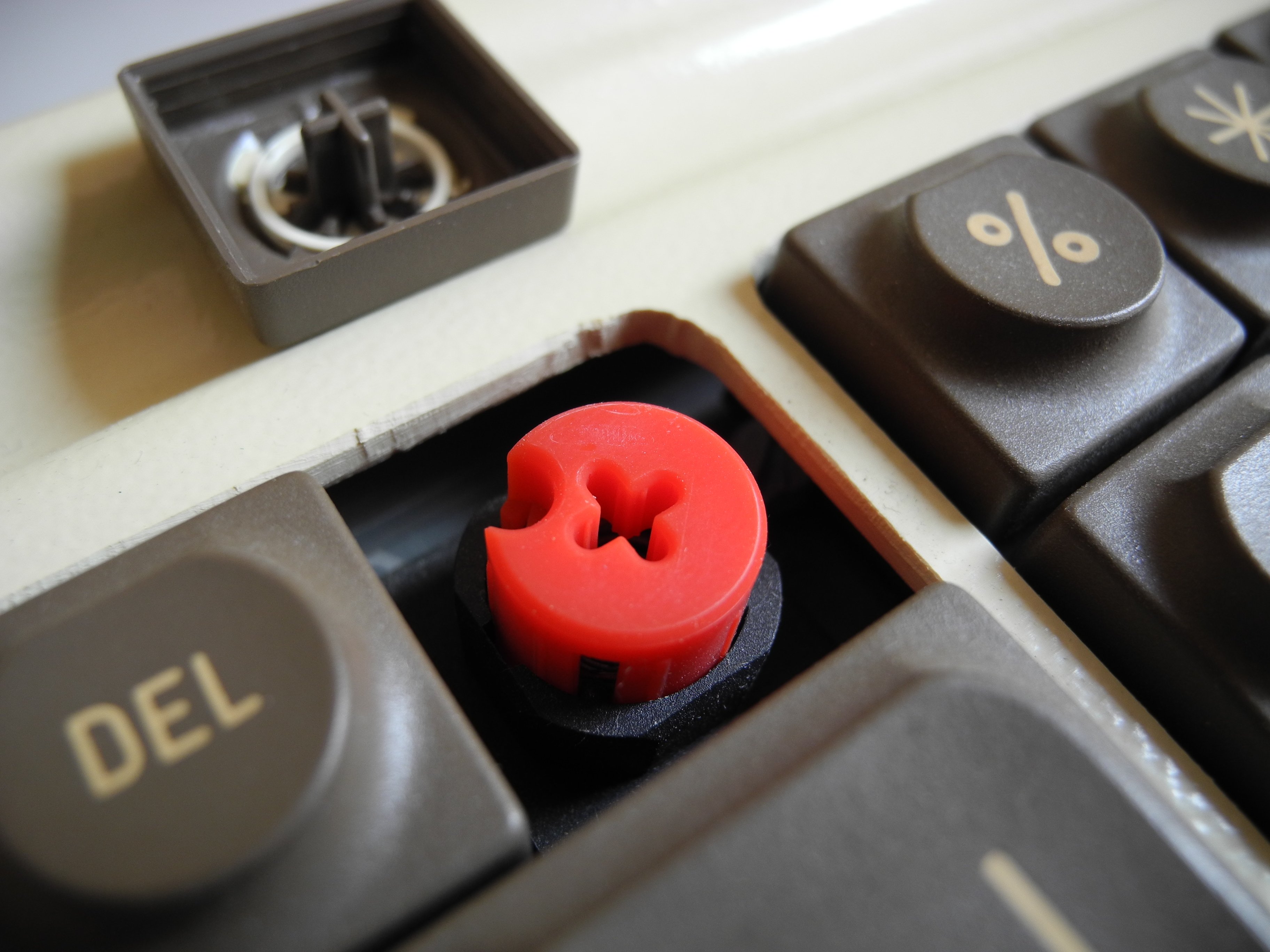

One of the latter is named 'Operator' and seems to sport some kind of Cherry switches with double shot keycaps.
I will recap the PSU and the rest of the mainboard tonight and see if the thing does fire up.
Has anyone seen this kind of switch before? I couldn't find anything remotely similar in the wiki.
The cherry-like board has a linear feel, slightly firmer than a brown MX, but very smooth.
Cherry KB
Cherry KB
Closeup
Closeup

Is the town/city of manufacture given? I'm guessing East Germany, as I don't think West Germany would get away with ripping off Apple like that. In which case, it could be anything from the Soviet era. The Cherry-like switches could be ИЗОТ for example, especially if they are M9-like or M8-like (both of which ИЗОТ cloned).

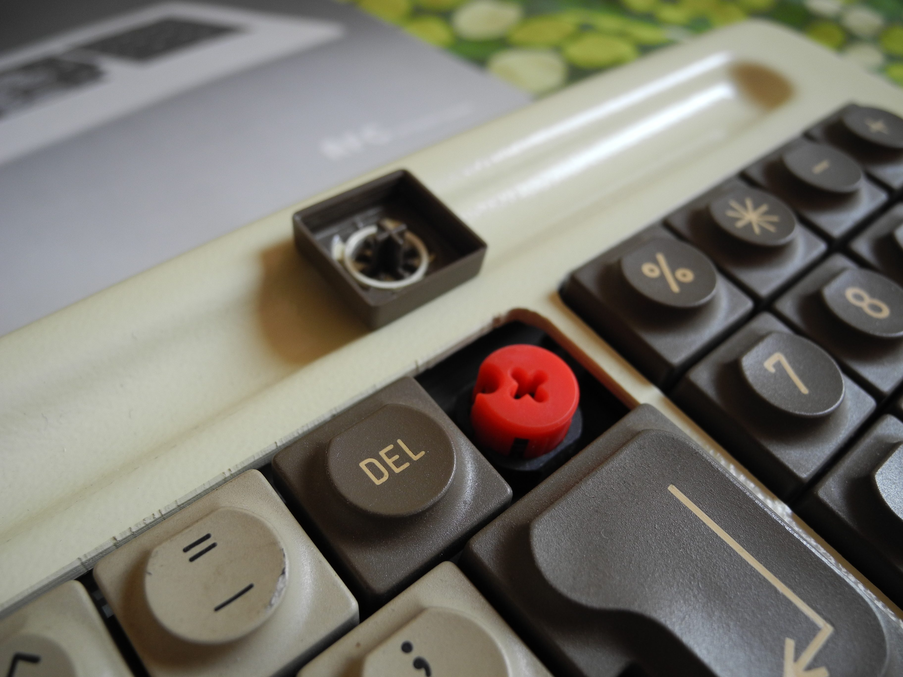

Whatever those red switches are, they look a bit suspect to me. It's hard to tell, but they do appear to be flat base assemblies, rather than a single moulding. I can't see any sign of a PCB though. You should remove a group of keycaps, or open up the keyboard — the PCB may be branded.
The keycaps are reminiscent of Siemens but the shape is different.

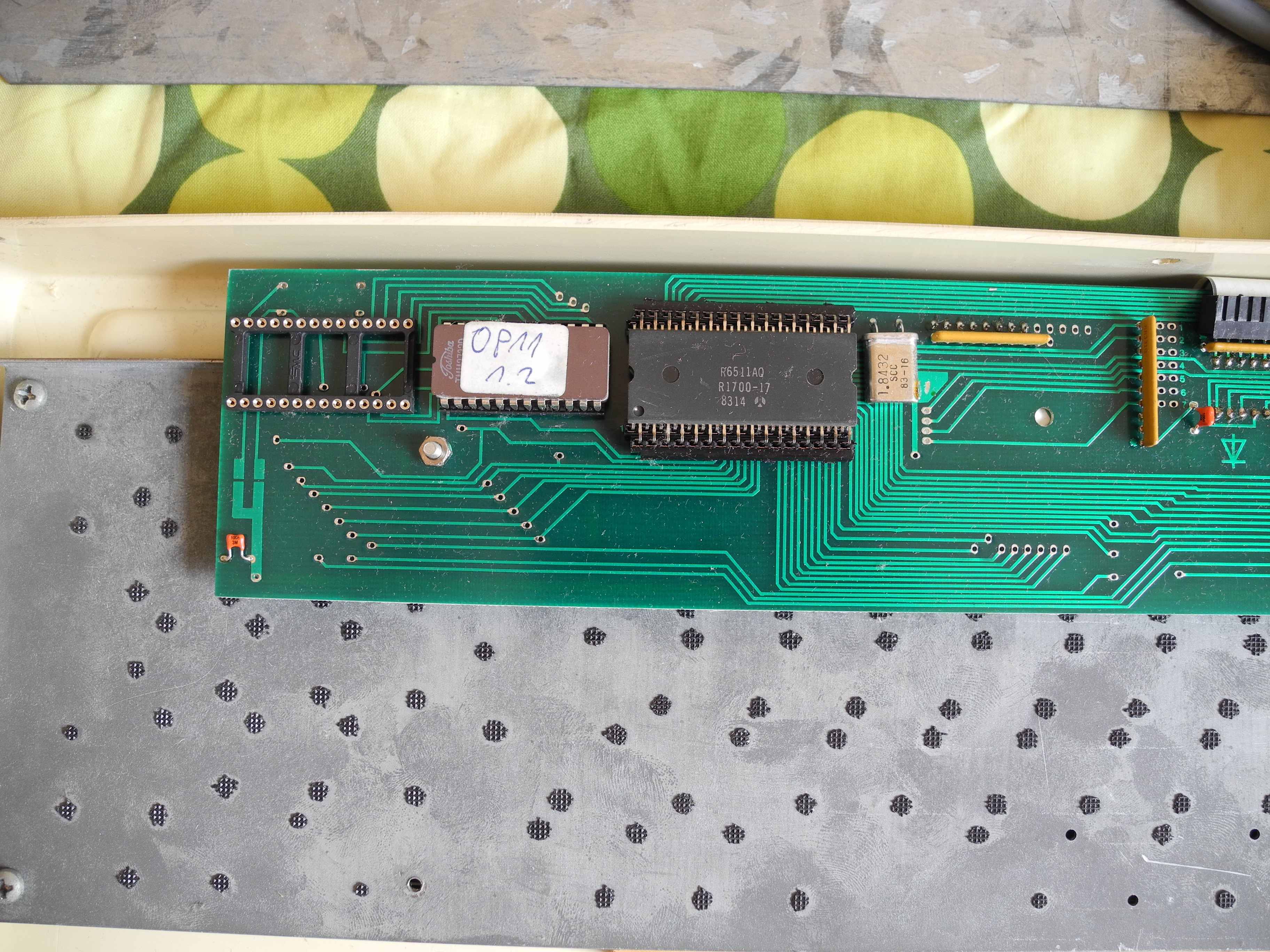

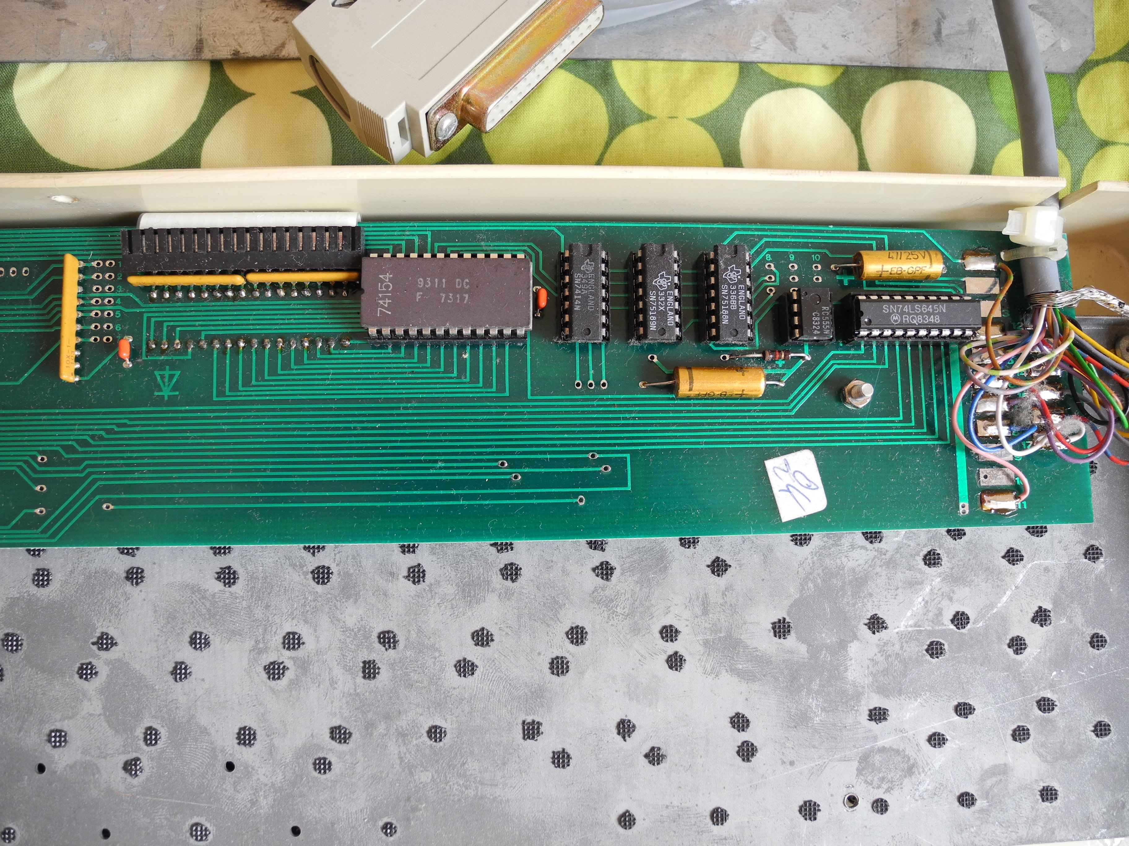

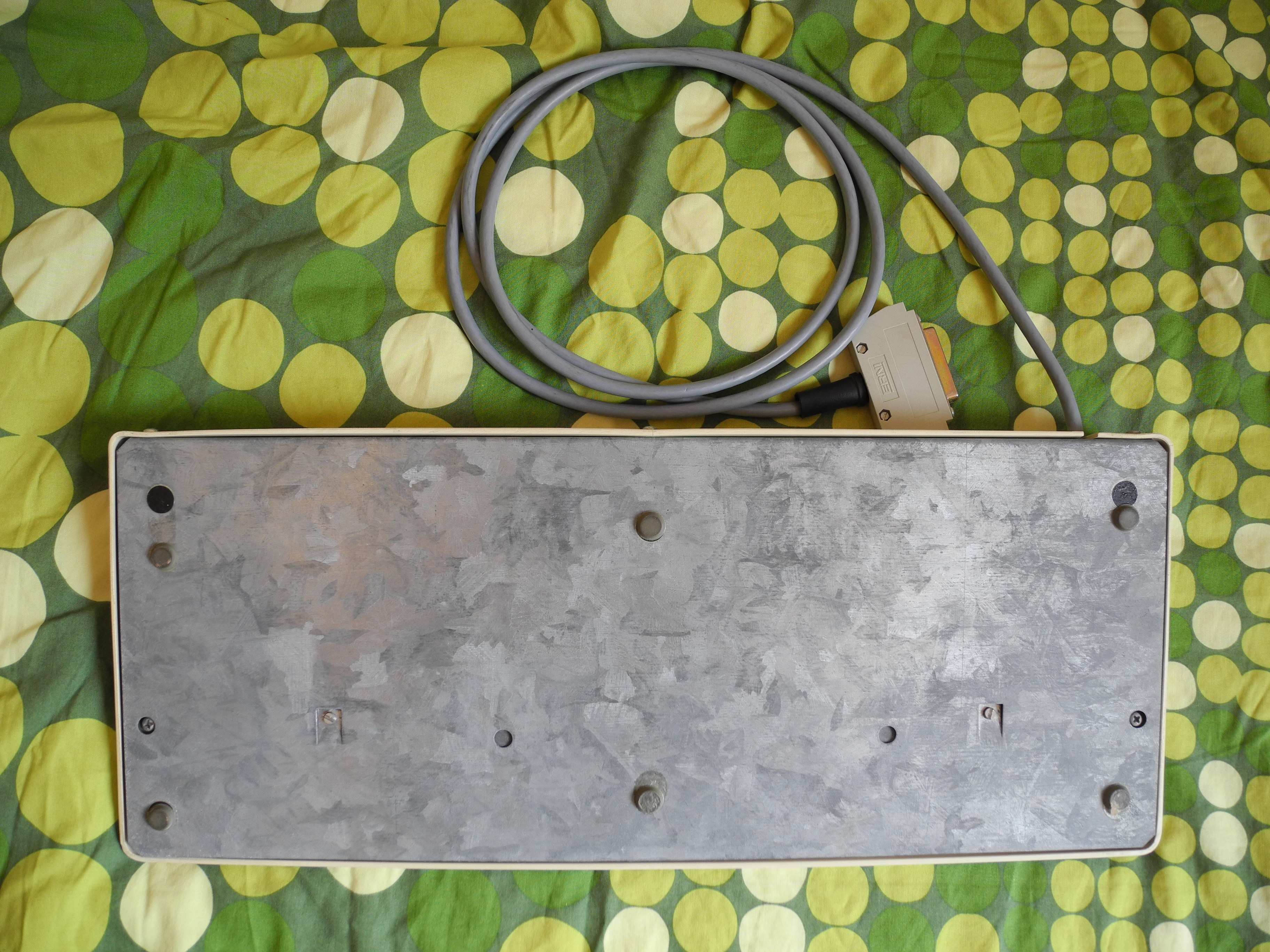

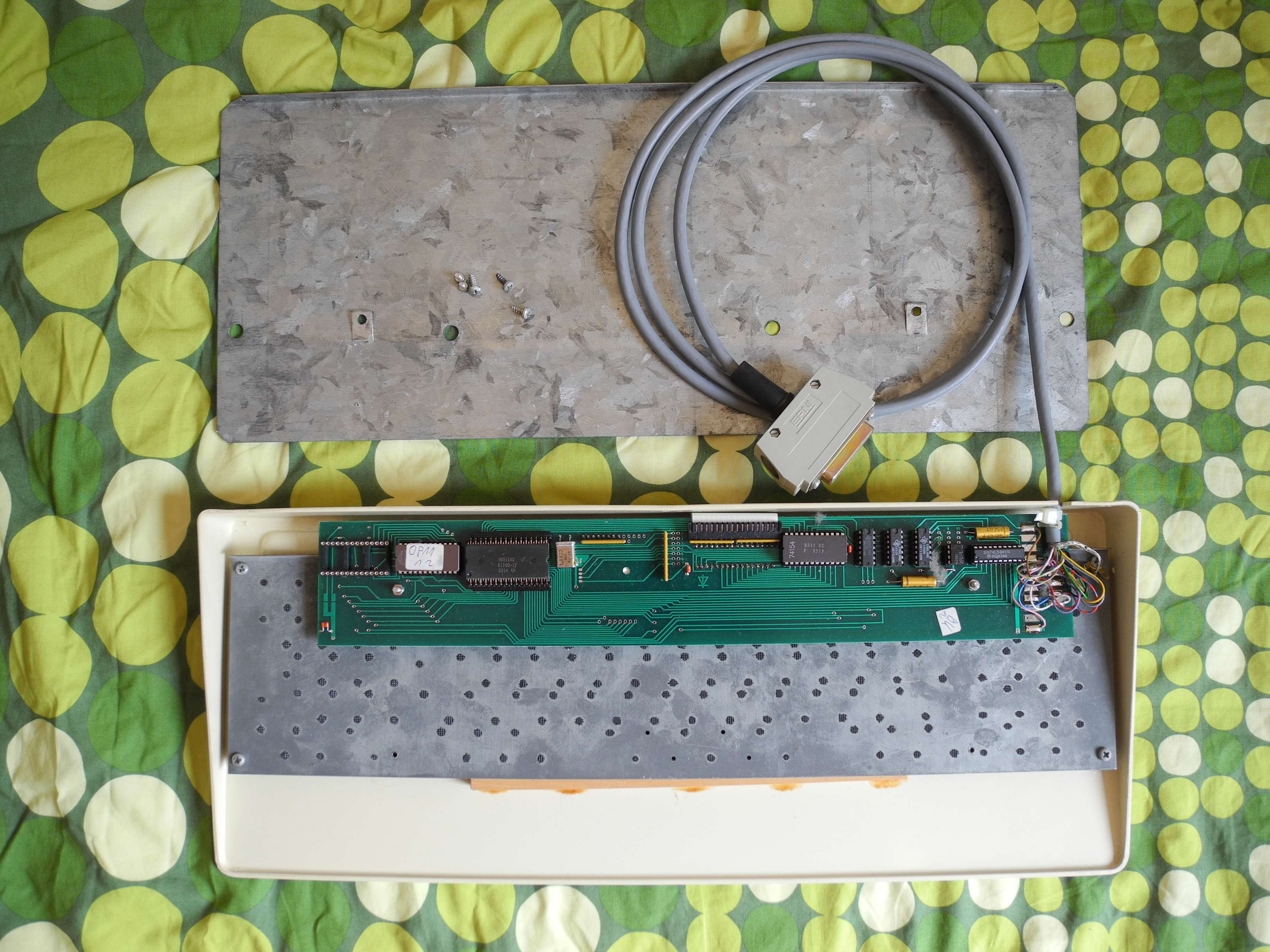

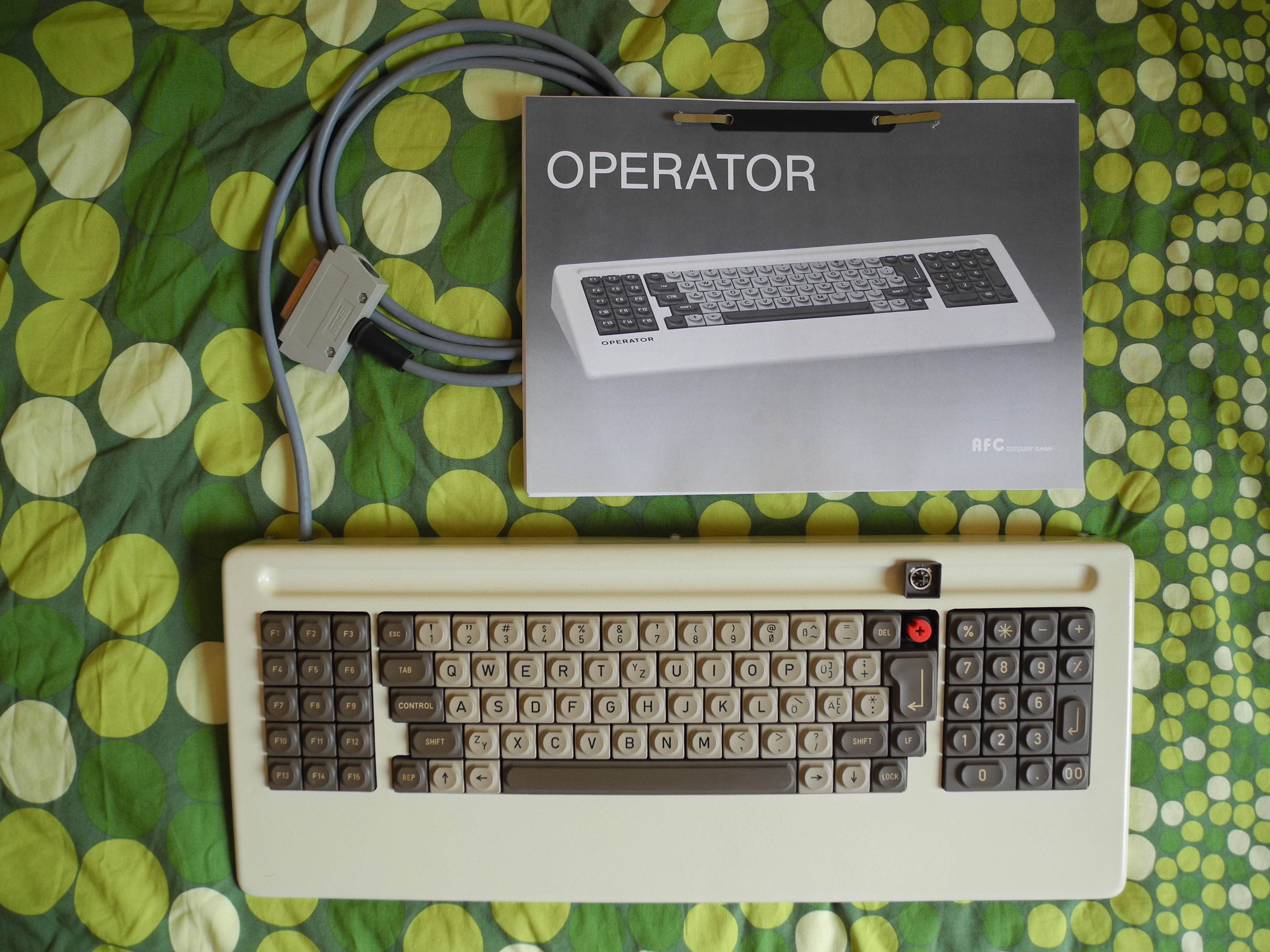

Ha, I know this board, I have the same one in my possession, albeit with different keycaps. I even have the manual, which identifies the manufacturer as AFC from Cologne and the keyboard name as 'Operator'. As far as I can tell this keyboard is from 1983.
The manual tells the user how to connect it to their computer, since this keyboard was made for a multitude of different systems. The numpad and the F keys apparently can be programmed freely by reprogramming the EPROM, it says that text macros are also possible.
The switches on mine are a bit stiff and bindy, I guess there is some dust in them. It's a membrane switch assembly unfortunately, therefore I can't open a switch without destroying the plastic rivets holding them to the bottom plate.

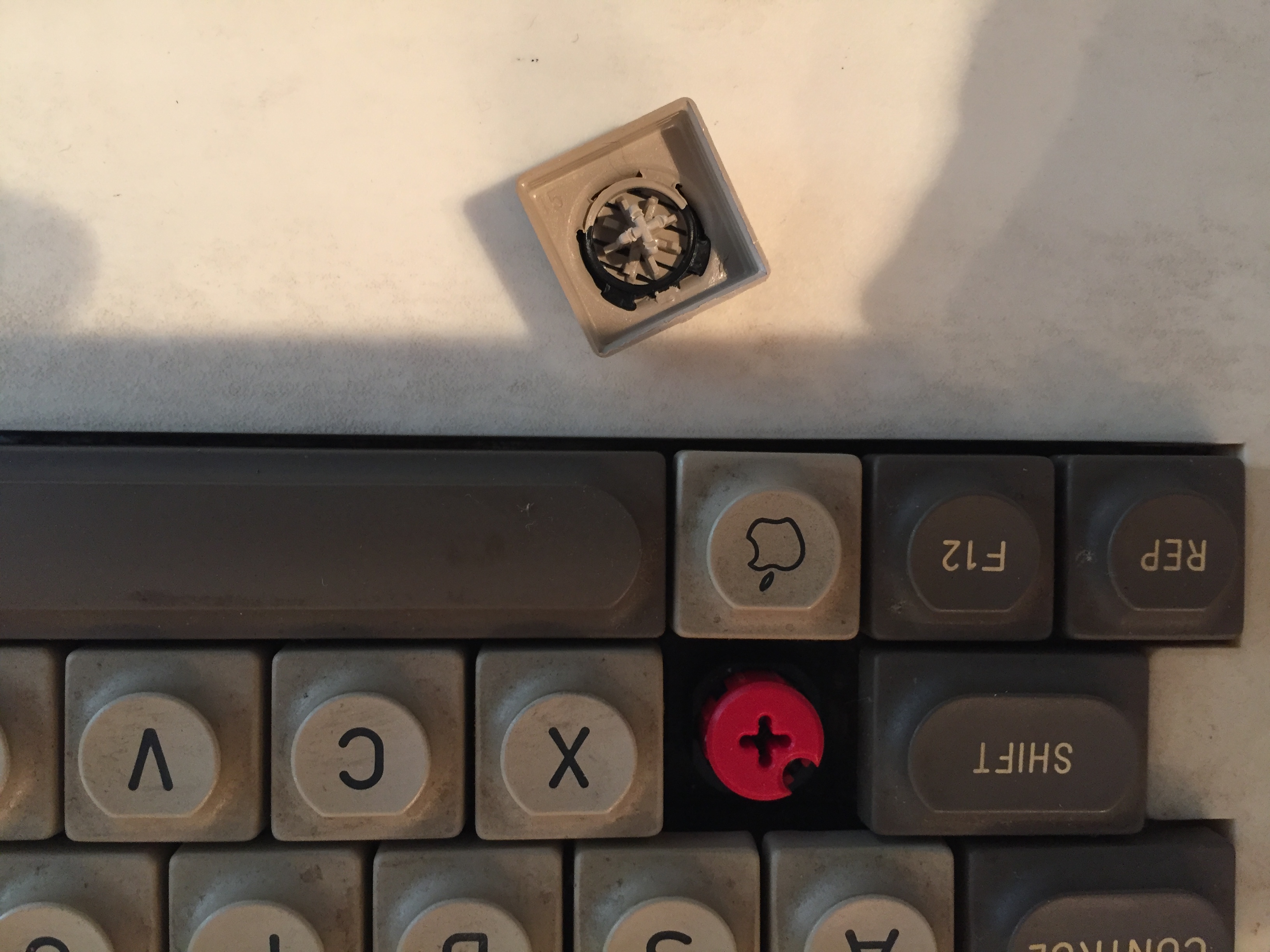

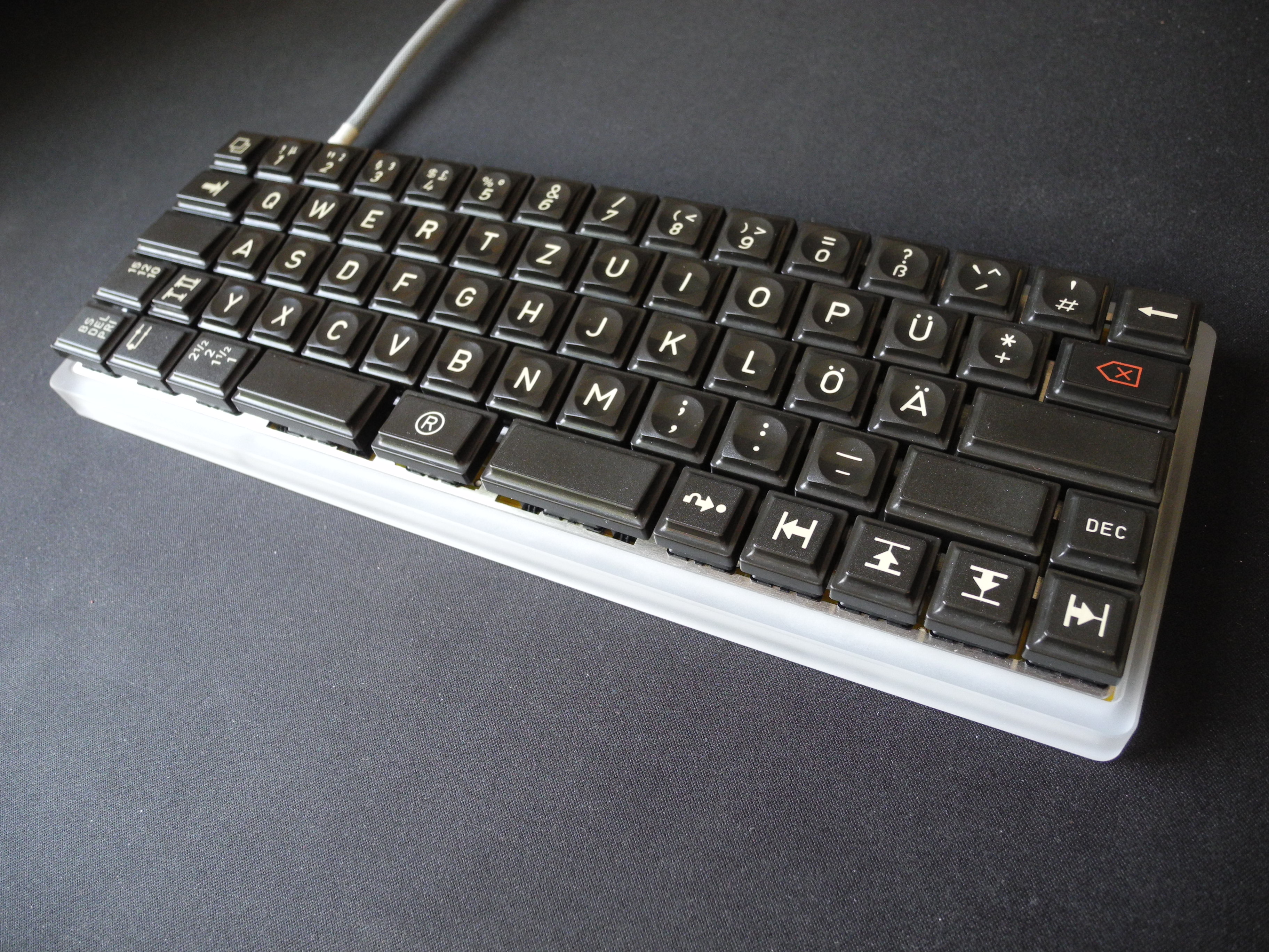

Do you mean the Triumph Adler Alphatronics series? They have the same keycaps as some of their typewriters, but in white/off-white instead of dark brown:
(Shameless plug of my own board with those TA typewriter keycaps)
Not too similar, I'm afraid.

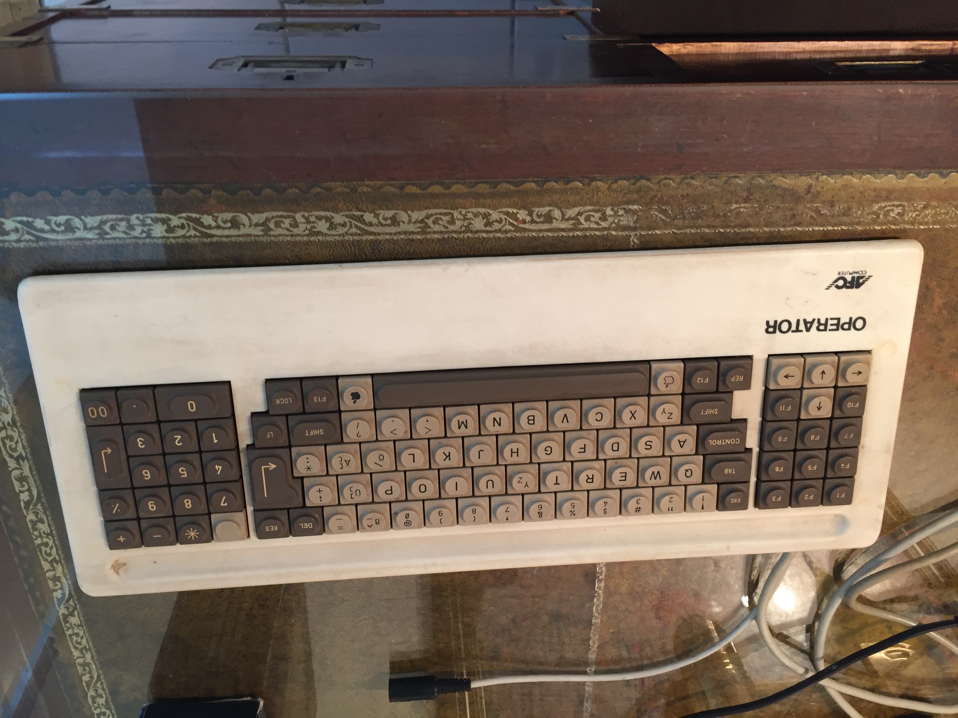

I look for the manual to this keyboard for a long time. I got a (serial) version of it for the "Gepard Computer", and a friend of mine (a parallel) one for the Apple II.
Would it be possible to have a scan of the Operator manual?
