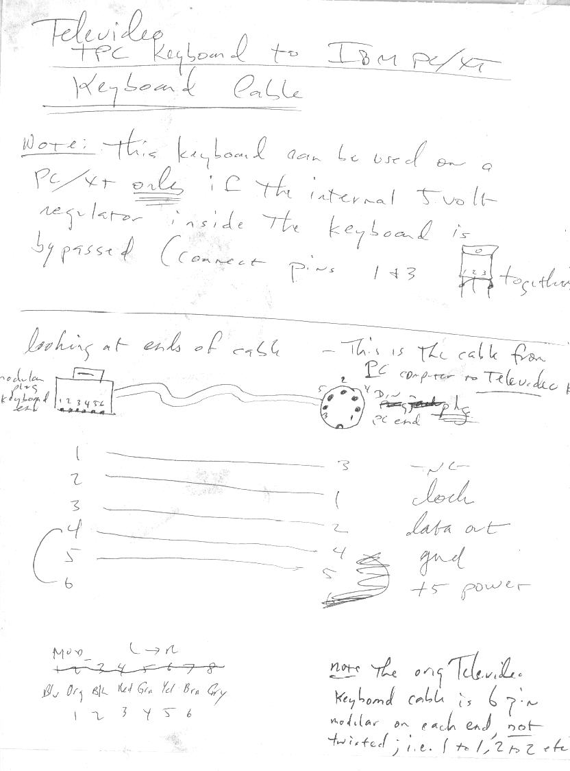

This is for the Televideo PC (vs. terminal) keyboards, Model 803, 1603, 1605, TPC-I, and TPC-II, possibly others. These keyboards use XT scan codes, but have a 6 pin modular connector and run on 12 volts (vs. 5). So a custom cable will allow them to work on an XT application once the internal 5 volt regulator is bypassed. Scan of my old writeup attached, sorry for my complete lack of artistic skills.
edit: 17 August 2019, please see corrected drawing below!
edit2: 29 May 2022 - It has pretty much been confirmed that this adapter does not work on the TS-803 or other Televideo 800-series computers. Those had an "integrated terminal" and used a 970-type terminal keyboard instead.
- TPCKBD.JPG (79.5 KiB) Viewed 13775 times

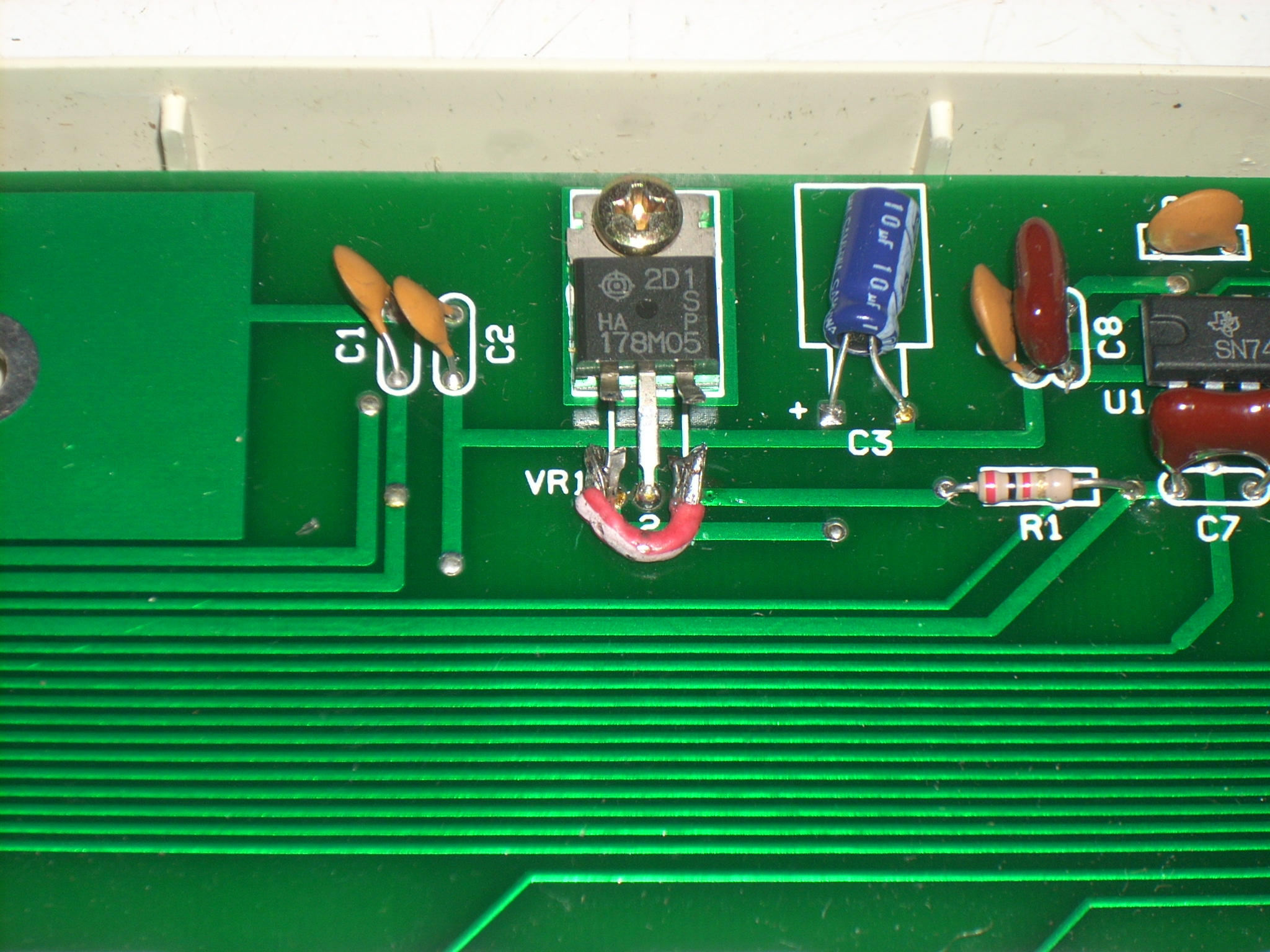

Good suggestion, see attached. Sorry about the $3 camera. This is the TPC-II version, but the others are similar. The 7805/78M05 regulator has three pins. Left to right - input, ground, output. Input is 12 volts, output is 5 volts. Cutting loose the two pins and bridging the input and output on the board allows 5 volts to pass through, giving you a 5 volt XT-compatible keyboard. You can remove the regulator completely, but it's easier to reverse this way. I'd suggest labelling the board so it doesn't accidentally get plugged into a Televideo.
- DSCN0005.JPG (823.89 KiB) Viewed 13669 times

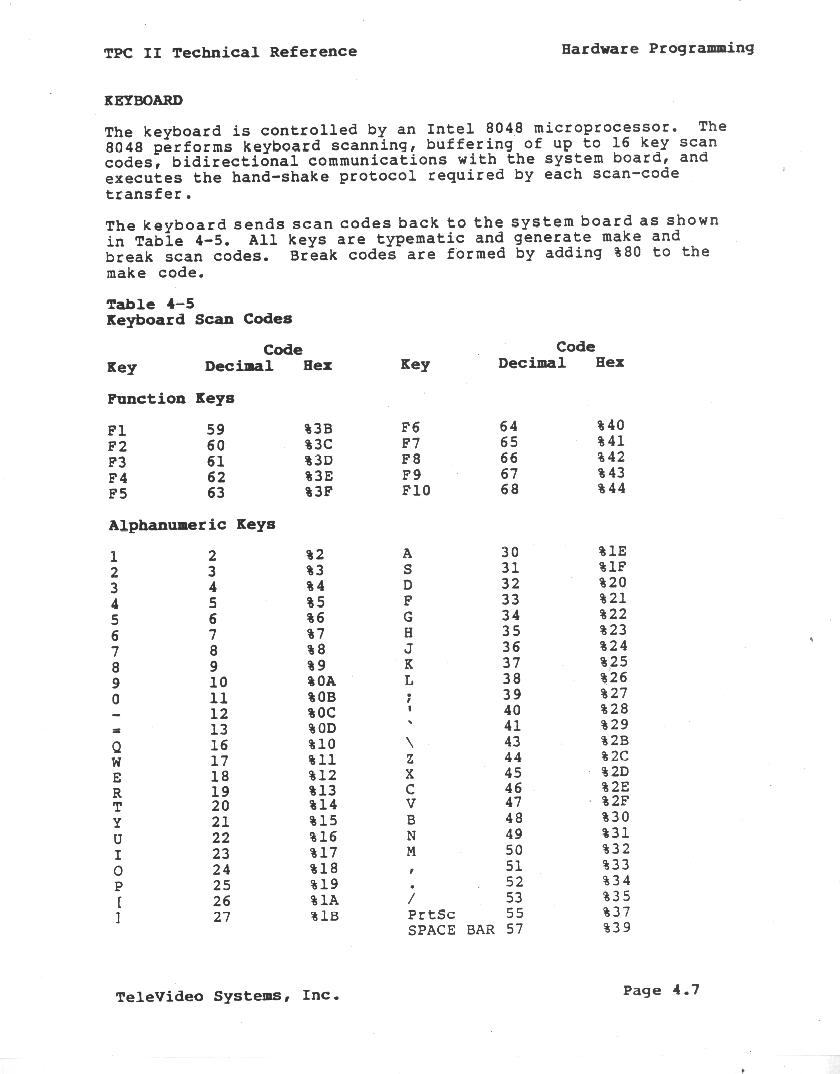

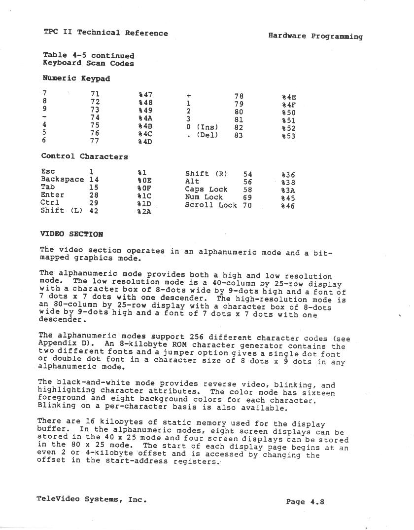

Scan codes from the Televideo TPC-II Technical Reference Manual.
- TPCSCAN1.JPG (84.95 KiB) Viewed 13667 times
- TPCSCAN2.JPG (125.09 KiB) Viewed 13667 times

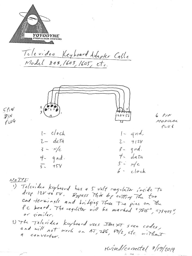

Good catch, I mixed up pins 2 and 3 when I did that drawing. The middle pin should be pin 2 and the far left pin 3, and the middle pin should indeed be connected as the data line, not the far left. Sorry for the confusion!ozzyrulesar wrote: 17 Aug 2019, 16:12 Hello!.

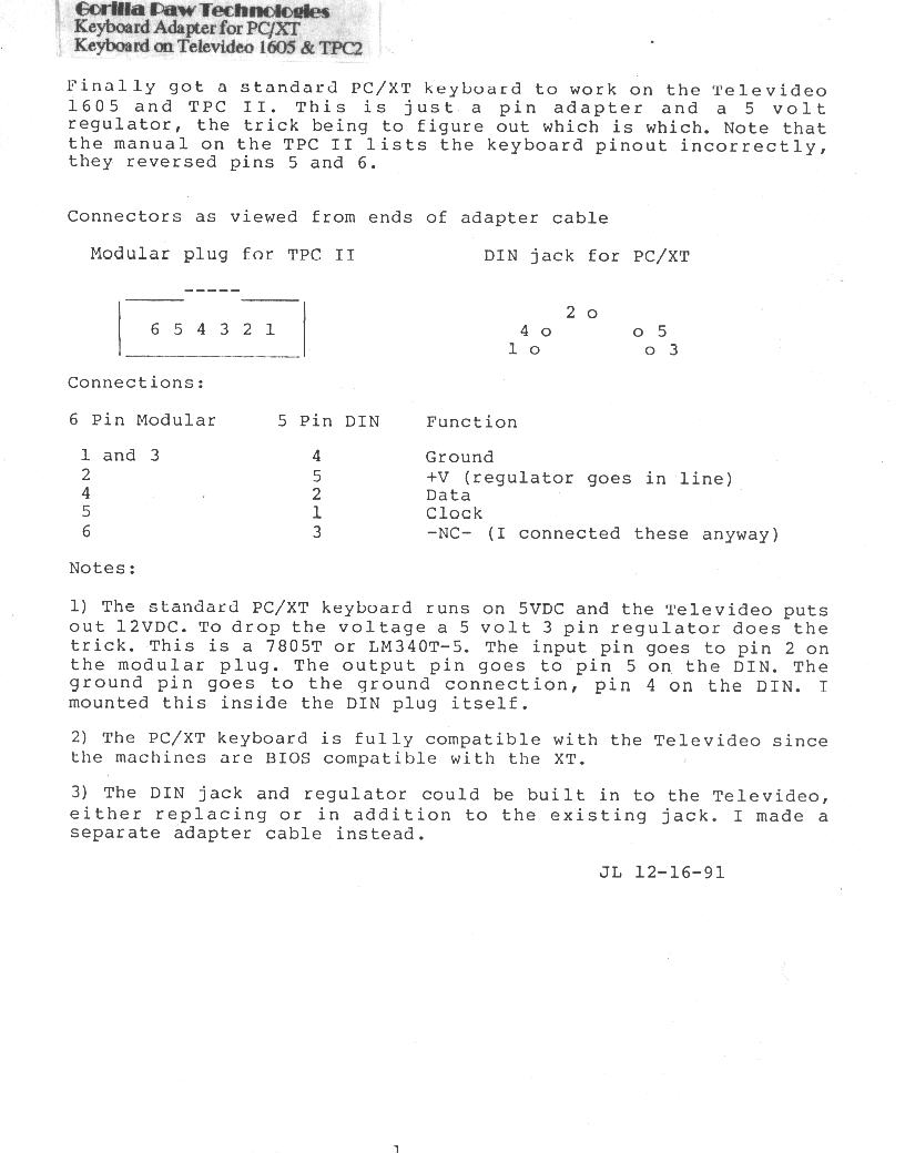

An adapter using a 7805 will indeed work, at least on the TPC2 and the 1603/1605 models. I haven't seen a Senior 2, but hopefully it's the same. I built quite a few of those adapters back in the '90s, and they worked with most PC/XT and clone keyboards. I still have the TPC2 but it's not working at the moment, probably bad caps in the power supply or monitor board. And I have one or two of my old adapters here someplace.

Let's try this again. Took me 3 minutes to redo the drawing and 45 minutes to get the P1 that runs my ancient scanner to boot. Seems the cat has been back there unplugging cables again.
Again this adapter is to run the Televideo keyboard on an XT connection. You can run an XT keyboard on a Televideo PC by building a cable with a female DIN connector instead of a male. You'll need to use a 5 volt regulator in the adapter or inside the keyboard to drop from 12 to 5 volts. The Televideo keyboards used a 6 pin modular cable, with straight- through connections, so you just need to use a female DIN5 instead of a male on the other end.
- revised version
- TELEKBD2.JPG (75.2 KiB) Viewed 13107 times

I've been doing some reading online, and one reference says that the 803 keyboard (CP/M) is not compatible with the PC/XT compatible Televideos such as the 1603, 1605, and TPC2. So if that's indeed true the above won't apply to the 803. The 1603/1605 (big gray wedge) and TPC1 and TPC2 (beige and gray latching portable case) keyboards are electrically compatible with each other, and are compatible with PC/XT keyboards other than the voltage difference.
I have personally used XT keyboards on the 1605 and TPC2 using a reverse adapter with a 7805 voltage regulator inline. I built quite a few of those adapters back in the day, and even sold a few to a local dealer who sold and leased Televideo PCs. And I have also used TPC2 and 1605 keyboards on XT clone computers (with a cable adapter) after bypassing the internal regulator. The 803 info above came from a customer in a former life, not confirmed, so that may be bad info. The only Televideo PC I still own is a TPC2, and it's not currently working. I have two of the keyboards for it, one NIB, and also the Technical Manual that came with it, if that helps anyone. Here are a few links with more info on the Televideo PCs. Note that none of the early Televideo terminal keyboards are compatible with the Televideo PCs, which is not a surprise.

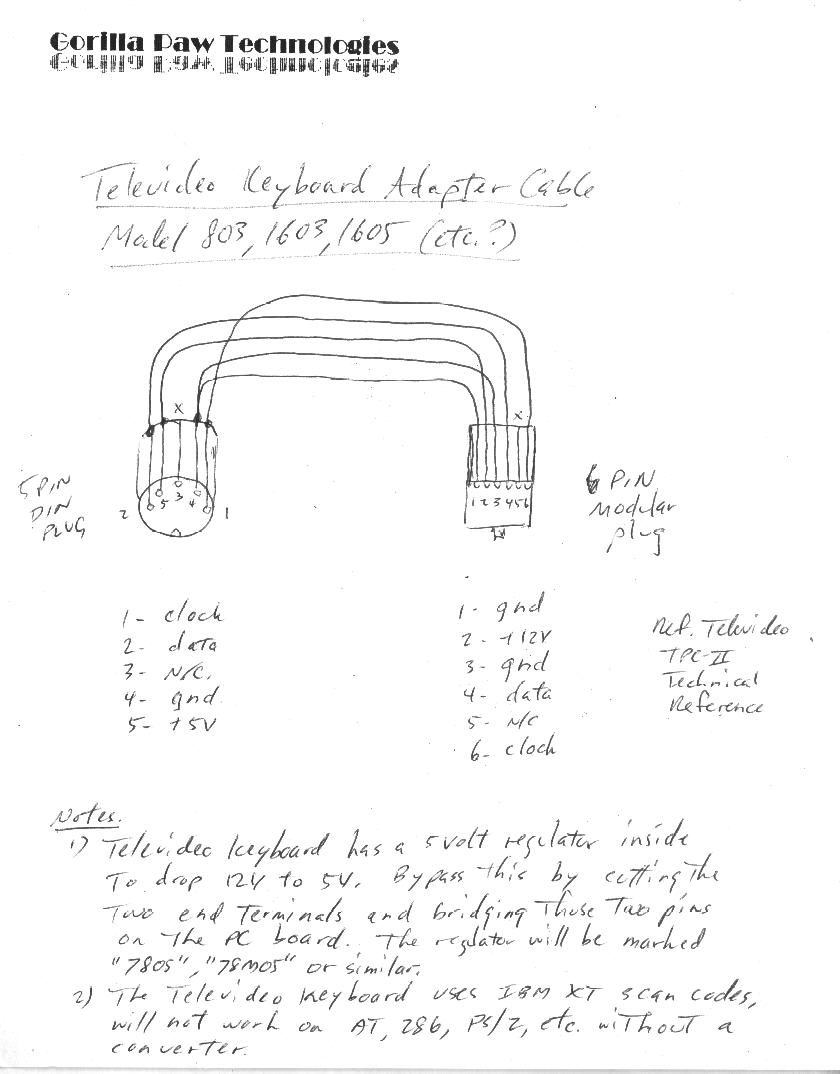

Doing some spring cleaning and quite by accident stumbled upon my old notes on the Televideo keyboards. Naturally the paper copies survived while the old digital versions are buried on some old PC that probably no longer works. Thank goodness I didn't fall for the "paperless office" propaganda! These notes cover both versions--Televideo computer with XT keyboard, and XT computer with Televideo keyboard. Both are from 1991 or thereabouts.
- TPCKB2.JPG (77.37 KiB) Viewed 12996 times
- TPCKB.JPG (95.83 KiB) Viewed 12996 times
