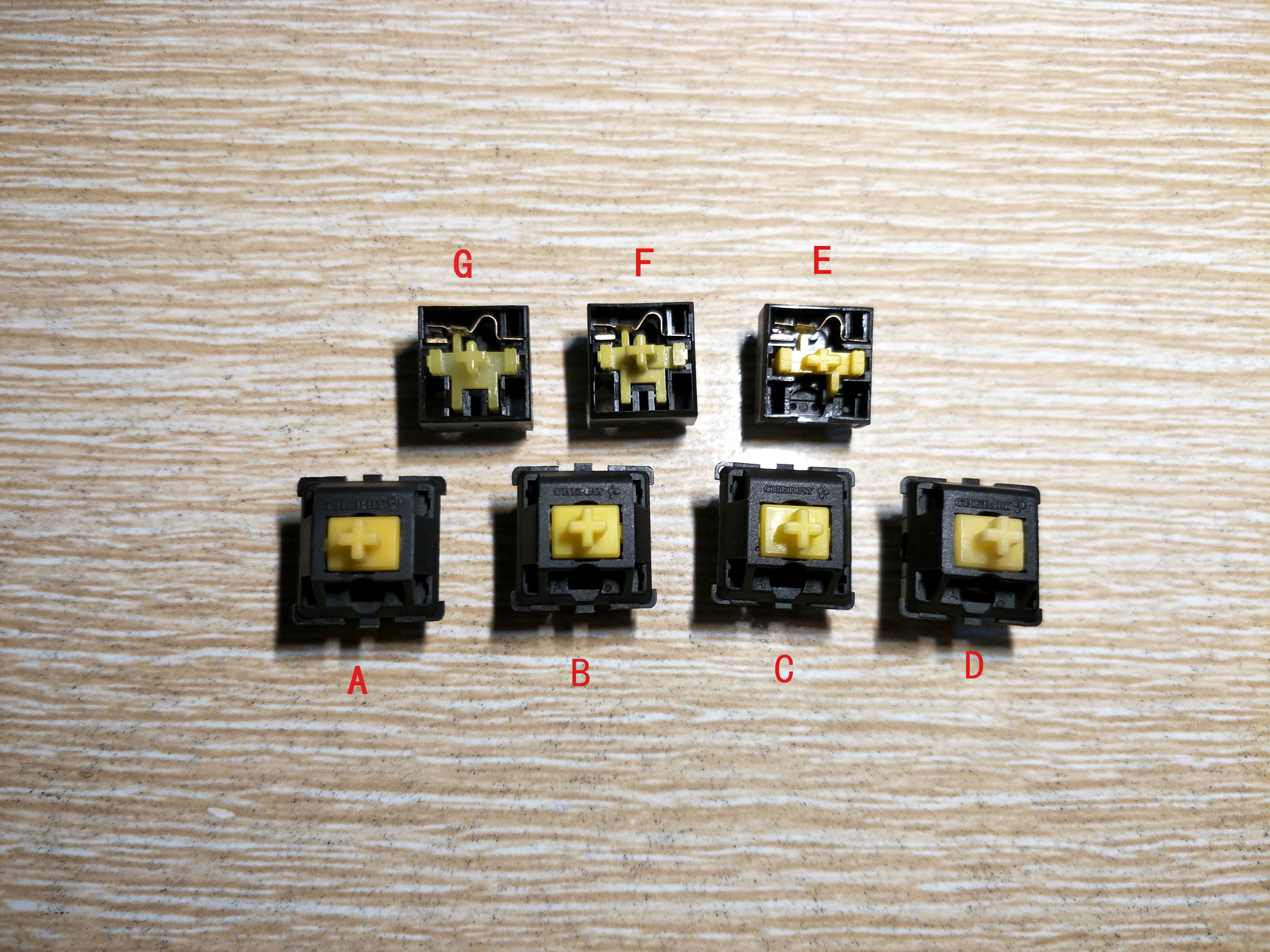

Hey, guys! Today I'd like to talking about ''Cherry MX Yellow''.Currently there is a lot of controversy about it.It seems that only Chinese players can solve the truth.As of today, I had collected a total of 4 kinds of ''cherry MX yellow switches'' and a ''cherry M8 yellow'' from ''G80-0978/0''. and also have 2 kinds of ''Hirose Cherry M8 Yellow''.
switch''A'' was from TaoBao: https://item.taobao.com/item.htm?spm=a1 ... 7319399100
switch''B'' was from TaoBao: https://item.taobao.com/item.htm?spm=a1 ... 6475149015
switch"C'' and ''D'' were from the same keyboard: https://item.taobao.com/item.htm?spm=a1 ... 1163807092
switch''E'' was the spacebar in ''G80-0978/0''.
switch''F" was the spacebar in "Panasonic VP-0187A''.
switch"G" was the spacebar in "Epson HC-20''.
"F" and "G" is the Hirose Cherry M8 switches, theyir craft are different with German craft.So we don't need to compare with them.

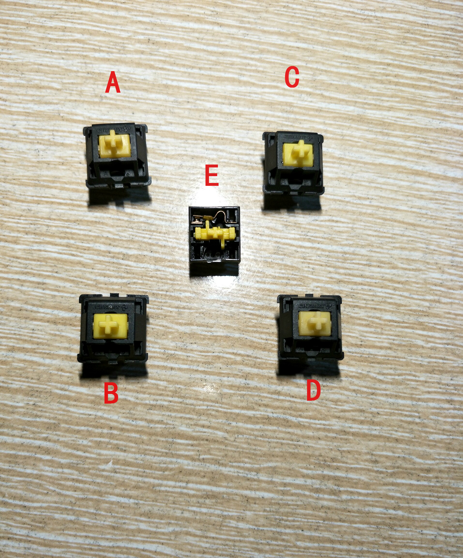

Now we can use "E" as a standard to compare them:

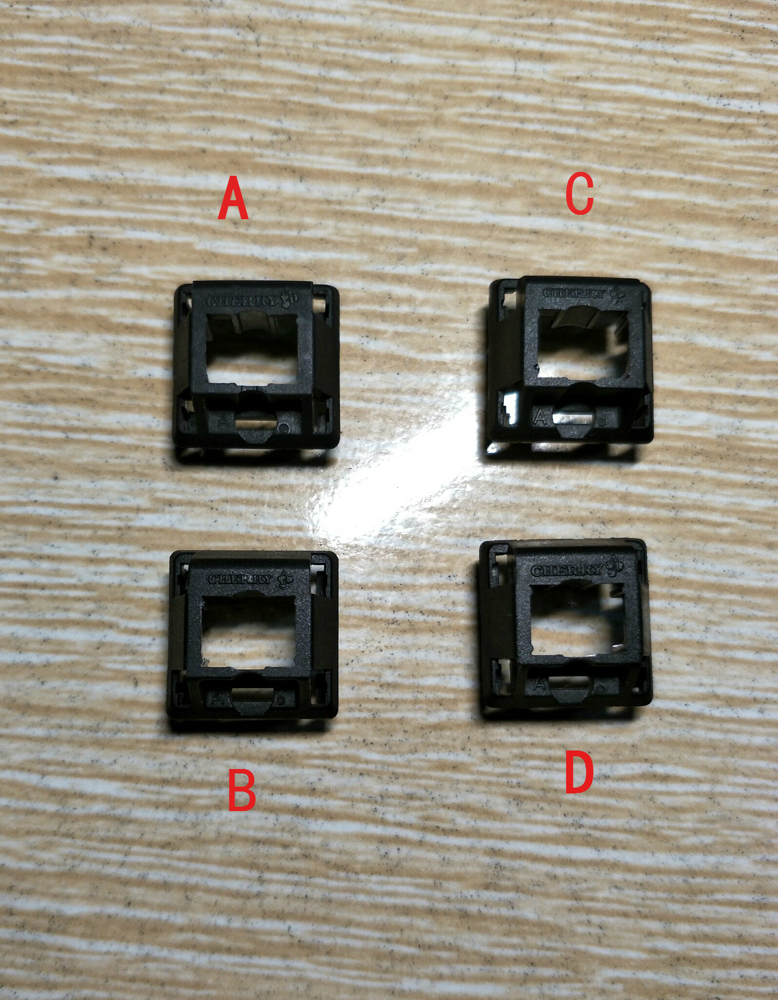

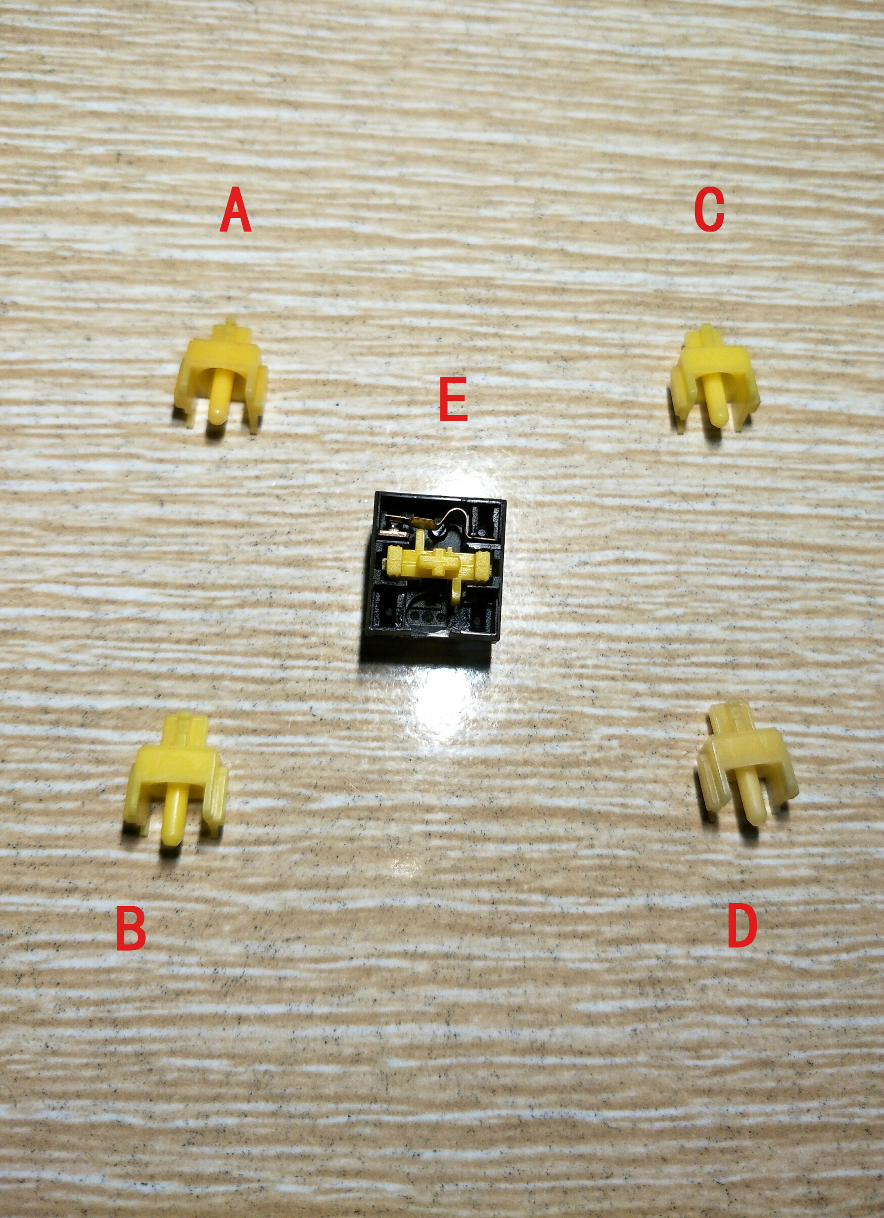

The most suspicious place of "Cherry MX Yellow'' is their key-stem.at first, I compare "A,B,C,D"'scolor.Unfortunately, none of them match the cherry color.
and there is a letter "C'' on the "A" key-stem,a letter "D'' on the "B" key-stem,a letter "F'' on the "C" key-stem,a letter "D'' on the "D" key-stem
This is the most questionable,I had collected many cherry switches,none of their keystem has a letter. The letters are replaced by numbers in cherry switches.Here are the others photos:

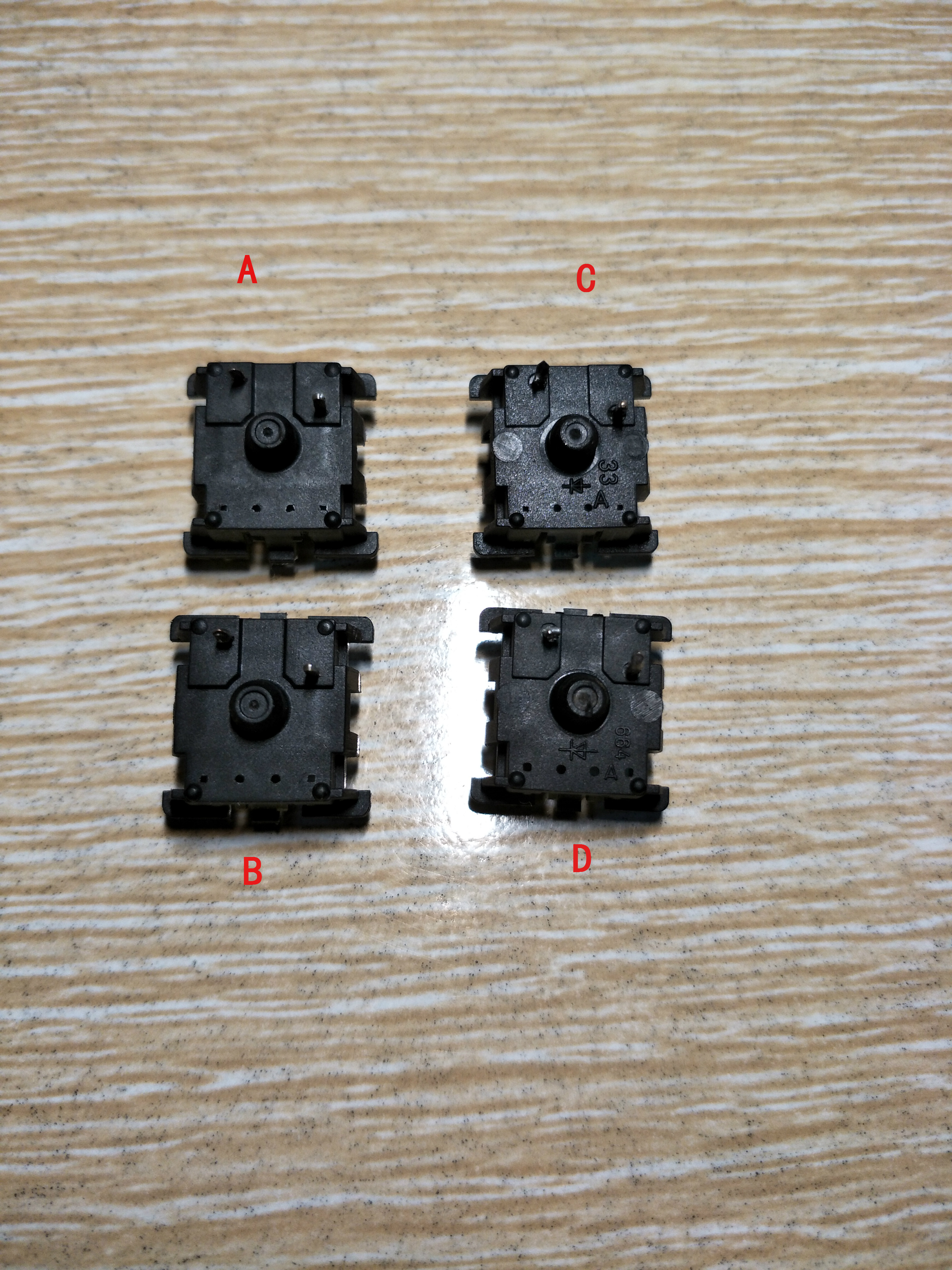

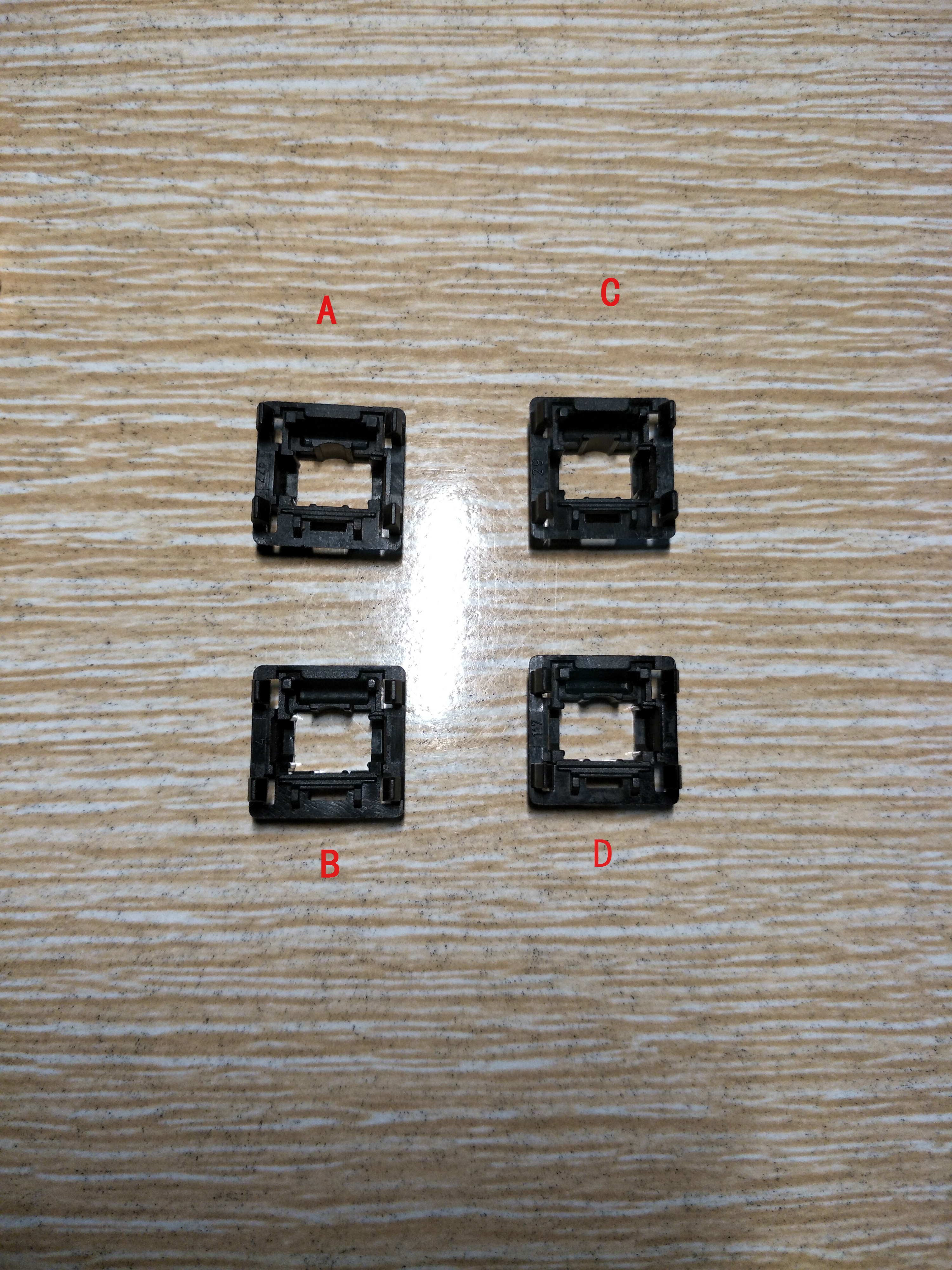

Note that this is the best evidence that it is a counterfeit product, the bottom shell of "A and B" hasn't serial number. Although C and D have serial number.But they may have changed the shell.

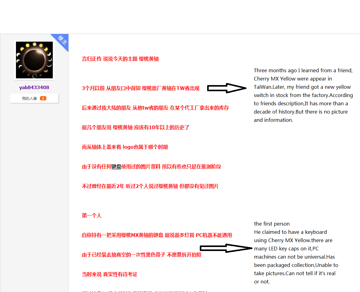

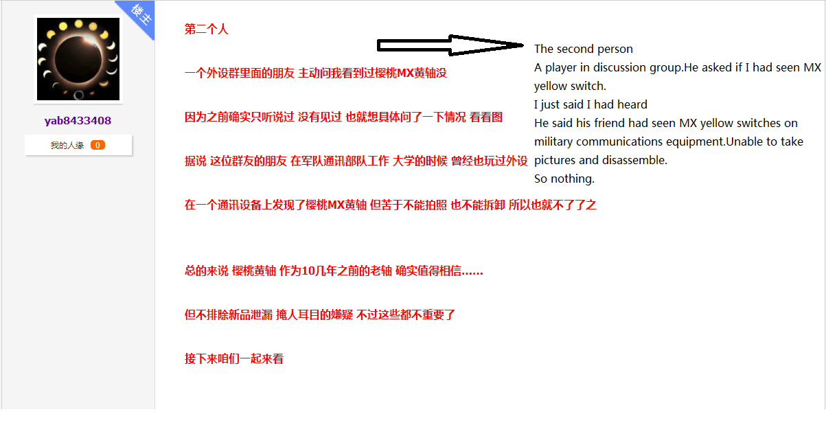

In China, the history of CHERRY MX Yellow switches dates back 8 years. According to my survey, It first appeared in the KBC forum,They are the closest switches to the cherry craft.There are many differences with my MX yellow switches.It is said that they are customized.
But the KBC forum is closed,I can not get more information. By the way, BroDragon's MX yellow switch was also from KBC.
As for these yellow switches, BroDragon had introduced them in the China Forum:
http://bbs.wstx.com/thread-191806-1-1.html
Other records of the MX yellow switches:

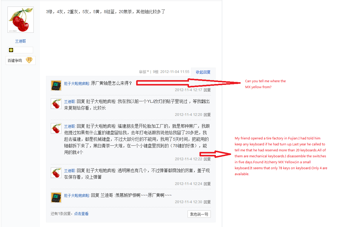

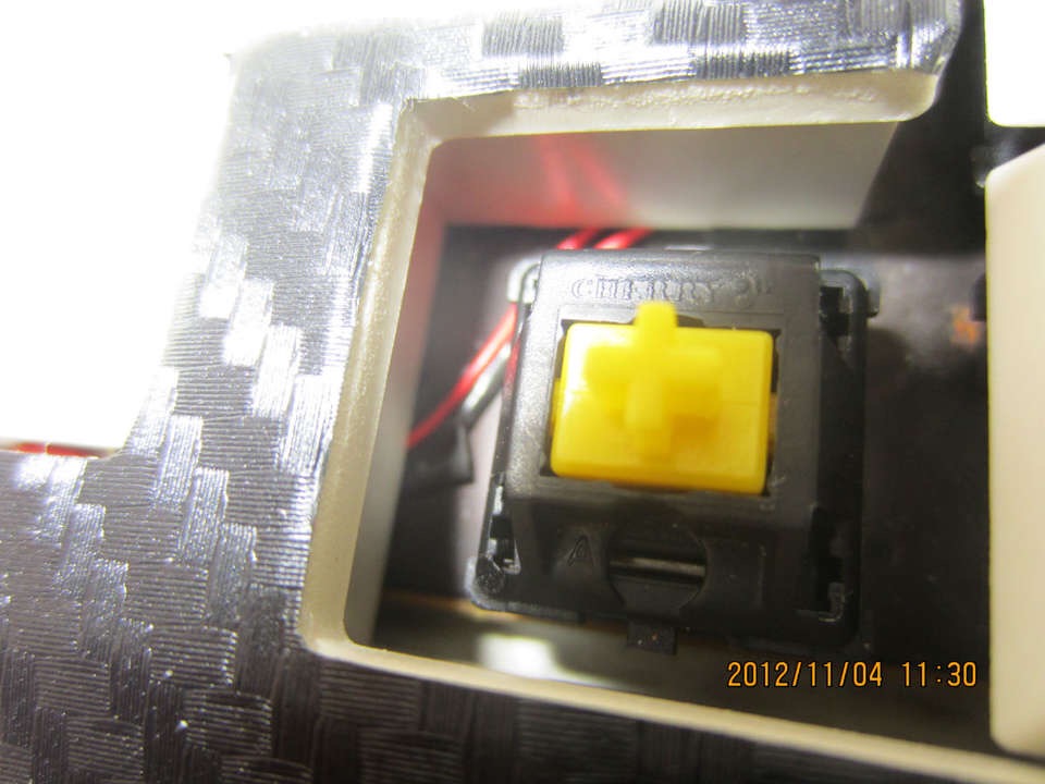

http://tieba.baidu.com/p/1963113038?pid ... 5964533603
Please note this photo, It is like a fake product.
Again, I can not contact those man who claimed have MX yellow switches.

According to Cherry in Germany, the letter on the stem shows that it is a fake part. So A, B, C and D all have fake stems
The switch tops look real.
Switch bottoms A and B (with no diode symbol or mould number) do look suspicious. Cherry shells without fixing pins also have circles where the fixing pins go, suggesting possibly that the same mould can do either. Those are also notably absent.

Lol thought that was weird too so had a look. 轮胎加工厂 is the text which apparently means 'Tire processing plant'. I'm guessing they process other rubbish too. If you keep flicking between English and Chinese in ElGoog, it does eventually turn into 'Tire factory'. Maybe people think the keyboards have *rubber* domes in them

Uh...The original is "tire factory".I also don't understand why...Daniel Beardsmore wrote: According to Cherry in Germany, the letter on the stem shows that it is a fake part. So A, B, C and D all have fake stems

Now I'm sure all of my "MX yellow" is fake.
Those MX yellow from KBC looks like real cherry products. There are many differences with my MX yellow switches.
