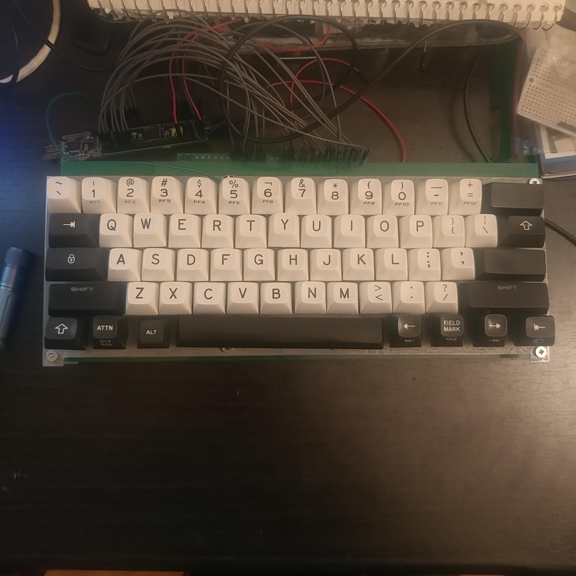

So far I have managed to produce a cherry mx conversion for my 3278 into a 60% Ansi Keyboard.
(I have DSA "ice" keycaps now to replace the space and modifiers I borrowed from a quckfire. I know they look bad)0
Most keys do not actually need the stabilizers as beamsprings almost never bind. I have been adjusting the 3d printed stems in order to get the stabilizers to work well. https://imgur.com/bBQUrR5 https://imgur.com/aCJ01Hi
Costar stabilizer bent bars hit the return spring and are not the best.

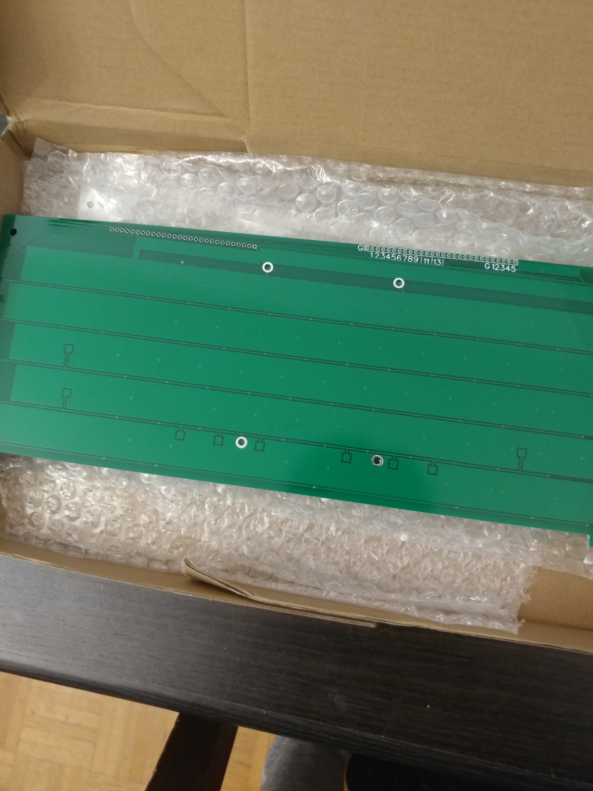

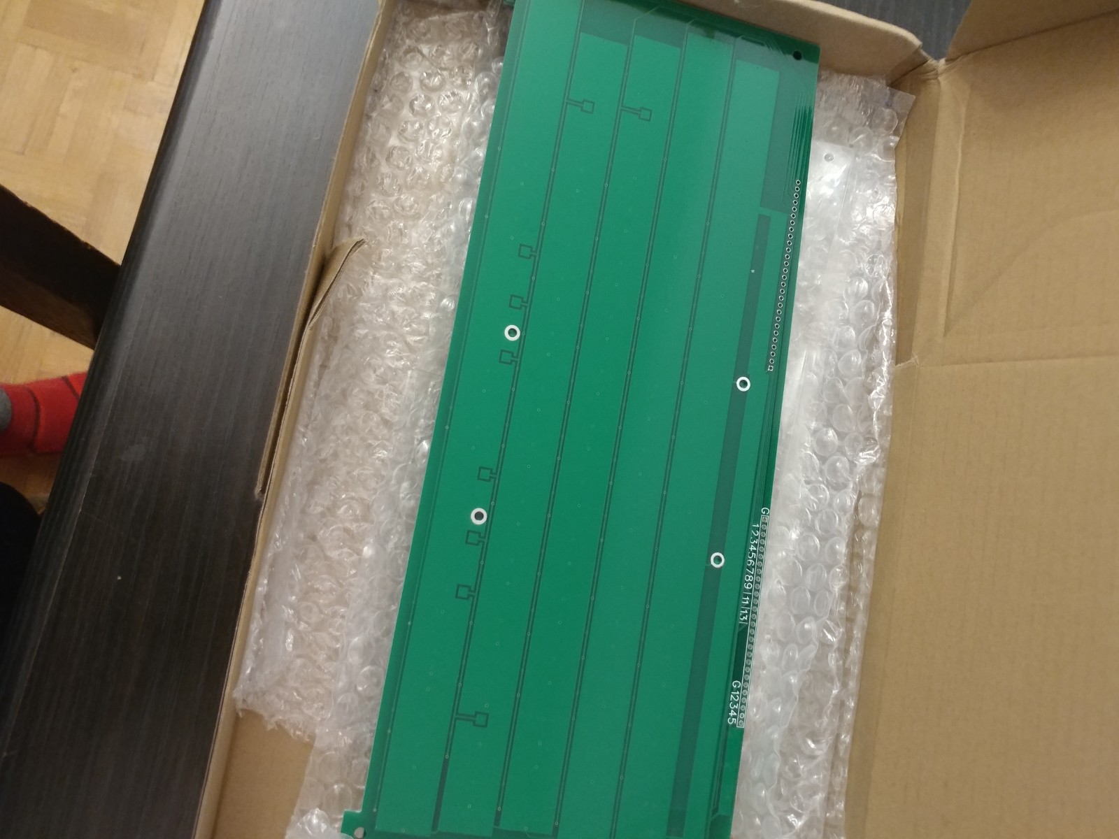

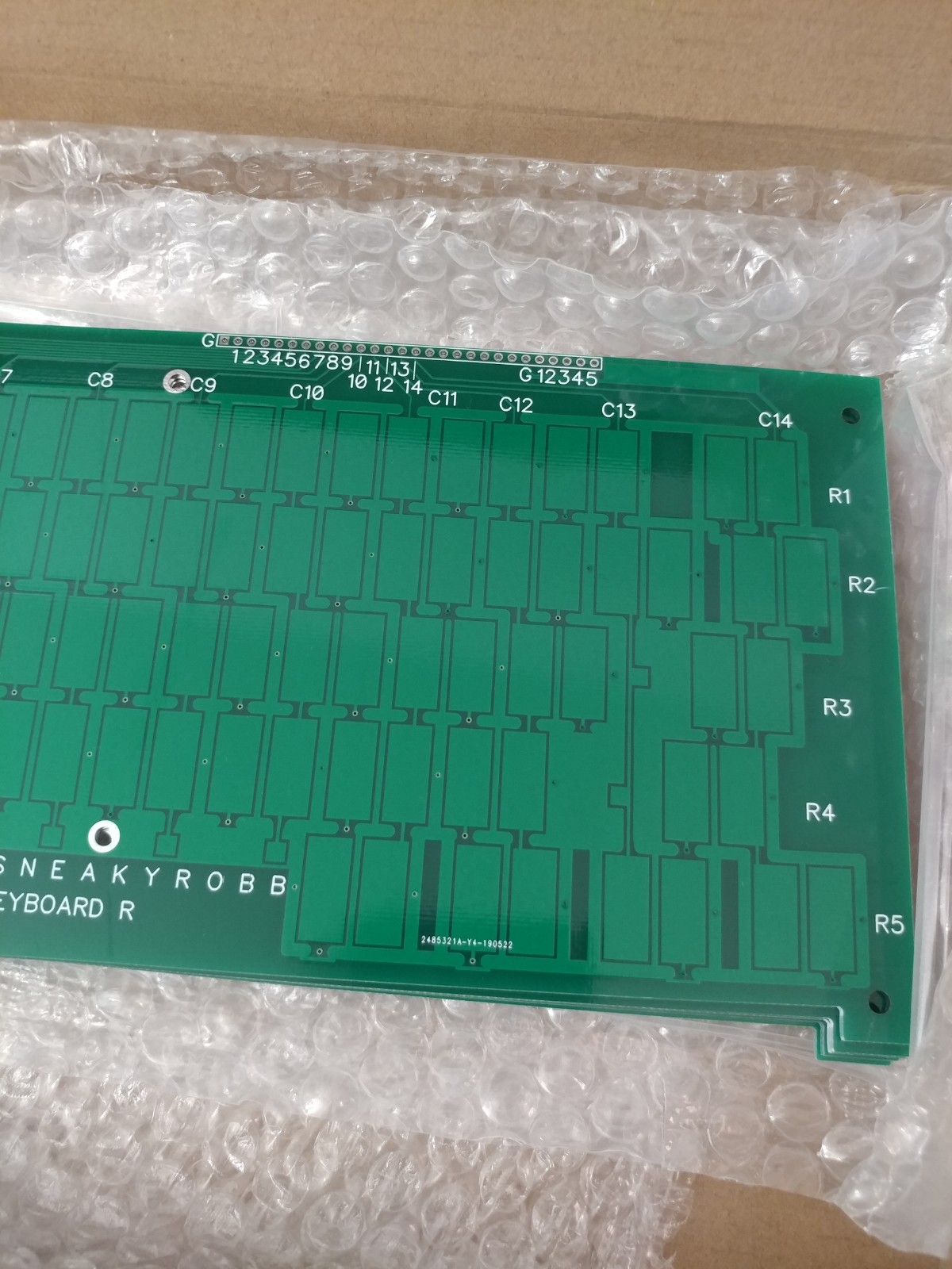

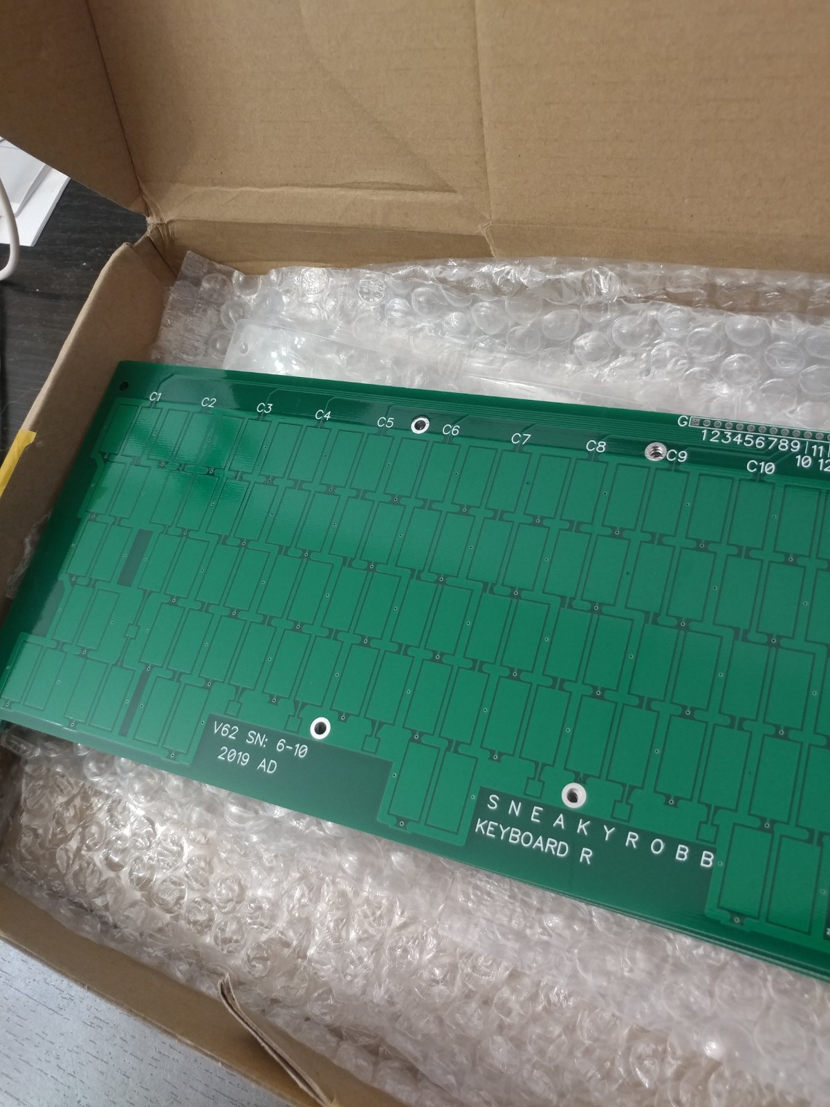

PCB/Metal cut gerbers
These are my first pcbs. As such they do not follow any particular good design rules for pcbs. They should 'work' but they aren't elegant, or really well thought out. I can't guarantee they will work, so if you order one from a pcb maker I suggest you double check it. Obviously I have uploaded them so you can change them etc. I have opted so far to use 2 layer PCBs because they are easier to make. They use the DMA commonsense controller on an external board because it is easier to test with an external controller. These are works in progress.
From what Ive found and learned from wcass.
https://imgur.com/Yy11gH3
https://imgur.com/IwOjOw8
This style of PCB is possibly the "first" beamspring style pcb. It has many vias which were expensive to produce. The sensing pads are both on the front of the pcb, the "rows" as they were travel using vias and connected to a trace on the back. There is also a massive amount of grounding copper rows on the back.
I theorize that the "front and back" style of PCBs that are seen in later Beamspring and then Model F keyboards are a cost saving measure. As such I opted to produce a PCB which is more akin to the original and hopefully has very strong signalling.

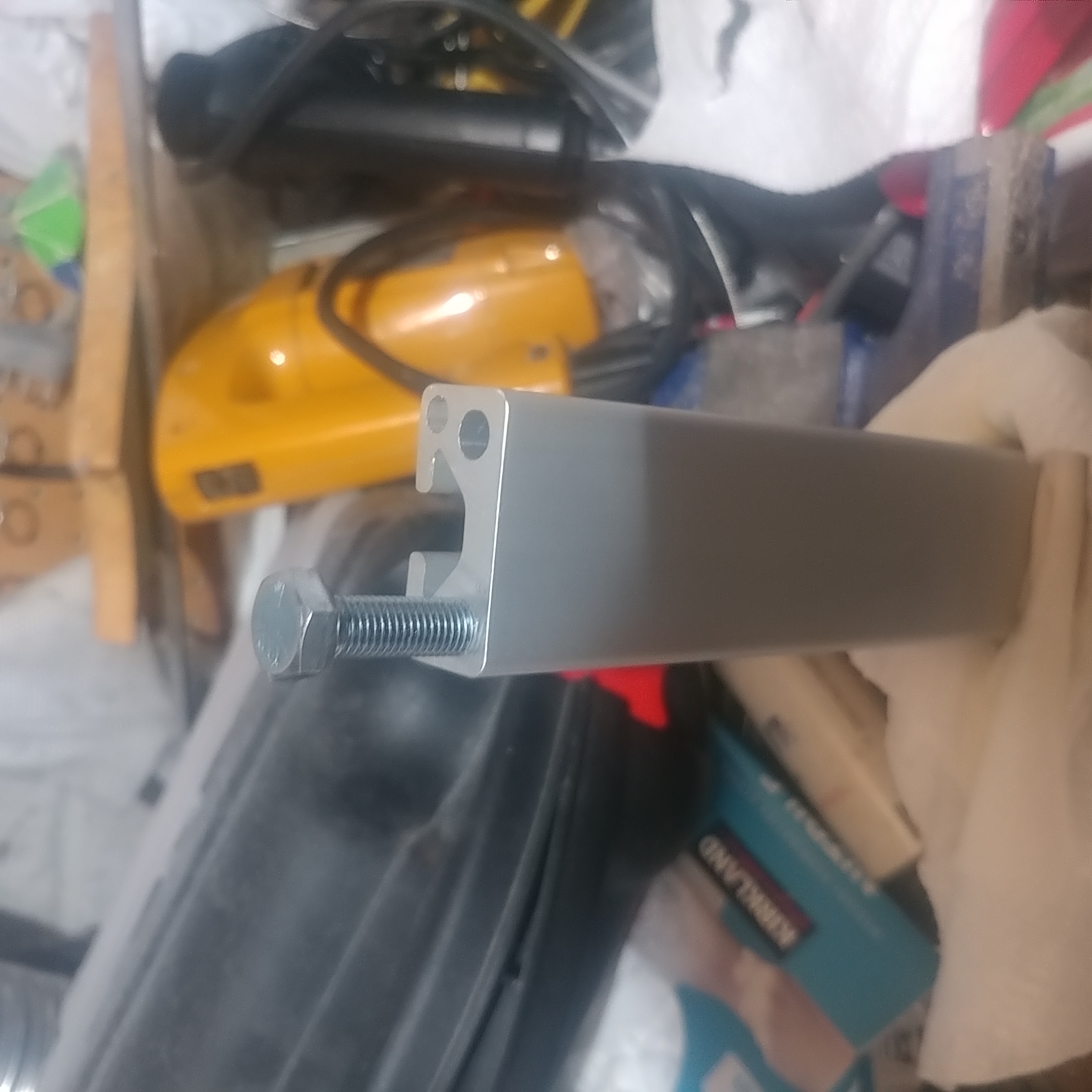

I made an MPCNC machine to make new metal plates. I have only cut some balsa wood ones so far as I just made the machine. I will eventually attempt to use aluminium.
For the plates I have found that having a very thin 3d printed card with the "tabs" to align the keys, makes it easier to machine the plate as you need no tabs on the plate.
ansi board - 60% board
Uses mostly original keys except for space modifiers etc using cherry mx stems for those.

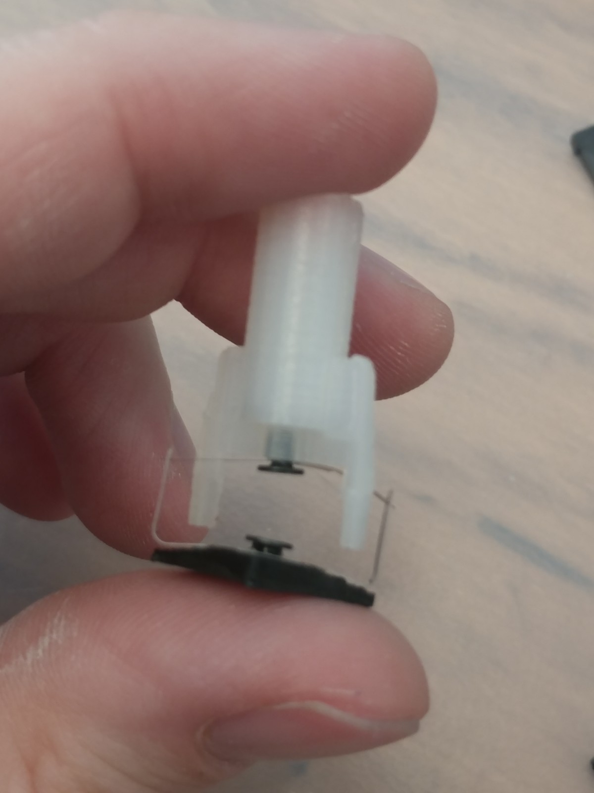

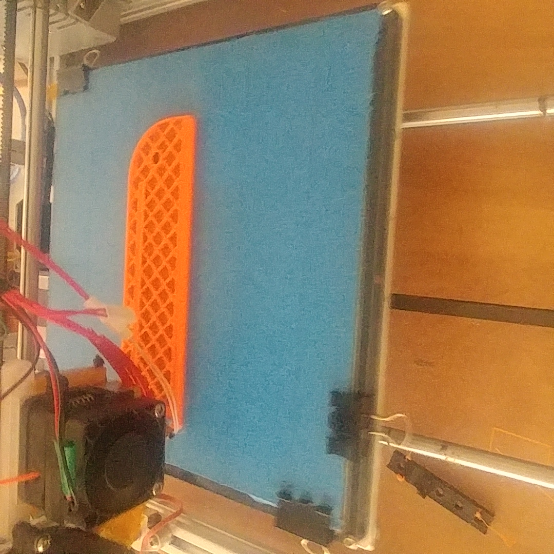

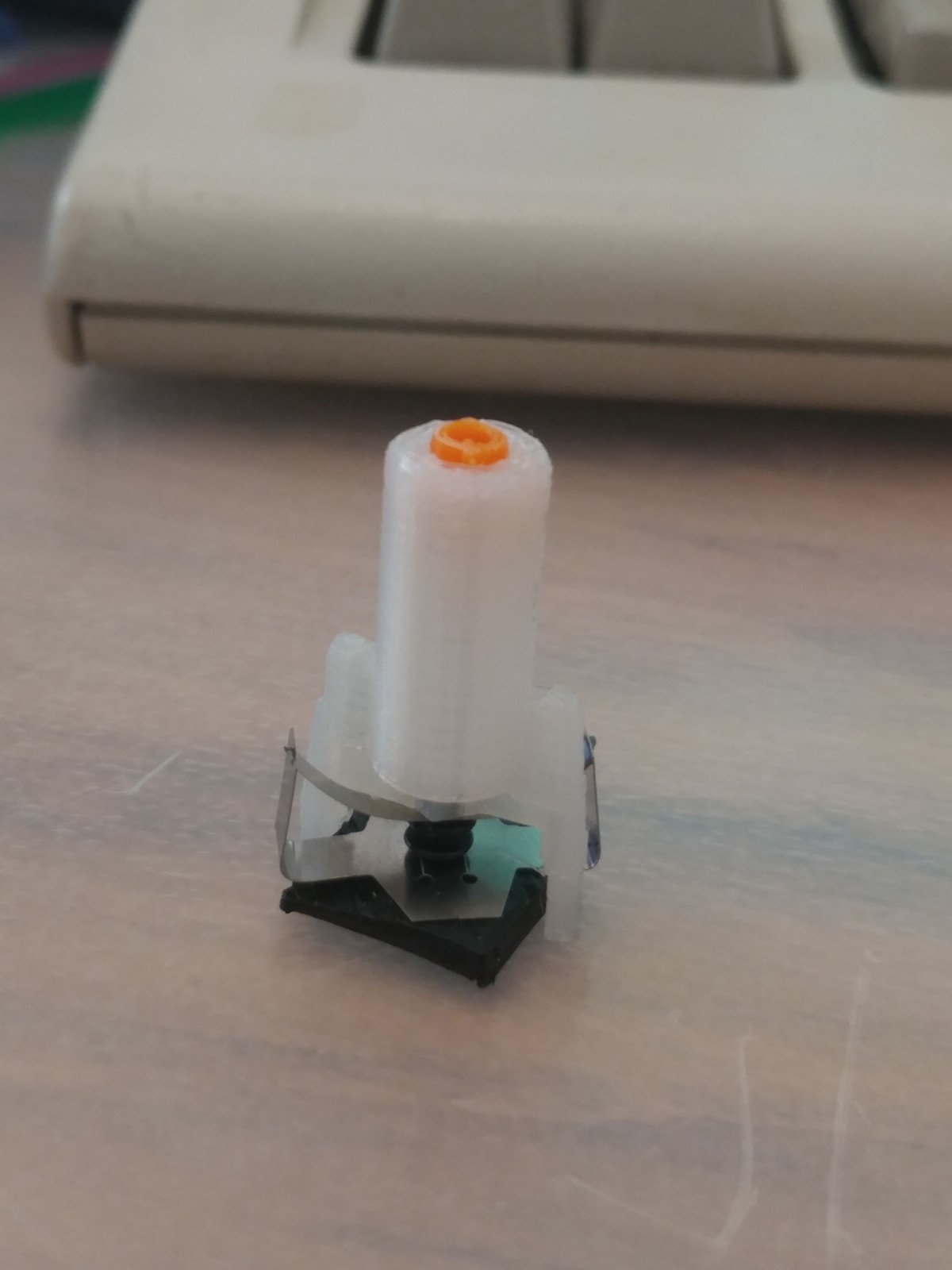

Currently I am working to perfect a 3-piece 3d printed plastic stick screw. I have music wire of 0.025 inch thickness.
I have been able to wrap the wire around the stick to make new return springs. This is somewhat time consuming but it works.
The stick has 3 lengthwise pieces. The 2 outer ones have the screw guide and the middle one doesn't. I will upload this file soon.
What you do is wrap the wire around and then remove the middle stick to remove the other pieces, and there you go new return spring.
Here is a basic idea of the mechanism. It is a guide to get the winding right, and then it disassembles.
https://imgur.com/a/gWKzwPS
I will update on the progress of these springs this weekend.
*This system didn't work at all. I have been able to make some decent springs by using a makeshift brake out of 2 metal plates, a bolt/nut and wood with music wire. Must continue developing.

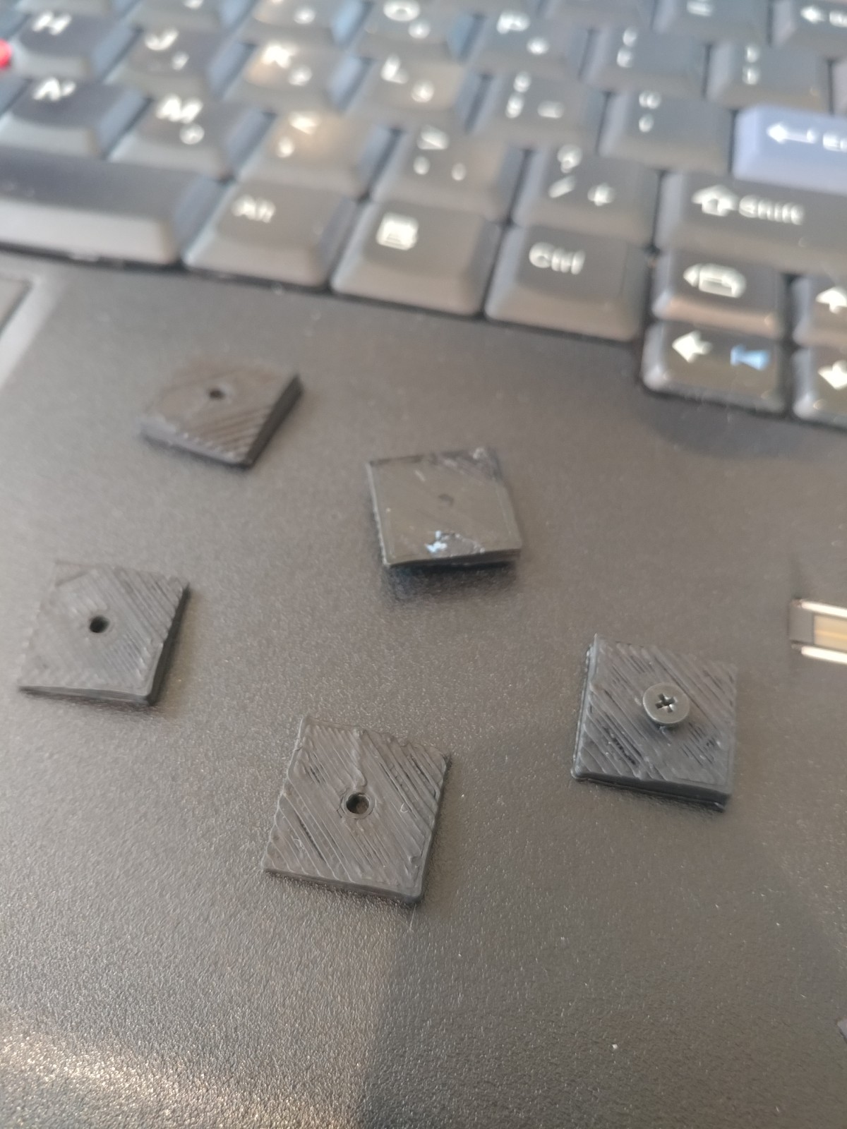

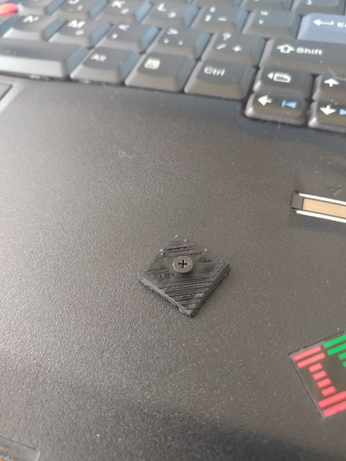

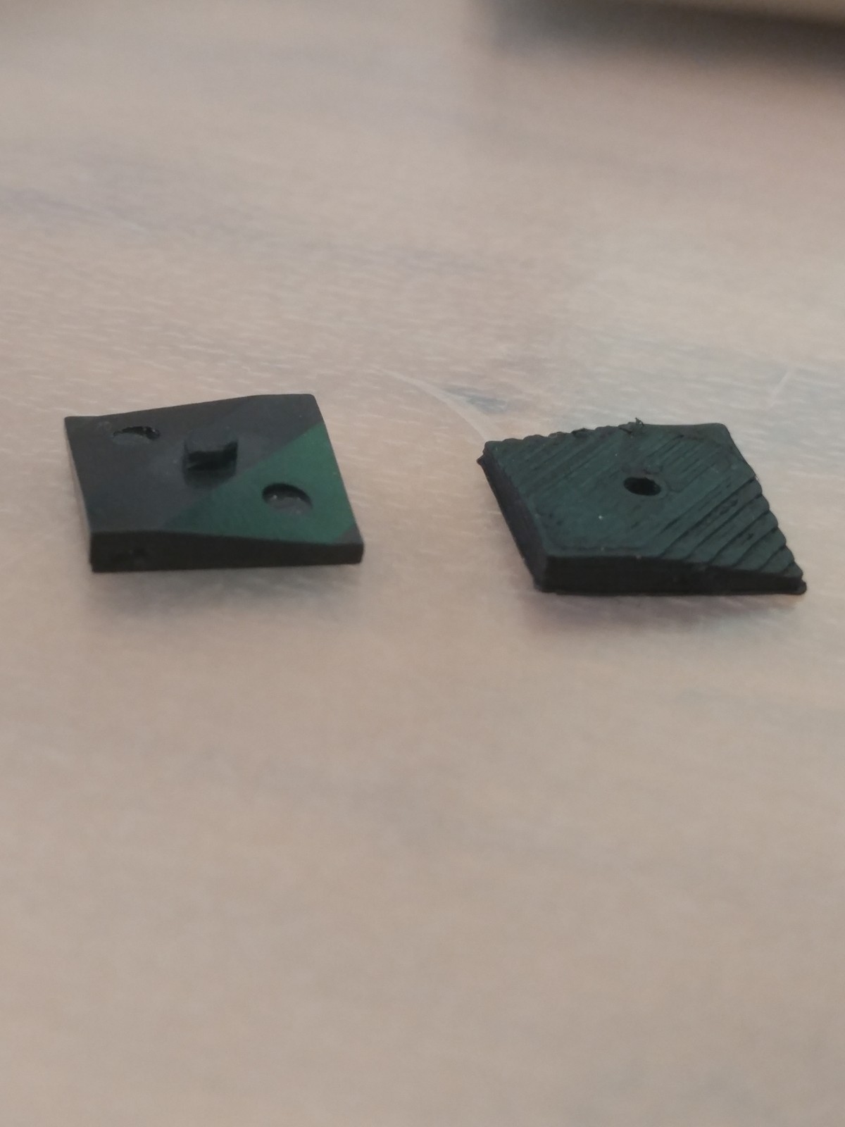

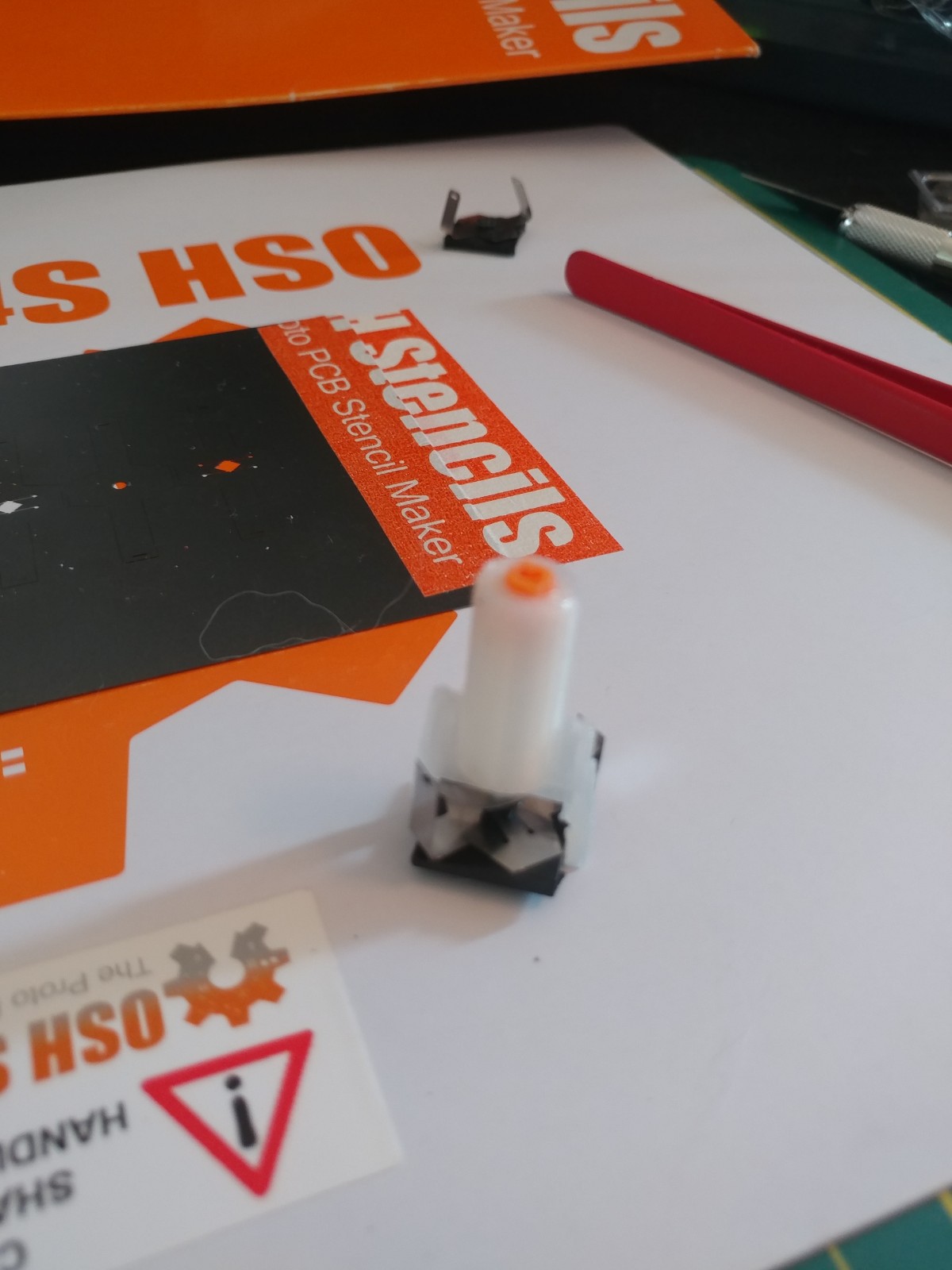

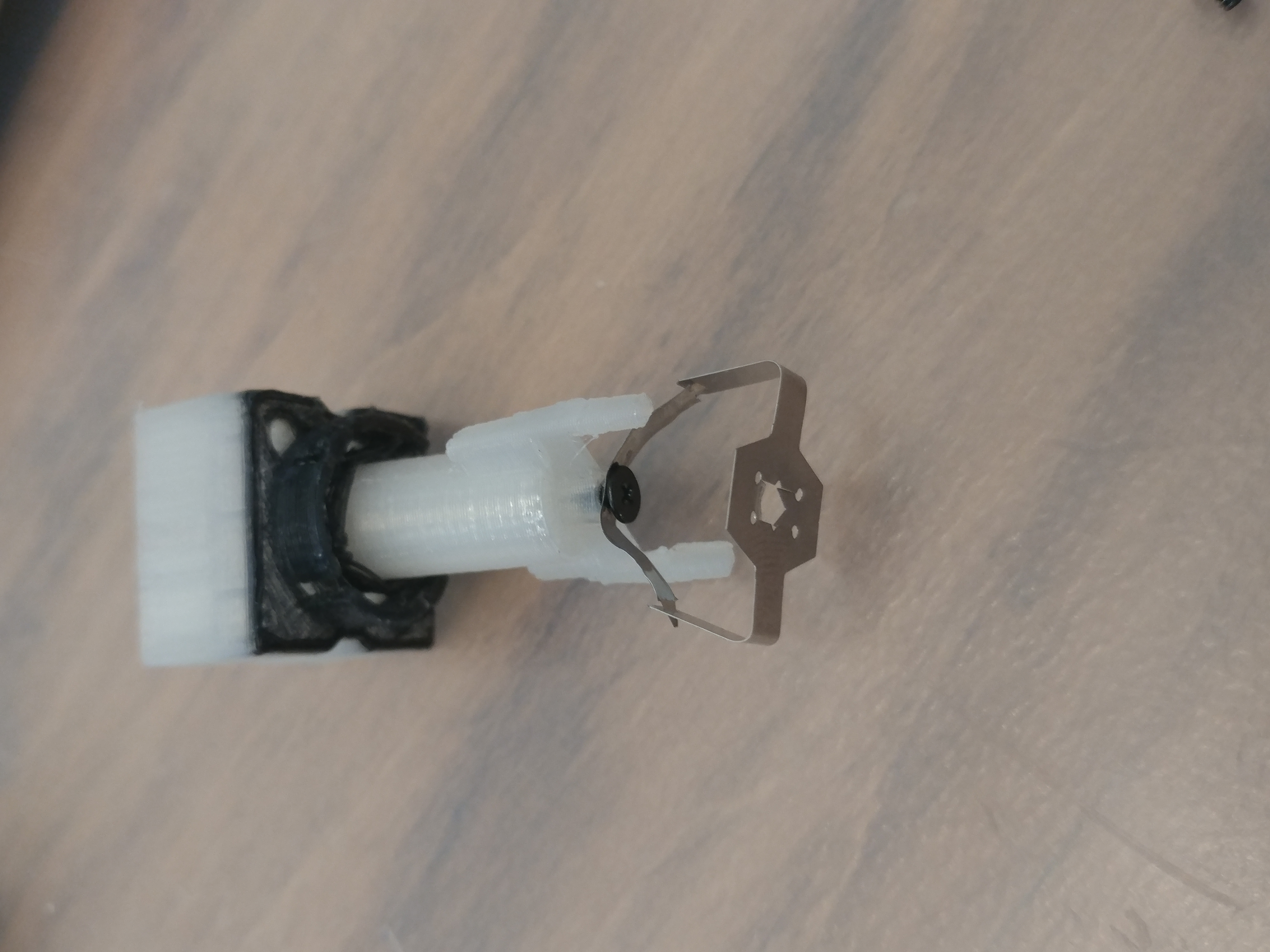

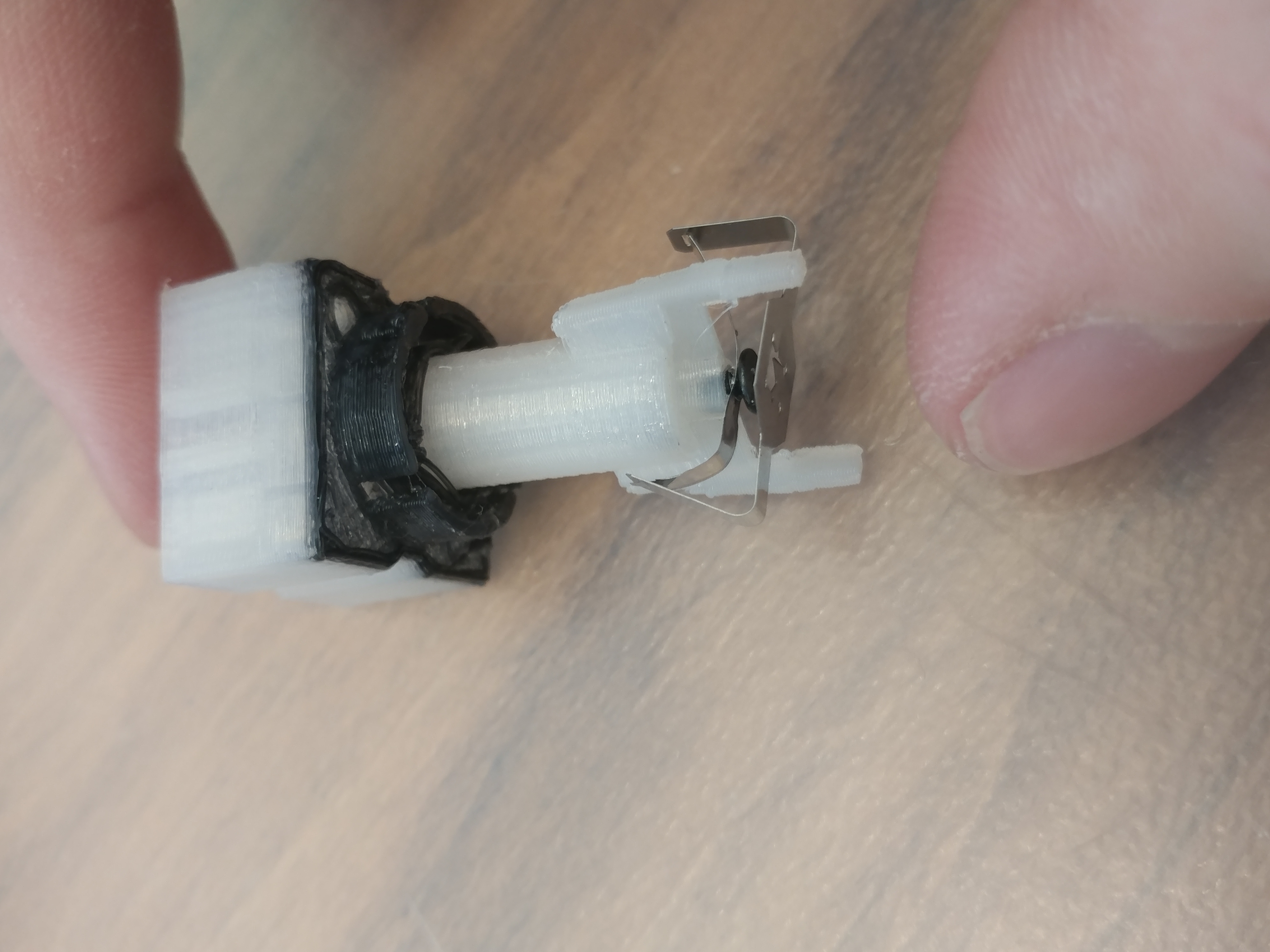

Foot

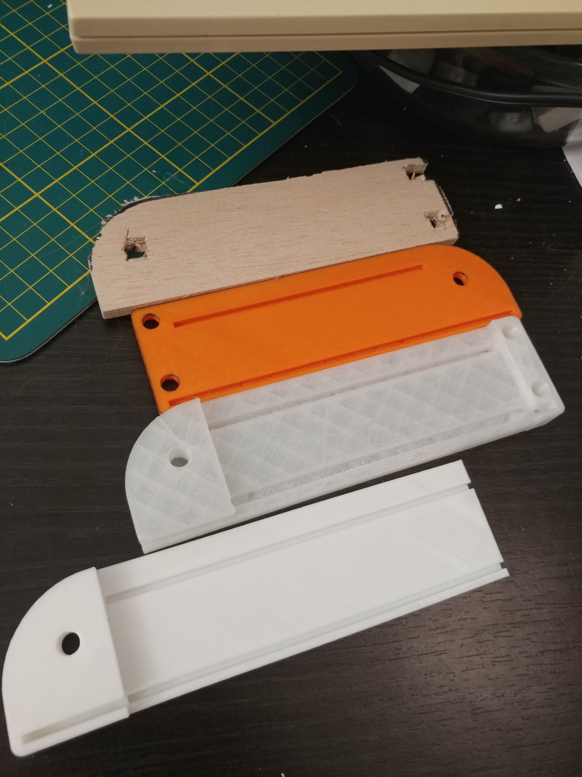

For the switch plate foot, black carbon 3d printed plastic seems to work somewhat. It is obviously capacitive. It doesn't matter what you make the barrel assembly out of.
I will be uploading some OBJ/STL files later tonight. The main consideration for this part is whether or not it should have a stem on it. The reason this is a question is that the original flyplate was press fit onto the foot with a metal backward fork preventing removal. I would rather use a small screw as if I am going to make flyplates, I would rather just punch out one hole in the middle with maybe 2 position post circles.
The stem can be seen in this gallery which will upload fully soon.
https://imgur.com/gallery/Jx1lnxF

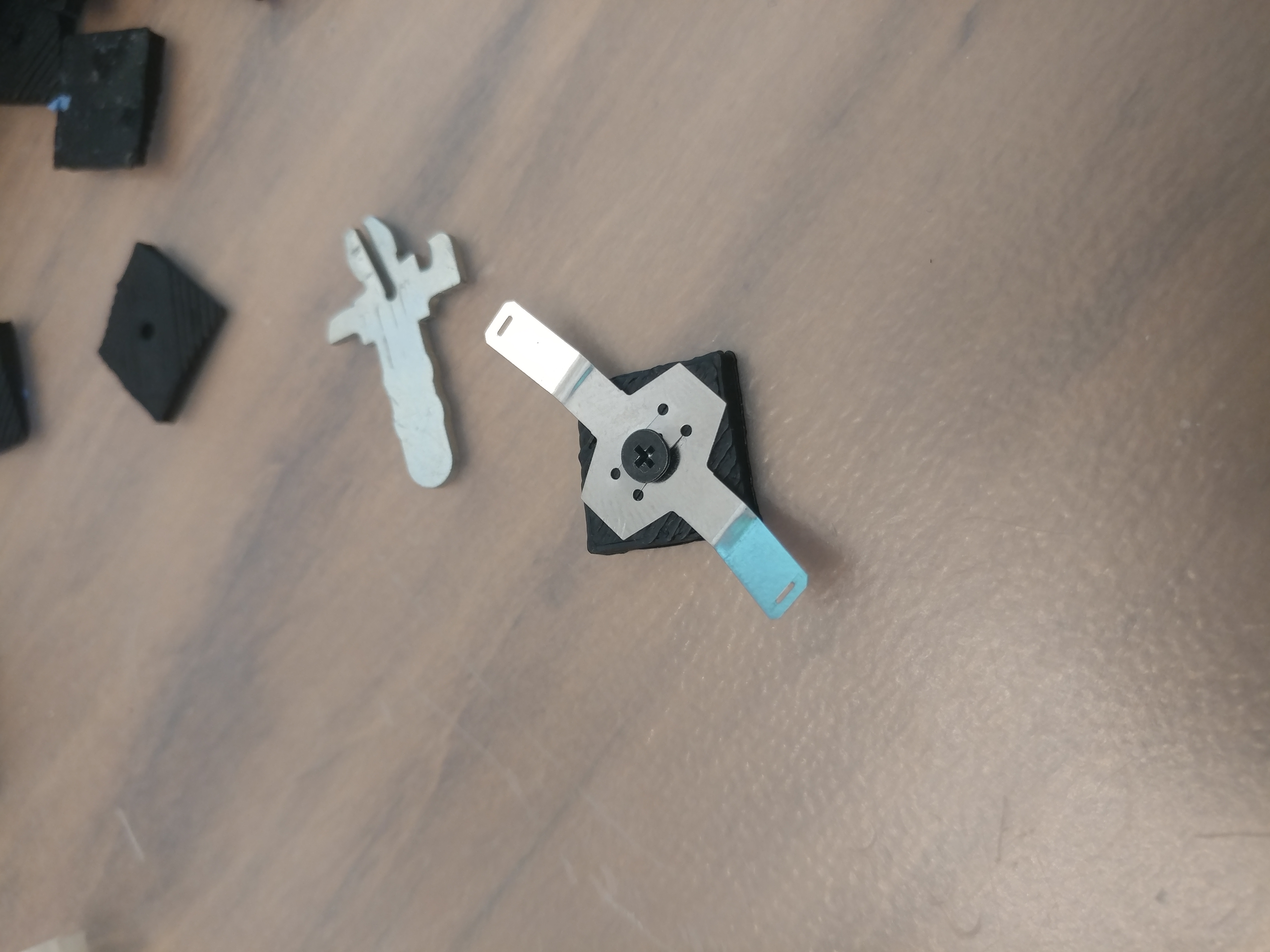

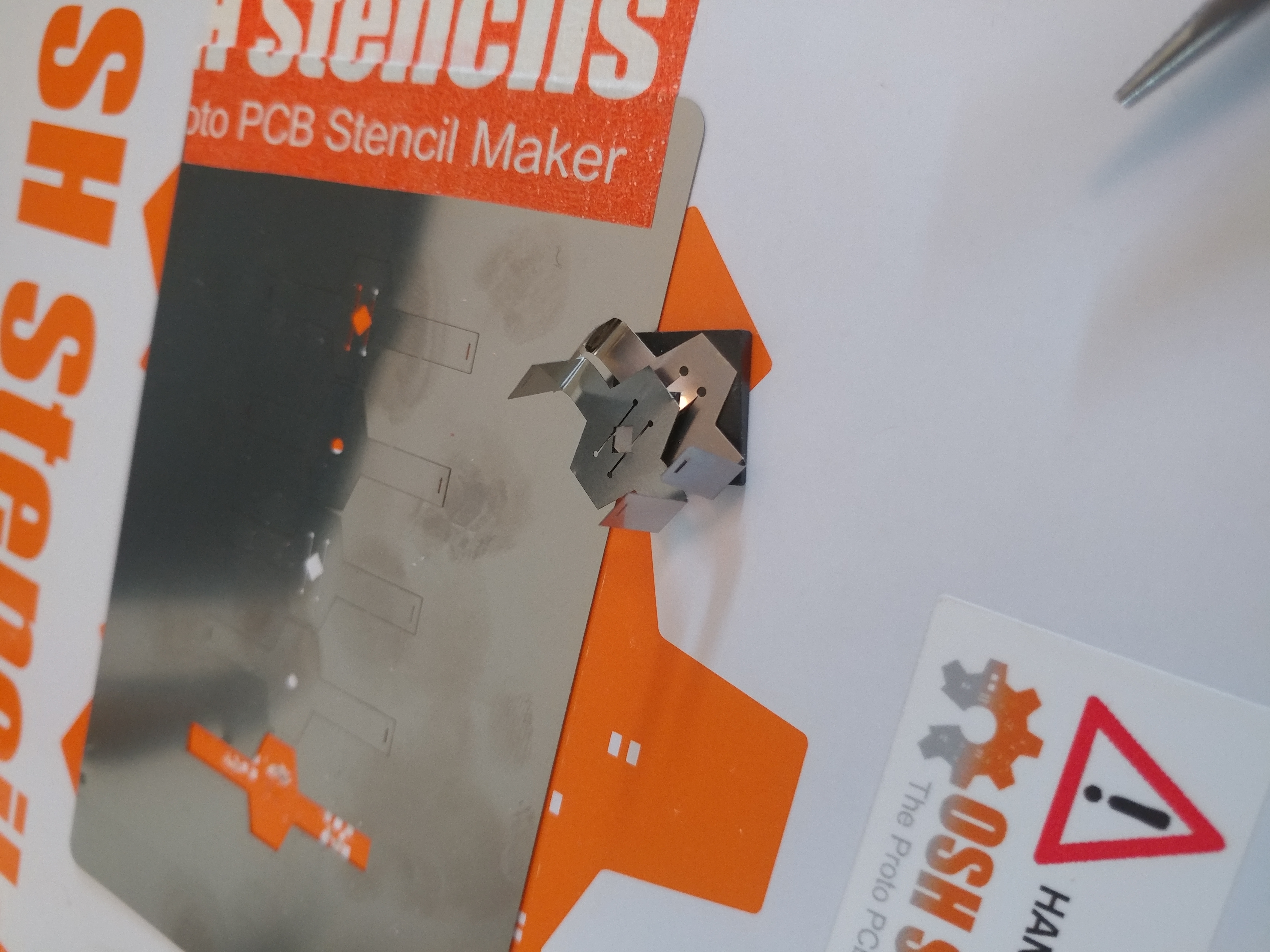

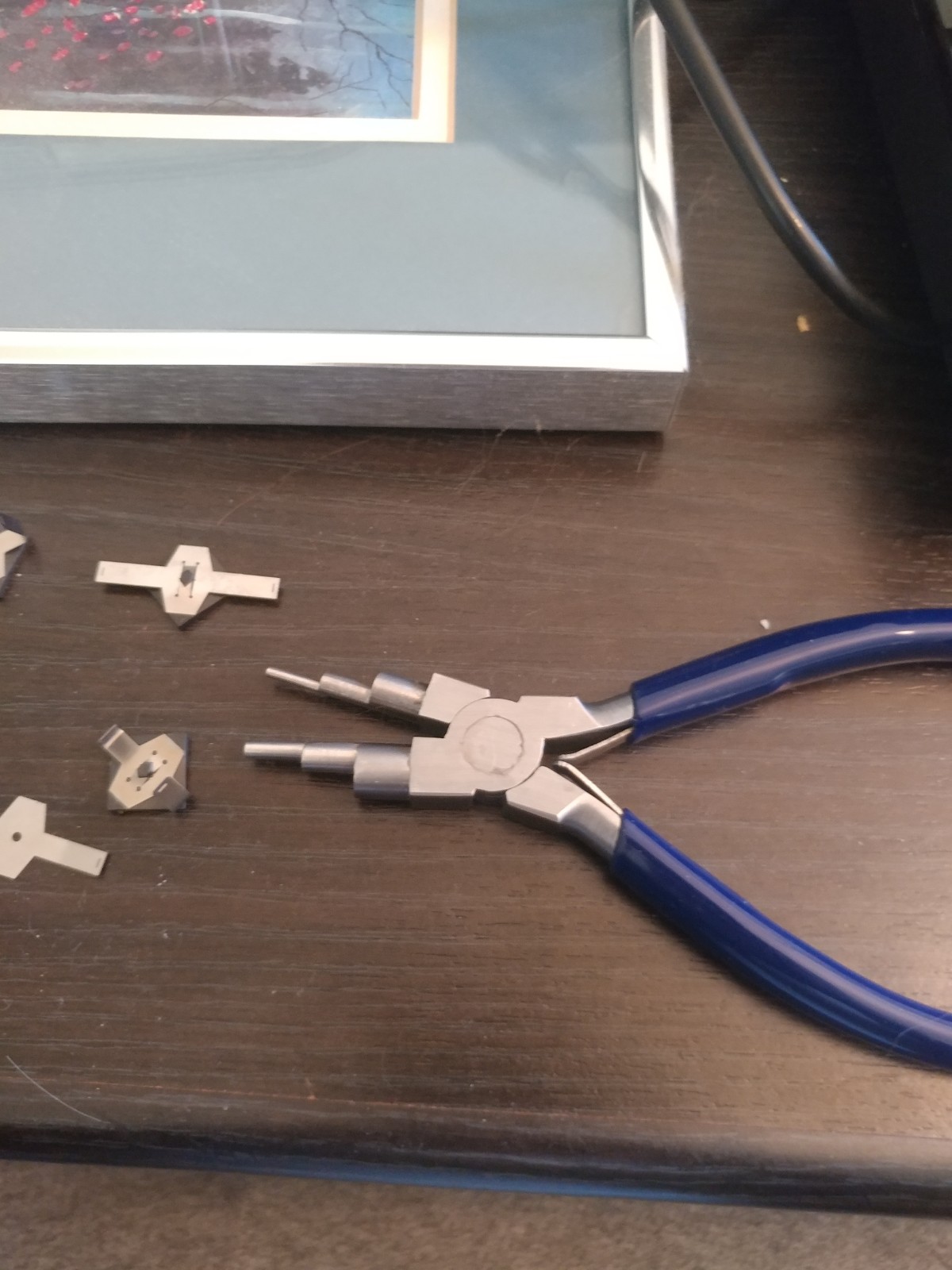

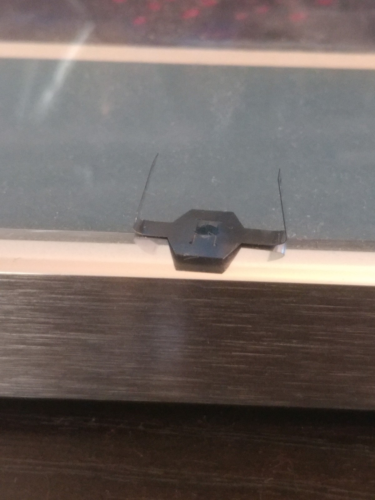

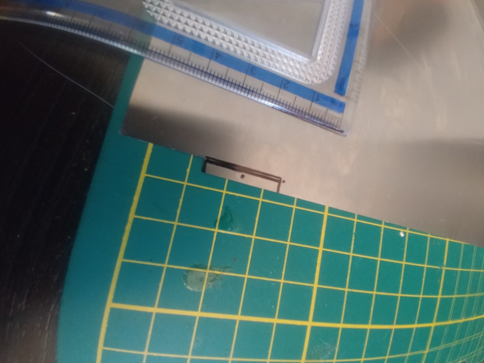

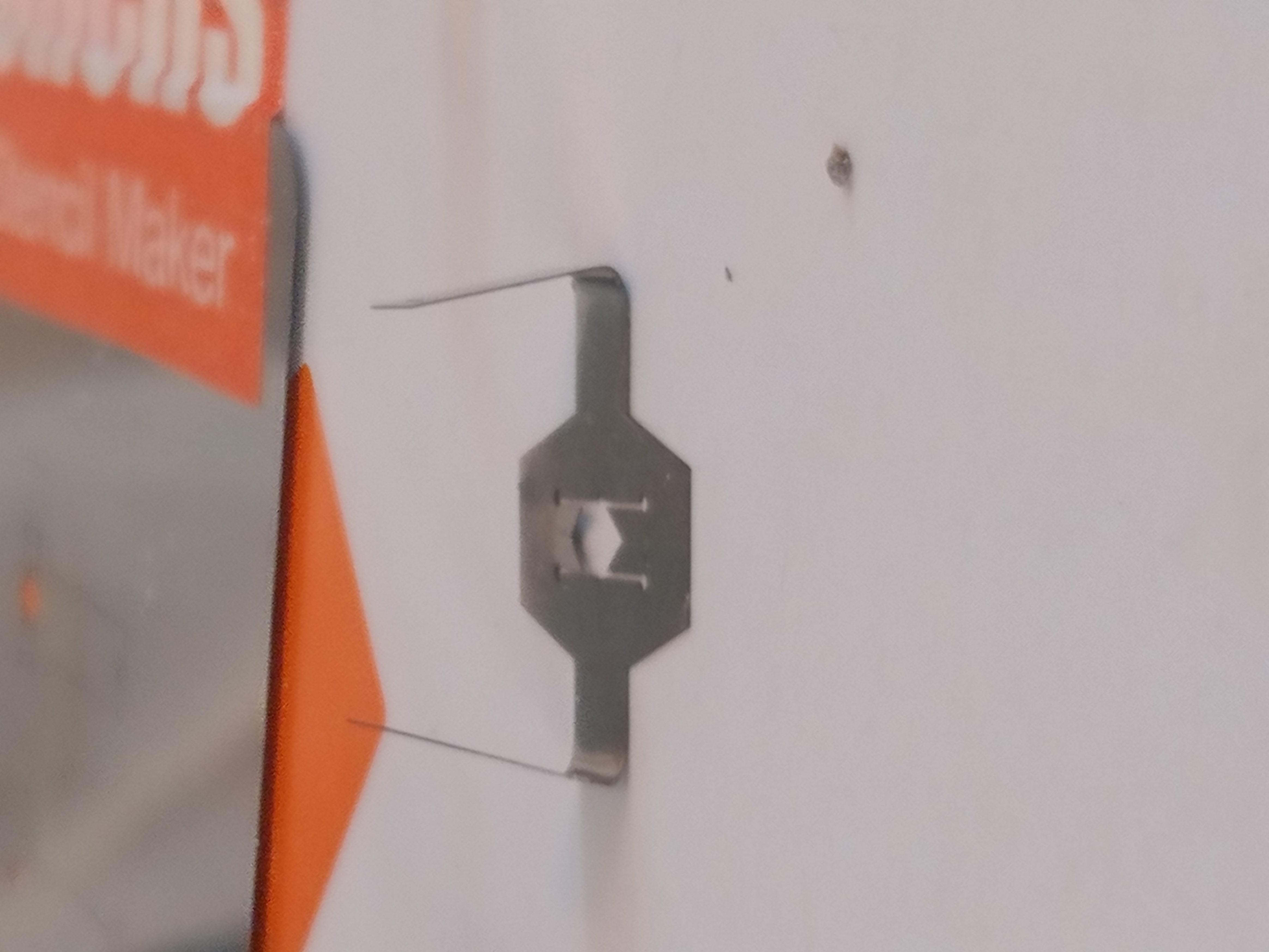

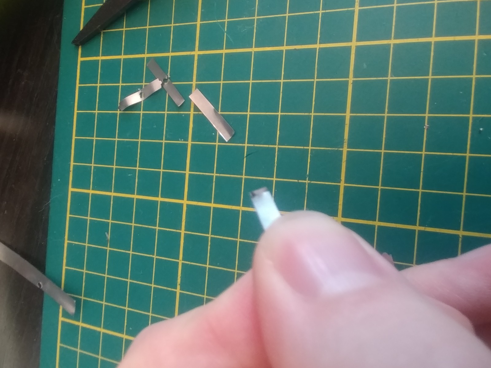

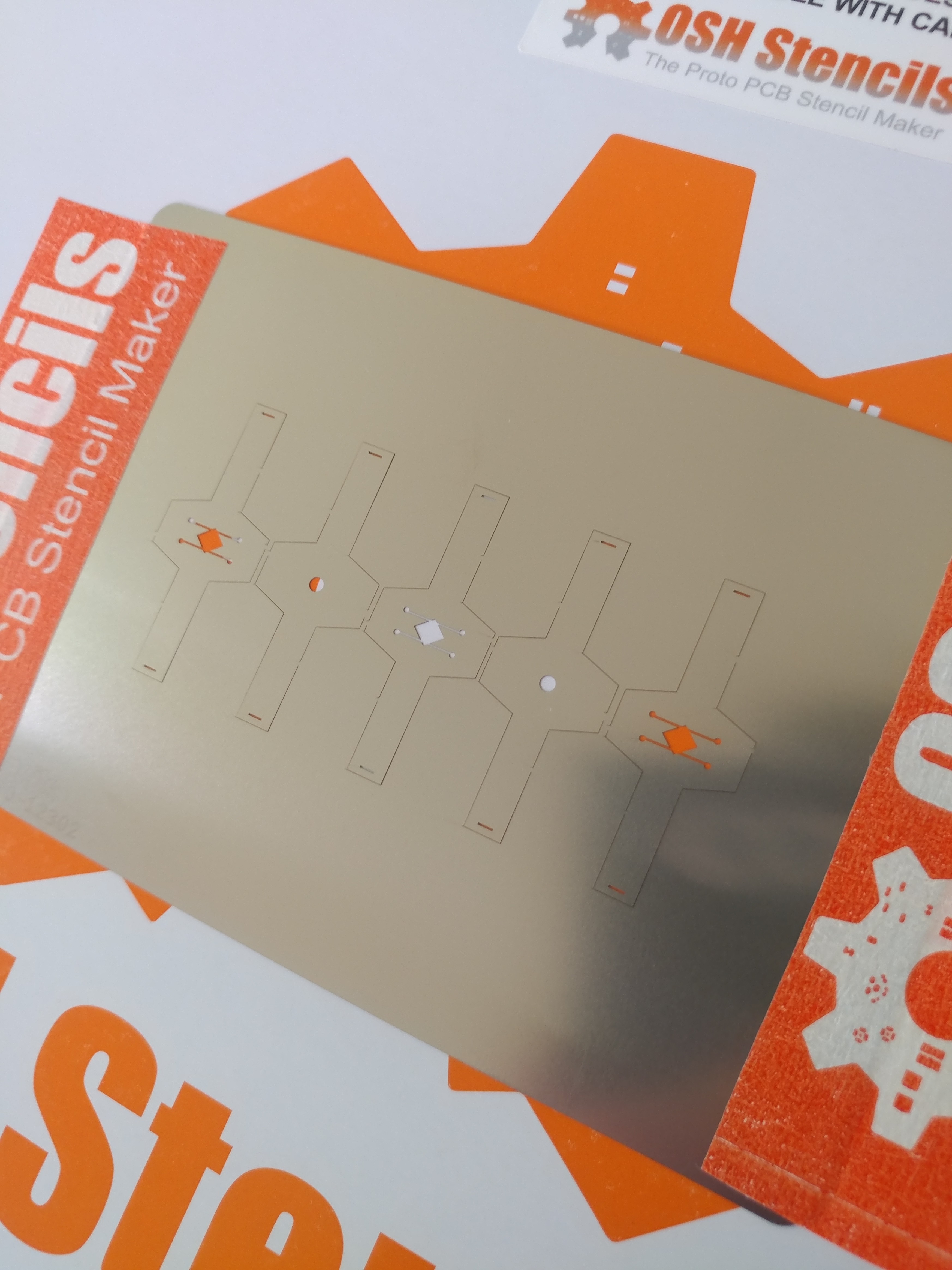

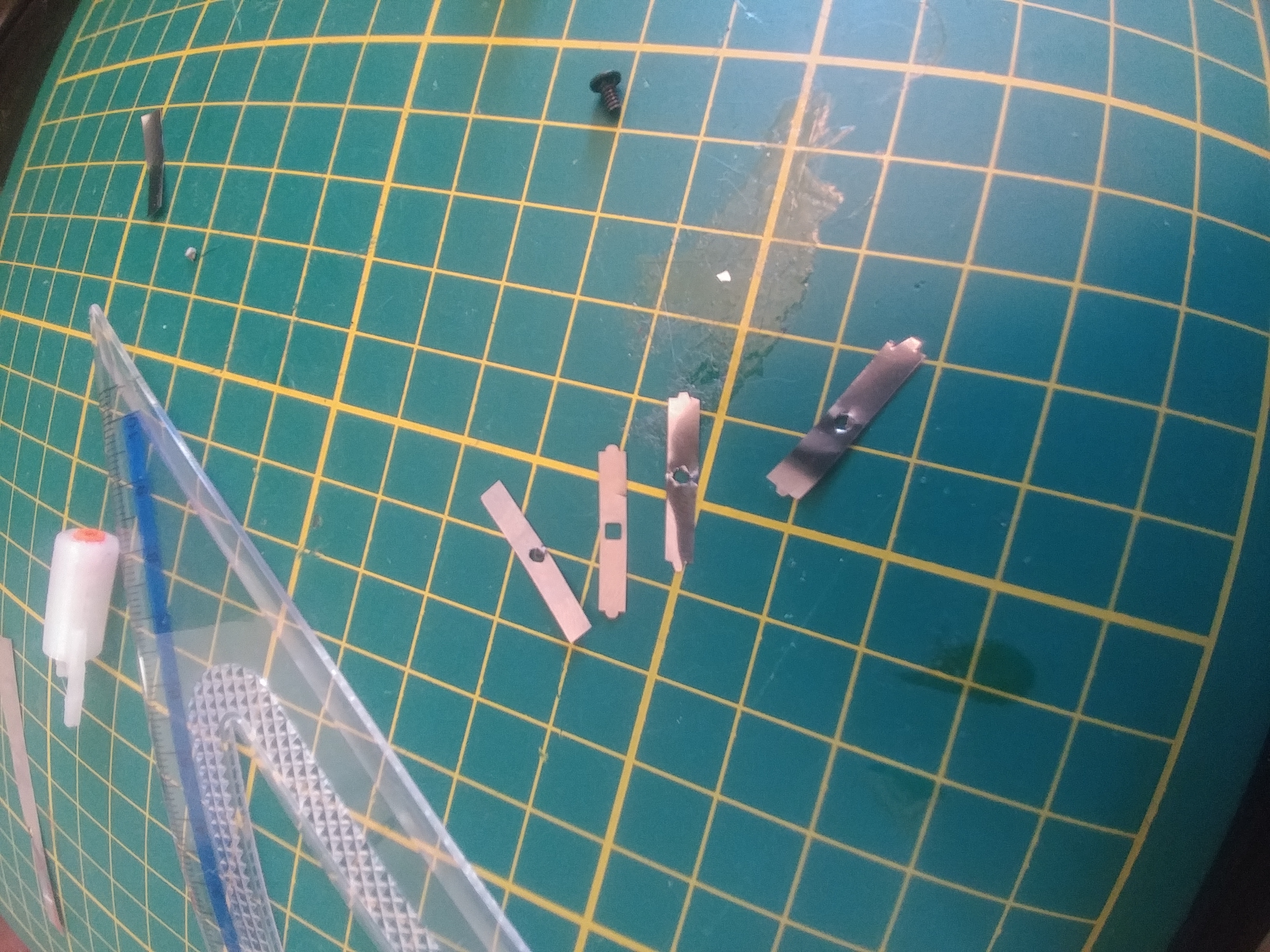

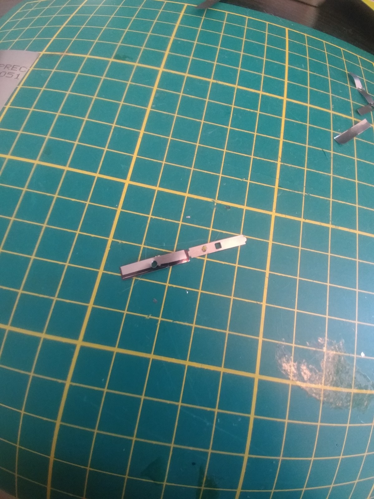

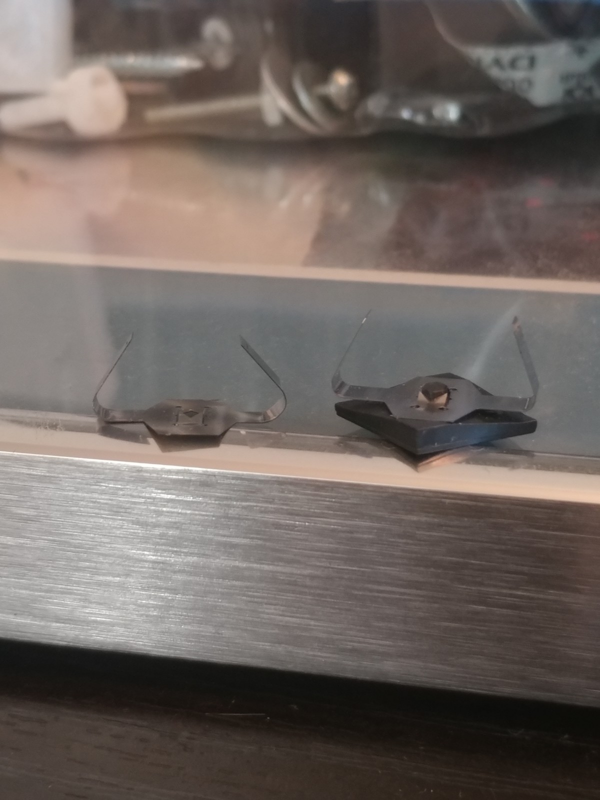

Flyplate
This piece will have to be stamped somehow. I believe the easiest way would be to order a circuluar disc puncher. As the metal is 0.035 inches thick. I would then bend it on a fixture that is 3d printed.
I have been in contact with this etsy seller of custom punches. They have quoted me between 150-350 usd. I am attempting to make one of these out of aluminium currently. Even if the aluminium punch only lasts a few punches, I think it would still be cheaper to keep remaking these.
https://www.etsy.com/ca/listing/6248648 ... rket&frs=1

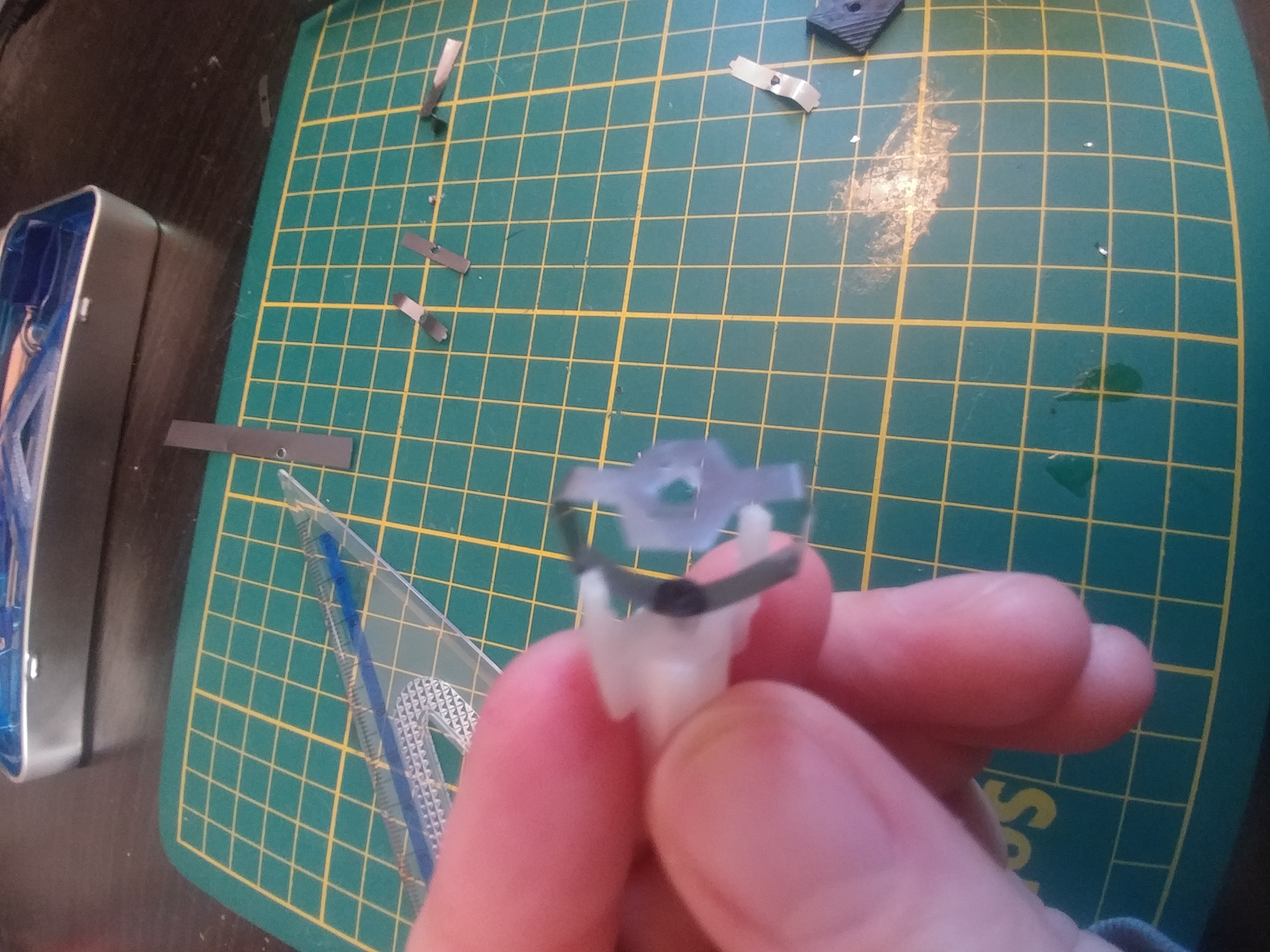

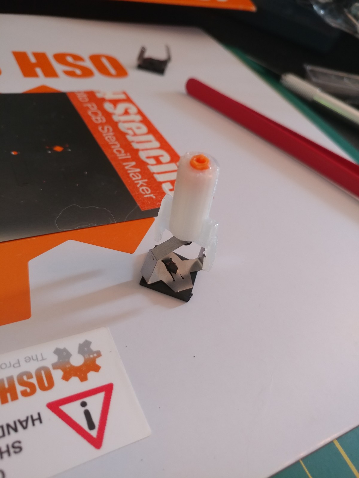

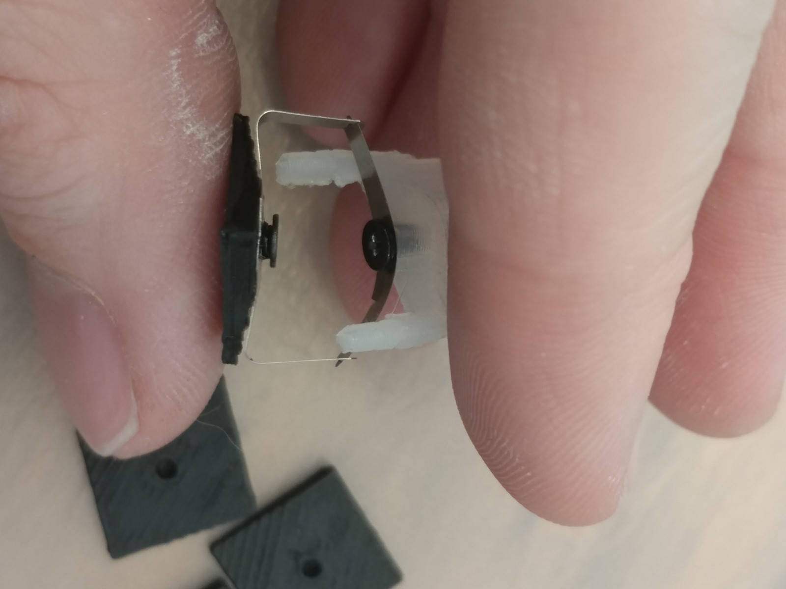

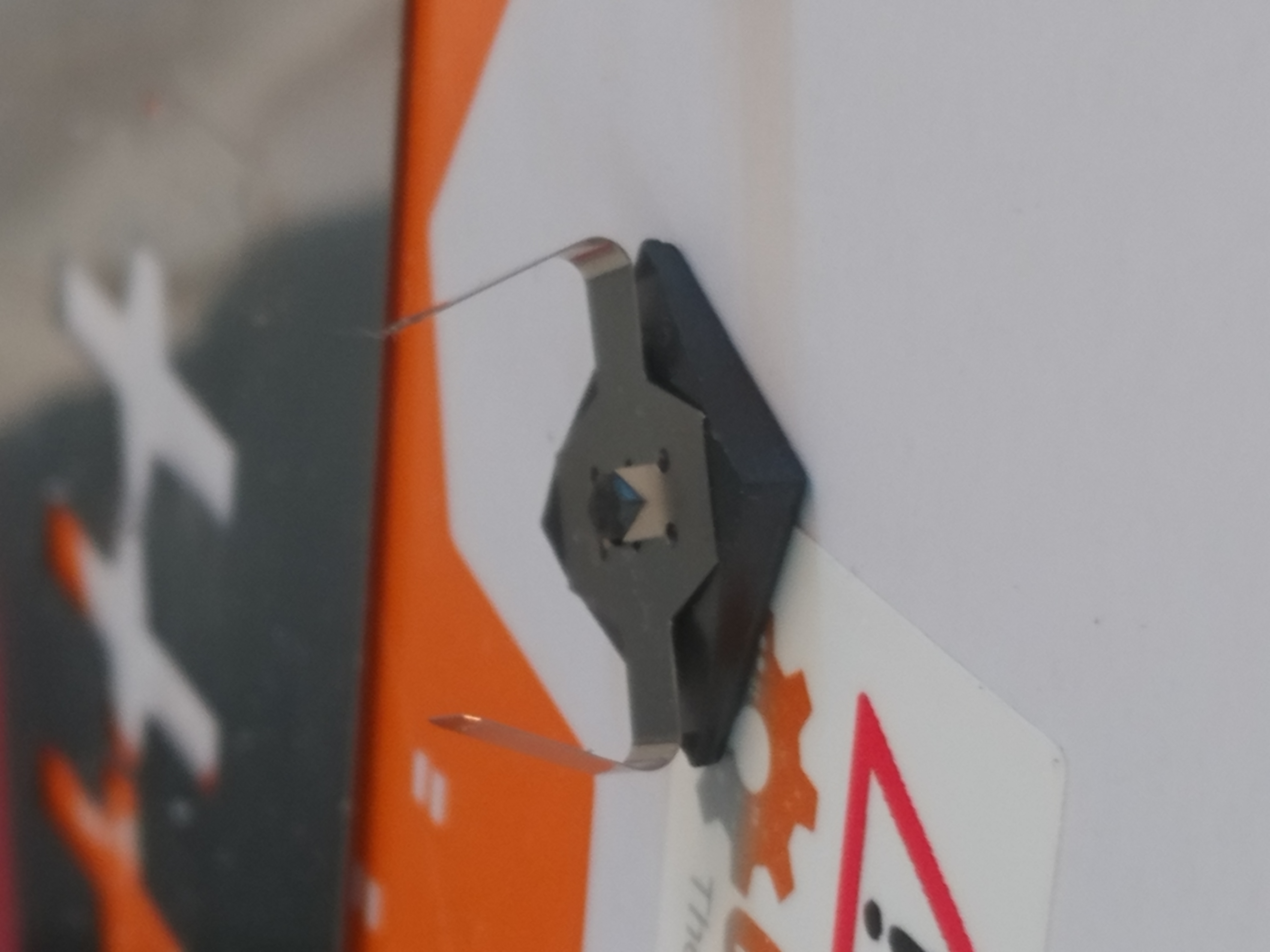

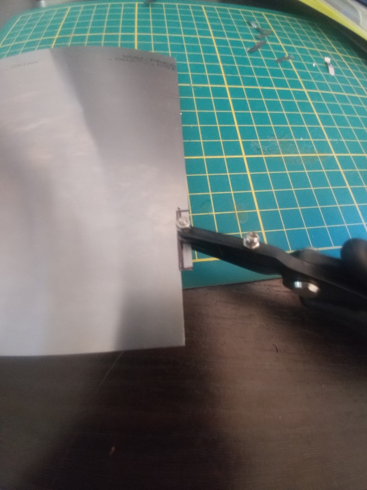

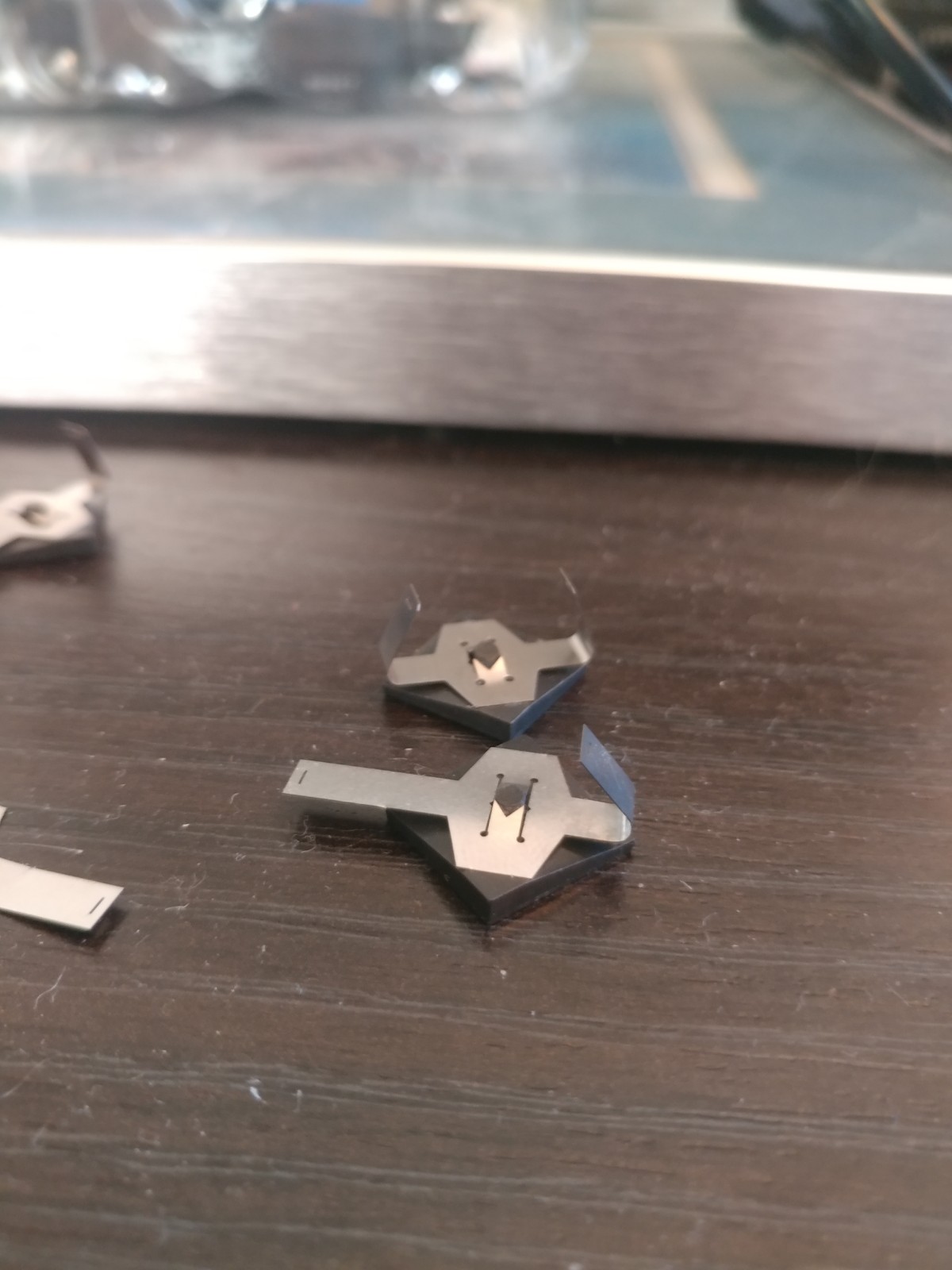

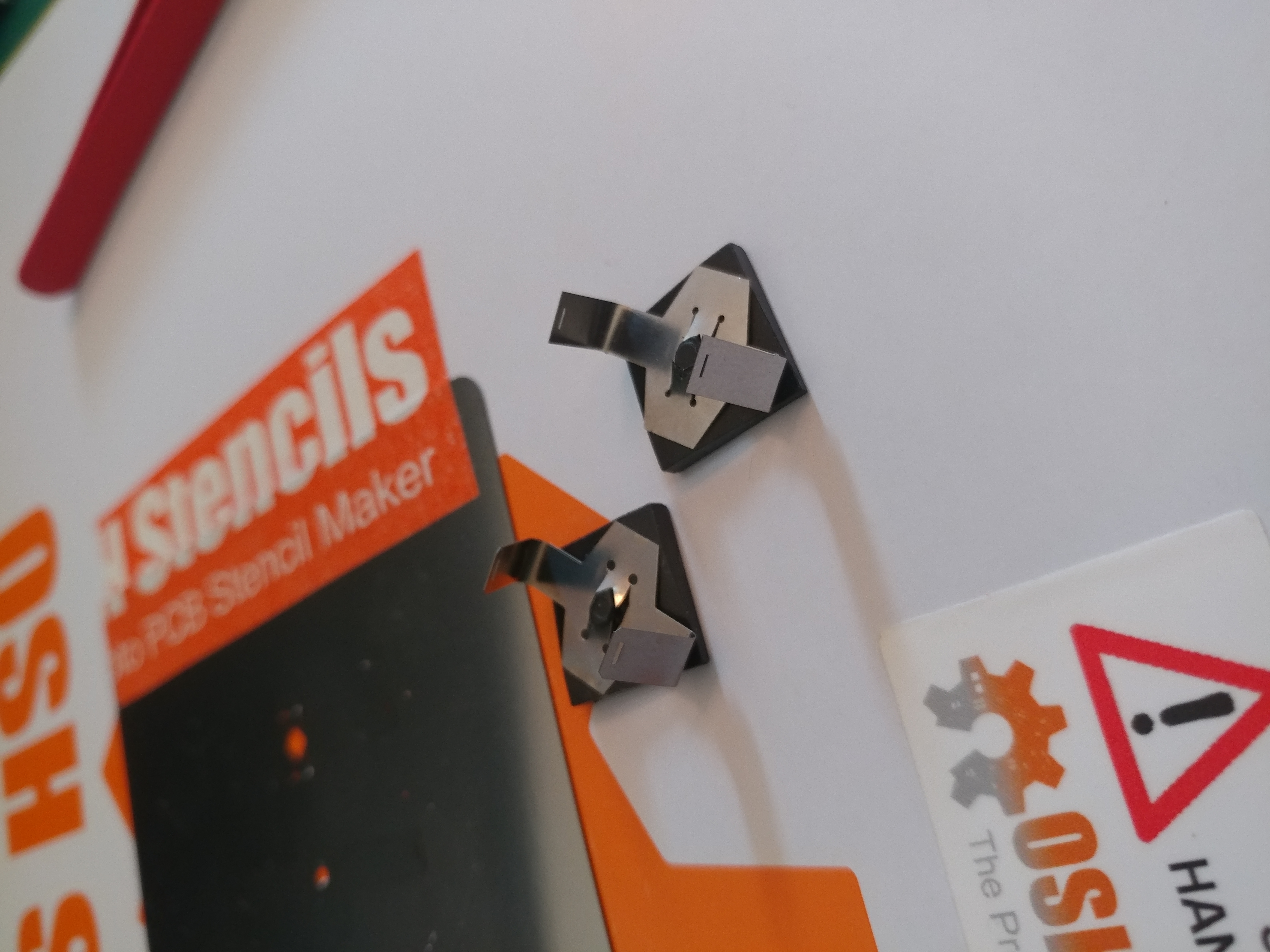

Beamspring - Reasonable Reproduction Achieved

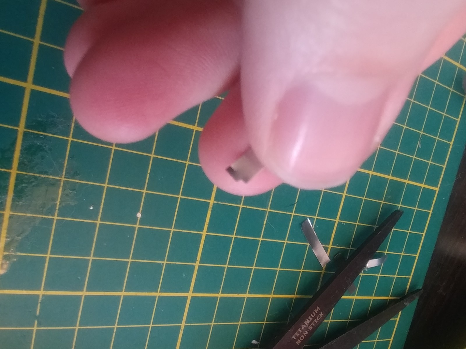

For the beamspring itself, the steel is 0.015 inches thick spring steel and you can cut it with scissors. (Don't ask me how I know this.)
The beamspring itself "should" be reasonably easy to make.......... with a press as it is just a shape with a hole in the middle. Just like the flyplate, I am currently trying to source/perfect my punch press in order to make larger quantities of new springs.

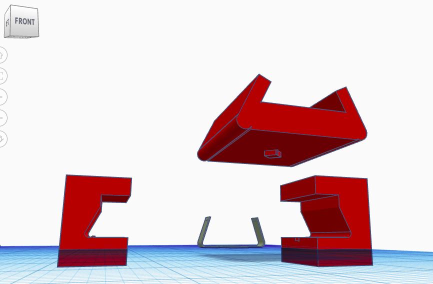

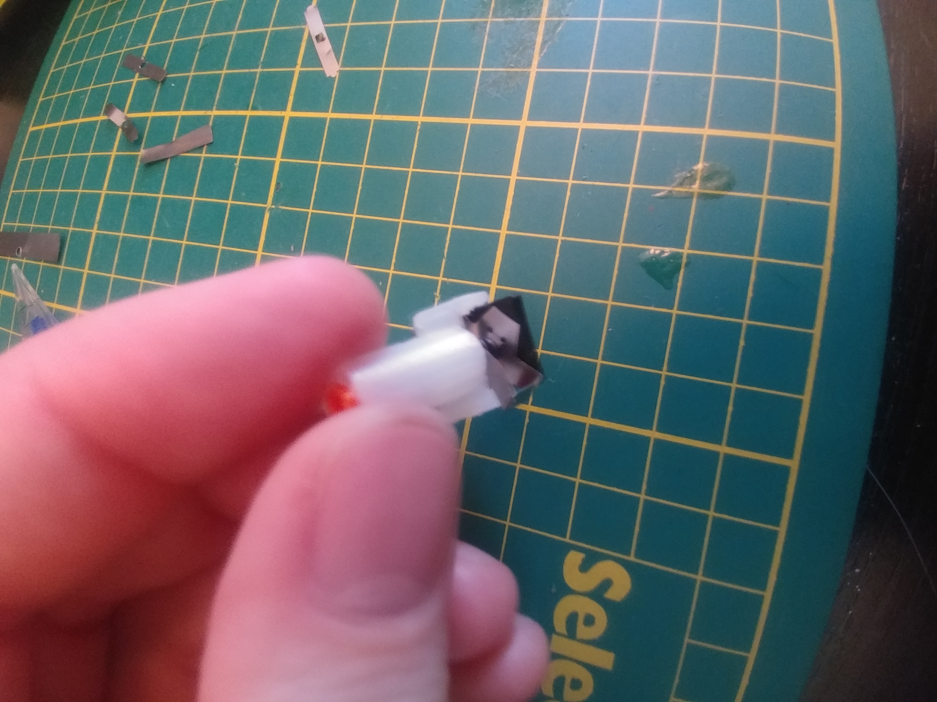

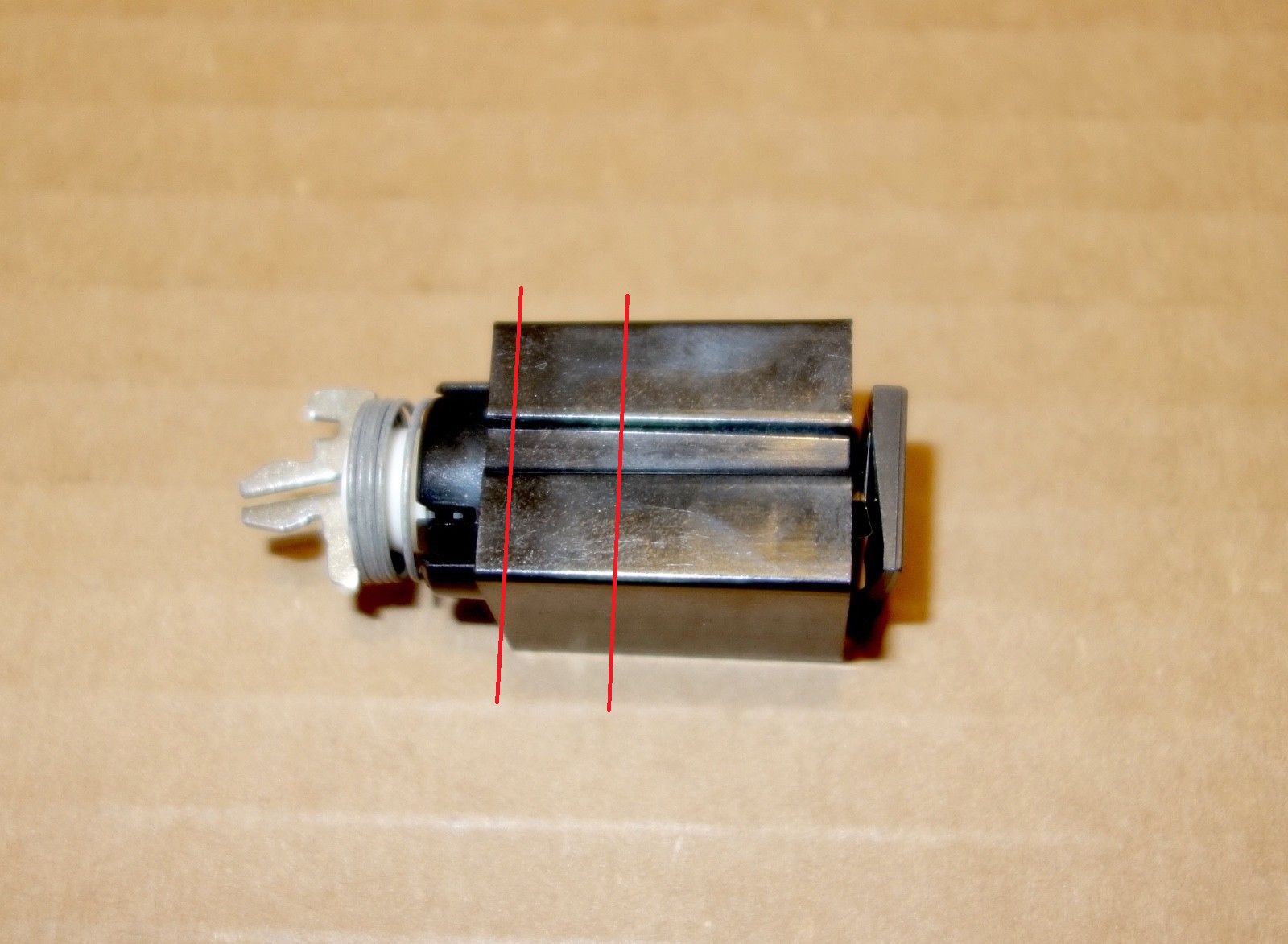

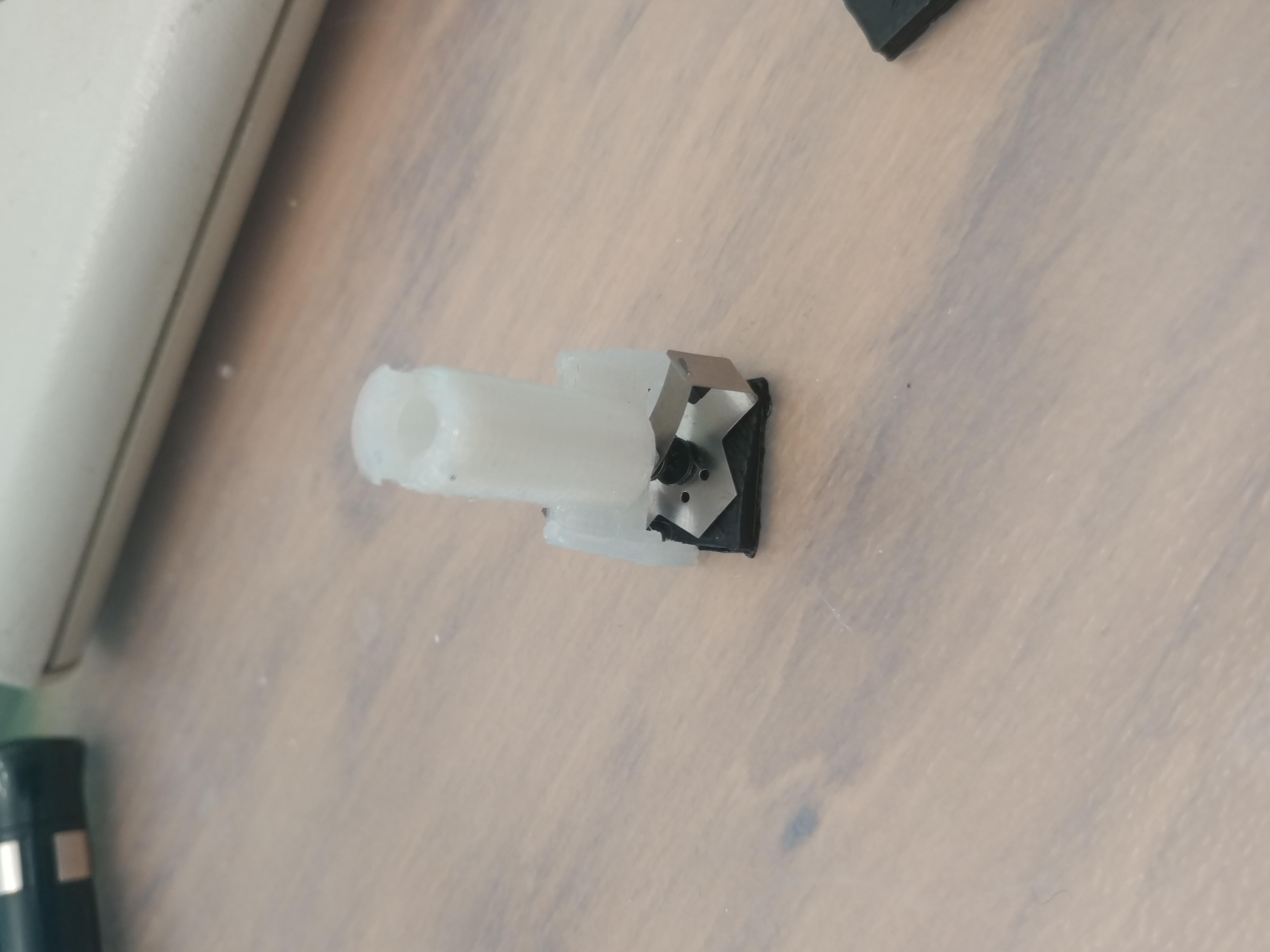

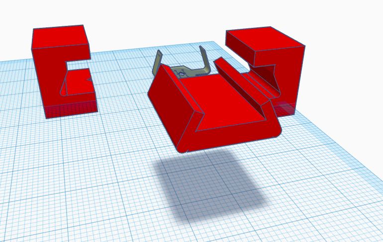

Barrel Assembly
I will upload an obj/stl of this a bit later. It is a pretty straight-forward geometric object that can be 3d printed.

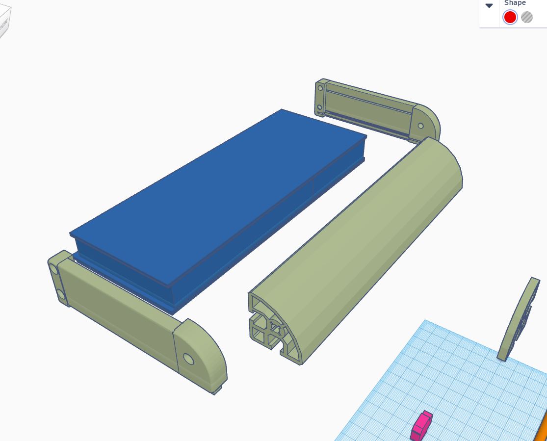

Basic work in progress 3d models for plastic parts.
https://www.thingiverse.com/thing:3641754

So I spent today trying to make return springs. I had some success.. but will need more work.
I had a concept of a 3d printed piece of plastic and it basically didn't work Which is good.
For this you need to use music wire. And a long 1/2 inch hex bolt. A piece of wood and some other hardware.
0.025inch thick music wire. You can use any brand/source>
Example https://www.amazon.com/PRECISION-METALS ... way&sr=8-5
A piece of wood to attach everything to.
This is basically what I modeled my process after.
https://www.youtube.com/watch?v=lhQBz6q ... e=youtu.be
I managed to make some smaller springs and will be able to soon make full size springs. I forgot to get a 1/2 nut so made some smaller ones. Most of them were average/poor. I showed the best one.
Basically. you need a piece of wood as a base. You will use 2 wingnuts on bolts to hold 2 plates of metal together. You sandwhich the music wire between the pieces of metal to compress it and not allow it to back up. It lets you keep up the tension.
You thread the wire through the nut and screw it down on the bolt. You then rotate the bolt and the wire takes on the spring shape. Then when done cut the wire and unthread it.
As you can see in the images I managed to make a smaller spring. It has decent spring characteristics and the newer 1/2 inch ones will function perfectly fine.

I have also been experimenting with shortening the switch. It seems like along length of the slider portion you could remove perhaps 5mm of length and shorten the switch in this manner.
I think you could plausibly delete at least the area in the redlines here.
There is also this product which obviously has shortened the mechanism albeit with different dimensions of spring.

Smaller update. Will make a larger update in a few days. I accidentally got 0.015" thick spring steel. The correct number should be 0.0015" thick steel. Doh.
I have been printing a lot of barrel housings, stems and capacitive feet. I have got the basic shapes pretty close to correct. Obviously the original ones were very smooth versus the layered 3d printing. So they are... scratchy.
For no reason I am also making brass beamsprings. Because why not.
I will take some close up photos of the pcb for interests sake.
For stabilizers I have been debating how to stabilize the keys. Almost every key except the spacebar doesn't seem to need a stabilizer. Even the space bar though can essentially be pressed anywhere and still register. I may just slice a channel along the front of a switch housing to fit the stabilizer.
This is the case design that wcass came up with. It uses 2, printed/milled side pieces that hold the plates from the side and uses aluminium extrusions as the front and back. I had to tap the holes to make threads which wasn't too difficult. The front will hopefully make the front a bit easier to type on. I may still design a 4-5 inch long flat wooden leadup/wrist wrest.
I will be assembling this soon to give the keyboard a more put together look.

Hi,
So I apparently made my side parts with incorrect measurements and it doesn't fit together properly so the case wont get together today. Sad face. I will reprint them.
Here are some versions of the side parts to keep the whole thing together. These aren't really necessary as the screws and switch housings basically themselves with just the bottom and top plate provide the necessary retaining force. The sides and front are just for aesthetics and somewhat ergonomics.
Here are some closeup pictures of the pcb for the ansi 60% one when they arrived.
The basic idea as said before is that unlike the "later" pcb which basically looks like the Model F one, this one has both capacitive pads on the front of the board. In theory this should make a stronger more consistent signal. This method uses a lot of Vias which were expensive back in the day, which is why I believe (I need to verify this) they went with the less expensive method of the second set of sensing pads on the back of the pcb for later versions. This is not actually the downgrade that it might seem like though. That method obviously didn't need as much drilling and basically itself is still super reliable anyway as seen by the various old model f pcbs that still work. I mostly did it this way for retro-fun after wcass originally showed me the old pcb.
As said, I post these to collect thoughts, have fun and share the learning. I don't have a specific time frame in mind. I will be doing some experiments this weekend with the 0.0015" thick metal that the beams themselves are made of.

It has been a bit laborious trying to cut beamsprings by hand. The 3dprinted punch die also does not work very well. It will have to be metal. I am hopeful the acid etching process will be easier. More to come Sunday.
I have my 3dprinted carbon black feet, PLA clearish housing, screws, taps and mx sticks. The switch is kind of scratchy as it is 0.2mm PLA, but everything seems to work. I am ordering a 0.1mm nozzel to use with abs.
Right now I have new pieces except for the flyplate spring and the coil return spring.
I also made a slight error with the PCB by not putting the fake pads by the spacebar to connect to the bottom row. Dur. Must re-order that.

Hi,
So using scissors isnt the best. But. But. I did make a "new" beamspring. The scissor method is currently the easiest. It is a bit tricky though as the spring is 20mmx3mm.
I believe that some kind of printer toner acid etching might be much better. The first one I made was kind of suck and a bit deformed but it works.
I believe my method of marking out the lines caused the deformation. I haven't been able to make a reliable punch die yet.
Regardless. Here is my first new spring in action.
https://youtu.be/LarHD7B1cCk

Hi,
And here are the capactive feet. There isn't much too these. Just a 3d printed carbon black conductive filament.

Hi,PlacaFromHell wrote: 09 Jun 2019, 22:46 I notice they are not flat, but we need to make them this way? Maybe cutting squares from a sheet will work as good as these non-flat feet.
I modelled the feet after the original feet and their geometry. If you see here when I press down the switch, the fly spring bends downward to follow the angle.
It might be possible to make them from some other material, but it took me 8 minutes to make 4 feet. I have enough of my $30 roll of capacitive filament to make almost 2 model m layouts worth of beamspring capacitive feet.

Hi, so I spent a while trying to use scissors to cut new beamsprings in a bit of a more nice fashion.
I have now marked this component as DONE. My basic conclusion from this process of making new "beamspring" components works. It can be a bit finicky and annoying but it works. I have now made multiple beamsprings. There is an unreasonably large amount of room here for refinement I would note.
I use m2x3mm screws to attach the springs to my sliders. The 2mm screw shaft fits through the 1.5mm hole punch I use.
My caliper showed the original beamspring at 0.001" inches thick. When I used this type of spring steel, and I did order legitimate cold rolled spring steel, it seemed thinner and very prone to bending and specifically creasing. Metal of 0.0015 and 0.002 thickness worked better. Luckily I got an assortment package from online retailer with multiple thicknesses.
You will need:
A metal hole punch of diameter 1.5mm. I go this one on the online retailer but you can use any you find as long as it can cut metal. Try to support local businesses when possible. This is not an affiliate link. https://www.amazon.ca/gp/product/B01L1J ... DWE6GHQVV9
This sort of item is generally used to make jewelry with large copper sheet pieces.
A sheet of spring steel, likely 0.002" inches thick.
A pair of decent scissors, you need those scissors that when you use them are like heavenly as they slide together. Basically ones that cost like $20.
A sharpie or other very thin tip marker that can leave ink on steel.
A clear ruler with mm indicators.
Drawing
Use the marker to mark out a point called center.
Mark this point and hole punch it. You will then draw a rectangle centered on this
of dimensions 20mm x 3mm.
Cut that shape out with your scissors.
It may be wider or slightly longer than the original so try to trim it.
Now at either end, you will cut, 1mm down from the tip a slit of about 0.8mm toward the center. It is a bit hard to see.
Then from the end cut down to those previous cuts to make a interior corner. You will do this 4 times. You basically want a tab at either end of the spring that can fit into the flyspring part.
The result is a 20mm long x 3mm wide piece of metal of either 0.0015" thick or 0.002" thick spring steel with a 1.5mm centered hole. It will have 2x 1mm tabs at either end.
Various attempts shown here of various levels of success.
The main rectangle portion then is 18mm long and the 2x 1mm tabs bring it to 20mm full length.
That's it. You have made a beamspring with scissors.
You will need to cast or 3d print a slider with a 2mm hole capable of accepting a 2mm screw. For my sliders I have added 2 small guides to make the spring not able to rotate. This is not pictured here. Without tabs, there is nothing preventing the spring from freely rotating aside from screw friction.
You will need:
Drawing
[/attachment]

Quick update but I took manisteinn's idea about the flyspring plate and ordered a test batch.
I will be trying to bend these into the right shape and will report back later how well they work!
- beamspring stencil flyspring.jpg (1.39 MiB) Viewed 35447 times
- SneakyRobb
- THINK
- Location: Canada
- Main keyboard: KB-5161A, F122, Dc2014, Typeheaven, Beamspring FXT
- Main mouse: MX518 Legendary
- DT Pro Member: 0242
Hi,SneakyRobb wrote: 29 Jun 2019, 18:20 Hi,
So the flysprings that I got basically work but they do need some adjustment. They are almost tactile right now. Sort of having more of a bump. I think this is because the curve that I put on them is more of a folded line.
The originals were bent into shape but have a nice curve to the top, mine have a sharper bend.
I may get some jewelry pliers in order to bend them to a more correct shape.
Regardless they do work. I used 4 mil stainless steel which is a bit thicker 0.004" vs 0.0035" than the original.
Original.
The new ones dont hold on as well. The screw variant works alright.
Side by side

Hi,
So after many attempts at bending the flysprings I am refining a 3d printed molding block. So far the best way to get the gentle curve has been to use jewelry looping pliers. I think the 3d printed form will be easier in the long run and at home when I need to make over 100 for the full size beamspring keyboard.
Here we can see the corners being too sharp when I tried to bend with regular pliers. Bad idea.
Here I am using the looping pliers to make the curve into a nicer shape, still a bit hard to align it and make it square. The corners though have that nice curve which is what we want.
The curve is about a 2mm diameter rod so I used the 2mm part of the pliers. It works pretty well, but getting it to be perfectly aligned is hard.
I am trying to perfect a bending tool that uses the center peg to align it all so it can be easily bent by hand. I think this will be the easiest method. it is just a small piece of plastic that is slightly tighter than the original shape so it springs.
I have about 100 extra flysprings coming in the mail next week and id rather use the tool than the pliers.
