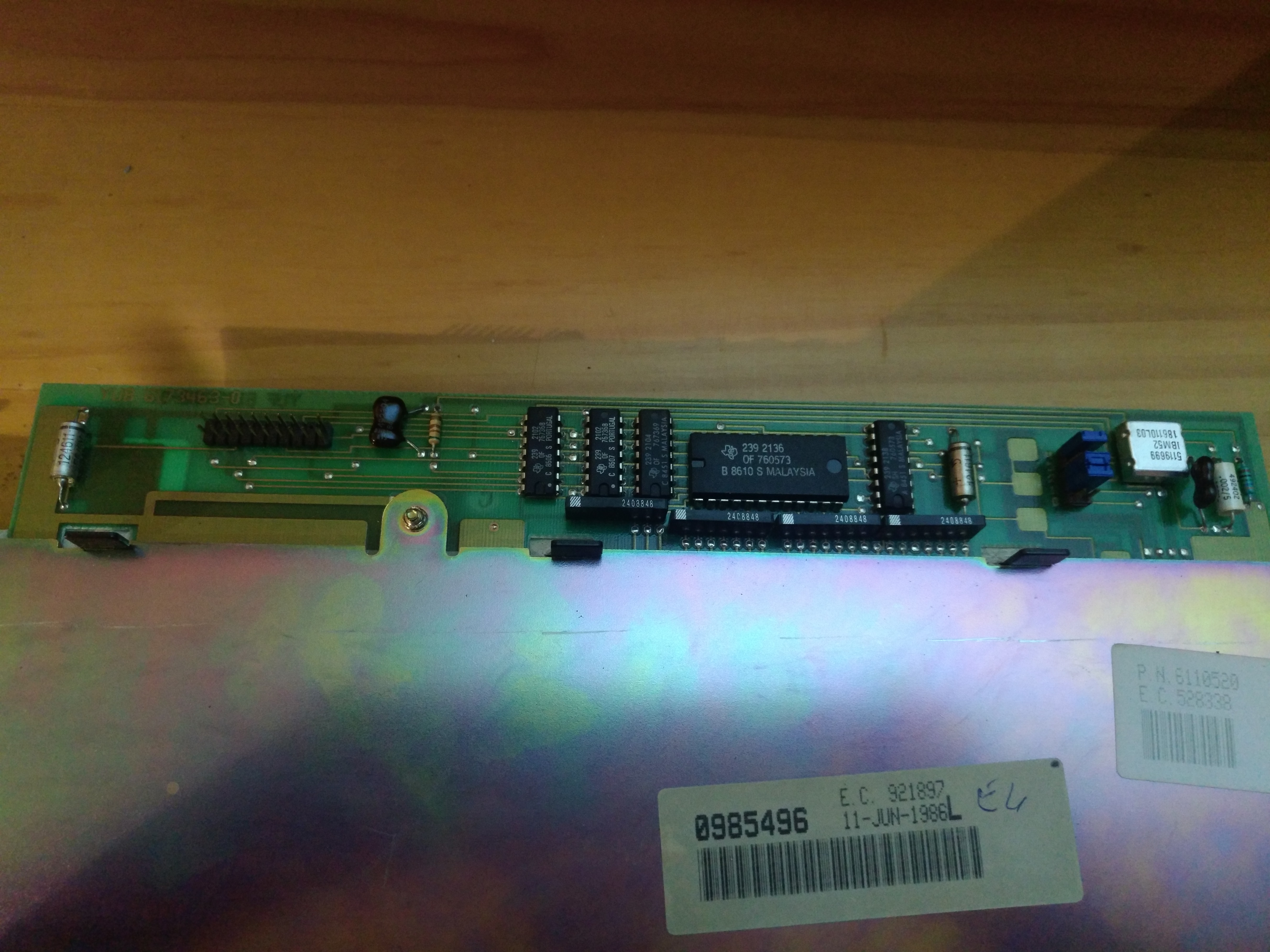

Hello everyone, hope you are doing well.

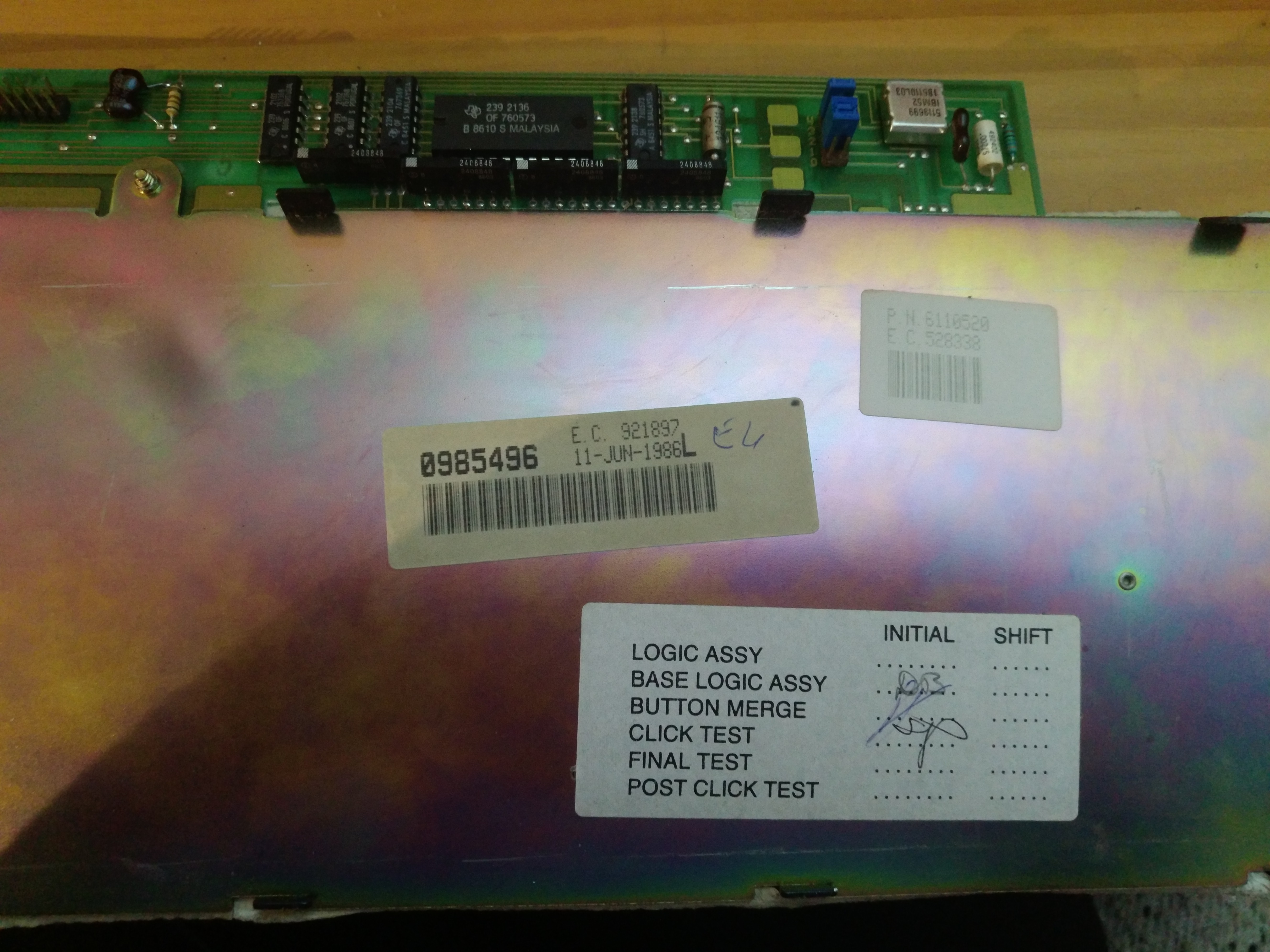

So, I got a Model F 8521, a model that certainly is not that popular as I thought it would be. Well its just a normal BigFoot, but with Spanish layout and legends. I'm currently in the process of building a controller (not adaptor, as this model doesn't have any CPU!) so it can be used with a modern USB connector. I was following this thread https://geekhack.org/index.php?topic=48950.0 when I ran into a little problem. The connector that used to go to the terminal has the missing pin in another place, and VCC is also misplaced, and for the keyboard itself, I have jumpers on positions 1,2, 4 whereas all the rest seems to have the jumpers shorted only at position 0.
My guess is that this keyboard is exactly like the others, and that I only need tho change the jumpers and wire it directly from the board to a Pro Micro, like everyone does, however, I would like to be sure that there is no further difference, so that's my question: is it any different from the other Big Foot out there?

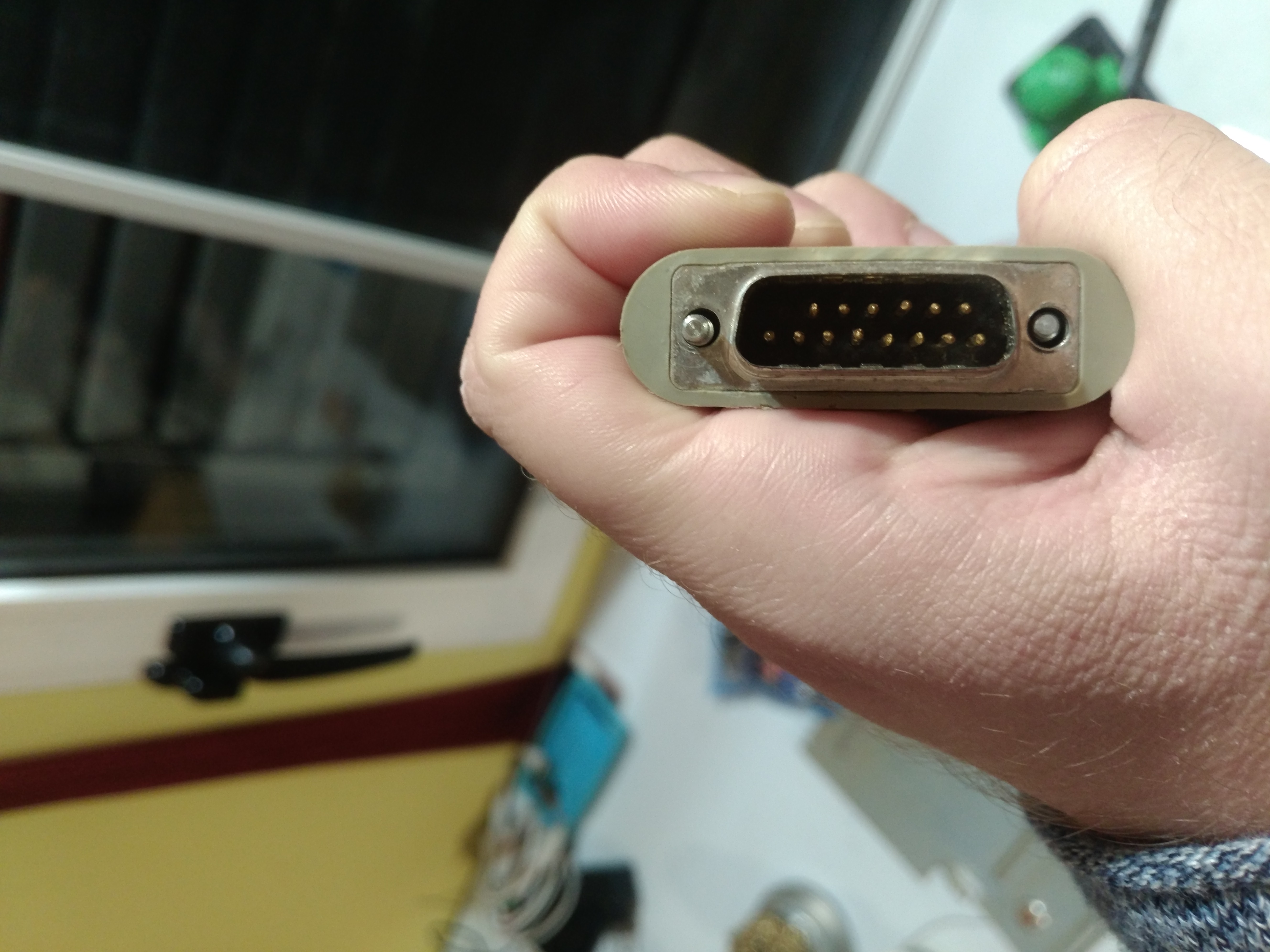

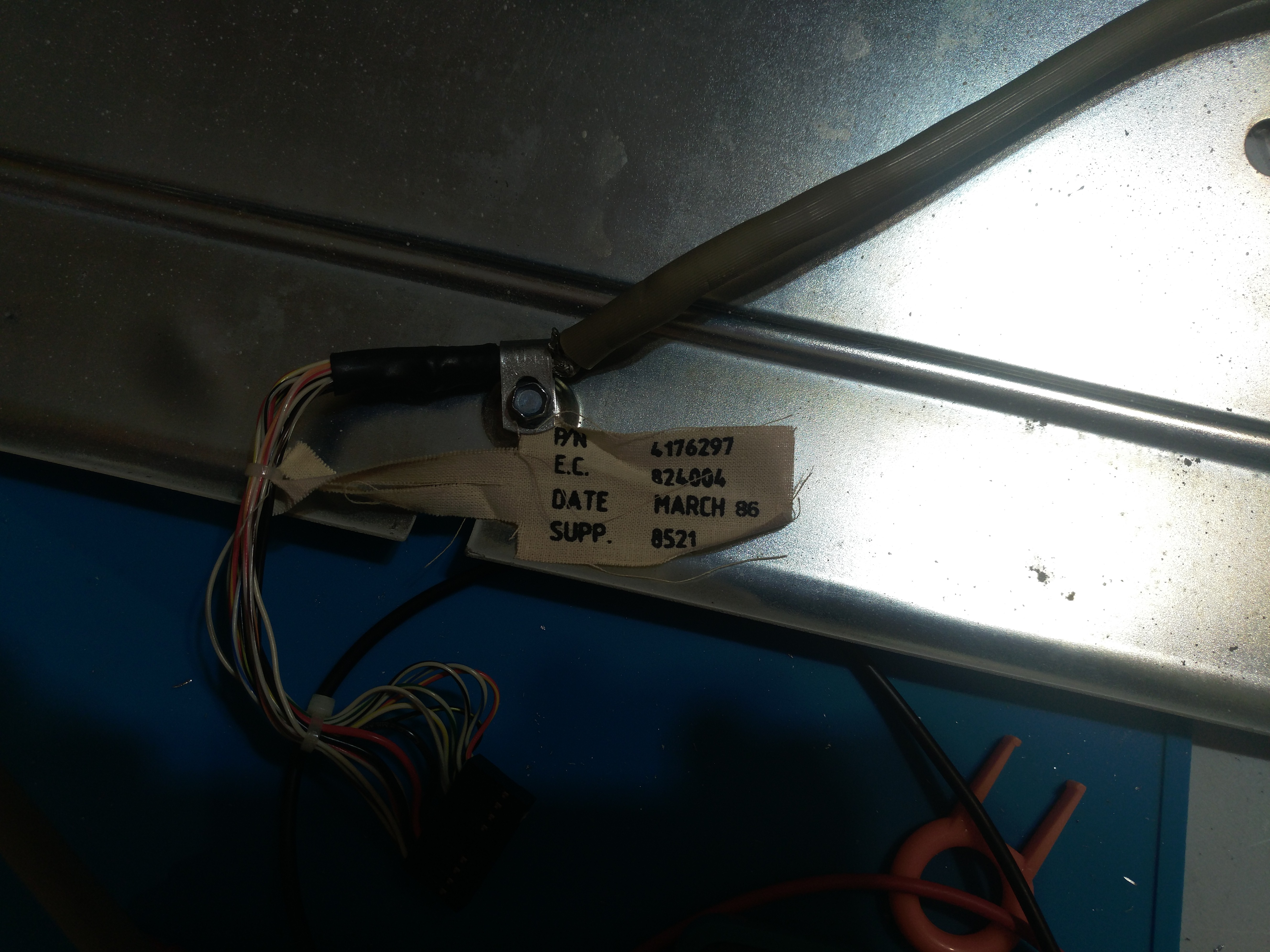

Some attached pictures!

If you have access to a regular XT capsense PCB, since the layout is the same, you can just change capsense PCBs (which has the controller on it) that and you'll have an easy to convert XT signal and you could even use the XT's original cable if you so choose. I've made this suggestion a few different times on different threads and I can't say I've seen anyone actually do it, but I see no reason why it shouldn't work given that the layout is the same and I'd have to assume that the retaining clips that hold the capsense PCB down to the backplate are also in the same places.
I don't have a bigfoot to try it with myself, but if I did, I'd probably go the Model F XT PCB route if you can get one without having to pay international shipping rates. Alternately, you might just totally swap XT guts into your case if the backplate uses the same mounting as the XT.
Other thing you could do is chop off the original controller and handwire to commonsense or Xwhatsit, like I have done here: viewtopic.php?t=19522

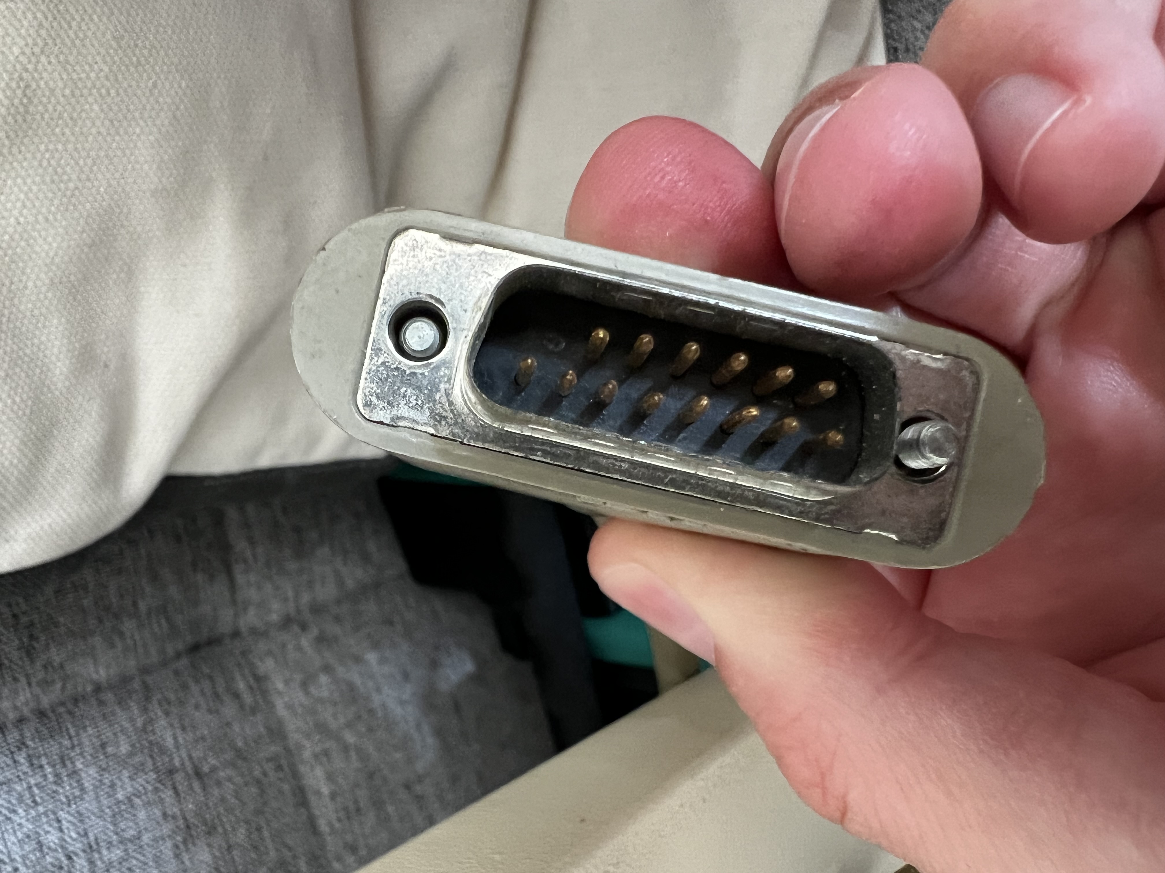

Hi, did you make it run with the Arduino Pro Micro?
I have acquired three Bigfoots and would like to use the cheaper Pro Micros instead of the expensive Teensy or Micro (without Pro).

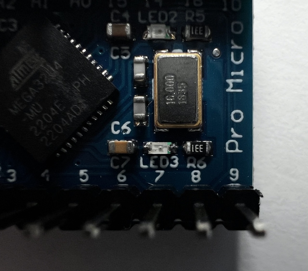

If you're using Soarer's Controller firmware, it can work but with one modification. The firmware's (at least by default) use of pins was designed with Teensy 2.0 in mind, and one such pin it uses (PB0) is exposed on the Teensy 2.0 but is used internally for an LED (RXLED) on Pro Micros. You should be able to remove the LED's resistor and solder a wire onto its pads to recover the line. See my website for the full pinout you need to use for Soarer's Controller on Pro Micro.AngryCockroach wrote: 10 Apr 2024, 16:33 Hi, did you make it run with the Arduino Pro Micro?
Oh wow, thanks for the fast answer. You mean the black little one on the right?
That is very tiny... I soldered the legs on the micro several times for other Ms or Fs, but that tiny thing looks difficult....-
I just saw teensy for under 10€ so I think I wait a little until they arrive before I destroy the pro micro…

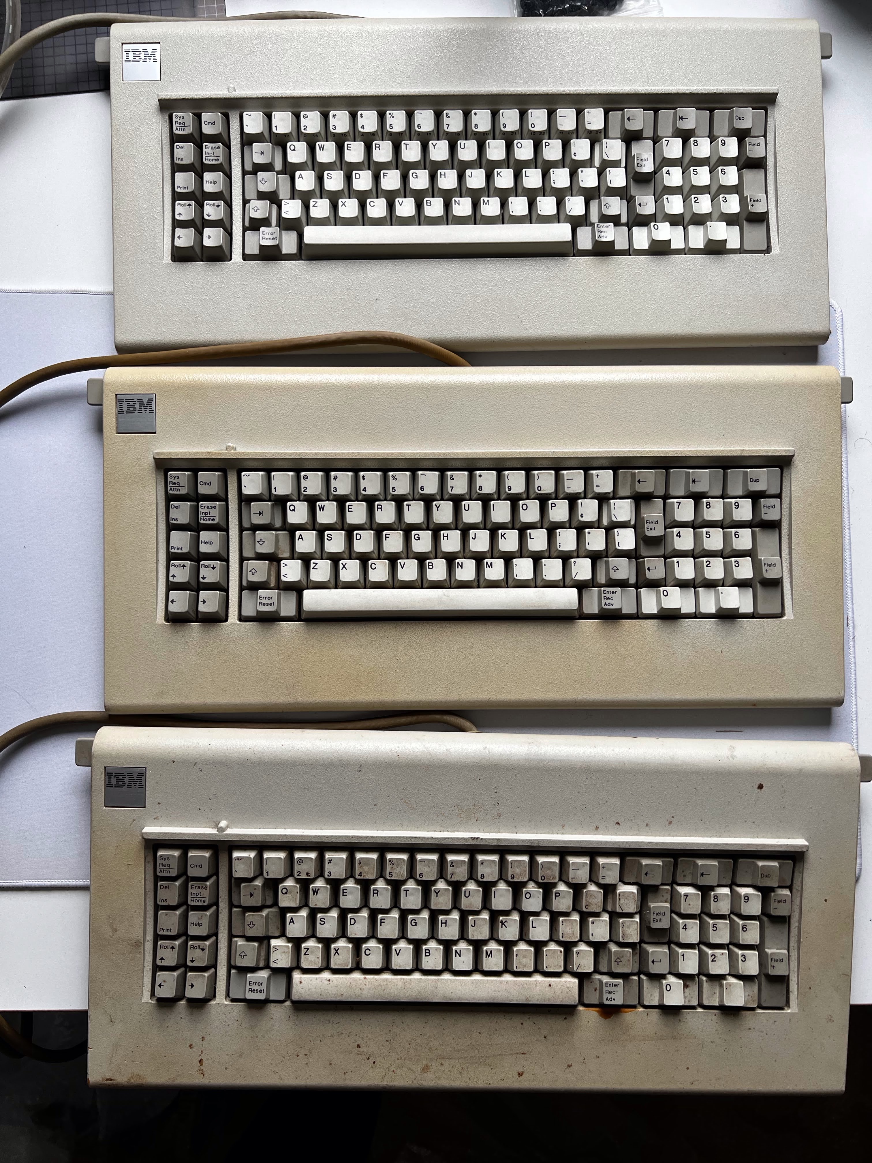

Here are the bigfoots. I will paste pictures after the restorations.

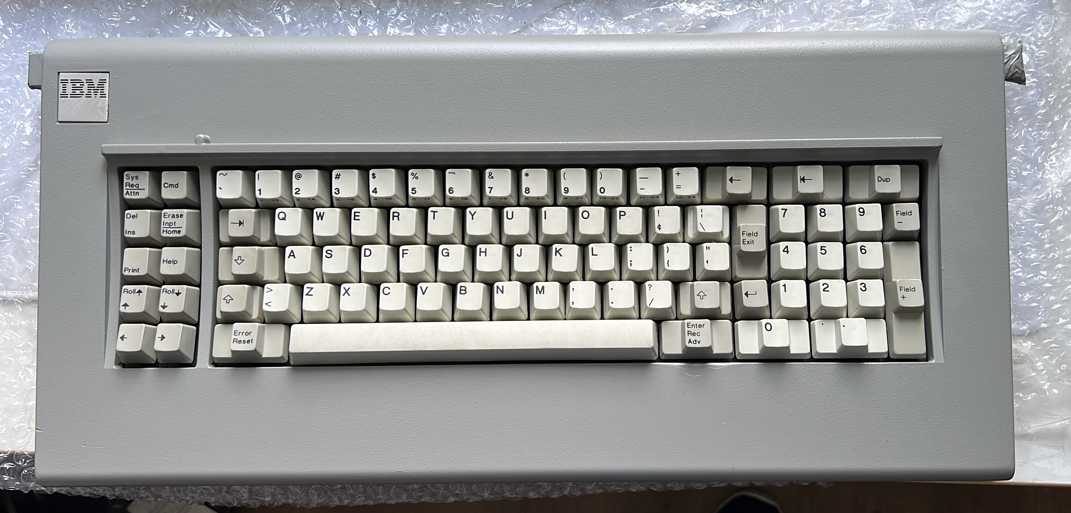

And I painted the last keyboard grey because the paint was damaged and I wanted the industrial look.

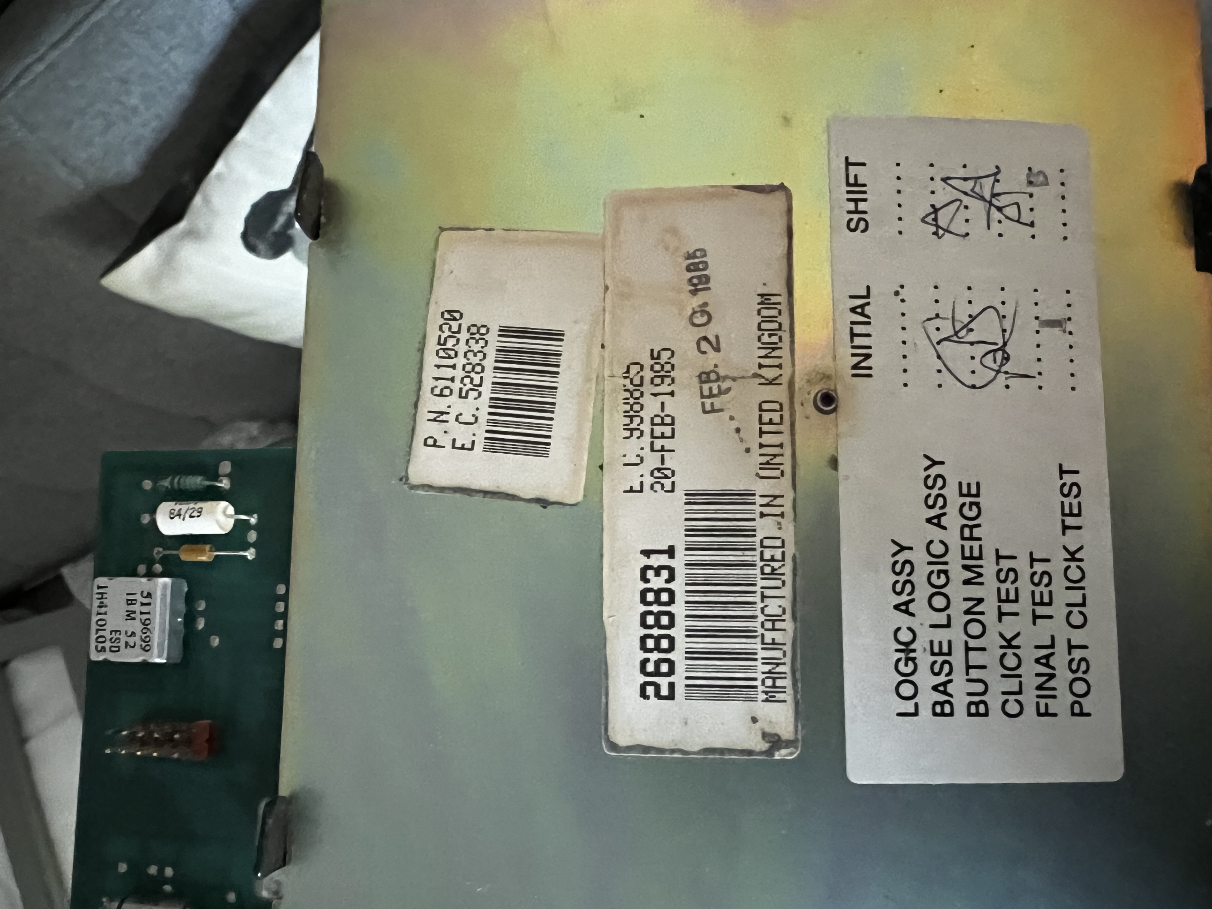

Do I have the 5291 or the 8521?
The product number suggests the 5291 right?

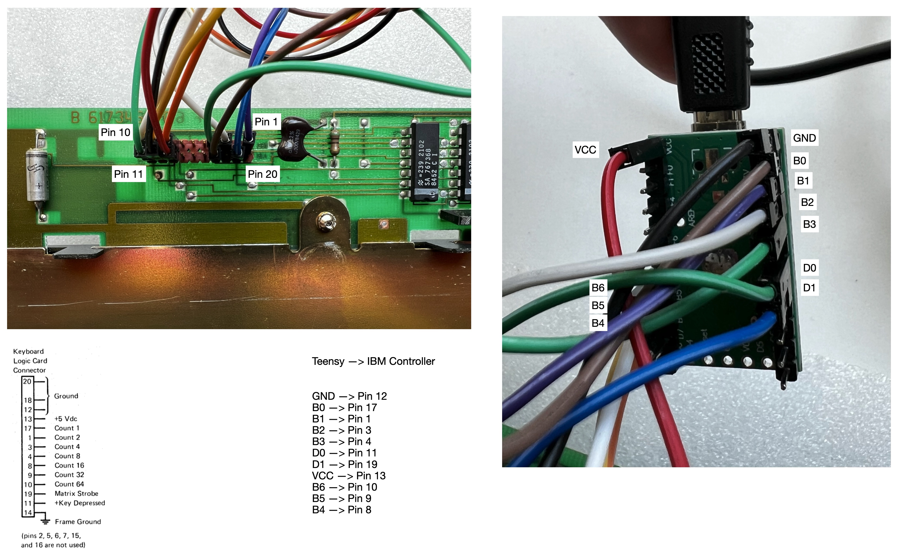

Ok, I found the issue:
The linked guide on geekhack is wrong: Wire 2 and Wire 3 need to be each one pin above!
Here is how you connect the keyboard to the Teensy:
I had some duplicate outputs which I fixed with debounce 2 (instead of 1) in the config.
