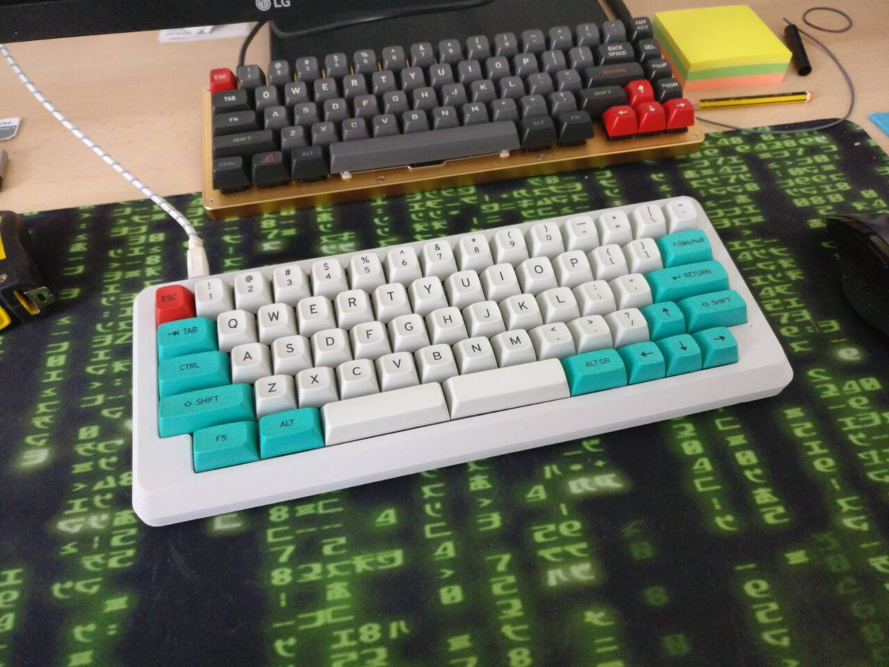

I think I could do with a 3u+3u spacebar. I find the button between the spacebars just a filler
- zrrion
- Main keyboard: F122
3u+3u spacebar is the best space bar so this makes sense to me.
- Location: Texas
- Main keyboard: Kinesis Model 130
- Main mouse: Logitech M-S48, Razer Viper
- Favorite switch: MX Browns
My mind is telling me vertical 2u, but my body is telling be 4u+4u
3u+3u is great. Symmetrical bars are hot. Asymmetrical bars too. Really split bars are great in general.
I should really stop shooting in raw, the color correction is weird with Gimp

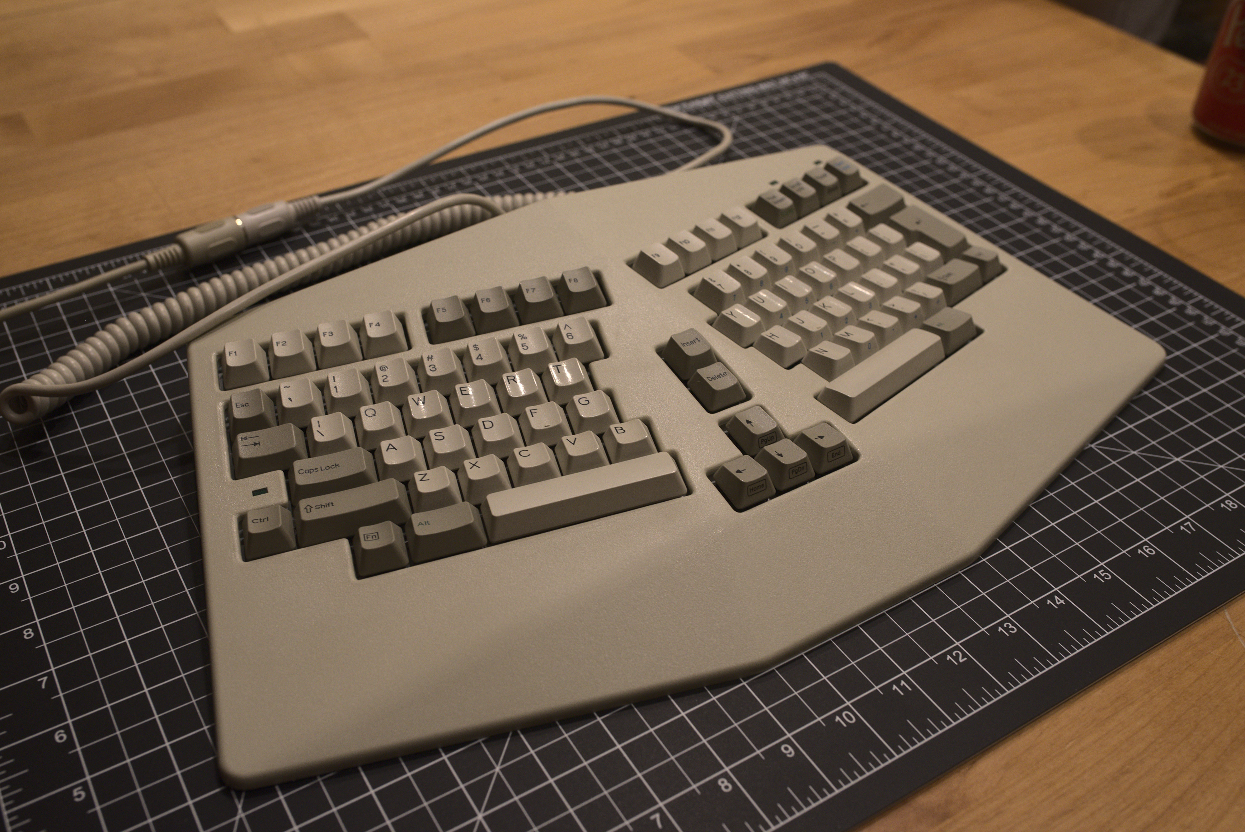

I made this
