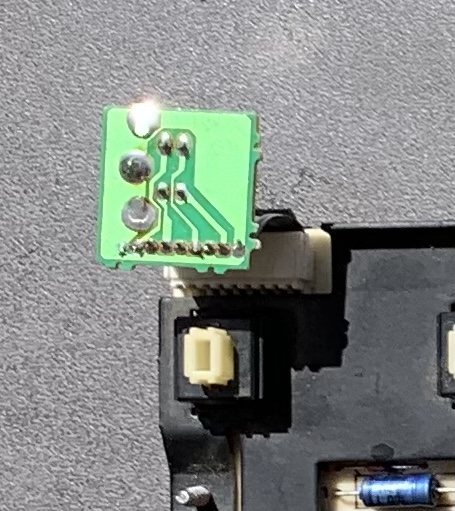

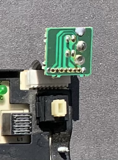

I’ve checked with the pictures of the cleaning of my AEK II. The daughterboards aren’t identical.Muirium wrote: 13 Apr 2021, 13:41 Can't remember if the daughterboards are identical or mirror imaged. It's been a while. They are at least very similar.
- D214F68F-A242-4002-BDB8-0E056574922B.jpeg (117.89 KiB) Viewed 21762 times
- 584645FD-0292-4556-A414-008DB69F2440.jpeg (106.77 KiB) Viewed 21762 times
