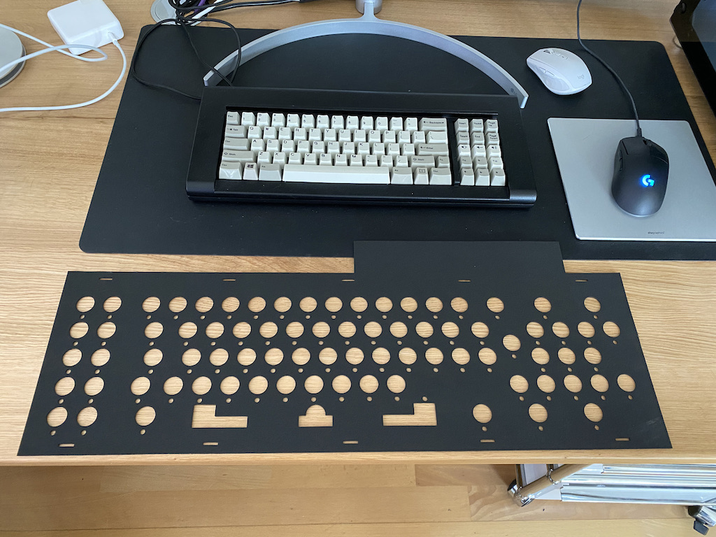

I have two laser-cut foams for Model F AT (design fits good) free to good homes.
Foam 1: EVA craft foam, 2mm
Foam 2: Open-cell polyurethane foam, 2mm
Conditions:
- you must have, or have bought, an F AT in need of foam repair - no hoarding!
- you need to tell me how suitable the material is for the purpose after you reassemble
- you pay shipping
Cheers!
Edit: Added pictures, top one is foam 1, bottom one is foam 2.
Conditions:
- you pay shipping
Cheers!

What are the differences between these materials then? Thickness? Feel? Intrigued.

If you're gonna swap the foam right away and can report back, then I don't mind - I just want them to get used immediately. I got these three done to test materials, but after my nightmare with clamps and neoprene, I didn't much fancy reopening my AT to try the other foams. The EVA craft foam has been used by other people before, the open cell polyurethane was a bit of a shot in the dark - it looked quite similar in consistency to the stuff I was removing from the AT so thought it might be worth a punt.Muirium wrote: 19 May 2021, 13:07 Well, I hear you're really supposed to swap out the vintage foam before it ruins everything, so maybe I'm not hoarding when I ask for one of them for my AT…

I have XT, AT, F122 and Kishsaver neoprene foam mats ordered. I don't have the full price yet, but I will just request the price I paid + shipping. Once I have them in hand and photos to share, I will post it here (should be within the next 3 weeks).gianni wrote: 20 May 2021, 11:05 I'm interested in AT and XT foams.... Are they still available?
I can pay a reasonable price for the foams, if it is possible to order two of each.
I have a beamspring too, but I have no idea if it has any kind of foam or not![]()
thanks
The AT one is already here and has been tested.
Ordered it from https://snijlab.nl and the material is: https://snijlab.nl/en/materials/254

I've been crafting a lot of foam mats lately, all pretty lazy attempts that didn't take me long and the holes all line up snugly with my rudimentary method of marking them. The perfect material that is working flawlessly is this: www.ebay.co.uk/itm/252353238313
I used the 2mm thickness in my F122 and the 3mm in my Bigfoot and XT. The 3mm is so much more solid and I think it's perfect for the application. This specific product is soft enough to compress without exerting much force outwards, so the plates aren't pushed apart like with firm art foam and therec's enough compression to seat all of the barrels without wiggle. I've tried other seemingly identical products from other sellers, but none are as soft as this.

Wait, are you saying you designed it with the CAD program set to inches or did you forget to check the "use sane units" box when placing your order?
- darkcruix
- Main keyboard: Brand New Model F F77 Keyboard
- Favorite switch: Ellipse version of Buckling Spring / BeamSpring
- DT Pro Member: 0209
I used the original design which used inches as unit, but I forgot to convert that downObin wrote: 07 Jun 2021, 14:48 Wait, are you saying you designed it with the CAD program set to inches or did you forget to check the "use sane units" box when placing your order?
