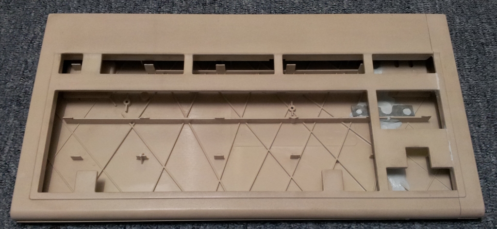

Tarkoon brings up the idea to make a 1501 a tenkeyless.
Controller is in the right position, the case is screwed and easy to mod.
NKRO and all the old DS sets fits without moogle kit.
This time i use some little metal pieces (instead of plastic) as stabilizers. So i am able to bring up more pressure during the "gluing".
The PS/2 cable is atm not detachable. Tarkoon plans to do it. So i maybe change this before i spray the housing.
Maybe a USB converter find it's way...
The keycaps are mixed. Many 2551, few 1501.
I will update this the next days / weeks.
I am not shure about the color i should use. Any proposals?

this is an optical illusion
in the 3rd pic, the fine glue (brown) fills all the litlle holes. the sanding is also done.

Magician
So you're saying it's physically near perfect (when feeling) just needs a lick of paint? Awesome, grats, have at it!
*edit to take back any doubt of you/ceesa making this one niiiiiiiiiice after having done sixty's, somehow remembered that reversed, that sixty made yours xD

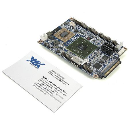

I'm considering using the space of the card-reader for something like this : 10cm x 7.2cm
EPIA-P900-10 1.0GHz Eden X2
Pico-ITX Board with 1.0GHz Eden X2 CPU, MPEG-2, WMV9, H.264,
1 x LVDS, 1 x HDMI, 7 x USB, 1 x IDE, 2 x SATA, 1 x GigaLAN, on-board DC-in
http://www.viaembedded.com/en/products/ ... serialNo=6

That's 4 rows you'll be needing (provided that the hdd doesn't extend past that), doubt you could sqeeze that in that top portion... But GL/HF, it IS a nice idea!Peter wrote:I'm considering using the space of the card-reader
10cm x 7.2cm

nice idea, back to the days when our Computers were build in the keyboard!Peter wrote:Nice SSK !I'm considering using the space of the card-reader for something like this :...
I just closed my 1501 but before that I took some measurements and compared them to the ones taken from the datasheet of the epia board. It will be a pretty tight fit if at all.
Main Problem i figured would be the height of the unit, as the Board ist 3cm thick with all the connectors and DIMM and cooler. Another one ist the units length of 10cm - combined with the thickness this will most likely interfere with the keyboards PCB.
Not saying that it can't be done, but it's definitely not a drop in solution imo. Take pics !
