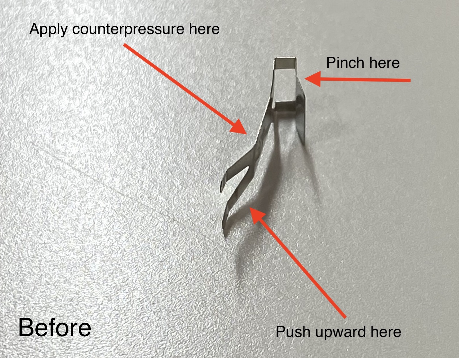

After full disassembly, boiling of all plastic, and reassembly some of the Alps were still dodgy- either not firing or only firing sporadically or if the slider had pressure applied at an angle. Something had to be amiss. I disassembled the top housing and tried manually actuating the switch by pressing the actuation leaf with the back of my tweezers. Switch worked just fine, so it has to be a problem with the motion during actuation.

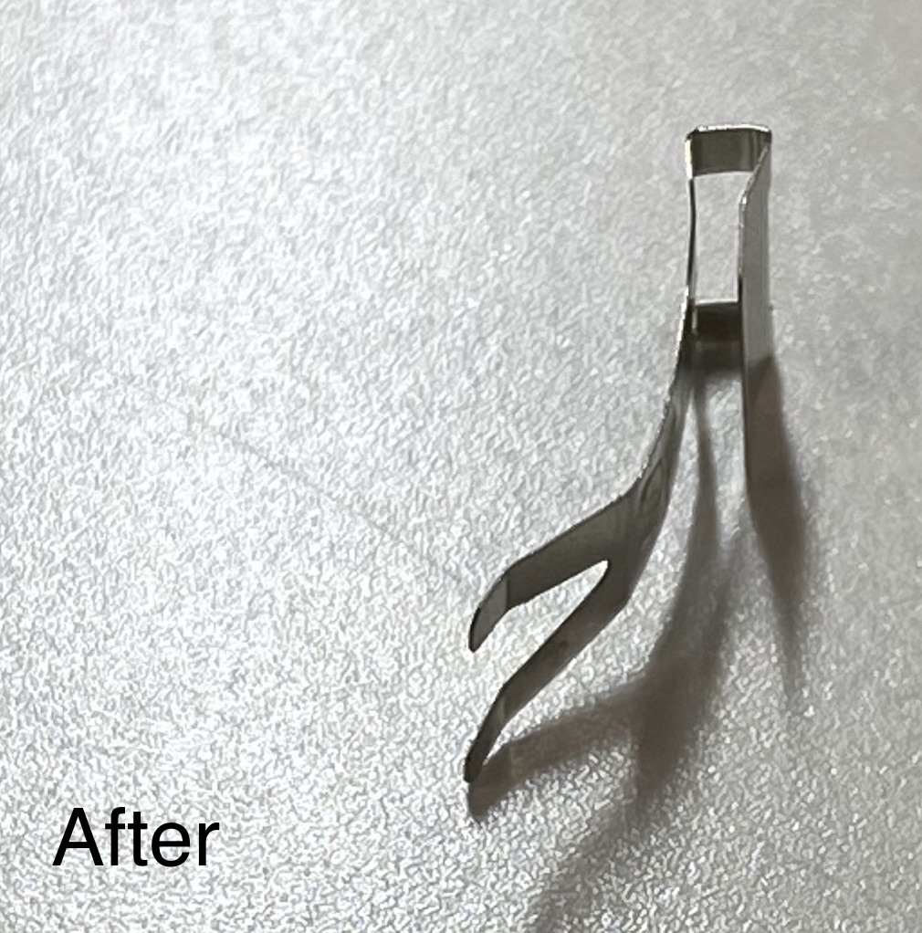

Upon closer inspection, it appeared that the actuation leaf was seated properly but was loose and not quite in its original shape. I took the actuation leaf and pinched the top section together to ensure a firm grip on the top of the switch plate, then bent the legs outward/upwards to ensure they would contact the slider when it was pressed down. This made for a very snug fit on top of the switch plate and aligned the legs so that the slider would contact them when pressed. After reassembly, the switches fired 100%.
Don't worry that this looks distorted or not quite at the same angles as a functioning switch. Reattaching to the switch plate corrects the top section, and pressing the switch a few times returns the legs more to a normal state. It's possible that you could bend the legs TOO far, in which case the switch would register as pressed even when it's not. Use some bloody discretion here, folks.

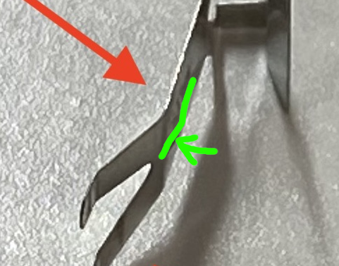

VR20X6 has been doing a similar bending for some time using flat tweezers or similar (forceps might work, etc.) on either side of the crease to prevent the metal from bowing by causing it to move only on the existing crease.
If you've got the tools, try it that way.
