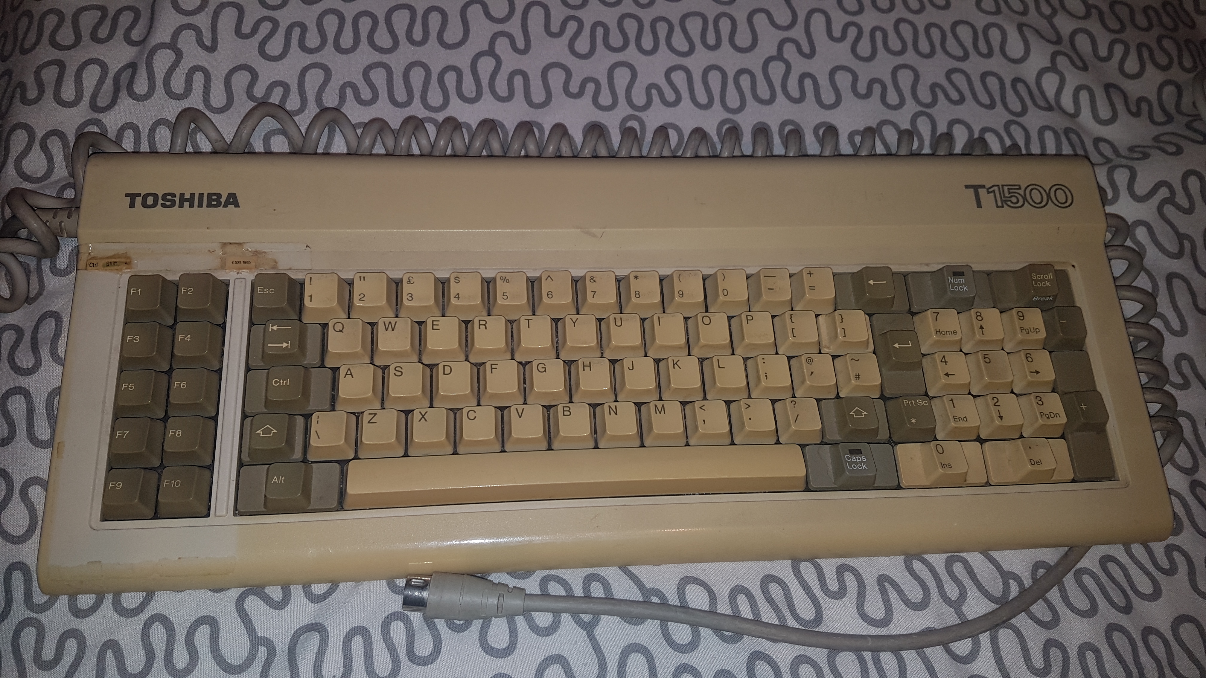

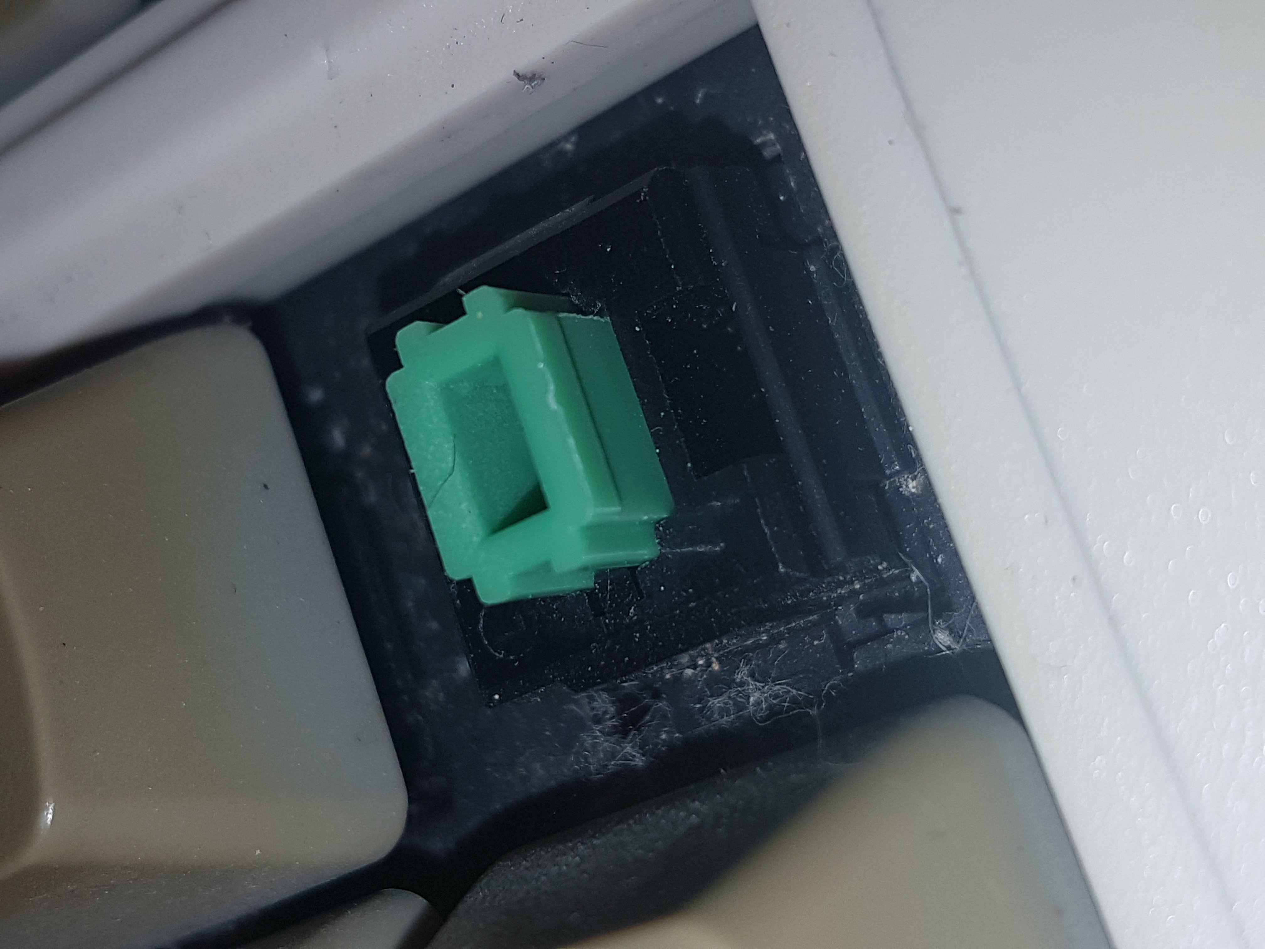

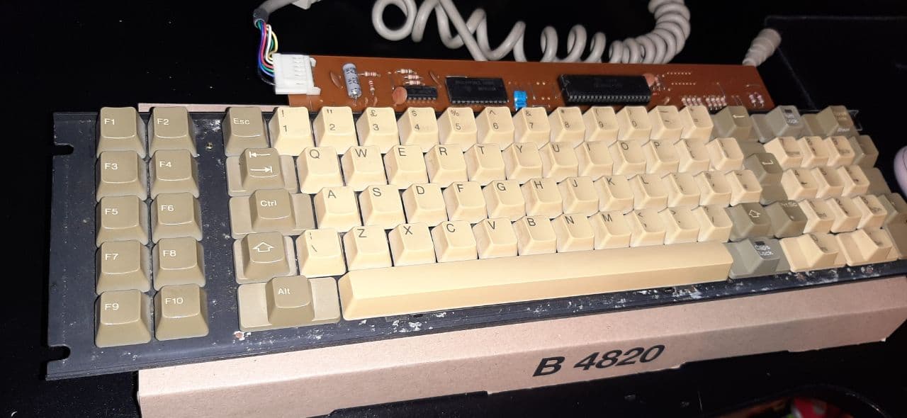

So the other day whilst scrolling through the depths of Ebay I happen upon this vintage XT looking keyboard. Labelled Toshiba T1500
Intrigued I send the bidder a lowball opening bid. and after some talking and the mention of an AT101W for sale we end up agreeing on a price.
Now I knew nothing about this board going in. Total gamble. So, imagine my surprise when I receive the board a few days later, take of a cap, and am greeted by a very familiar sight. An ALPS slider!
Indeed I found out after purchase that this keyboard uses old Alps SKCL Green linear switches! Which REALLY piqued my curiosity,
Now why I write all this is simple. I want to know if anyone has any further information on this particular keyboard. All the info I could find online was a dead forum thread regarding the Toshiba T1500 Personal Computer and a weird magazine ad.
Furthermore, would a basic XT to USB converter work for this particular board? Like tinkerBOY's IBM AT/XT converter. I'm not entirely sure if it's an IBM compatible, or if it sends out entirely unique scancodes. I'd really like to try daily driving this board on modern hardware!
Thank you for reading, if you have any info post it below. Following are a few pictures of the board in question.

Apologies for bumping this but I figured I'd post an update,

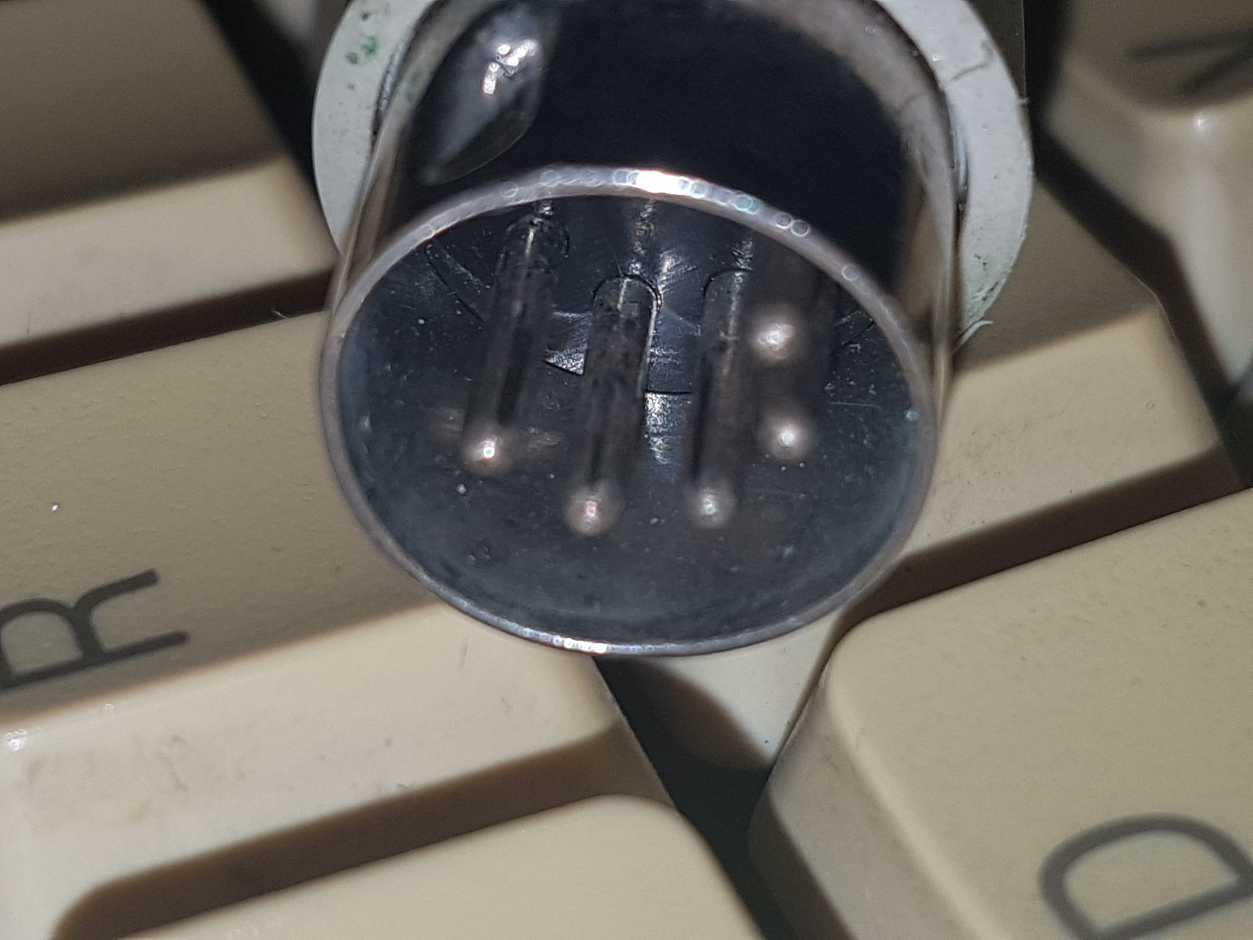

I've recently gotten a basic Din 5 to PS/2 passive adapter, in the hopes that this board would just use the AT protocol and be easily converted to PS/2 without any active converter. (The board has lock lights which was an indicator to me that it at least isn't XT)
Whilst power does get through to the board no data seems to actually make it to my PC. I can sometimes get the lock lights to turn on/off but that's about it.
Does this mean that I'm dealing with something proprietary Toshiba here? Or should I roll the dice and get an AT/XT to USB converter. Thanks in advance for any help anyone can offer.

Given the layout I would have assumed it used the XT protocol. Sometimes XT era boards will control the lock lights keyboard side, like on the Zenith Z-150, and still use the XT protocol, so I do think there is a chance of success. Be warned that XT protocol boards have been known to not work without additional resistors in the converter, like the Z-150 and the DC-2014, so sometimes the prebuilt converters sold by Orihalcon may not work. I have no idea if this is the case for this board, however.

That would actually explain why the lock lights sometimes worked when it has power! Alright brilliant. Would something basic like the tinkerBOY converter work? It uses Soarer's firmware and would save me the headache of soldering it up myself, especially cause I've previously had quite a lot of trouble trying to make an ADB converter (which also resulted in me buying a tinkerBOY in the end)SOTGO wrote: 13 Dec 2021, 16:52 Given the layout I would have assumed it used the XT protocol. Sometimes XT era boards will control the lock lights keyboard side, like on the Zenith Z-150, and still use the XT protocol, so I do think there is a chance of success. Be warned that XT protocol boards have been known to not work without additional resistors in the converter, like the Z-150 and the DC-2014, so sometimes the prebuilt converters sold by Orihalcon may not work. I have no idea if this is the case for this board, however.

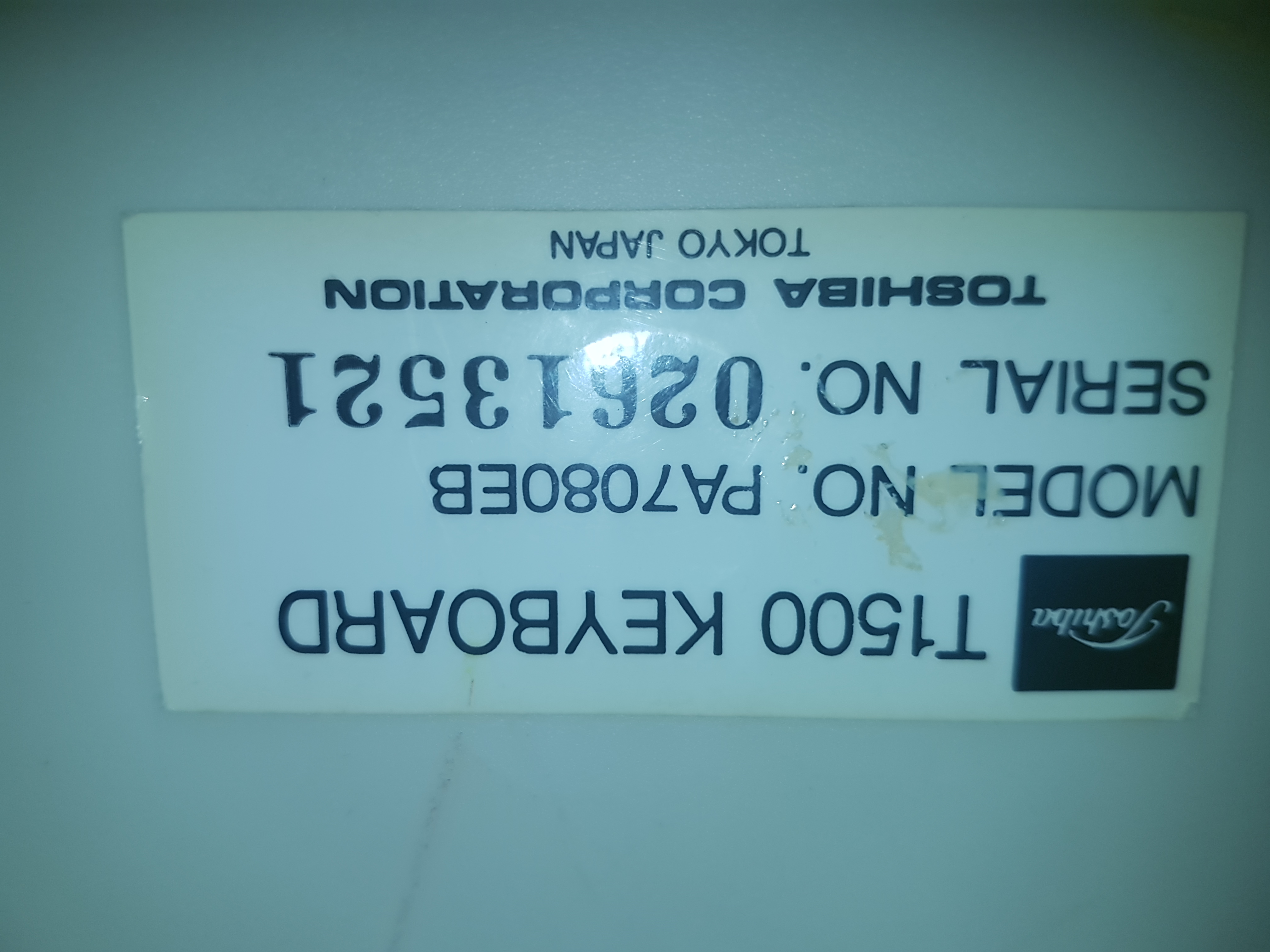

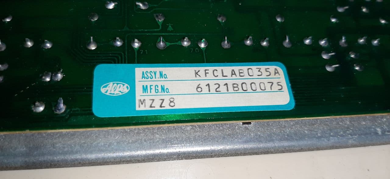

This keyboard was manufactured by Alps Electric and this is a great find! There is very little documentation on Toshiba Personal Computers.
If you have any more information about the system that this came from or more pictures of the keyboard's inside that would be amazing.

Ask and you shall receive!TheInverseKey wrote: 14 Dec 2021, 16:35 This keyboard was manufactured by Alps Electric and this is a great find! There is very little documentation on Toshiba Personal Computers.
Baffled how I didn't notice the Alps Electric logo sooner btw, silly me!

I'm under the impression that pretty much all old Toshiba keyboards (including their laptops) were Alps made. I haven't actually come across a Toshiba with Alps in it yet that wasn't made by Alps.

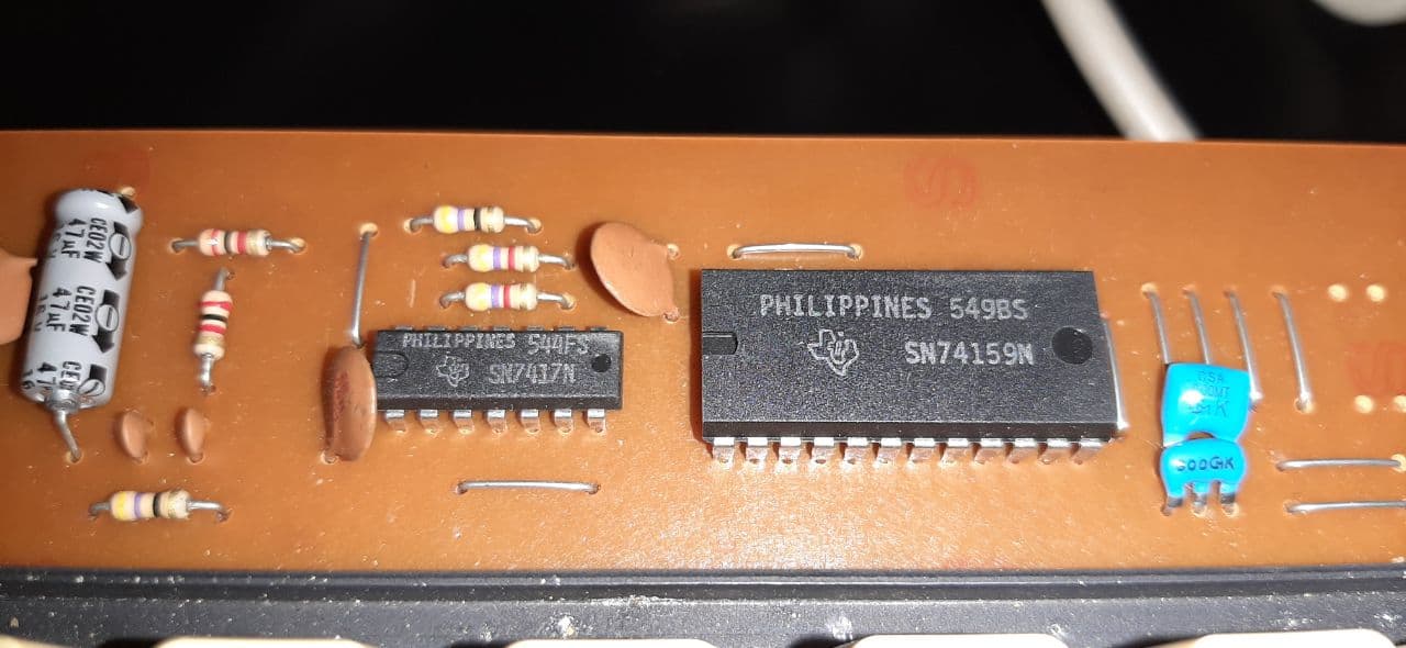

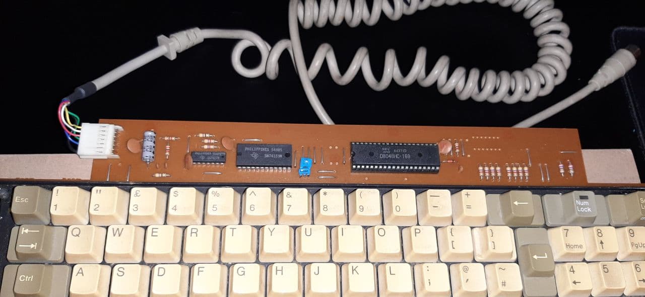

Another necro; did anyone of you succeed? I recently got a T1500 and soarer's converter on its bare bones pretty much does nothingjejex wrote: 02 Mar 2022, 23:43 necro, but did you succeed in the end? seems like a great boards, waiting for updates and good luck!
edit: I'll investigate myself, I have some ideas
edit: the ideas:

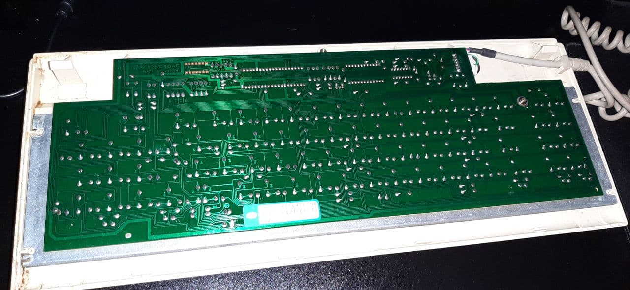

I traced around the board:
the CPU of the keyboard has to be resettet from the PC. I think the unpopulated IC was meant to do this, but apparently Toshiba was betting on PCs doing tht job.
Since Soarer's converted has reset capacities I'll test if that signal manages to start the cpu. If not I'll try to find a drop in IC for the unpopulated space. If I can't find one I'll propably fashion a small drop in board with an uC.

From pics the T1500 keyboard seems to use XT reset line. You need to have reset line on your converter to initialize the keyboard, probably.jensma wrote: 14 May 2024, 15:46Another necro; did anyone of you succeed? I recently got a T1500 and soarer's converter on its bare bones pretty much does nothingjejex wrote: 02 Mar 2022, 23:43 necro, but did you succeed in the end? seems like a great boards, waiting for updates and good luck!

hasu wrote: 15 May 2024, 08:27From pics the T1500 keyboard seems to use XT reset line. You need to have reset line on your converter to initialize the keyboard, probably.jensma wrote: 14 May 2024, 15:46Another necro; did anyone of you succeed? I recently got a T1500 and soarer's converter on its bare bones pretty much does nothingjejex wrote: 02 Mar 2022, 23:43 necro, but did you succeed in the end? seems like a great boards, waiting for updates and good luck!
edit: I'll investigate myself, I have some ideas![]()
Yeah, I'll try that when I'm home this evening.
The unpopulated party are a pretty common reset signal generator, C1 should determine the pulse length. No idea about the IC though. I thought about a 556, but I'm not sure about it. A 7414 was my second guess, but that's nonsense.
update: I created the reset signal with an arduino, working fine. I'll fashion something in the next days and document it.

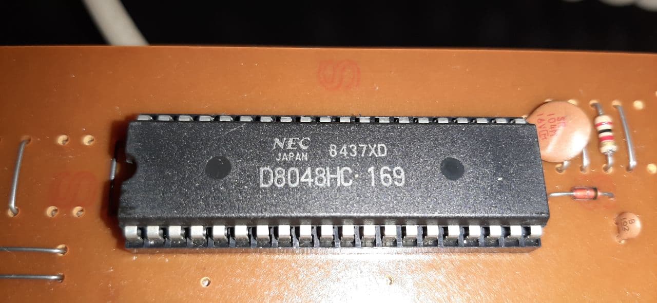

Heya,
I fiddled around with some cpu watchdogs, but their pinout is just to wild. It kinda looks like a rat's nest if you solder them to the pcb. So I opted for an uC in the end.
I used an attiny45. I started at some nanoseconds for the reset delay, but 1ms was the sweet spot in the end. That's the code:
Note that if anyone wants to replicate this:
To archieve a nice drop in replacement you need to disable the reset for the attiny itself. If you disable it you only have to reroute the GND to pin 4. And you have to change the code accordingly.
Buuut if you disable it you can't program the attiny anymore. So if you're anxious, just bend the leg outwards of the socket. Or snip it. In that case you have to route physical pin 5 of the attiny to solder pad #1 on the pcb. I did it with a white wire pictured above.
unsigned long delayTime = 1; // #reset delay
void setup() {
pinMode(0, OUTPUT); // 0 = physical pin5 on attiny
digitalWrite(0, LOW);
delay(delayTime);
digitalWrite(0, HIGH);
delay(delayTime);
void loop() {
