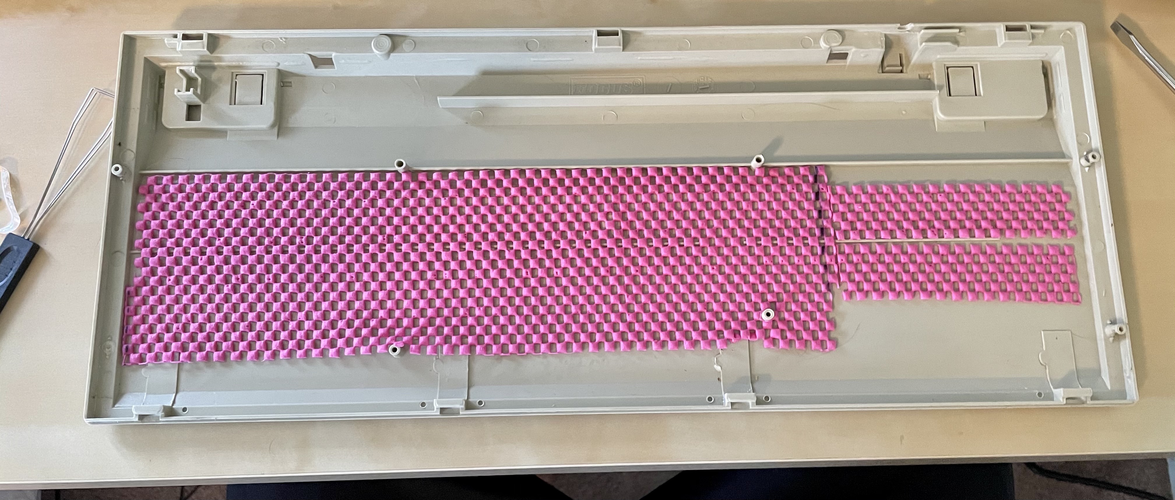

I’ve also noticed this and I think it has to do with the vibration of the plate and PCB. On Focus keyboards putting a non conductive pad under the PCB helps and tightening up the case. I’ve never tried on an M0116 but it couldn’t hurt to try. Below is a pic of a foam pad used on my Focus keyboard. It presses against the PCB and eliminates almost all of the reverberation.

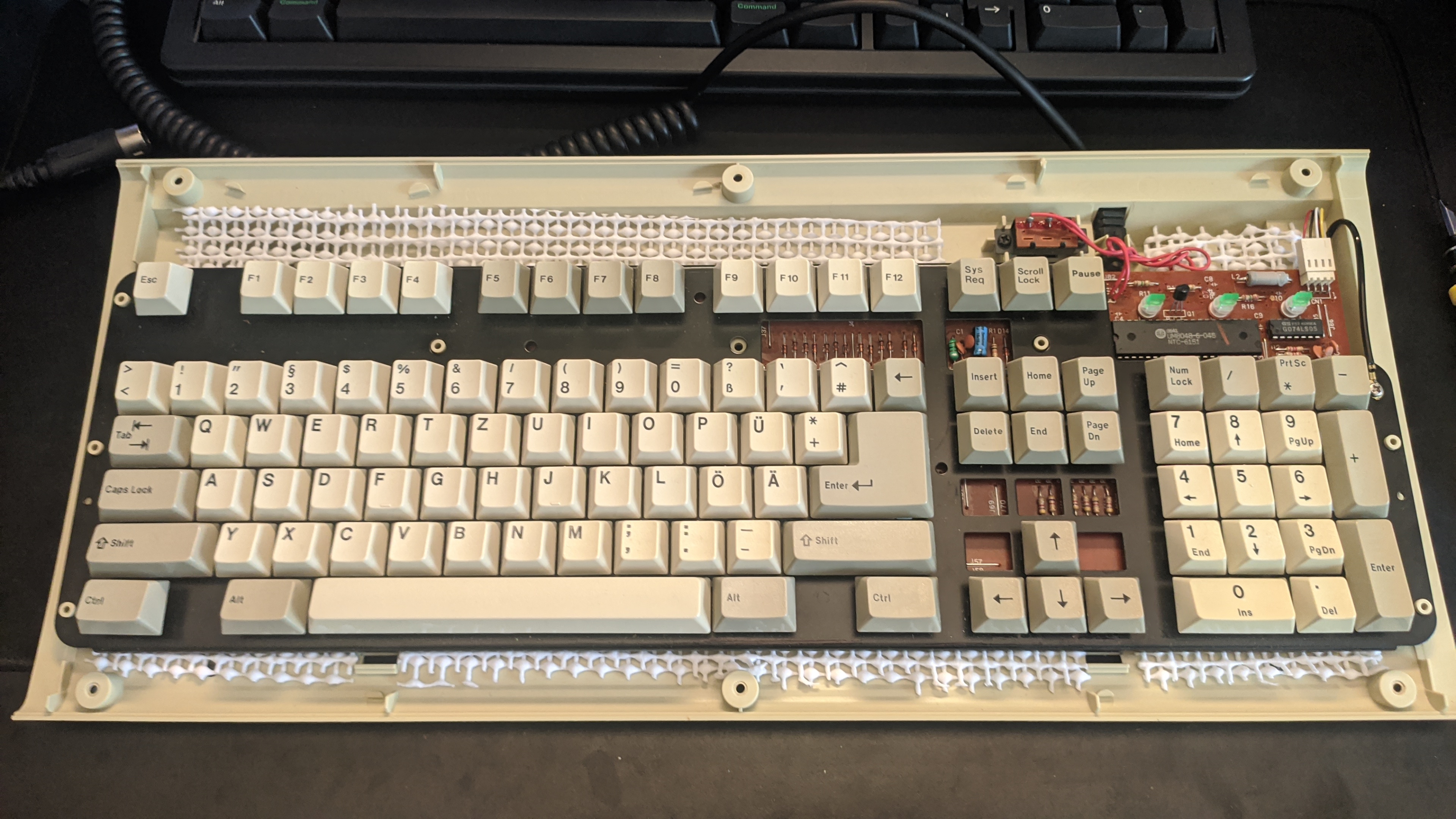

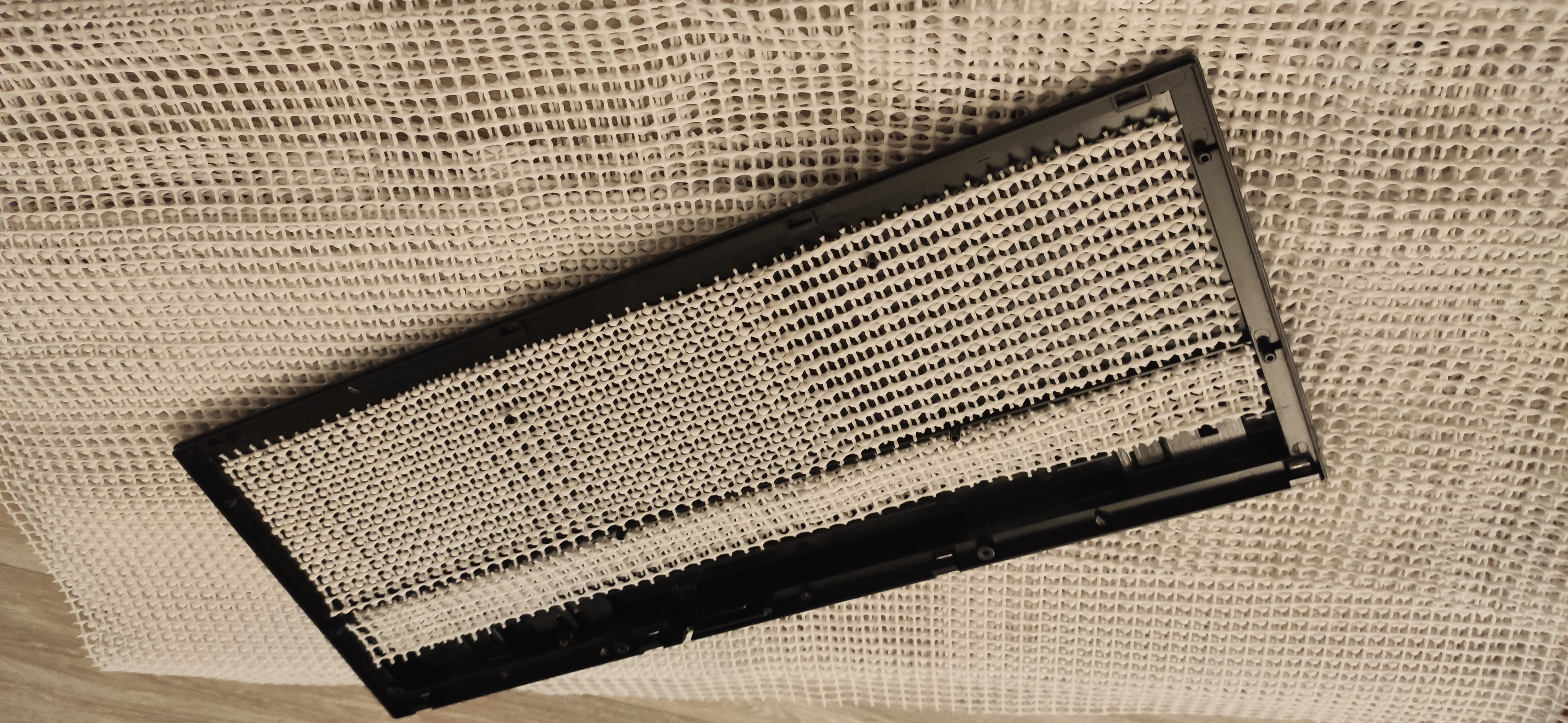

yep, that works especially well with roomy boards. i tried with m0116 too but it didnt had such impact as the case is pretty dense already and there is not so much space. worth a try anyway.thefarside wrote: 31 Aug 2022, 16:23 I’ve also noticed this and I think it has to do with the vibration of the plate and PCB. On Focus keyboards putting a non conductive pad under the PCB helps and tightening up the case. I’ve never tried on an M0116 but it couldn’t hurt to try. Below is a pic of a foam pad used on my Focus keyboard. It presses against the PCB and eliminates almost all of the reverberation.
