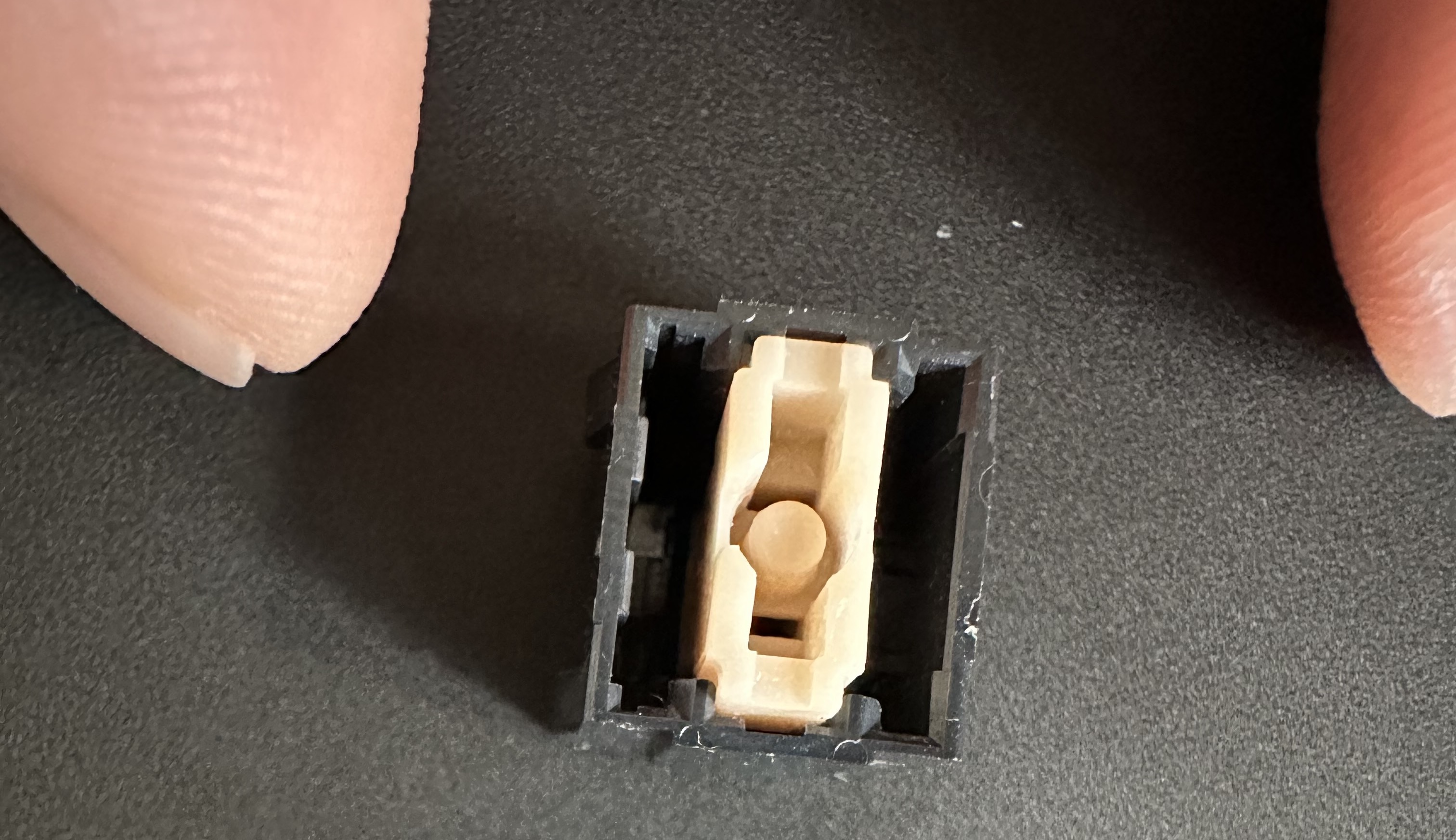

For SKCC we have my Creammaster:
This isn't the final pic of it, I was just messing around with caps, but it has visible switches so that's the pic I'm using. Ultimately the Creammaster just looks like a Pingmaster outwardly, the only difference is that it has SKCC cream so not having a pic of it with the normal caps is fine, yall know what a pingmaster looks like. This one is more of an honorable mention since I didn't wet lube the switches but I feel like it's reasonable to include it in this roundup because it's the only pre-din switch I've tried wax on and IDK where else I would really include it since I don't feel it's worth it's own post.
Results: SKCC's slider geometry has a lof of concave right angles for wax to build up in and they seem to be the most sensitive to overwaxing. I waxed some tall SKCC for someone on reddit once and I got way too much on the first go but even after removing a lot of the wax the customer reported that the switches felt like shit for the first week but by the end of that week they were feeling way better. On this board I seemed to only barely over wax them and it did not take quite so long to break in. SKCC good.
