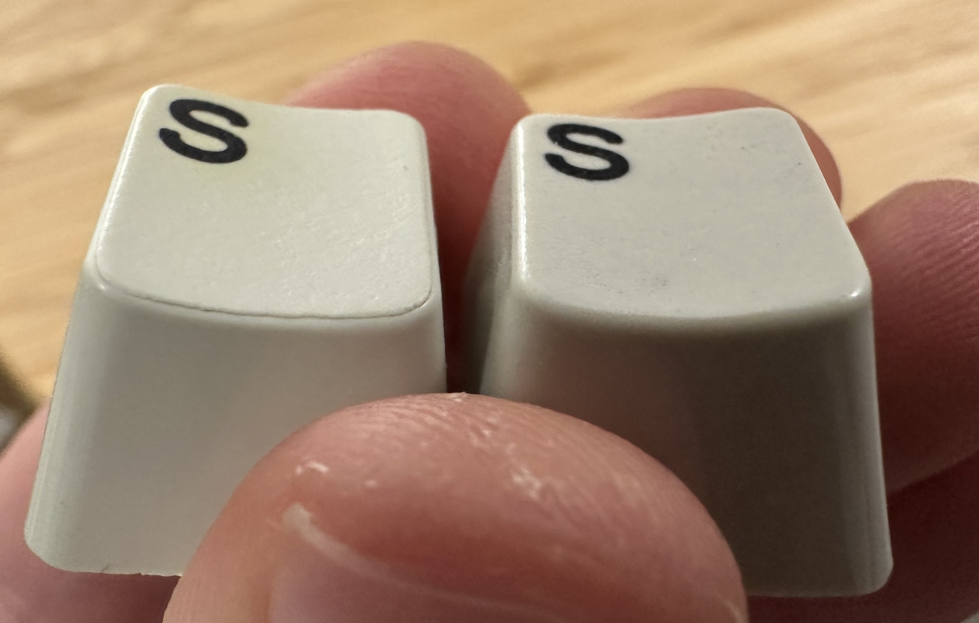

Hi deskthority, I posted on the r/modelf subreddit yesterday about a "mint" condition Model F XT I recently acquired, and it was suggested to me that I ask in here instead. The keyboard looks stellar, except the keycaps are a bit weird.
The one on the left is from this “mint” condition, and the one the right is from another Model F XT (which was not otherwise in as nice condition). It seems like there is a layer of film? Add to this that there is a bit of yellow coloring around the letters of each letter on the keys…
Are these genuine Model F XT keycaps or is there something wrong here? It seems strange…

They’re not something I’ve seen before, and I’ve had a half dozen Model F keyboards, several of them XTs. That’s not IBM’s style on those keyboards. They came with tasty, single piece, high quality, heavily inked dyesubs as standard. XT key caps are some of the best, far better than what they put on Model M.
The one on the left looks like some kind of mod.

At first I thought maybe it was some weird artifact from the manufacturing process. Like maybe there was some batch of keys that had a weird lip on them. But the more I look, the more I'm inclined to agree that they're stickers and you should attempt to peel at least one off for science.
For what it's worth, the nicer keys from my F122 (admittedly different since it used two piece caps) have a more clearly defined line between the end of the pebbling texture and the start of the smooth texture than on your worse condition F. You'll only know if it's a weird manufacturing glitch if you attempt a peel though.

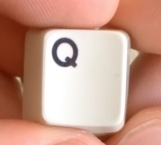

Which, to Muirium's credit, is indeed a keyboard made for the weird Øuropæäns!SicloudEN wrote: 26 Oct 2022, 14:58 Thank you all for your responses. I also just clicked on Chyrosran's review of the Model F XT from 2016, and despite the video being in 720p resolution it sure looks like there is a sticker on his as well.

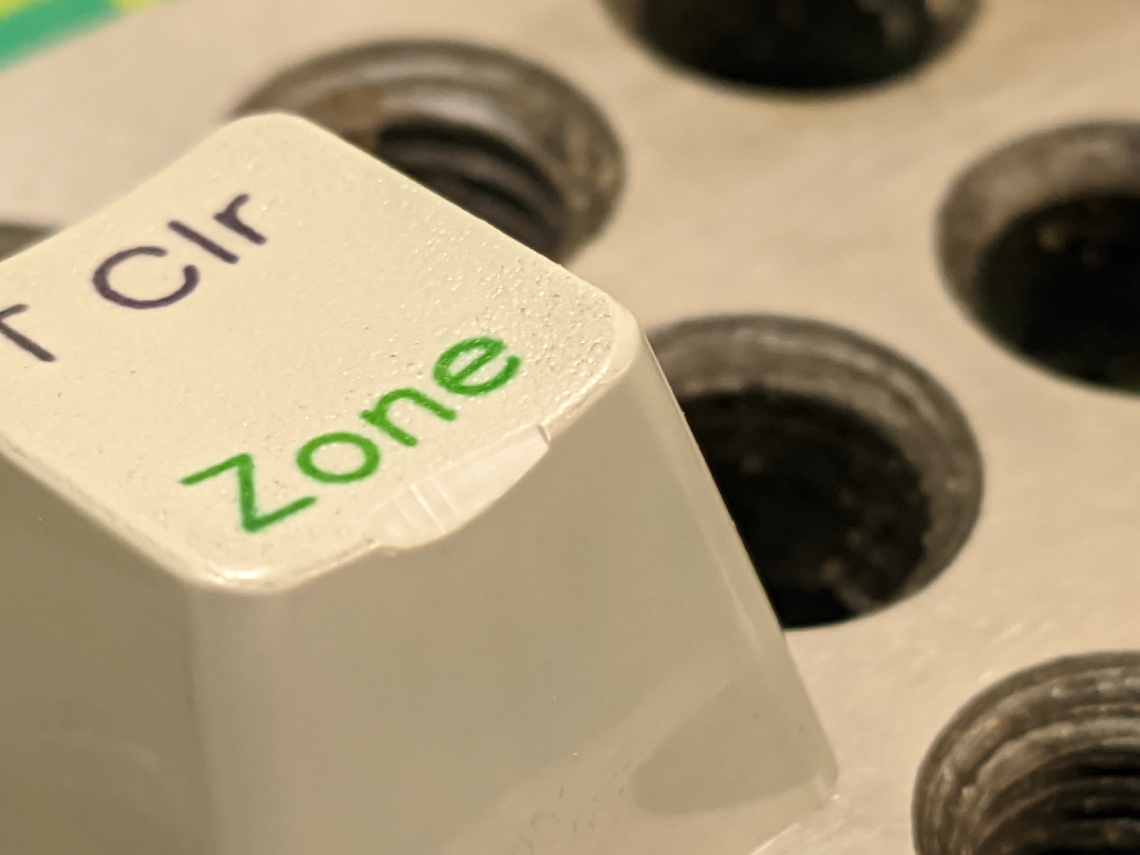

I'm almost certain that those are not stickers. It would make sense from a tooling standpoint if the molds are multi-piece with the top part being separate to allow for media blasting (texture), different maintenance intervals, homing bumps, etc. I'd bet that the tooling fitment just had some variation over the years which causes a parting line on some caps but not others.
Here's a cap off a Wheelwriter with a similar line. I took a sliver out of it with a knife and it's indeed uniform plastic all the way through, no sticker.

This is exactly what I'd first suspected! Given how much more OP's look like stickers, I say that there's still a chance of that being the case and the only way we'll know for sure is if they try to peel it off.jsheradin wrote: 26 Oct 2022, 15:34 I'm almost certain that those are not stickers. It would make sense from a tooling standpoint if the molds are multi-piece with the top part being separate to allow for media blasting (texture), different maintenance intervals, homing bumps, etc. I'd bet that the tooling fitment just had some variation over the years which causes a parting line on some caps but not others.
They don't need to cut a slab out of it like you did to the wheel writer though. That would be a crying shame if it really were a mint condition IBM F XT.
