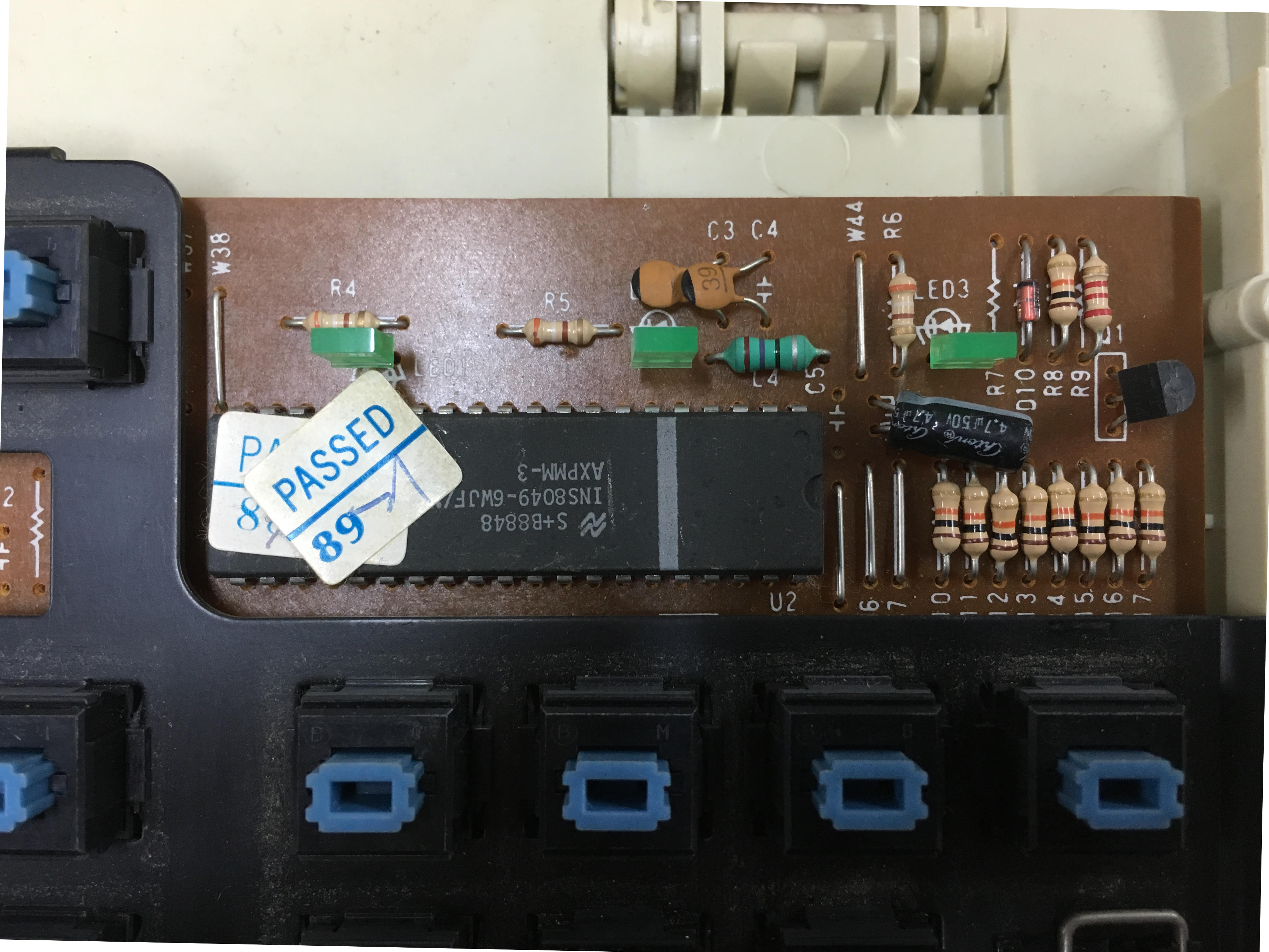

The keyboard's controller does seem the likely culprit. I'd try testing it on one more AT / PS2 host computer before being sure about it, but you're very likely right.
Going by the wiki, does your PCB look like this? Have I got the right keyboard?
That controller runs on the (ubiquitous) Intel MCS-48 chip. (You won't always see an Intel logo, as other manufacturers second sourced it.) They were an affordable microcontroller back in the day: programmed during manufacture but unalterable for us mere users. They have the same / similar* footprint to truly programmable controllers like the Teensy++. They are indeed removable with determination. If you put something else in there, you can do advanced stuff like QMK or even Bluetooth.
But before getting deep and hacky, see that electrolytic capacitor nestled between the resistors? Is yours leaking, perchance? Try measuring its capacitance. If it's out of spec, the controller may not be to blame and might just jump back to life once the cap's replaced. I'd start with that.
