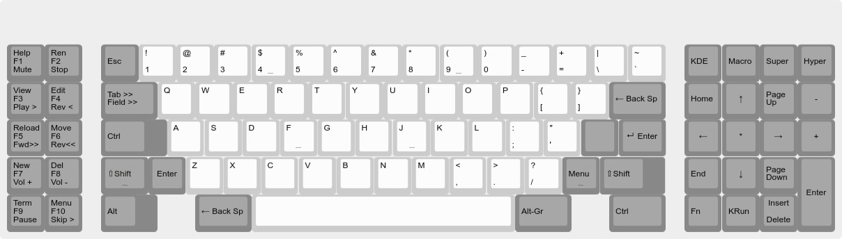

I've gone beyond that; I'm using a 1.25u Enter key, which let me recover two useable key barrels. And I split both Shift keys and the Insert key, too. I don't have any flippers for them in my daily-driver keyboard yet, though.
The left "M alt" key will be an extra Backspace, Colemak-style. The right will be Alt-Gr. I already have the keycaps for that, and an M spacebar, and now that the spare keyboard is apart, that should happen Real Soon Now.
Except for the M alt keys, it looks pretty much like the picture below.
- PC-AT with split Enter and split shifts.jpg (61.36 KiB) Viewed 18539 times
