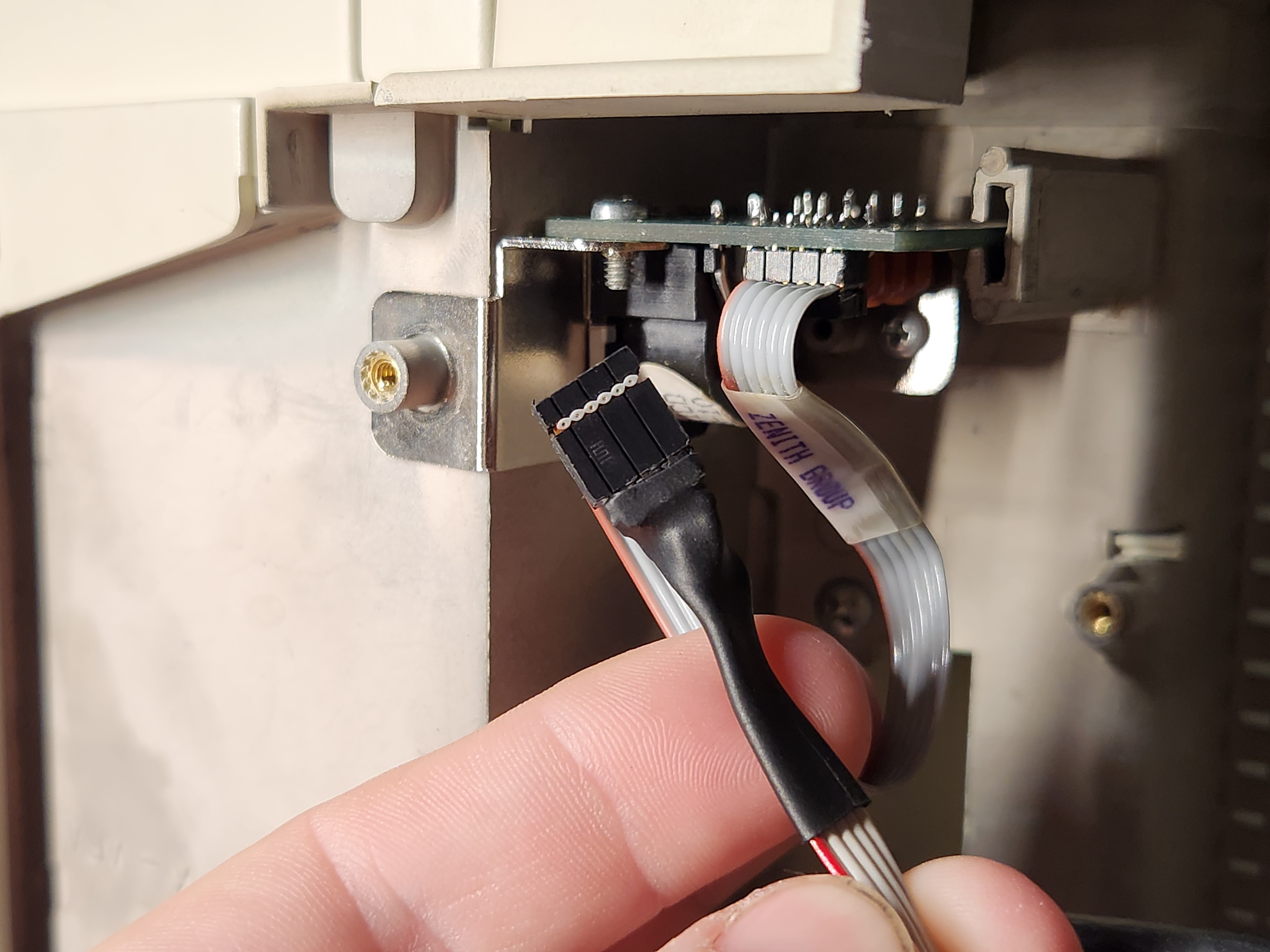

I'm working on a retrofit project involving a Zenith Turbosport 386. I set myself a limitation that I couldn't do anything to it that couldn't be undone in the future. Part of that has been adapting it's XT 5 pin DIN keyboard to USB. But I also wanted to be able to remap keys because some of the keys I use a lot are not easily accessible. For instance, F12 is accessed via Fn+F2. I also wanted to be able to add macros and map a windows key. I stumble across this forum and the excellent Soarer's firmware. Since there were turnkey versions of this on eBay, I decided to go that route and bought a 5 pin DIN to USB cable that had the microcontroller integrated and the firmware already flashed.
Unfortunately, that proved to be unreliable. It seemed that most times that I plugged it in, it would detect my keyboard incorrectly and many of the keys would be mapped to weird keys. I'd have to unplug and replug in the keyboard many times to get all the keys to finally work. Not ideal.

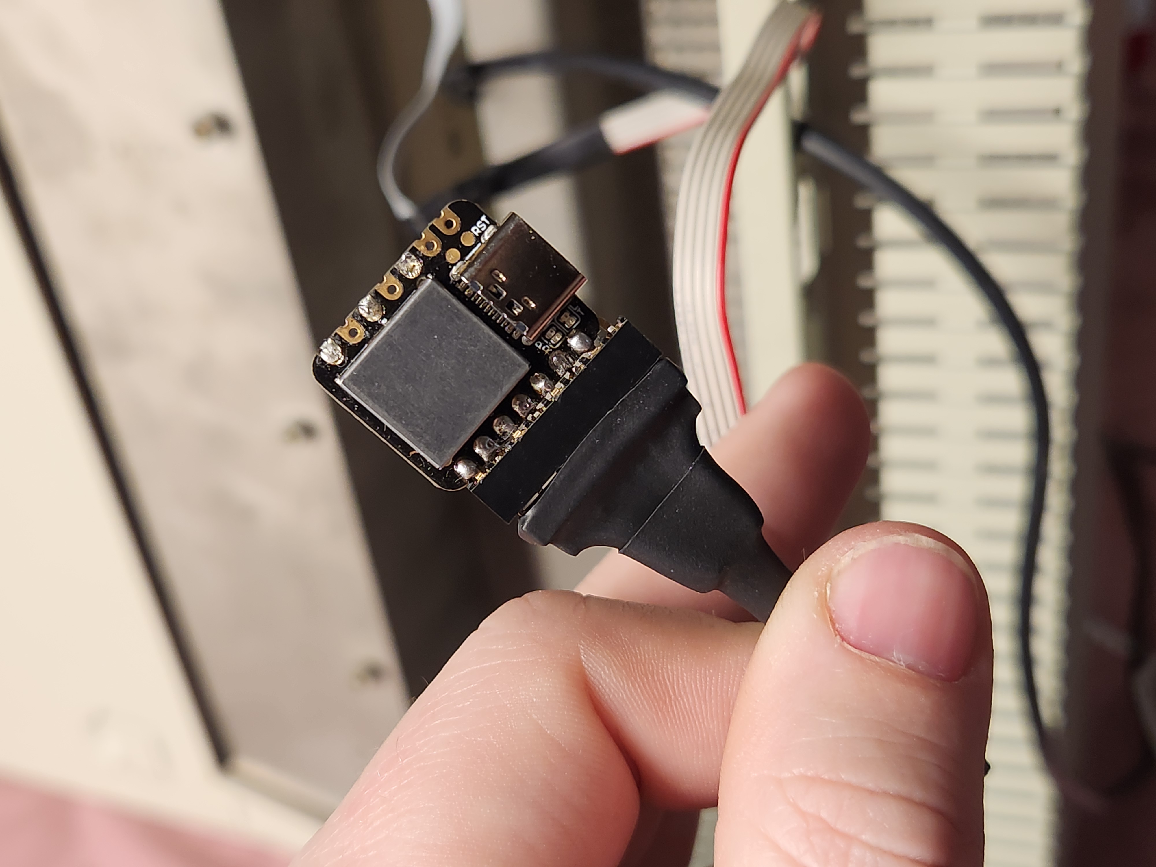

Long story slightly less long, I decided to roll my own. With a Seeed Studio Xiao and copious amounts of googling and trial and error, I have a functional keyboard that works correctly every time it's plugged in. I still have some small things to overcome, but I'm typing this on it now. It works well. That brings us to my actual question:

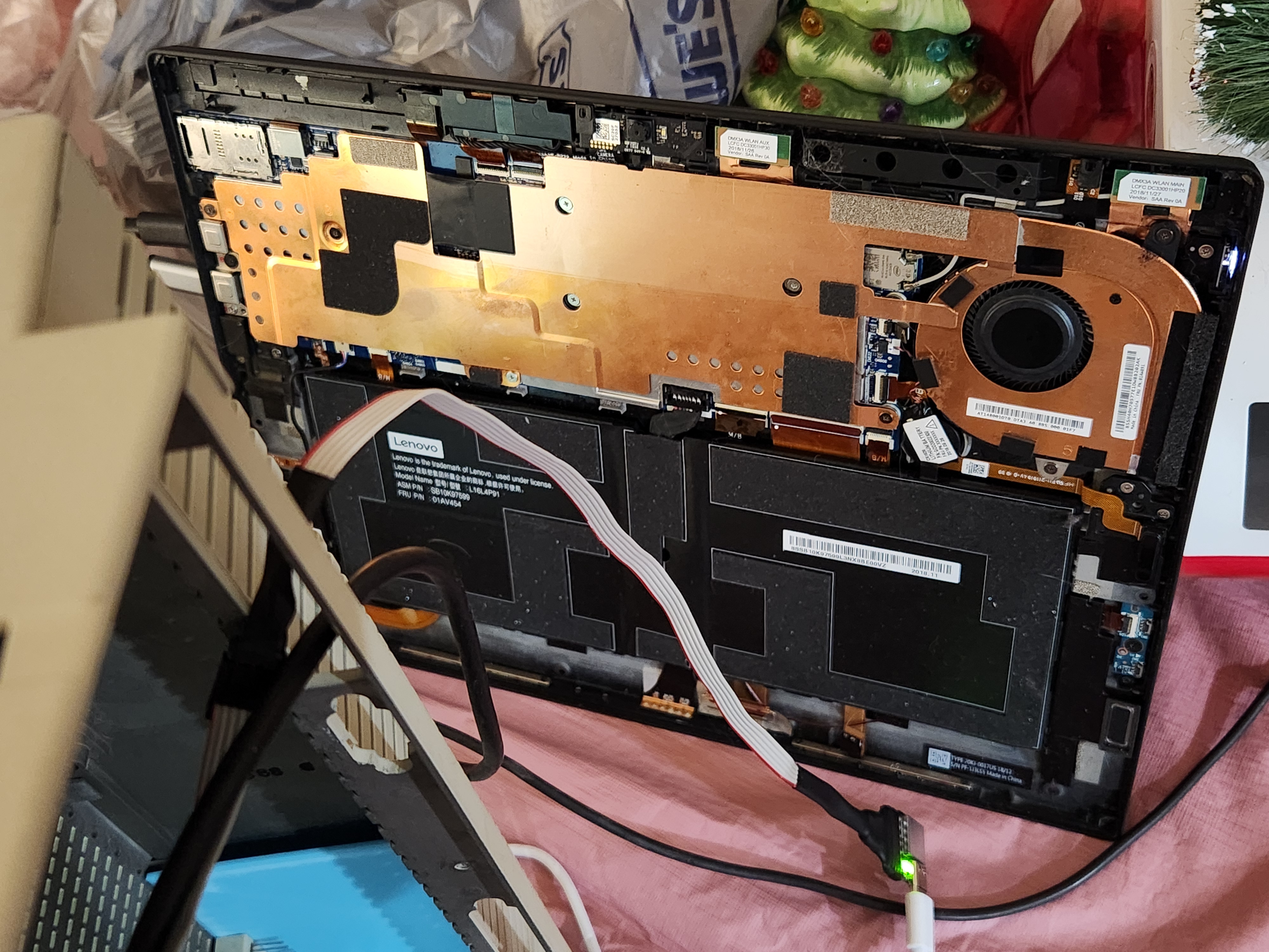

If nobody here knows, I may see if I can hook something up to the original hardware and see what it sends for the power on LED. That's all I'll be able to check though. I'm retrofitting this computer because I was unable to get the original hardware to boot. Even after purchasing 3 different units to try to troubleshoot. But it will, at least, turn on the power LED on the keyboard.

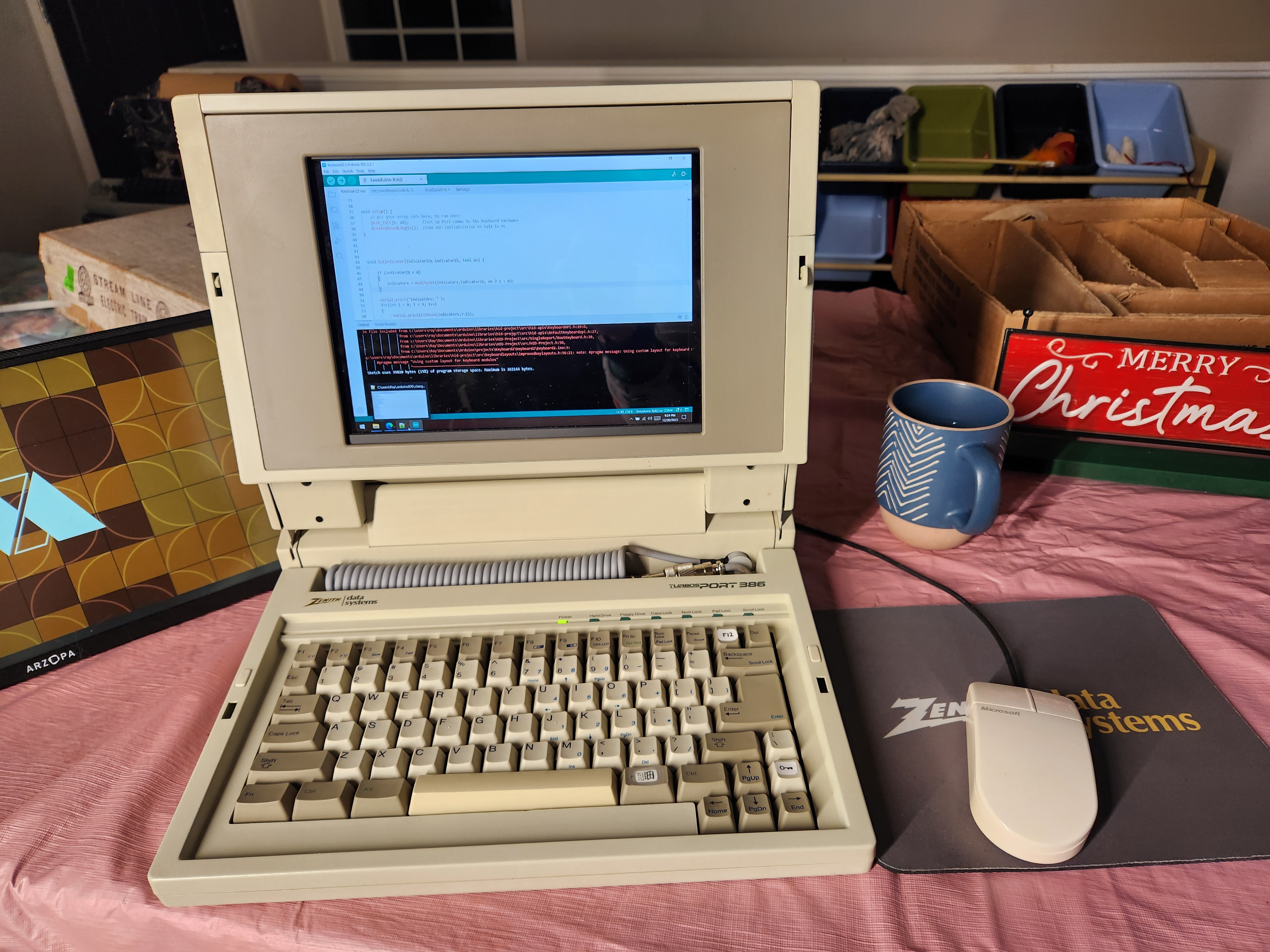

Yep! That's what I'm working on! Here's mine in it's half-finished-but-probably-never-truly-finished form:
I've been using the computer as my work computer (I'm a software developer, it's been fun) as I developed the keyboard's firmware. It's actually quite usable now. I've remapped some keys to give myself easier access to keys I use a lot. I also hard coded a couple macros. I plan to add two way serial support so I can change key mapping, macros, layers, etc. to the keyboard without getting the Arduino compiler involved. But for now, I'm really happy with it.

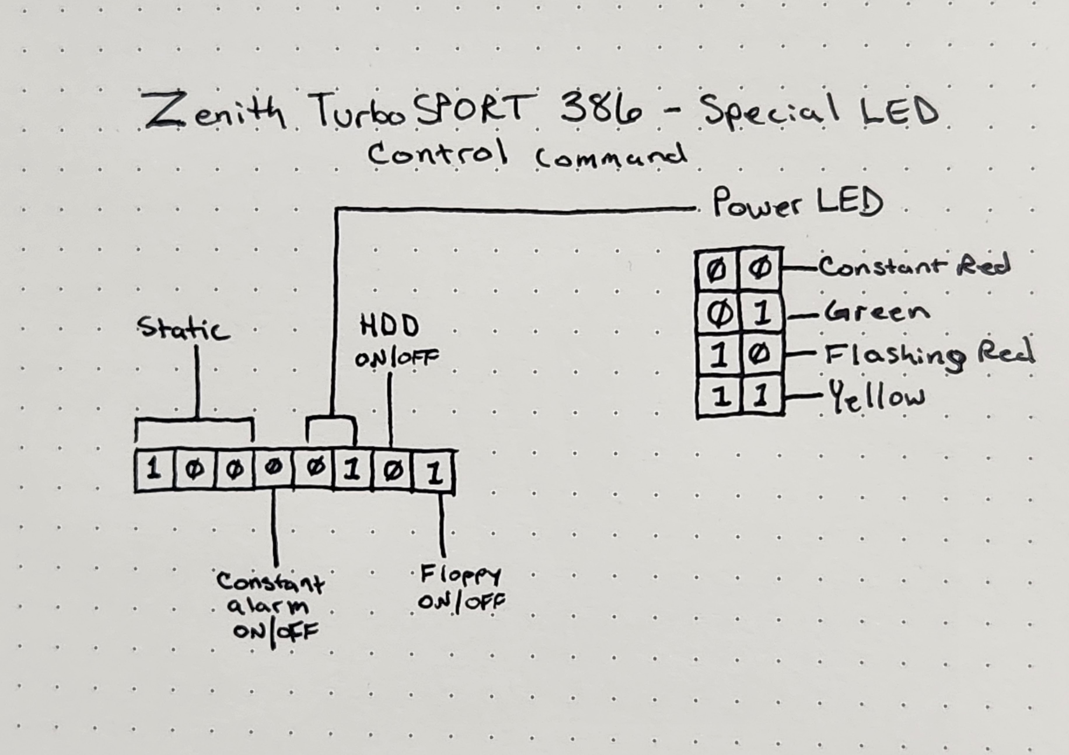

Thank you so much for the information. I hadn't come across that page yet. I did manage to find out how to control the other LEDs though! I decided to brute force it last night. I figured it was probably using the same two byte method that the other LEDs were, just with a different begging byte. All of the documented PS/2 commands are up at the upper limit of a byte, so I figured I'd need to head downward. So I programmed the caps lock key to send the two byte message, then subtract one from the first byte so on the next keypress, it could try again. I also had it write a message out to the serial port that said what number it was on. I kept the second byte static sending a "1" figuring it probably followed the same pattern as the regular LEDS.
At 0x9F (159 in decimal) I finally saw results. All of the "special" LEDS lit. Unexpectedly, I also got an alarm! lol. I wrote down the number and continued down to see if things changed. As I did, various LEDs went out and the power LED changed from yellow to flashing red, then to green, and finally to solid red. All the while, the alarm sounded.
I continued farther to see if anything else would happen. I didn't really expect it would. But I was wrong. As I reached 0x8F (143), I started the cycle of LEDs over. Just as before, they all lit, with the power light yellow. This time, however, the alarm was blissfully silent. That was, until I got to flashing red. This time though, it sounded the alarm momentarily and with a few second gap in between. Much to my delight. I went through the full cycle. All the way to 0x80 (128). Once I went below that, no changes happened. Importantly though, the power LED remained on it's last set value (constant red, in this case). There doesn't seem to be a way to turn off the power LED once it's turned on. You have to reset the keyboard.
I don't know if anyone cares, but I did figure out how the actual command works. It's not a two byte command like the regular LEDs. It's a single byte. The diagram below shows how it works:
The first 3 bits are 100 and are static. Following those are 1 bit that indicates if the constant alarm should sound. 1 for yes, 0 for no. After that are two bits that indicate the color that the power LED should be. In my example, it's set to 01, which would make the LED green. The diagram shows the values for the other colors. Following that is a single bit indicating if the HDD LED should be lit, and then finally, a bit that determines if the Floppy Drive LED should be lit.

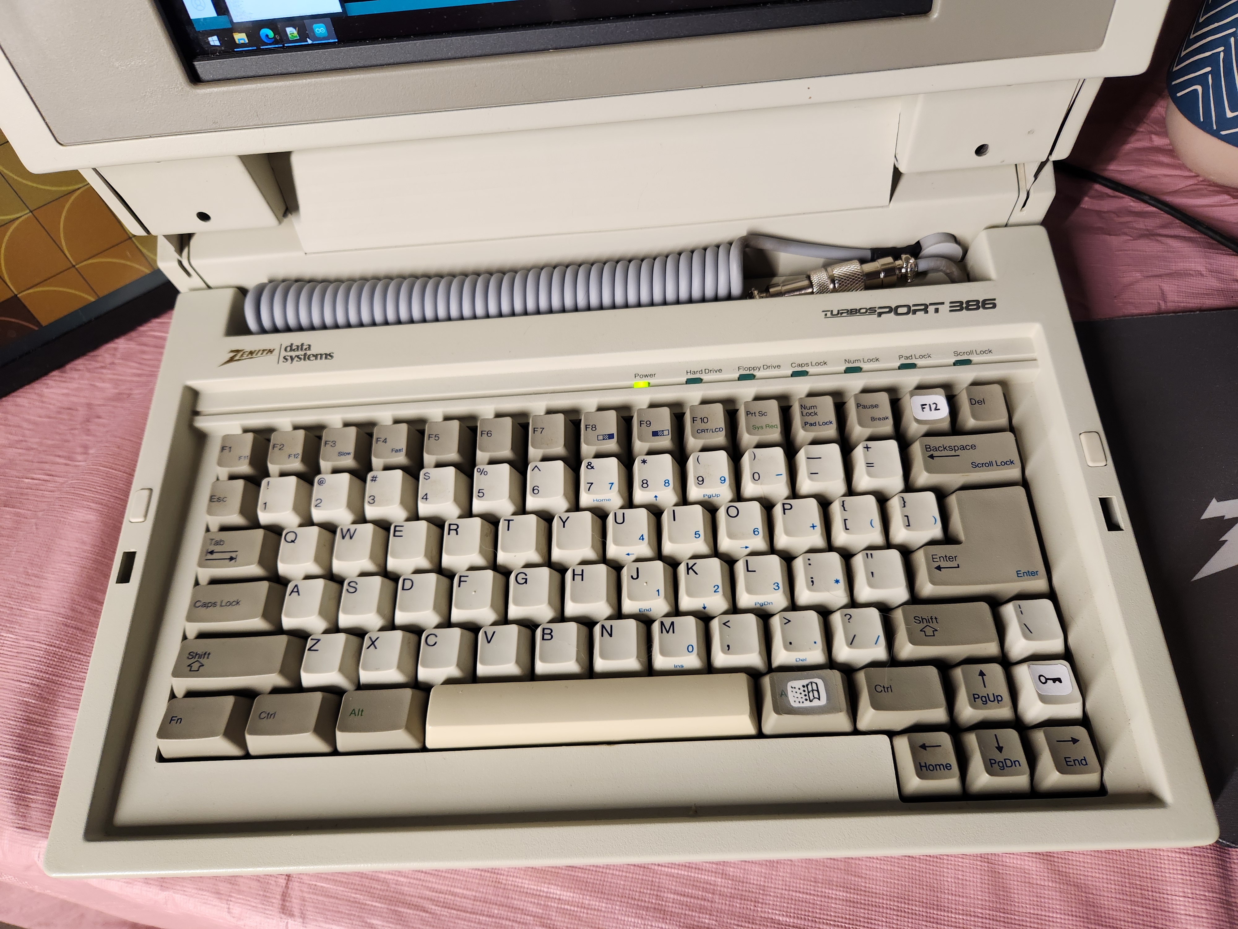

I was able to control the LEDs and alarm as I pleased using this single byte command. I'll also note that the keyboard does not respond with 0xFA (ACK) when this command is sent. So there you go. It's working! You can see it in my earlier post
The power light is set to come on once the keyboard is initialized now.
