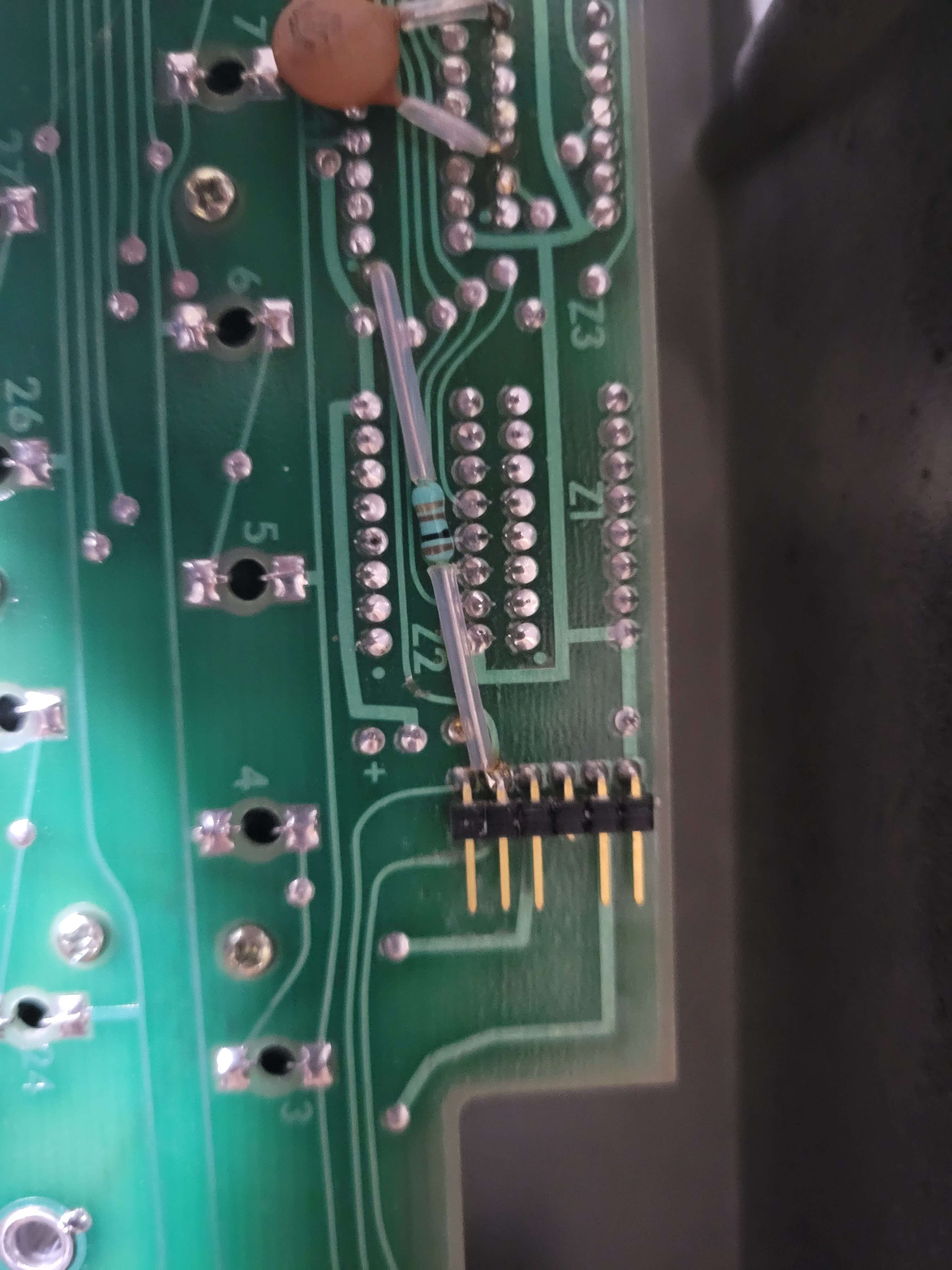

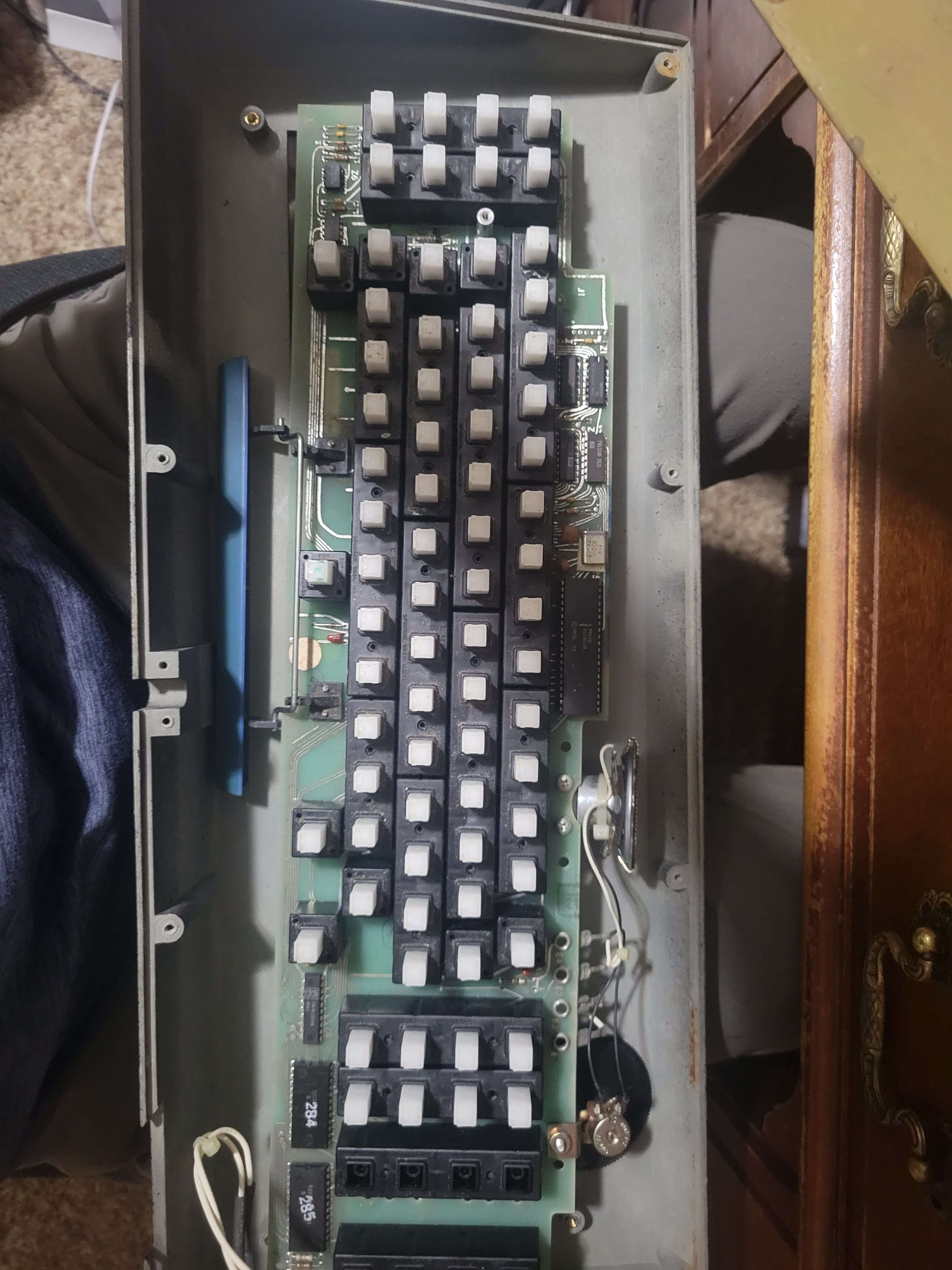

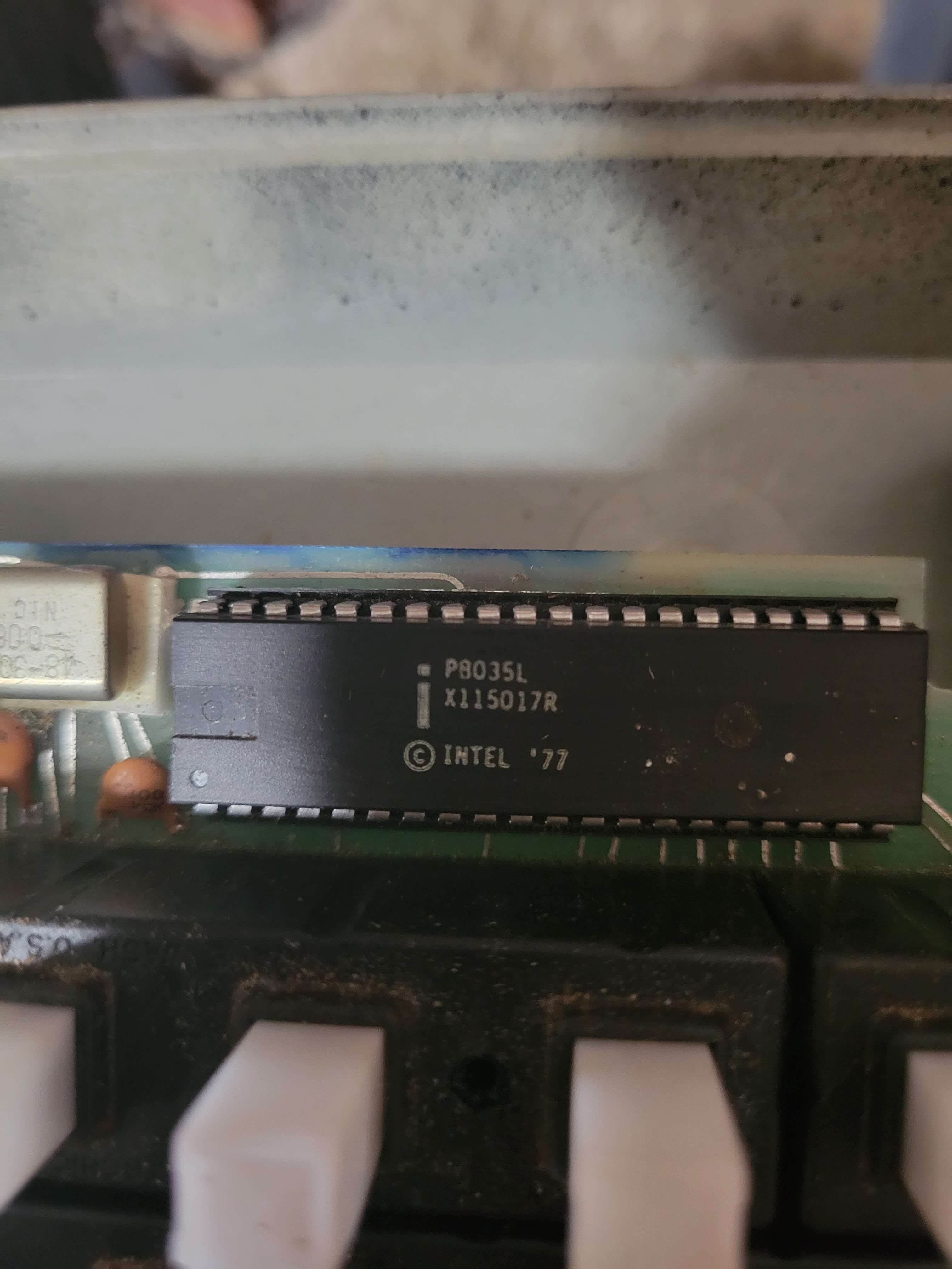

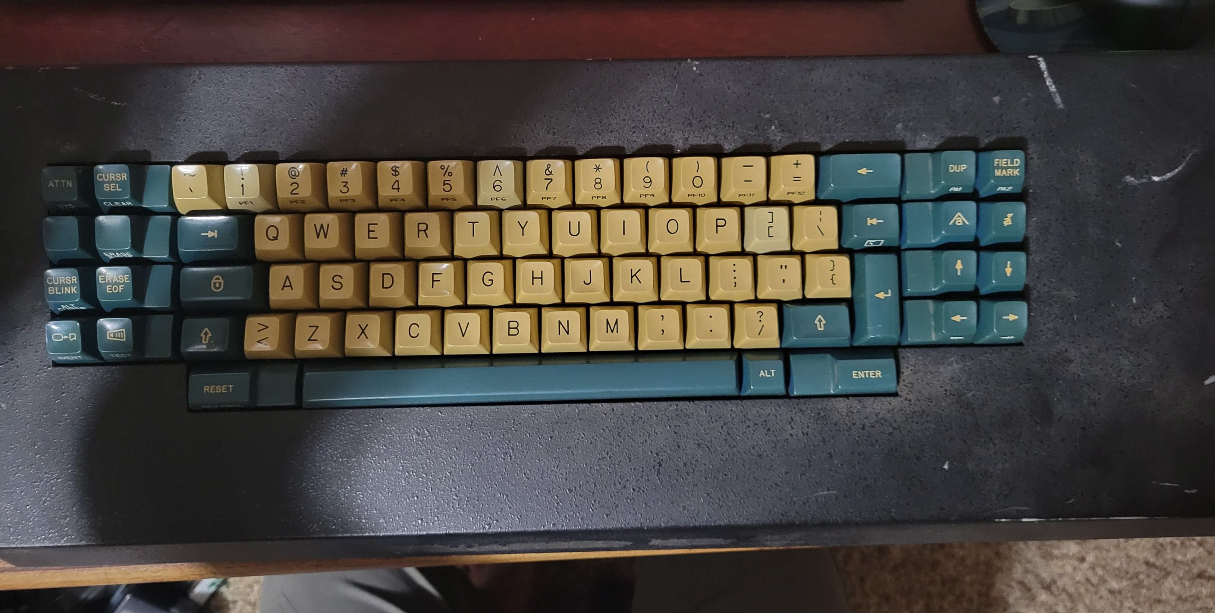

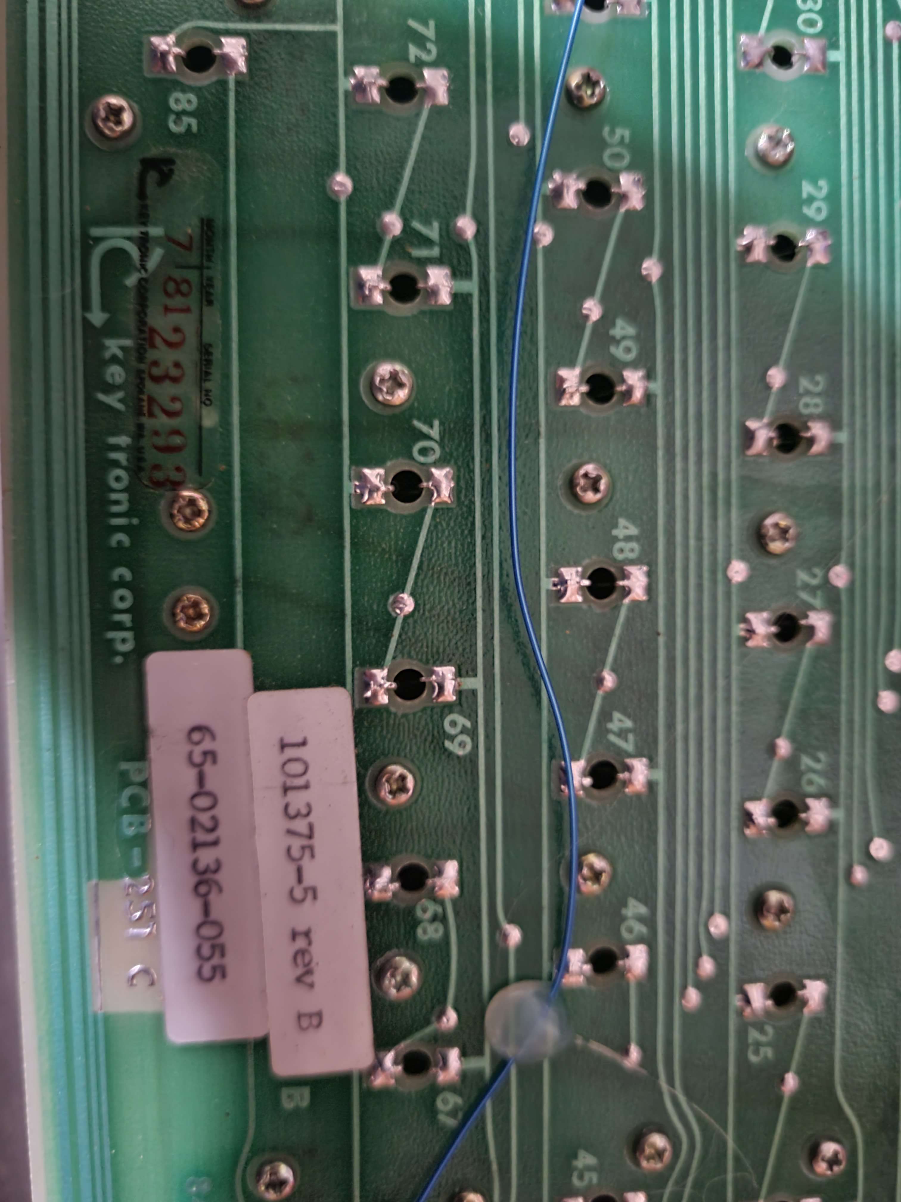

Hello, a while ago I bot a few old keyboards, one of them I can't find much on and it's got me in a bit of a rut. It's got an ibm 3278 layout and a keytronic pcb, but there's no identification anywhere on the thing. (I'll include the serial and pcb #'s in the pictures). The inside of the case and the pcb have spots for an extra few rows of keys, so I'm assuming it's a custom board? From looking around online I believe that it's got magnetic reed switches, but I'm not 100% confident on that. The microcontroller is an Intel P8035L. It also has a key-hole/lock on the side which connects to a speaker&knob, probably to control keypress sounds.

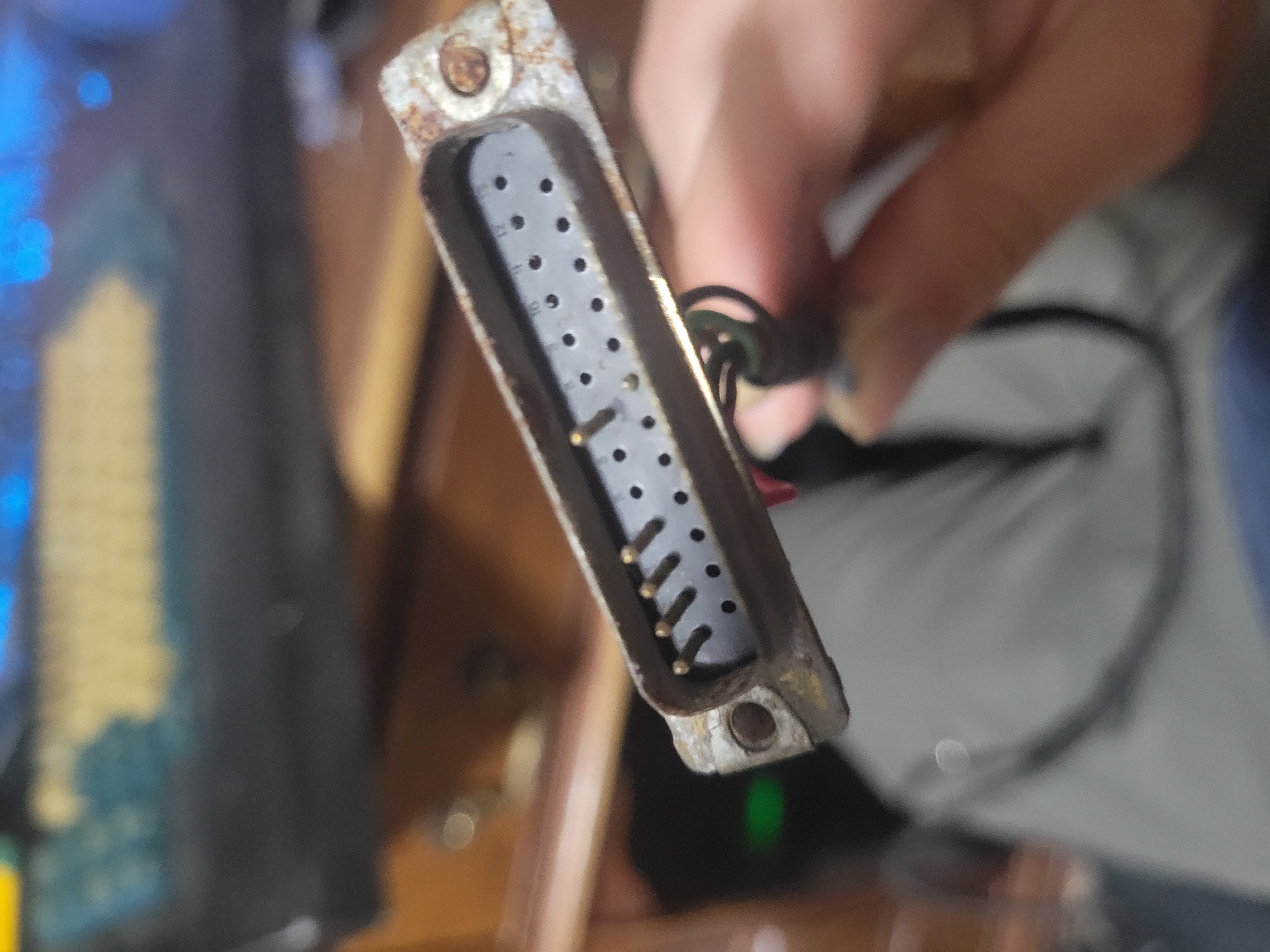

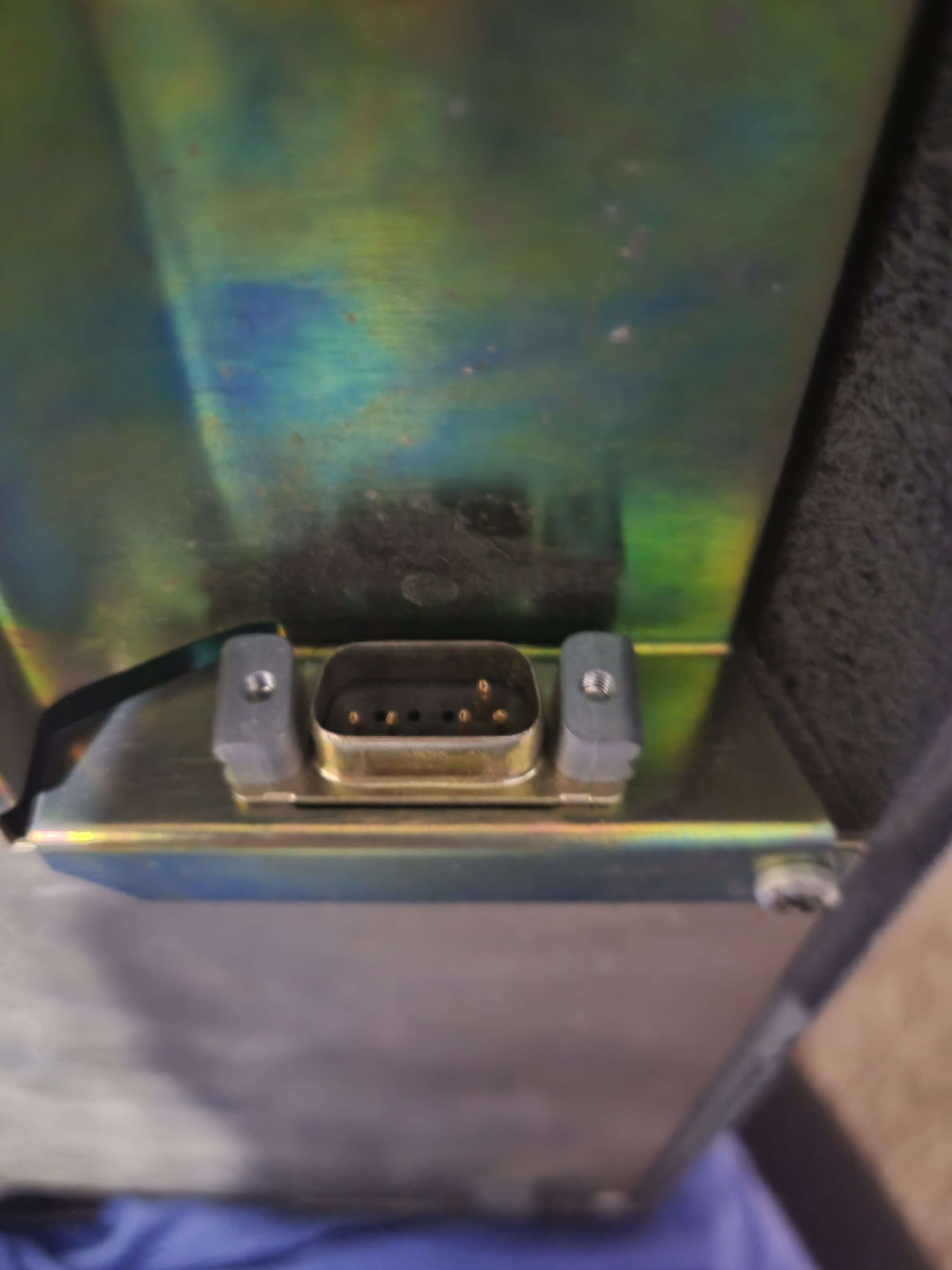

I've mapped the output to the best of my ability, it has a male db9 port with only 5 pins. Can anyone help let me know what my next steps should be in trying to make an adapter for this thing? I've worked with some old posts and made a USB adapter for one of my other old word processor boards but that was just someone else's work so I have no idea where to start.- Attachments

viewtopic.php?t=17523 might help.
My opinion is that it's most probably the magnetic reed version.
I swore off tracing keyboard matrices when they started giving me headaches. Someone on this forum should offer matrix tracing service at a reasonable price.

Worst case, you could cut the traces and hardwire your own matrix. There are lots of DIY keyboards out there with a forest of wires inside.

When I get some free time I'll definitely try to reach out to the OP of that post. I'm up for learning how to trace the matrix myself eventually, I just don't even know where to start at the moment.

I'm tempted to just do that, looks-wise it seems fixable though so I'd rather not cut anything if I don't need to. I got another enormous keyboard in the lot that was for a CPT 8000 series word processor, made a converter for it but a lot of the switches are rusted out so I'll probably put new guts in that one before I do any big changes to this keyboard.AndyJ wrote: 12 Jun 2024, 14:37 Worst case, you could cut the traces and hardwire your own matrix. There are lots of DIY keyboards out there with a forest of wires inside.
