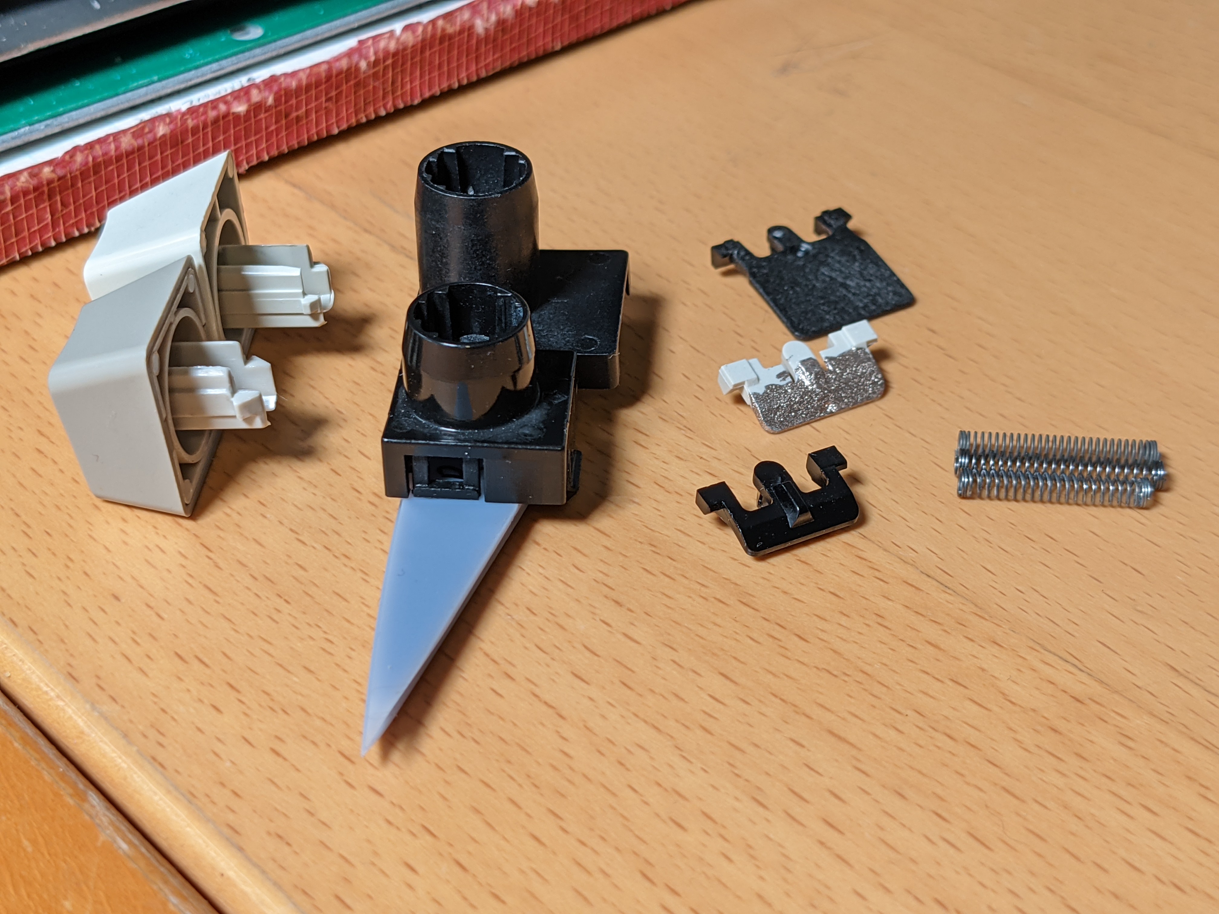

Probably terrible idea: One of the things that makes the Model F hard to deal with on a hobbyist basis is the curved aspects-- a curved PCB, the curved sandwich plate, a case to accomodate the curve, getting all the tolerances right, dealing with foam to pack it all together. Without fancy tools, that means going to a pro manufacturer, high MOQs and startup costs, and iteration is very expensive.
I wonder if it might be possible to design individual barrel-spring-flipper assemblies in plastic "cages" that could snap into slots in a flat PCB. Think of a unit looking like one of these individual-switch module keychains (https://www.ebay.com/itm/282392918945) but with the bottom plexi removed and some little hooks added to engage the PCB.
That would make it more or less possible to design "flat" buckling spring designs that fit into essentially the same cases as common MX hobbyist projects. If you could say "dig out an old G81-3000 from the scrap pile, remove the PCB, and drop in the FMF PCB", that could make the product hundreds of dollars more accessible. Or, of course, you could have deluxe, more custom cases fabbed, but it wouldn't be anywhere near the same level of required it would be with a curved assembly.
Further riffs on the hook idea:
* Instead of a simple hook, maybe use a split circular prong-- the sort where it can be pinched slightly to fit through the hole, then spreads out to prevent back out. Think of the mount on non-screw-in MX plate mount stabilizers. The idea is to give the PCB shop the simple requirement "drill a 2mm hole" rather than the somewhat harder "drill a neat rectangular slot 1.5mm x 4mm for a hook"
* Four hooks, maybe positioned at slightly off positions on each side, would engage from all sides, but avoid having to put two drill holes right next to each other. For example

Hak Foo wrote: 06 Jan 2025, 05:25 Probably terrible idea:
Not quite! It's not even that hard to make flippers a bit smaller - but doing that will change the sound (not feel) of the keys.
Hak Foo wrote: 06 Jan 2025, 05:25a curved PCB
Curved PCB isn't actually needed - original IBM ones are curved simply because they were sandwiched between plates for 30+ years. "PCB-curving machine" was invented because somebody didn't understand shit about how IBM keyboards were made.
Hak Foo wrote: 06 Jan 2025, 05:25getting all the tolerances right
Those are pretty wide tolerances, actually.
Hak Foo wrote: 06 Jan 2025, 05:25I wonder if it might be possible to design individual barrel-spring-flipper assemblies in plastic "cages" that could snap into slots in a flat PCB.
That _is_ possible, but there's a problem: 87 keys x 65 grams is 5655 grams of force, 104 keys is 6760 grams. FR4 will buckle significantly - most noticeably between "G" and "H". So the plate needs to be steel. 1.5mm steel, to be exact - because plate-mount stabilizers expect 1.5mm plate thickness. (yes, keys will need to be MX or something else designed for a flat plate - IBM keys on a flat plate will form 19x21mm grid, see wcass's beautifully machined flat model F).
Iteration cost for laser-cut 304 steel is about $100 at ponoko (about $30/plate at 100 copies last time I checked).
Hak Foo wrote: 06 Jan 2025, 05:25If you could say "dig out an old G81-3000 from the scrap pile, remove the PCB, and drop in the FMF PCB", that could make the product hundreds of dollars more accessible.
Actually, the case can be just two plates, like download/file.php?id=78222
Re: hooks - I remember that most antique keyboards have a steel plate. That plate can hold the modules down, and holes just need to position the module horizontally on the PCB.
Something will need to hold that 6 kg of constant force down, no way around that.

@ChairmanMeow yeah, I just given up on properly setting up my resin printer, and will work around what I've got instead. So I should be able to produce some physical items to test them real soon.
However.
Model F flipper is 16.7x16.8mm. It's a moving part, so it needs at least 18x18mm free space to operate in. (ok, the actual flipper is 15.2mm wide, so 18x17mm). Where you propose to put the fasteners, considering that standard key spacing is 19.05x19.05mm?
I'll try to print something that should fit into 14x14mm MX hole and not violate the 19x19mm space (although ideally all of it should fit 14x14mm footprint - stabilizer wires won't fit otherwise) and check how it affects feel (and possibly sound - I'm pretty sure the sound will change, but I don't care about sound, it's all about the key feel for me).
"more modular form" for PCB is irrelevant nowadays: PCBs are really, REALLY cheap (and 87 13x13mm PCBs are probably 20 times more expensive than 5 keyboard-sized PCBs). You probably think that you can use existing controller - but no, it won't work with capacitive sensing. Same goes for existing PCB - it has probably corroded in a couple inconspicous places already, and even if it didn't - most of those PCBs were really shitty, and at least couple of tracks will be lifted while trying to desolder the switches.
Using ohmic contacts will require a metal flipper, accompanied by at least one spring on the PCB, to work.
Inductive - just say no. As an author of the only modern inductive sensor (which reads MagValve switches) I can confidently say that inductive switches are forgotten for a good reason - and that reason is requirement to catch very fast (50ns) very weak (50mV) pulses.
Piezo is an interesting idea, but it will also require catching very short pulses (plus vibrations of a key will cause pulses in adjacent keys (because vibrations do travel fast and far. Yes, per-key PCBs will solve that problem - but see above on cost)
Optical is probably practical, but requires either N LEDs or a per-row (LED + custom light pipe) + N photodiodes/photoresistors.
In any case, it won't be a hotswap replacement to any other switch - except for piezo and ohmic, the switches will require more than two pins, and everything except ohmic will require a different controller.
So, PCB will definitely need to be replaced anyway. What else do we have in G81-3000 that's worth saving?

Using model F flippers/barrels would only be the proof of concept model for what I was thinking of. Since manufacturing would have to be done anyway, I thought the "final product," if it ever came to that, would just use smaller versions of model F flippers/barrels with potentially slightly different shape, allowing clearance for fasteners within the appropriate area. My electronics knowledge is slim, but I don't know of a reason why smaller flippers wouldn't also work as a switch.
Given your info about PCBs, it seems this idea would be better as a switch with an open bottom that bolts onto a large PCB (or attaches with some compliant mechanism) instead of a unit containing a small PCB.

> https://ex4.sakura.ne.jp/kb/tech_bucklingspring_e.htm
Wow. That guy.. That guy has a PHENOMENALLY SHARP SAW!
And similarly sharp observation skills - for example he is pointing out that it's a slanted base that nudges the spring to buckle that particular way, not "having springs positioned to 12 o'clock" bullshit I keep hearing elsewhere.
I notice that brother switch is somewhat shorter - so the spring must be shorter too.
Re: "not capacitive" - yeah, model M is also not capacitive, but the Unicomp I've bought 10 years ago (which is still the only keyboard I haven't got at Goodwill) failed in 2 years of use because of the membrane: G and H started to register keypress intermittently - they clicked OK, so the mechanism was OK, just not the membrane.
Also, wcass tried to find anybody who would produce those mylar membranes - guess what, the cost was like $500 per unit for 10 units. PCBs are cheaper nowadays.. I mean, it could be that it would be $50 per unit for 100 units - but PCB would be probably $5, can't beat that.
..now I just need to find that brother typewriter with bucking springs.. It's a really intriguing thing, especially the flipper holder. Plus their springs seem to be shorter - another problem with buckling spring as a module is that original barrel is almost 18mm high.
Does anyone here actually have one of those keyboards in their collection? The photos in that link are too small to be useful, and I'm definitly not paying $300 + shipping from Japan for one of those just to take some measurements :(

DMA
03 Feb 2025, 21:18
TIL "Alps buckling spring" is a thing: https://www.paulbramhall.uk/bits-n-bobs ... -keyboard/
Shorter spring is a benefit - I was able to shorten the barrel to 15mm in height, but cherry MX switch is 11.6mm high, and I'm kinda worried about stabilizers not working with that extra 3.4mm.

24 Feb 2025, 12:56
Borrowed that 5576.
Just drove back from California. Hands are too shaky to make any measurements (also I'm basically waiting for the nervous system to understand that trip is finished and let me sleep) - so the measurements will follow in couple days - but for now, here's a sneak peek:
First off - yes, the brother version is significantly stiffer. Probably 80 grams? I bet HaaTa has the chart somewhere, but all I can say - it's a bit TOO heavy for my liking.
Barrels and stems are like ~5mm shorter, spring is ~2mm shorter but seems to be made from the same wire. Interestingly, model M spring seems to be about 1mm longer than model F - could be just one-off, will take 10 of each and compare.
Barrel plastic is super-slippery - probably Japanese did "optical polishing" of the mold.
Also barrel has undercuts - which makes molding process a bit more involved.
More details later, will try to get some sleep.
