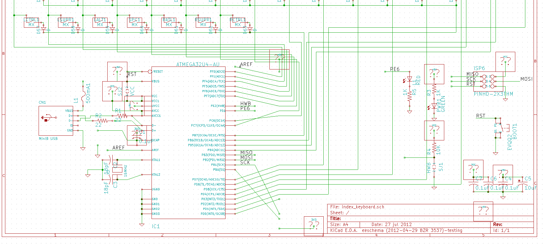

Hi all,
Been working on this PCB for the past week using KiCAD. I got my layout done, I just need to add in the Teensy into the PCB. However I want to use the SMD components from the teensy. I've got the correct microcontroller on it already, I just need to mini usb and the rest of the Teensy components on it in the correct spots.
I'm planning on putting this PCB in a Poker case and I want to be able to connect a ICSP on the bottom through the hole in the Poker case.
I was wondering if someone could help me place the rest of the components of the Teensy.
Thanks,

The Teensy I want to place on the PCB is the Teensy 2.0 to be specific. The schematic can be viewed here: http://www.pjrc.com/teensy/schematic.html
Edit1:
Also, I think the CUI might be a better alternative to the Teensy since it has more documentation on it. Any thoughts?

Here's the updated project files with both the breakout board and the cherry switches.
Can someone please look over the schematic? I know nothing about pcb design and I'm pretty much doing this for the first time.

I had a quick look and it looks quite right, but don't take my word for anything... Also I don't have all the standard libraries installed so some components only show up as boxes with question marks in them. It would help if you kept all library files you are using in the project library. And remove all other library files, KiCAD get so grumpy when it doesn't find them all =) (And you also don't need to spill your username and OS..)
- There are still some wires that look like they end up in the middle of nowhere. And I think it is customary to only use vertical and horizontal wires with 90° bends, for a good reason...
- You can tie HWB to ground, through a resistor. It only needs to be grounded for the chip to call the bootloader on reset. That is unless you want to use that pin for something else. Then you need to have a jumper or button tying it down, while resetting.
- Keyboard LEDs?
- You can use the pins connecting to the ISP interface for other tasks in general use (that is the whole idea..)
- 3.3 volts? Are you going to want to use that, otherwise you can design that whole part away as well.

Sorry about that, I literally just did what u told me to do in the geekhack forum and just connected the wires from the cherry switches to the microcontroller.bpiphany wrote:
I do want to be able to reset the microcontroller so I can be able to reprogram it. Is that what you mean?bpiphany wrote:
I don't want any keyboard LEDs, except for the microcontroller so I can see visual feedback when I'm reprogramming the microcontroller.bpiphany wrote:
- Keyboard LEDs?
Oh really? Well, I want the ISP pins there so I can reprogram the microcontroller.bpiphany wrote:
I don't believe so, I just want a USB keyboard where I can connect an ICSP in order to program it.bpiphany wrote:
Thanks for all the help bpiphany (formally PrinsValium), I know it must be very hard to stay patient with me. I talked to you before about designing a pcb on geekhack after looking at your symmetric stagger keyboard and pcb diy guide.

HA, don't worry I'm quite patient, and I like to teach and help out =D I am no electrical engineer myself, but I think it looks tidier and easier to follow when everything is laid out straight. For quick and dirty prototyping there are of course no rules...
When you press reset the controller looks at the HWB pin. If it is high the controller only restarts the program (I think, never did that actually), and if it is low the controller starts running from the memory address where the bootloader is located.
The bootloader is used to transfer files via the USB port. The other way to program the controller is to use a serial programmer and the ISP interface (in system programming), this is also good if you for some reason want to change the fuse bits since this can't be done via the bootloader. (There is parallel programming as well, but I have never used that.)
You don't even need to disconnect the unit to be able to program it using the ISP programmer. The programmer just jumps in and takes over. The rest of the design may get very confused while the programmer is talking to the chip perhaps, if you've got anything listening on those wires.. But that shouldn't be a problem here.
You may want to square off your matrix a bit, dropping the two rightmost columns since they only have 3 switches in total, and put those switches somewhere else.
The absolute path to the library files are stored, so your windows username shows up there =) By the way you still need to tell KiCAD where your library files are at, under "Preferenced->Library". There you will also see which "standard" libraries that are included. The power connections are from one of them, and I don't have them installed. So those also still do not render...
Generally I recommend taking a look into the files with a text editor, they are not too complicated and it reveals a little of how things work under the hood. Also it is possible to quickly copy and paste together your own library files including only what you need. They are pretty forgiving on white spaces also, spaces or tabs doesn't matter, neither does the number of newlines.

Here's an updated version, tried to follow ur advice bpiphany.

I think it looks pretty good, the library paths still are messed up, but let's not focus on that =)
You probably don't want to connect the unused D0, D1 pins directly to ground. Even if you are not going to use them. If they are accidentally set to high output that would probably be bad. Leave them floating or have a 1k-10k resistor in series.
And, really, use some of the free pins for some switch mounted LEDs. It won't hurt you to have them there if you ever want them. Actually why not use every free pin for this purpose, or come up with some other use for them. No reason leaving IO-pins unused =)
Generally, try to make sure why every single component is there, and understand it's purpose. Ask questions if you can't figure it out. Why are C4-C7 there for instance?
You are probably going to want to move things around when routing, moving keys in the matrix, swapping controller pins and such. All to make routing easier and tidier.. And route by hand, it's not too hard and the result often gets a lot tidier. I sometimes use the FreeROUTE tool to do it by hand. It's pretty nifty to have the traces floating and making room while drawing out new ones. But that is only to sketch out the routing, after that I always redraw everything by hand in KiCAD.
I should work some more on the KiCAD tutorial =P There are some good-to-know keys to know when routing in KiCAD.

Hmm, I think for the free pins, i'll connect a dip switch. Just like how to Poker has a dipswitch.
I think I can connect a 3 switch Dip Switch using the ICSP pins and the 3 Leftover pins.

New update!
1) Added dip switches
2) Pruned some outdated files
3) Created a github repo for the entire project: https://github.com/callenrosario/index_keyboard

Much better =D
I think for the DIP-switches, you really only need to connect one of the sides to GND, and use pull-up resistors on the pin you connect to the other side. That way you will know which way the DIP is switched, and it gives you double the number of DIPs =) And I don't think it is a very good idea to use the AREF as an I/O-pin...
That 500mA fuse is probably pretty unnecessary, and tie HWB to GND through a 1k resistor straight away, if you are not planning on using it for anything.. You can lose the power indication LED without shedding any tears, but I still think other indication LEDs are useful =P
There is no PCBnew (.brd) file in the github repository...

Didn't know you could do that, that's very cool. I read more about it here: http://www.thebox.myzen.co.uk/Tutorial/Inputs.htmlbpiphany wrote: I think for the DIP-switches, you really only need to connect one of the sides to GND, and use pull-up resistors on the pin you connect to the other side. That way you will know which way the DIP is switched, and it gives you double the number of DIPs =) And I don't think it is a very good idea to use the AREF as an I/O-pin...
What is a 500mA fuse used for anyway?bpiphany wrote: That 500mA fuse is probably pretty unnecessary, and tie HWB to GND through a 1k resistor straight away, if you are not planning on using it for anything.. You can lose the power indication LED without shedding any tears, but I still think other indication LEDs are useful =P
Ah yeah, I didn't add it because it was out of date. I'll create a new one tonight after work.bpiphany wrote: There is no PCBnew (.brd) file in the github repository...

My guess is the fuse is on the breakout board to protect the USB port when messing around with peripherals connected to it. With a well functioning keyboard you should of course never exceed the 500mA USB limit. Accidentally shorting out two pins on a breakout board I could see happening...

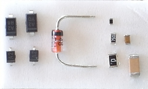

Unfortunately I didn't add anything for reference in this photo.

New update!
- Added .brd and .net files.
- Most of the .brd is done, just need to do the following:
1) change the spacebar footprint to 7.00u.
2) change the dip switch from a 3 to a 4.
3) place all the resistors
4) figure out the correct placement for the mini usb
5) change all the diodes to SMT

I think you are using some of my own old diode footprints. If I were you I would make them a bit wider and make the annulus of the pads a bit skinnier. Perhaps 0.3" spacing and 0.07" size, and round/square.
To enter the bootloader you will be required to have the HWB DIP switch set to ground. I would tie HWB to ground through a resistor (1-10k) and forget about it. You have all those ISP pins that you could use instead. Or use one of them for the LED and you will be sure not to short one of them to GND through the DIP switches. Actually PB4 is free, so just use that one instead =P
Edit: Saw you were going to switch to SMD diodes. So that comment won't matter much. You can do the same for resistors. I think 0603s can usually handle the effect a LED line will generate over it. But you may want to verify that. There is one thing that is actually nice with through hole components: It is a lot easier to fly wire things when you designed them erroneously =P
Over 14 key spacings there will be a difference of ~0.5mm, but I have no idea if the Poker was designed in inch or millimeter... You will need mounting hole locations as well as the USB connector location. I did some measurements of them all once. They haven't been tested or verified, but I can probably round them up from my notes...

Moar Updates!!:
Completed:
- Fixed the layout of the cherry mx footprints (based on .75" instead of 19mm).
- Swapped all through-hole diodes with SOD-123 diodes.
Todo:
- Fix spacebar footprint (still 6.25u, needs to be 7.00u).
- Place the USB footprint.
- Place all resistors, diodes, capacitors, crystals, and the jumper(?) on the backside of the PCB.
- Route all the wires.
Problems:
- Seems all the diodes are not wired up (I have no idea why this happened).
- I only have a rough idea of where to place the USB from pictures of Poker PCBs, still need an exact measurement.
- I have no idea how to edit the drawings for the spacebar to make it into a 7.00u spacebar (can only move components, can't seem to extend the drawings).
Completed:
