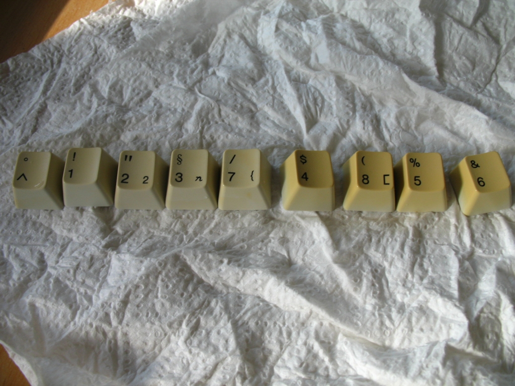

I pulled out a white Filco today (the "original" Otaku), and I was shocked. Slight yellowing! It has been in a box!
In original state:
In original state:

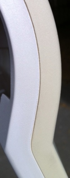

TAKE BEFORE AND AFTER PICS!!
No one believes until they see.
Kinesis top case in oxy-clean and water ONLY, bottom case untouched.
- kinesis retrobrite 1-3.jpg (26.23 KiB) Viewed 7717 times

oh, well, this is my compaq -NMB rubber dome (my clusterfu**k back in 7bit's thread)
I should've been satisfied with this result after 12 hours.

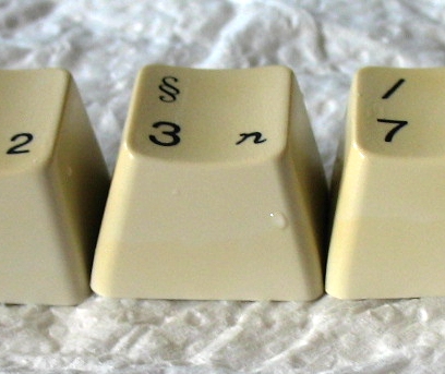

so after a couple of days in, what I would call, English weather there is some noticeable progress
-availability
-price
it sucks for
- handling
ps.
these are printed focus key caps (just like yours)
you can see the edge of where the stuff was applied
but overall I have to say, that, while it is good for-availability
-price
it sucks for
- handling
ps.
