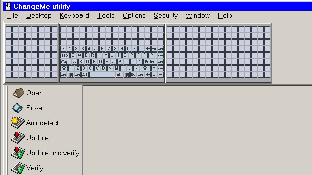

My keyboard consists of 3 units, and it is the middle one which is connected to the computer. No problems there.

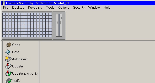

On their PCBs all units have 2 connectors (one on either side) for their internal connection ("Tipro Bus). Obviously the controller/program identifies what is connected where.Icarium wrote:How would the board know where left and right is?
As a matter of fact, every time you open ChangeMe, it scans your keyboard and displays its actual physical configuration, for example:
or even:
