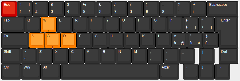

Hello everyone, I'm Loris from Italy. Few days ago I was looking for a new gaming keyboard and I ran into mechanical keyboards, I discovered great communities behind them so I started thinking about building one for myself.
I read many threads, especially Matt3o's ones and I understood basic priniples in building a custom keyboard, so I started out choosing a layout that could be good for my needs (gaming and coding) and that could be quite "easily" built by a novice like me. At the end I think that a 60% standard ISO layout would be the best, considering also keycaps retrieval.
This is what I was thinking about, actually I had a little modification in mind since I don't really use right control keys

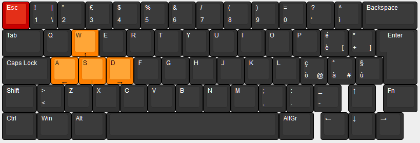

This one could be another option, since I don't even use Caps Lock and a Del button would be useful for coding
My question now is: if I move Fn instead of Caps Lock, will I need configurations for games that use Caps Lock buttons? I mean, how will the keys be recognized? I read something about the Teensy configuration, but I didn't really get this thing, will I have to set a particular layout on PC too?

That was an idea... I really don't use the right shift, so it wouldn't be a big loss for me. I use arrows while coding, so those would be useful to have, but I could Fn WASD, even if I should get used to that.Eszett wrote:Do you really want to sac right shift for the arrows?

Welcome to custom keyboard design! You've identified one of the three options I know for navigation keys in a compact layout:
http://deskthority.net/workshop-f7/grou ... t7474.html
I'm much more into option 1, myself, which is going straight 60% and learning a function layer. Here's my current keyboard, IBM's one and only 60% buckling spring:
The way I have it mapped, on the function layer, is like this:
If you can master HHKB style arrow keys (the diamond shape on the right) or WASD or ESDF arrows (what I use on the left) then you can really master anything. It's a lot easier making customs and matching caps if you can stay close to a standard 60% block. I find it second nature. But there's definitely an ideal layout for everyone, and it's not the same for all people!
As for your question about Caps Lock: a Teensy powered custom keyboard can take on any mapping that you like. You have complete control. Your computer also has a software layout associated with the keyboard. That's where you change between ISO German and ISO UK for example. I think what you're trying to do is put your keyboard into a "gaming layout mode" so you don't have to make the same key binding changes in every game you play. A Teensy can handle that for sure! I'd make it a layer lock, so you just press a key combo to engage it and the keyboard stays there, with Caps Lock etc. moved to traditional locations, until you toggle it again when you're done.

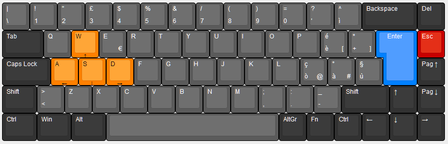

I guess I will have to put the ~ issue away for the moment... I think that this could be a good layout for both gaming and coding, I put pagUp and pagDown instead of volume which is more useful for a programmer and replaced the ~ key with del. This is pretty compact and I like it, basically needing Fn only for function keys, so not much headache to learn alternative configurations. The only thing I am not 100% sure about is the absence of spacing around the arrow keys... could be uncomfortable.

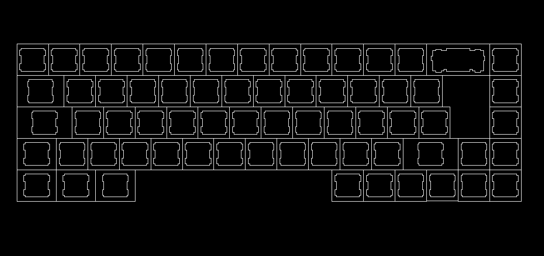

I also tried to "design" a plate for the keyboard using a template I found here on deskhority, but since this is the very first time for me using a CAD software I was only taking shapes and moving them to position. Here is the result:
I don't know what to place for return and keyboard since there is no "block" for those keys. Another thing: he .dwg template file contains the sizes for everything, but they are different from datasheet ones (slightly smaller?). For example the square hole for a 1u button is 0.55 (inches I guess) on the template, while on the datasheet 0.61, why is this?
