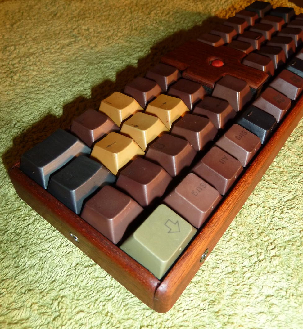

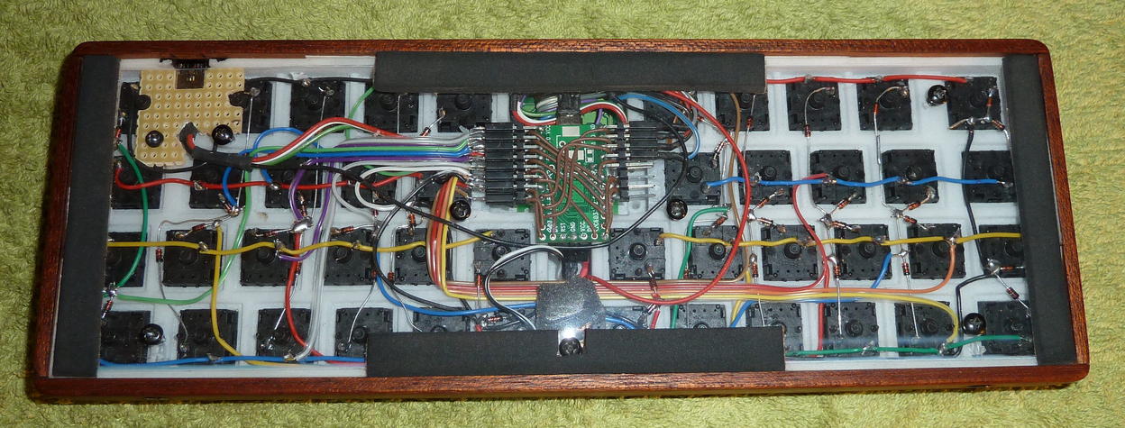

The wooden frame around my HyperNano took me longer than expected, but I'm kind of happy with it now and have colored a bunch of keycaps in the meantime to find a pleasant color scheme to go with it.
Other than that I've been typing for almost a week on this little beast and am impressed how pleasant the layout is: No comparison to a split and tented setup which I'd much prefer, but the symmetric 1/4 stagger together with larger than usual hand separation makes it more natural for me to type on than on a standard desktop keyboard.
I also I put an acrylic baseplate on and finally added a proper mini usb socket - no the most beautiful attachment, but it works.
On the software side of things, I ported the mousekey support from tmk_firmware and am quite surprised how well it works with the right settings - especially for emulating a scrollwheel as recently discussed on the HyperMini thread (if I didn't have that functionality with the trackpoint already I'd miss this sorely by now). By the way, I seriously consider switching to that amazing firmware altogether in the near future, seems to be a lot more advanced than my hackish attempts, with a bunch of nifty features I'll find hard to implement.Other than that I've been typing for almost a week on this little beast and am impressed how pleasant the layout is: No comparison to a split and tented setup which I'd much prefer, but the symmetric 1/4 stagger together with larger than usual hand separation makes it more natural for me to type on than on a standard desktop keyboard.

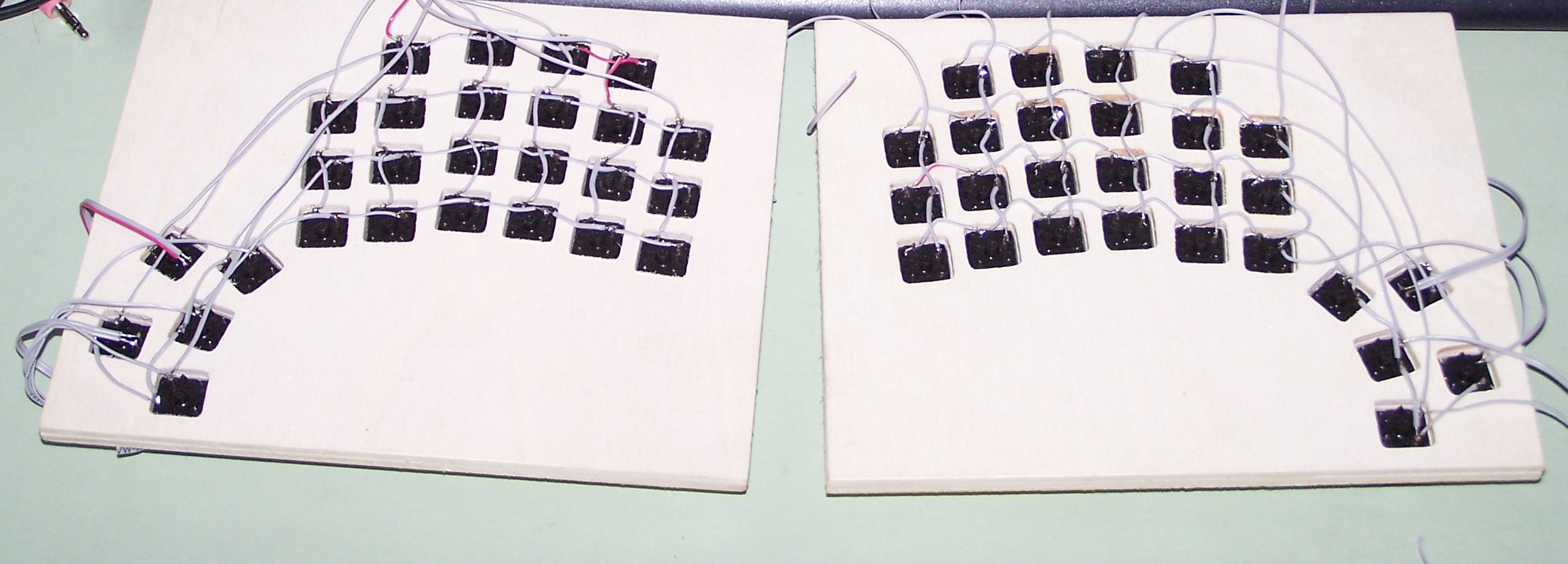

I registered with Deskthority just to post on this thread; these are amazing, and thank you very much for posting them!
I have a mill and i'm going to try cutting some grids this weekend. Thanks for the inspiration!
I'm a little concerned about the 14mm^2 holes; as i'm using a mill, it's tough to get sharp corners on inside pockets, and the cherry's have most of the "lip" on the corner. Did you have any trouble with the fit on any of the early prototypes? Or does the extra rigidity from the PCB below take up any slack or wobble?

Since it is 3D-printed, all corners of the cut-outs are rectangular - don't know what the tolerances of the switches are if you mill it.bearcat wrote:Did you have any trouble with the fit on any of the early prototypes? Or does the extra rigidity from the PCB below take up any slack or wobble?
There is no PCB in my designs! Just the plastic frame however is stable enough to support the whole keyboard, especially since it it enclosed in a frame.

You don't need to overcut the corners if your bit is small enough.bearcat wrote: I have a mill and i'm going to try cutting some grids this weekend. Thanks for the inspiration!![]()
I did this boards long time ago with a 2mm bit and had no problem with inserting the switches. If you take a close look at the corners in the image, they are not perfect

Whoa, that's great! Definitely gonna have to give it a go. Didn't get to it this weekend but have been playing around in openscad getting the model ready.
Mind if i ask: what is the separation you're using between holes? E.g., a 14mm^2 hole separated by 3mm? 4? what's normal?imp wrote: You don't need to overcut the corners if your bit is small enough.
