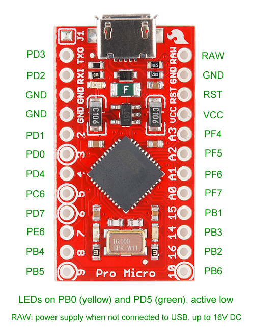

If you're planning on using two boards, the Pro Micro should be enough.
I would not recommend the Nano, as it does not use an AtMega32u4 chipset. The Pro Micro does, which means that software that is designed to run on the Teensy 2.0 board can run on it. You will have to look up the Arduino Leonardo / Micro / Pro Micro pin out to map the pin names between what the teensy uses and the Arduino uses, but that is it.
The Pro Micro does indeed not have a reset button, however this is not required.
1) With the default bootloader, it will stay in programming mode for 10 seconds (I think) when it is plugged in before booting the firmware that has been loaded.
2) You can wire your own switch on to it, all you have to do is connect the RESET pin to ground.

I can confirm that Pro Micro works great with Soarer and tmk.
I bought this guy :
Leonardo Pro Micro ATmega32U4 Arduino IDE 1.0.3 Bootloader replace Pro Mini
with free shipping; It arrived in 7 days .
Took a while to figure out how to upload stuff (RST + GND twice puts it in boot mode for 8 seconds).

I’ve been using the SparkFun Pro Micro for a while, and I’m satisfied with it. Biggest plus to me is the Micro-USB connector, since I refuse to buy any more Mini-USB stuff (this is one of my pet peeves). It doesn’t have space for ISP pin headers though. More annoyingly, it does not have any mounting holes
The Arduino Pro Micro is nice as well. Has Micro-USB and ISP pin headers, but comes with the pin rows pre-soldered (at least mine did), so it’s hard to stuff in a keyboard case.
For anyone concerned with bootloader times: if you tinker with AVR processors regularly, I recommend getting an AVR Dragon for about 50€. This allows you to flash anything to a wide range of AVR processors via ISP or JTAG, without worrying about bootloader stuff. Highly recommended if you can justify the expense
